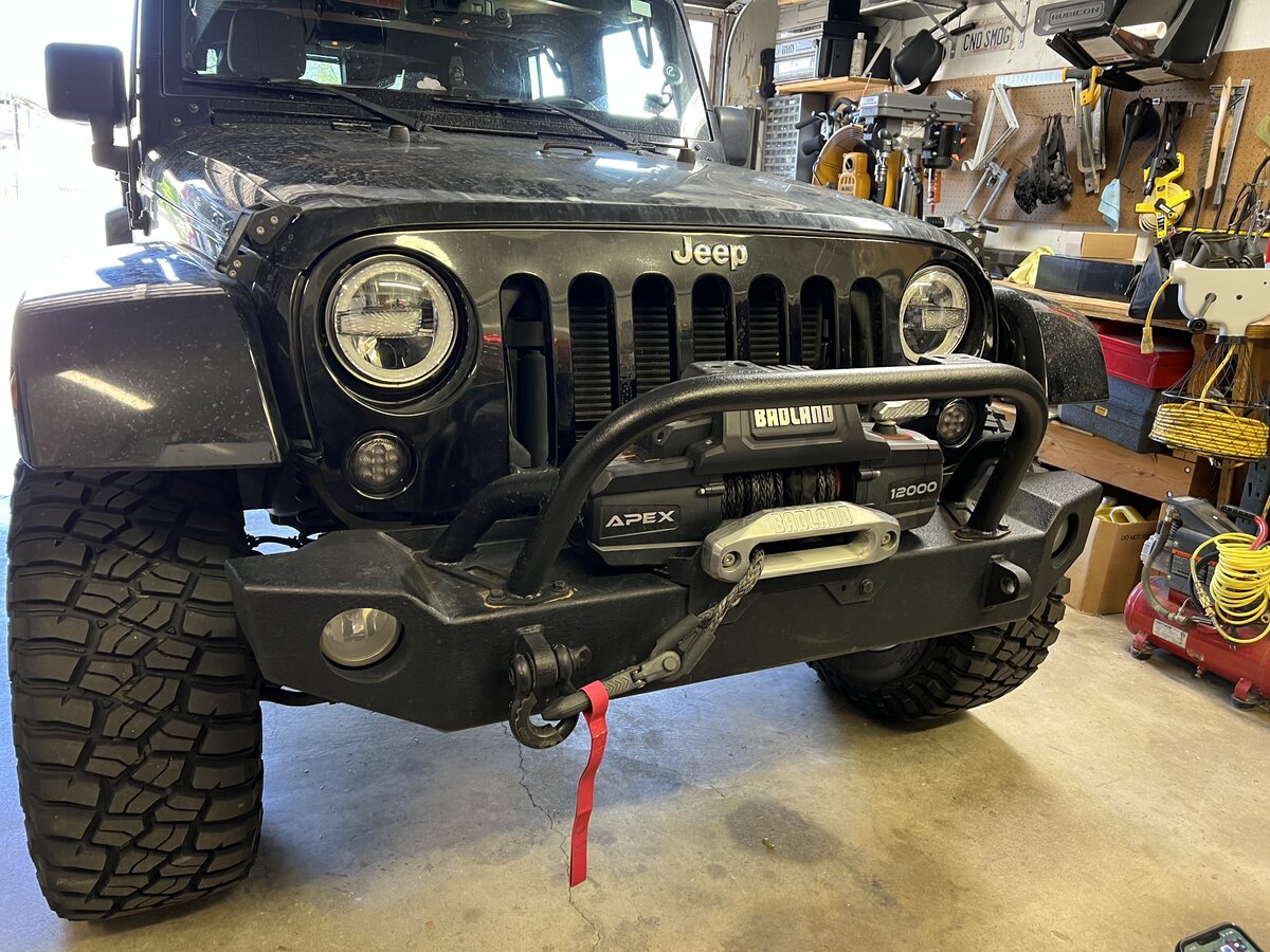

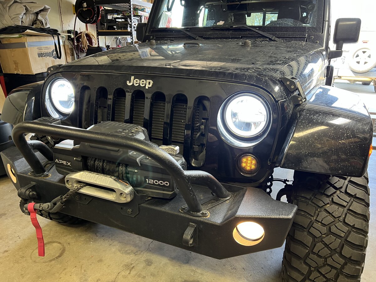

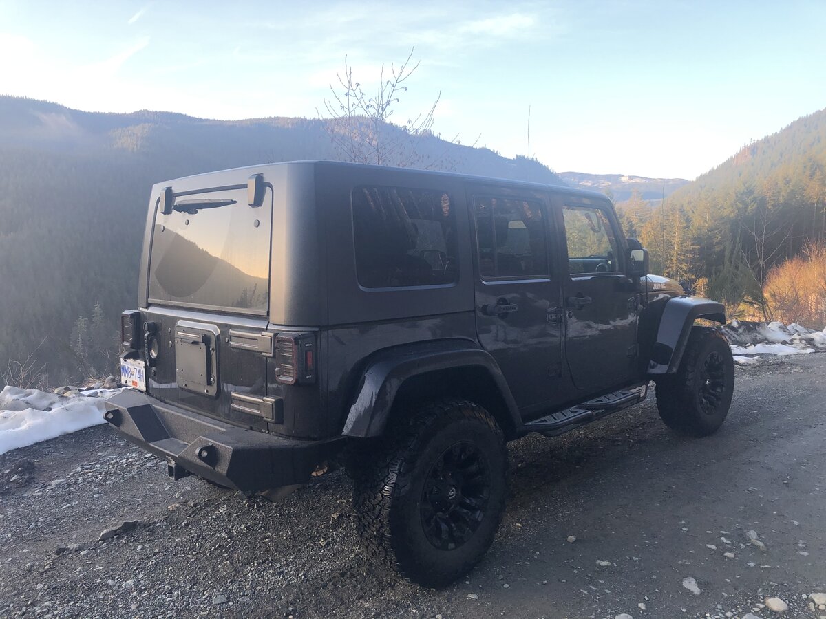

Metalcloak 2.5 dual rate, rustys spare delete / license reloacter, tinted turn signals and JL hood latches installed. The tinted parking lights have yet to arrive.
Overall the installation went pretty good, I personally thought MC instructions sucked, lots of crap I didn't need and lacking a lot of stuff I did. Haven't drove it much, haveView attachment 123915View attachment 123916 to get it aligned next week.
I've seen the JL hood latches on a couple UTube channels.
Thinking of doing that on my Jeep. As mine are pretty faded.
Is it a PITA install or pretty straight forward.
Nice looking Jeep

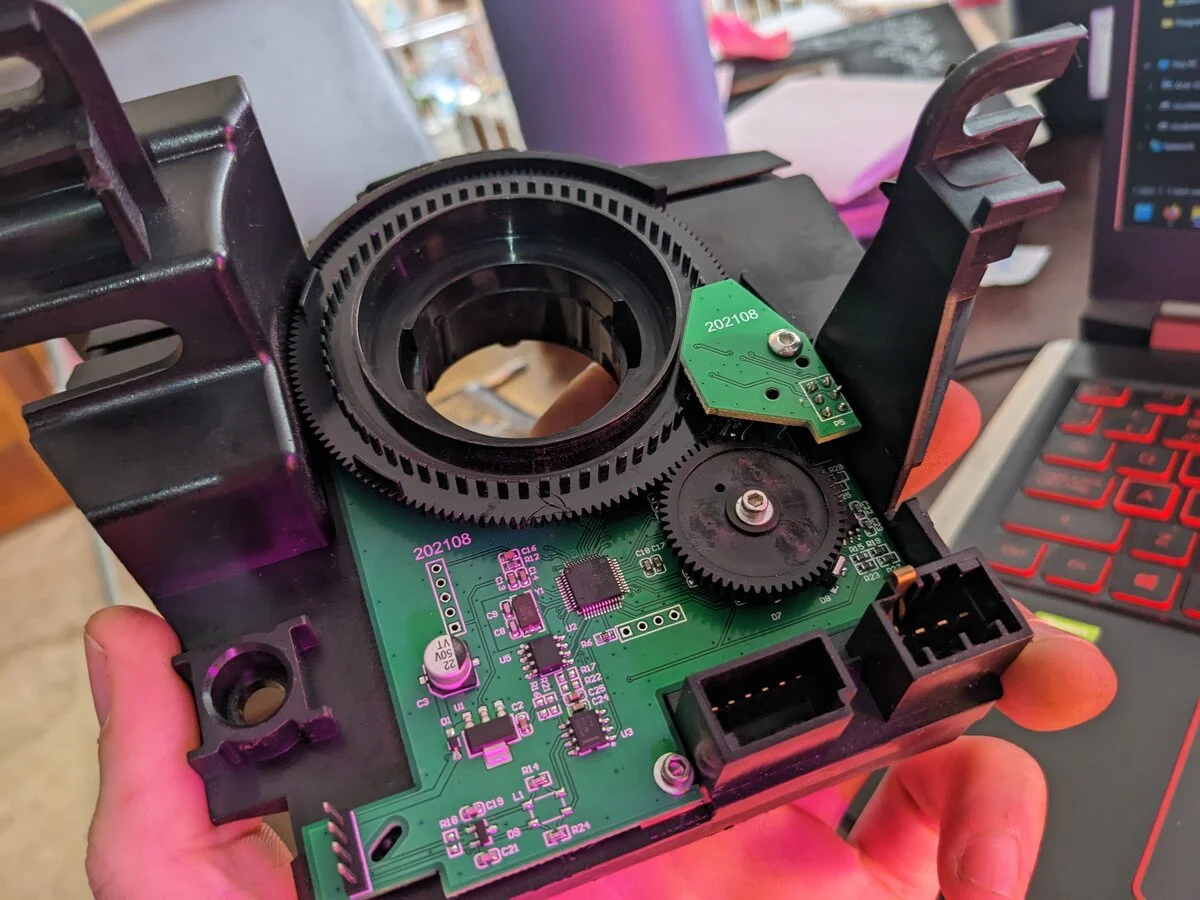

I replaced the original 14mm track bar bolts with 9/16" bolts. She rides much smoother and tighter now, no more death wobble. It's amazing the difference between ten thousands of an inch. Once I got that working nice, I installed a new steering stabilizer.

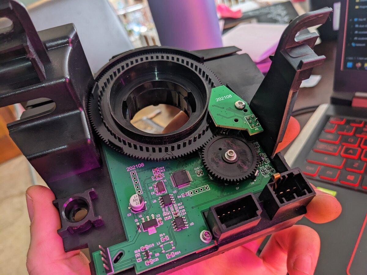

I also replaced my broken clockspring. The cheap one I got from Amazon apparently didn't have the steering position sensor unit in it but looking at the plastic housing, it had all the screw holes and clips for that circuit board. So as an experiment, I removed the circuit board from my original clockpsring and installed it in the cheap unit and it fits perfectly. The only thing I didn't know is what angle to install the little gear wheel so I just guessed it. That wheel is what I believe the vehicle uses to get the precise steering wheel angle. As expected, all my warning lights and codes went away except for the traction control light. The computer is picking up my steering wheel as going outside it's normal boundaries. I'm gonna see if Jscan can output the steering wheel angle to help me center that little gear wheel. Otherwise, I'll just have to move it one tooth at a time until the light goes away.
Glad you figured out . The 9/16 do the trick.
Whenever you get around to doing control arms
good time to replace with 9/16, shouldered grade 8
all around .

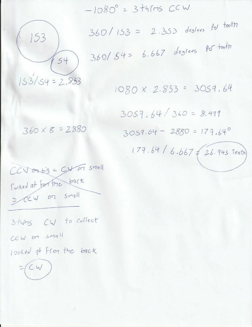

Yup she's good now.
I also corrected the angle on my steering wheel position sensor.
It involved reading how far off it was on Jscan (-1080 degrees for me), then counting the teeth on both gears on some photos I took of them and doing some gear ratio/ gear tooth per degree calculations. The steering angle reads as it should on JScan now. I don't expect many people will ever go through the trouble of installing their own steering column module but if you do, here's the math that I used.
I now have no more codes, no wobbles and all my features work again like cruise control. I guess it's time to break some more stuff.

Yup she's good now.
🥃 To you for figuring it out. That much math is above me (I hate math).

Sorry I took so long to answer.
It is a very simple install. The only issue is that the JL latches have 2 tabs that do not align with the JK hood. You can either 1) enlarge the holes in your hood so everything mounts up or 2) cut off these tabs.
I choose to cut off the tabs as the latches are pretty cheap. I have put about 100 miles on the Jeep since installing and have 0 complaints.
would do this again
would do this again
No worries. We all have lives
outside of the forum .
Well sort of .haha
Thanks for the intel
Appreciate it😊
would do this again
Yup, ran into this two days ago. Sales ad: they fit! Reality? Sure do with an angle grinder. Zing, off with their tabs. lol
