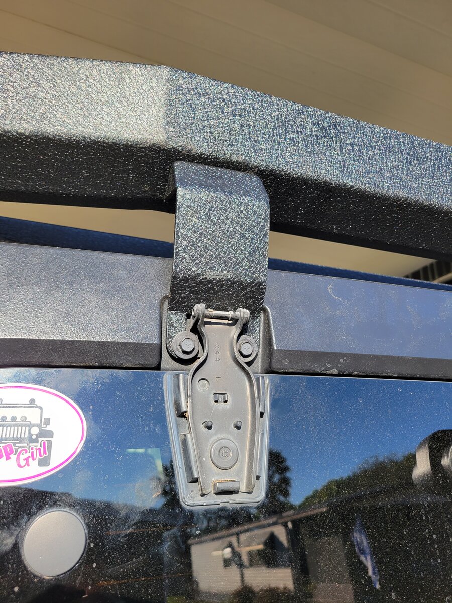

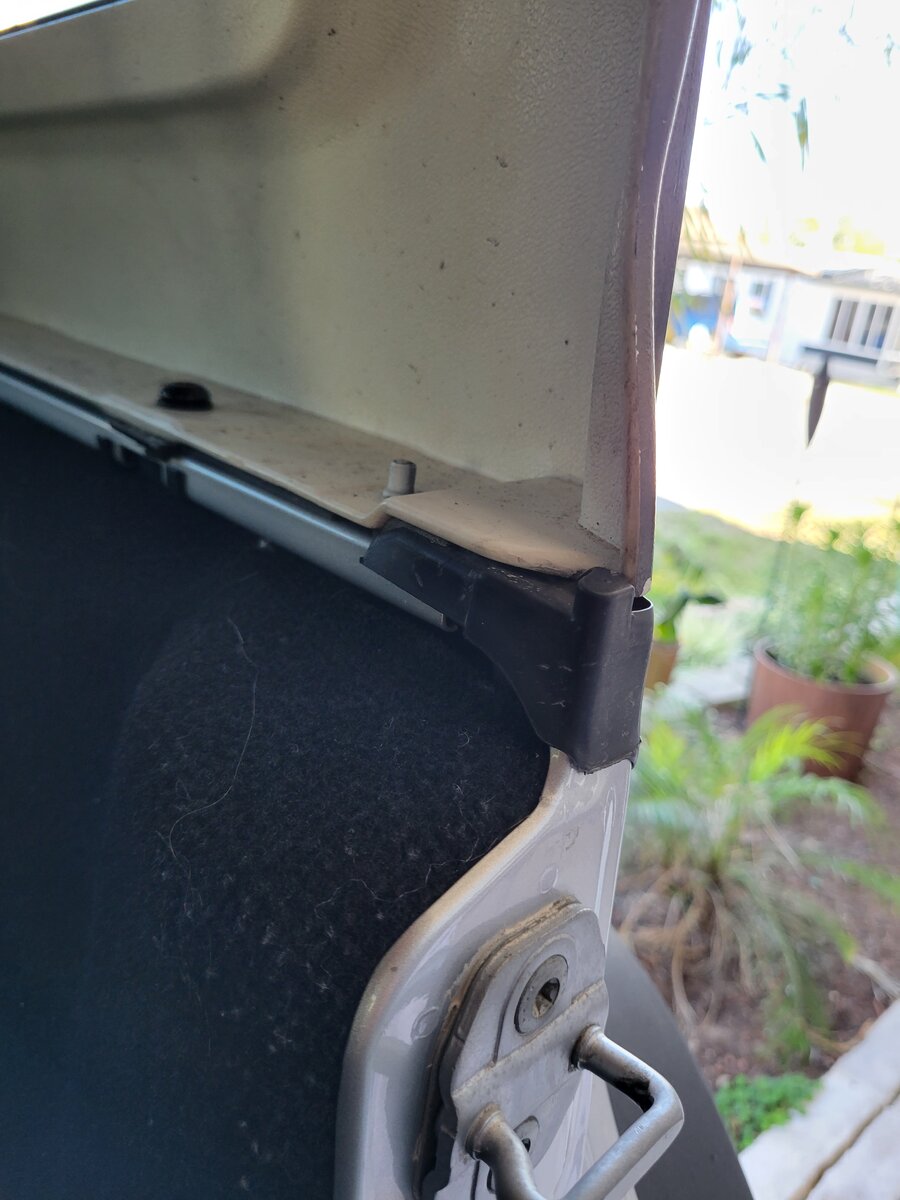

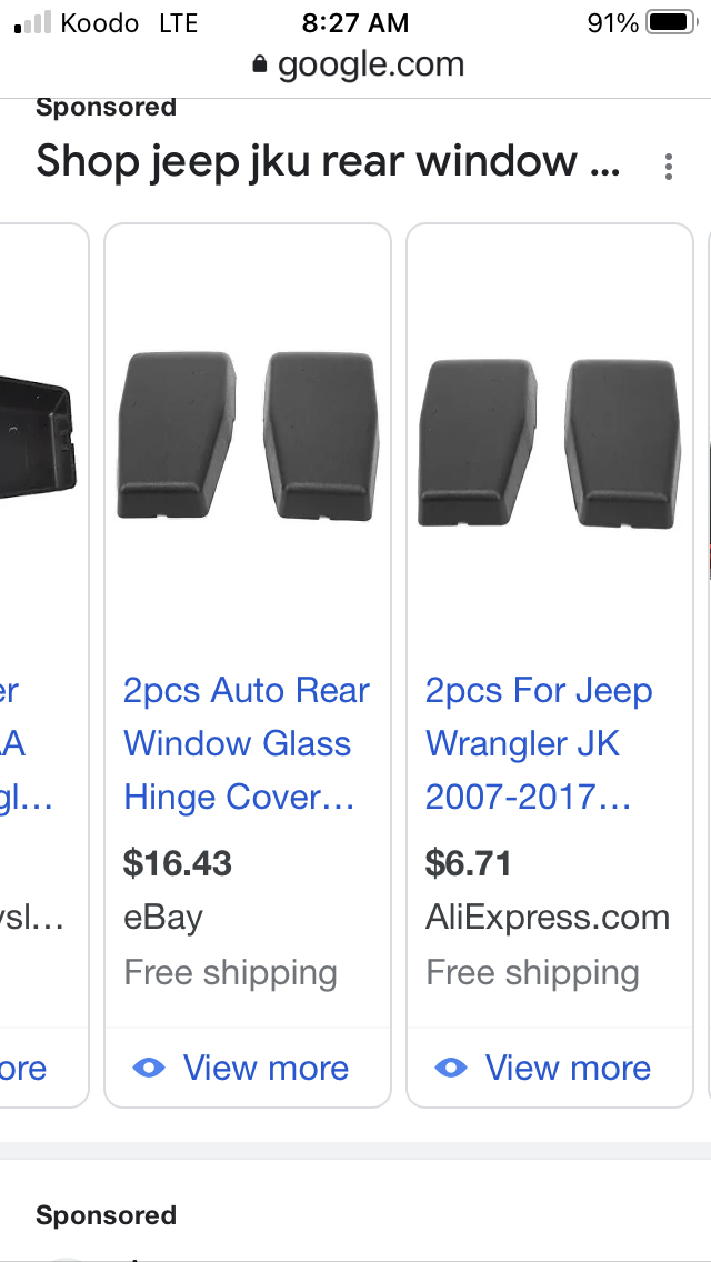

Noticed that one of my rear window covers was missing this morning. I installed the new roof rack a few days ago. Not sure if it came off going down the road, or when opening the glass? The directions were crap so didn't know weather the bracket mounted behind or in front of the hinge. I mounted in front as to not mess with the factory glass hinge location. I'm thinking it's causing interface though. Anyways, the cover is nowhere to be found grrr.
Was wondering how the rear of rack was attached . So attaches rear glass hinge .
lots of sources available for hinge covers
If you mounted it behind, you'd mess up the alignment and seal of the liftback.
When you added the bracket, you increased the thickness behind the cover. Opening the liftback caused the cover to contact the metal and work loose. I know this, because the same thing happened when I installed hinge-mounted lights on Mrs. Dogs JKUR. My solution was to touch the top edge of the new cover to a belt grinder and clearance it a bit. Didn't take much. Problem solved.
Great advice! I'll be sure to shave the the new covers once I get them.

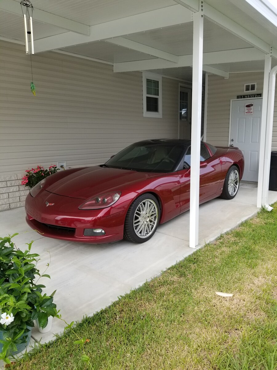

I Noticed this hardtop gasket was missing on the passenger side last night. Is this something I will need to get from a dealership?
It's a 2007 C6. No engine mods except for the CAI and Borla. Plenty powerful enough if you know what I mean lol
There's no such thing as powerful enough...
Heads/Cam/Blower LS3 in an M6 C5. Made 841HP. New engine is being assembled. Looking for 900 on pump gas, 1000+ on race gas. It's also getting a new roll bar, new seat pads and leather. Planning on a coilover conversion winter 2023.
