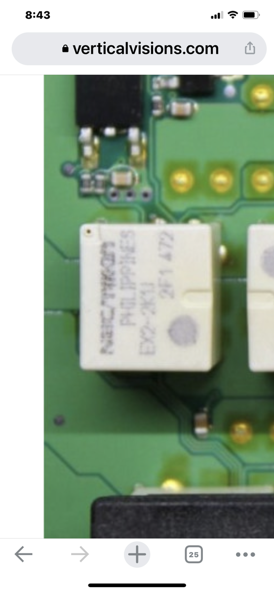

Been researching the this intermittent wiper problem (they only work w/o delay), along w/ a sporadic door lock/unlock issue.
Both are symptoms of a failed/failing TIPM.
I reviewed the options of new, rebuilt, and/or sending mine in for rebuild… all of which are overpriced.
That made me keep digging for more information what the failure modes are and how they are repaired.

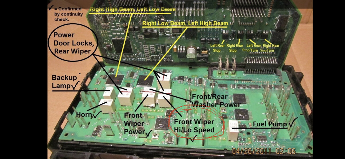

That’s when I found this photo:
Which clearly identifies the relay associated w/ the wiper speed and the door locks as being integral to one another.
I found the process of replacing the fuel pump relay and it doesn’t look all that complicated, so given my desire to not spend a ton of cash for stuff I can do myself, I tracked down a few of these relays… and I’ll tackle this repair on my own soon.

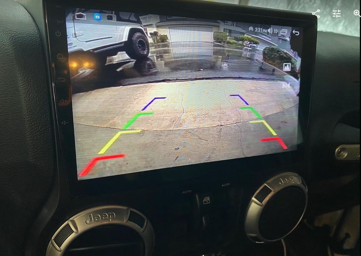

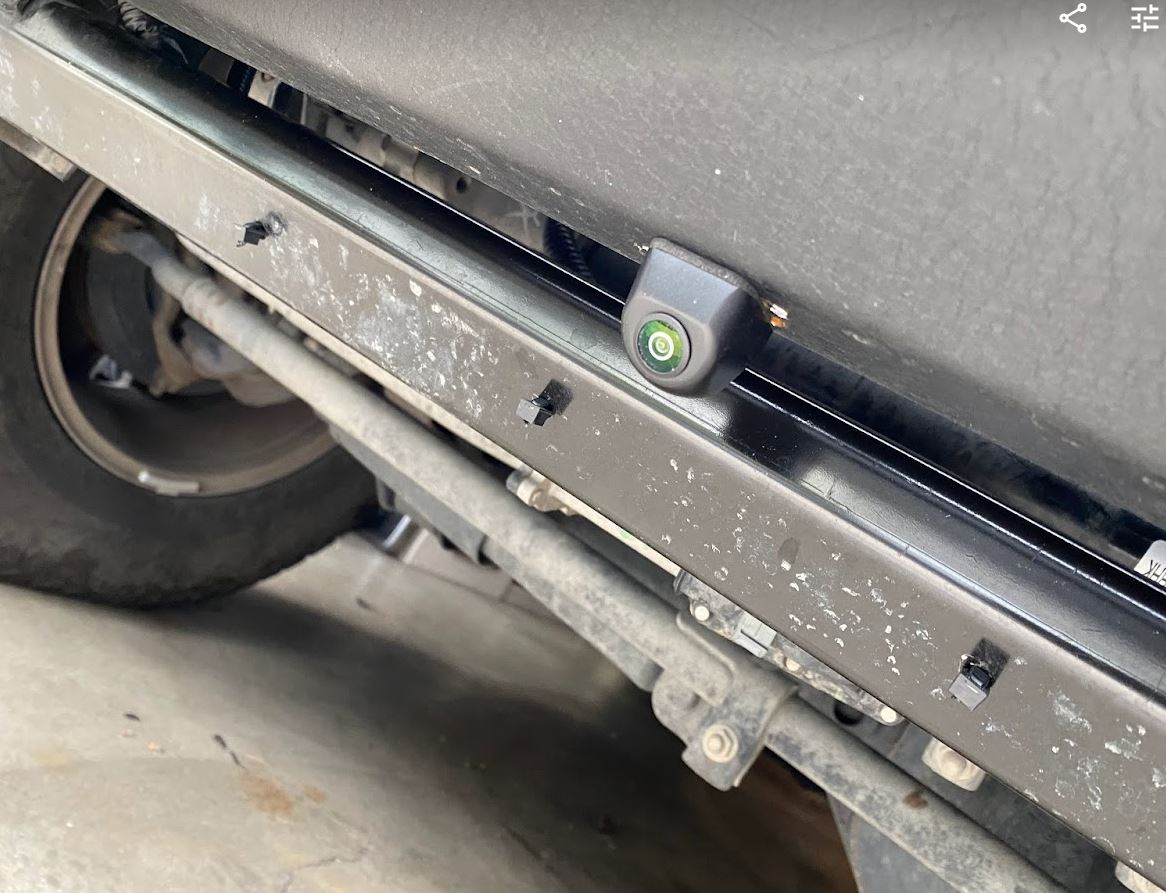

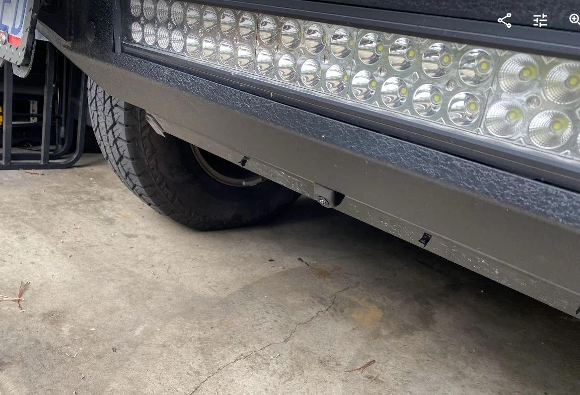

Got the trail cam connected.
Closer view:
Screen View:
I like the viewing angle so far, we'll see how well it works in the dirt
I need to learn the clearance I have between camera view and reality before I have any kind of confidence in it.
It's really just a gimmick that the radio happens to support, so I wanted to see if I could maybe also
use it for recording video instead of just providing a live feed.

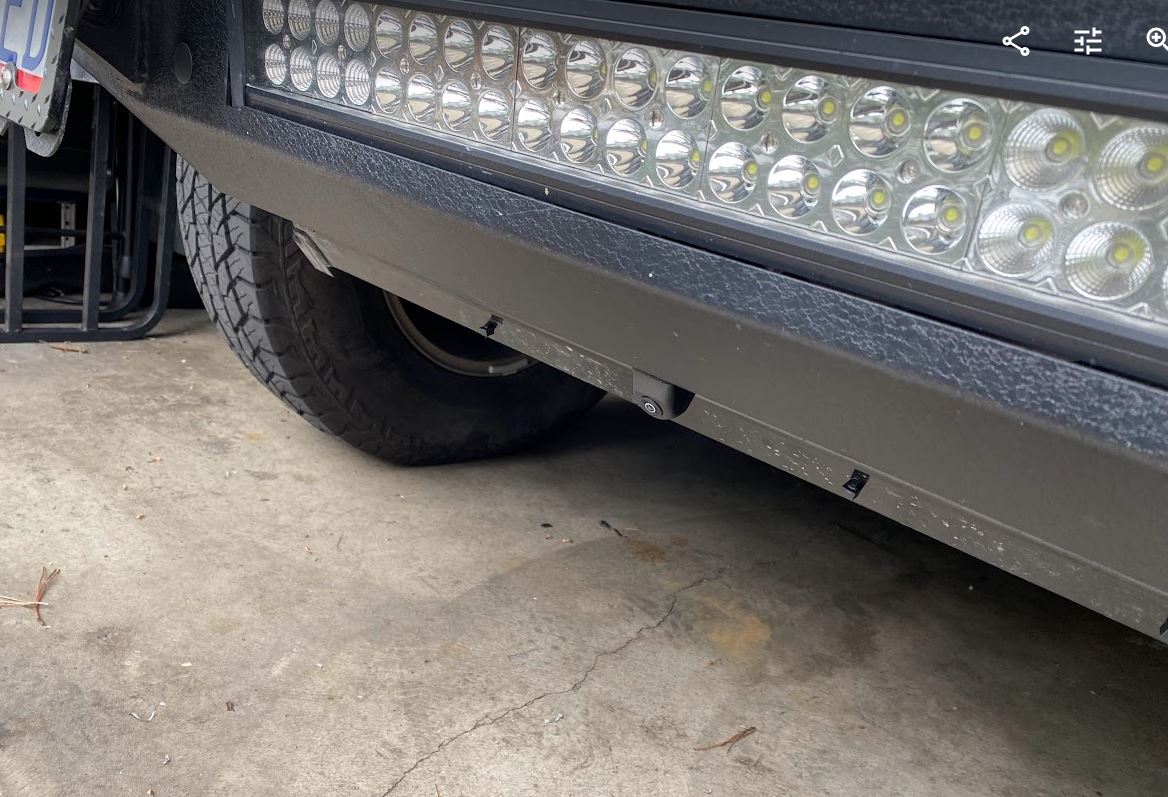

Closer view:
Screen View:
LOOKS good! I'm thinking of doing the same thing with my extra camera. I have the same radio.

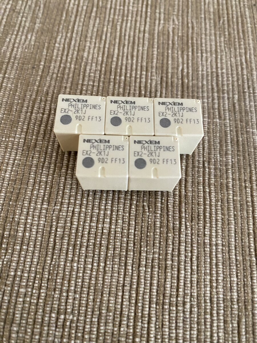

Look what I got today…
I might get to the TIPM repair next week.
I’ll take a few pics and provide as much of a DIY tutorial as I can.
I took the module out and disassembled it. Not difficult, but definitely a bit tricky.
Removed all of the fuses, relays, stacked boards and accessed the onboard relays.
R&R'd the relay in question and put it all back together.
Installed it and the damned thing wouldn't start... just cranked and cranked. The starter even remained engaged with the key in the RUN position.
Not good.
Disconnected the battery, pulled all of the cables off and carefully reseated them, then tried again.
Jeep started just fine.
Took it for a quick spin around the block to try the wipers and see if the new relay solved the problem; it didn't.
Still no delayed wiper function, only in low or high setting.
Not that big of a deal, except that when I parked, I noticed that the reverse lights remained on.
Definitely not a problem that I had before.
Played w/ Jscan to reset the ECU, clear codes, etc. and the damned reverse lights will not turn off.
I had to pull the bulbs.
Then I spent some time finding the best rebuild option for our schedule and this damned thing is heading out for a professional rebuild tomorrow.
