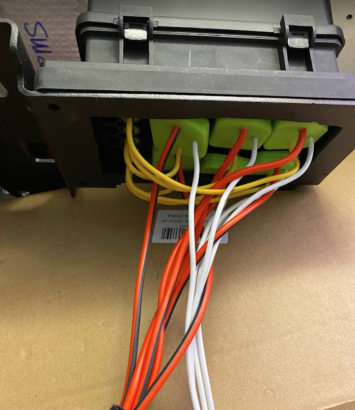

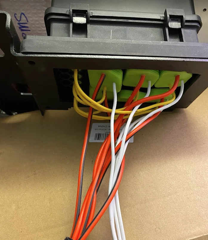

Spent a couple of hours playing with wires tonight.
Connectors are crimped, soldered, 'heat shrinked', and run through silicone gaskets to ensure the inside of the relay box is as dry as an English scone (or sense of humor).
I need to add the ground wires and the output leads from the fuses next. Then button it up and install it to the fender.
Then it's time to complete the trigger-wire routing through the firewall and up the A-pillar, install the circuit breaker, #8 power wire & bus bar.
Then I should be ready to connect some lighting.
Things take effort and thought to do right, and time spent now should avoid trouble later.

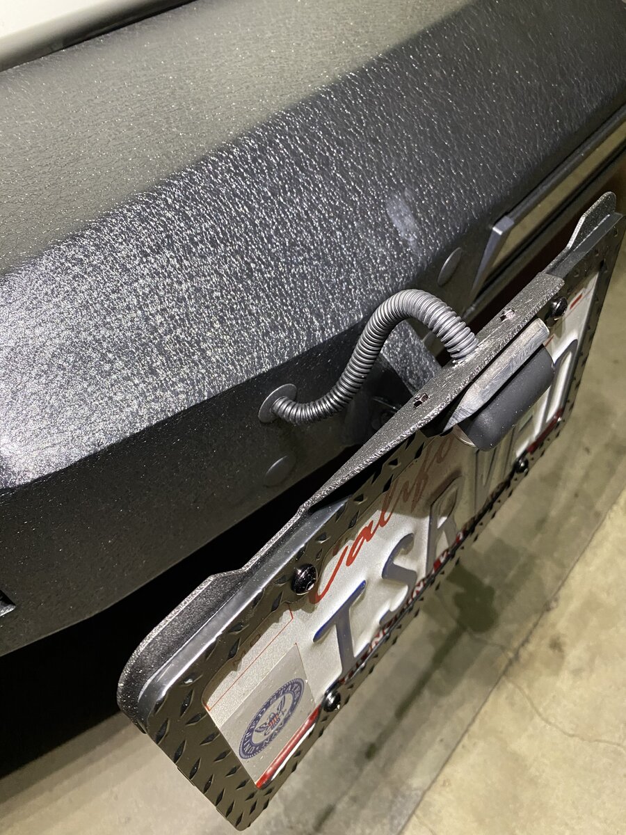

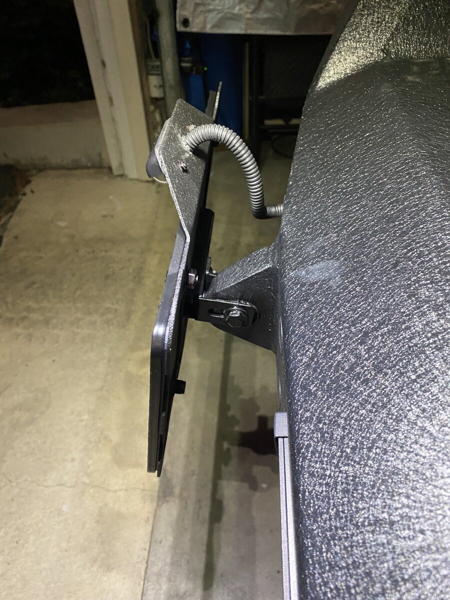

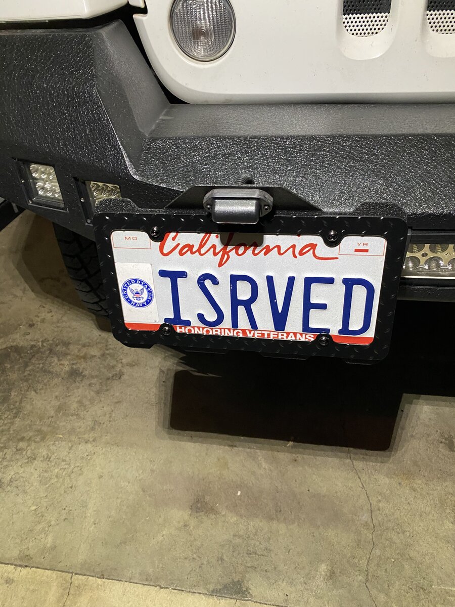

It looks to me (at least in those photos) like that mount will interfere with your lights. Do you not use them often enough for that to be an issue?
Reactions: Speartip
There is a very slight overlap on that inboard light, but probably not enough to be an issue.
Since I don’t have power to the lights yet I can’t confirm it.
If it does create a blind/dark spot, I’ll adjust the angle of the outer light to compensate; basically crossing the beams to get a wider pattern.
Probably just the angle of the photo then. It can be difficult to judge.
Well that would seem to be the bigger issue.
