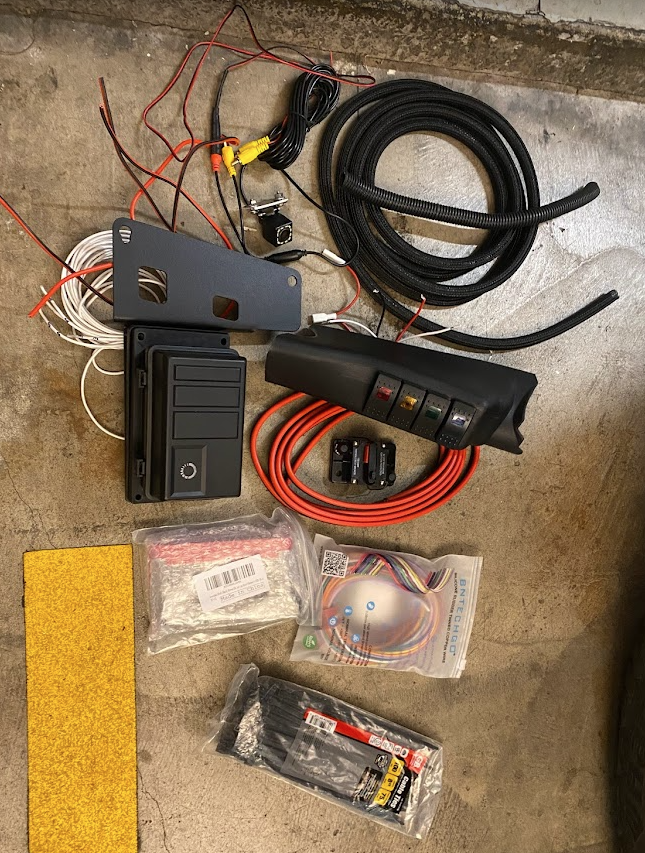

Gray truck arrived again today with more parts; some for the JK & some for the Harley.

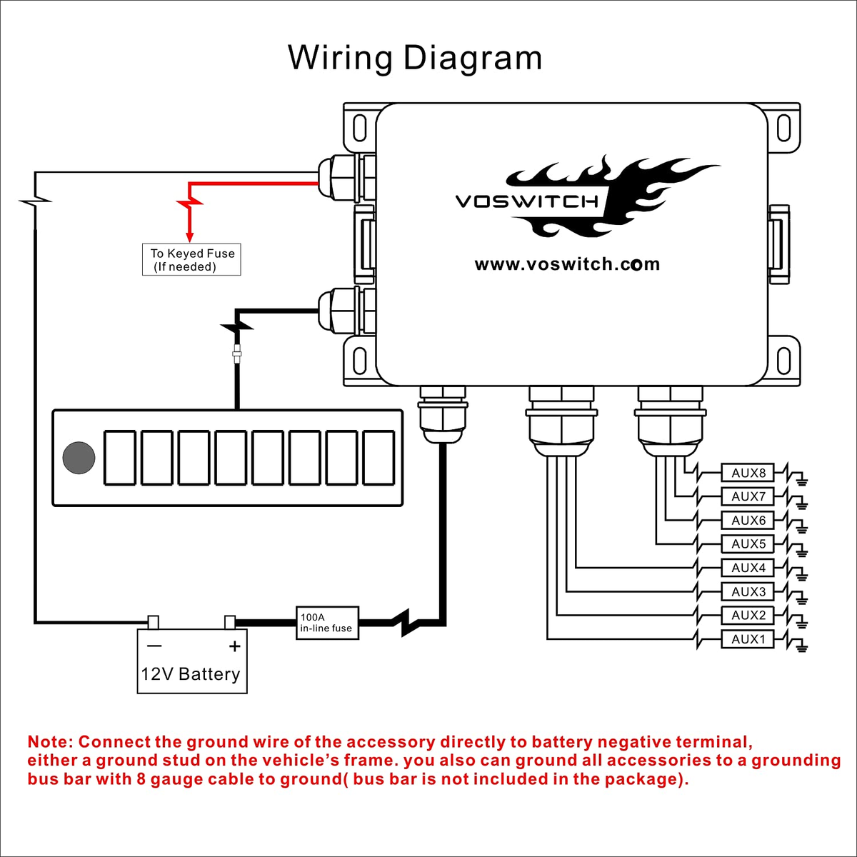

This is the pile of parts that remain to be installed for this switch & relay panel project (which is actually most of it!).

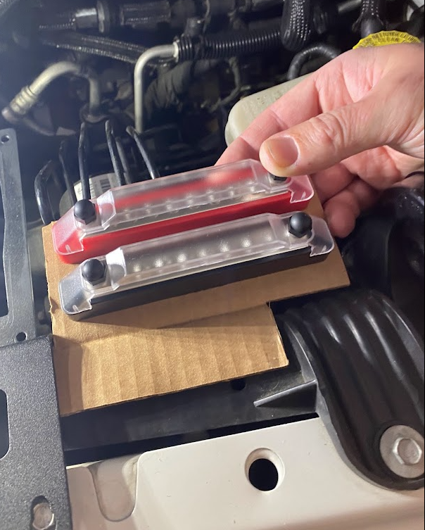

Circuit breaker will go next to the battery and the bus bars will go on a new bracket mounted to this plastic cover in front of the horn.
I plan on leaving enough extra wire in the bundle underneath the relay box to allow it to be removed to access the large electrical plugs that are part of the factory harness.
Trigger wires for the relays will run along the inner fender and through the existing hole in the firewall, wrapped in a sleeve, which will be zip-tied and secured to the factory wiring wherever possible.

@WestCoastDan, you're using bus bars for positive and negative? I had assumed the positives were inside the box, with the relays and fuses. Worried about exposure to the elements at all?
I’m definitely using the ‘double bus bar’ approach
How else can one reliably split that 8AWG power and ground wire to 6 different relays? 🤷‍♂️
As for corrosion, etc. I’ll probably coat each of the bars with something to prevent oxidation, perhaps dielectric grease, or some other black magic material…
In the past, I protected exposed battery terminals on solar equipment with high-temp axle grease to prevent corrosion.
Same approach should apply here.
Reactions: BigAL07 and mrjp
The ‘bus bar’ for the + in the VOS system is internal to the relay box; my relay box has 16/18 AWG wires and individual spade connectors at the relays, so I have to split it up externally.
I’ll never submerge the vehicle enough for these to create a problem… no different than the actual battery terminals, which are also exposed.
Reactions: Dirty Dog and mrjp
