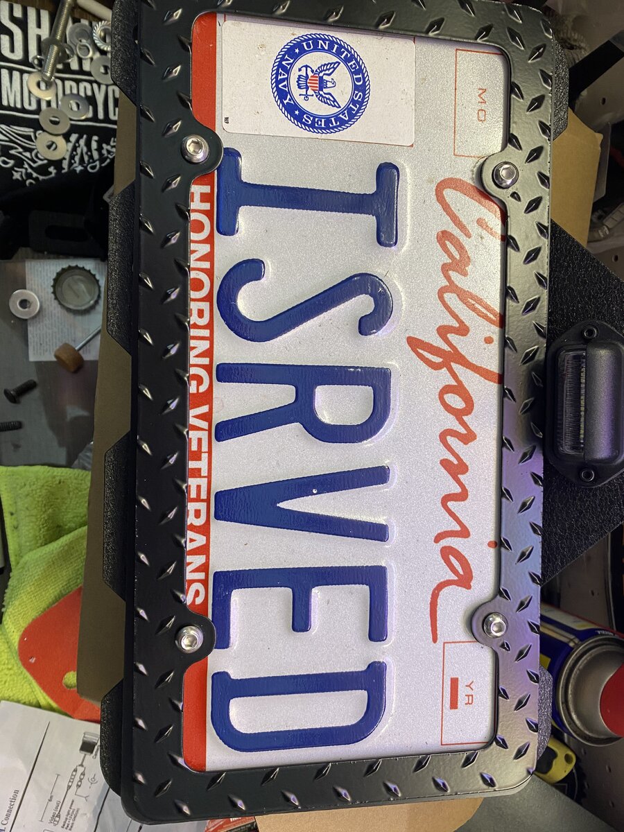

Looks like a D ring mount
Actually looks like quite a
nice bracket . I’m assuming the LED is a plate light
Yes, it’s a “shackle mount” and the LED is for the plate. I MIGHT cut that off… haven’t decided yet.
I definitely don’t like the mounting bracket; it’s a couple of cheap L brackets and a long bolt through the shackle.
It sticks out too far and has the wrong angle.
I also don’t like the power wire routing so if I keep the light it’s getting modified.

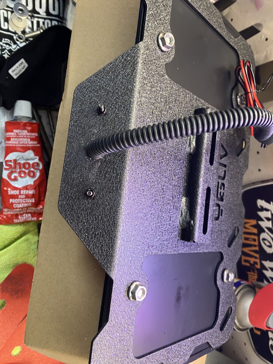

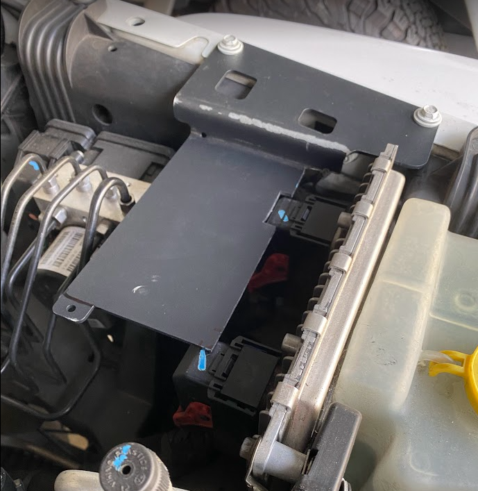

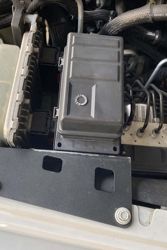

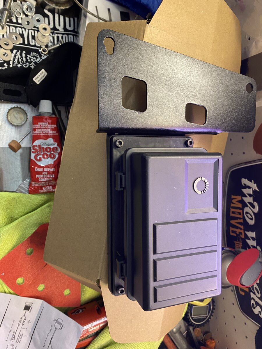

Modified the relay mounting plate to work with my preferred relay box. Had to bend the plate to make room for the taller box under the hood.
My bend was off by the thickness of the plate, so I had to notch out for the plug to make it sit flat.
Just need to make the notch on the corner so it sits flat, trim off that extra tab, cut out the hole in the middle for the wiring, then paint.

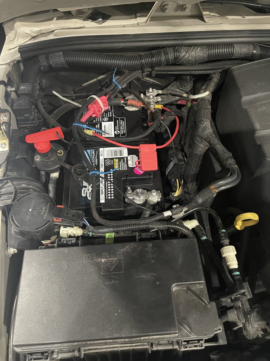

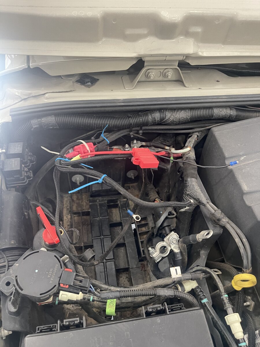

I just ordered 60A circuit breaker, #8 power & ground cable, along with the + & - terminal blocks.
This project is moving along quicker than expected. Still slow, but there are a lot of pieces to the puzzle.
Not yet addressed is mounting & wiring for the trail cam.
All in good time.
