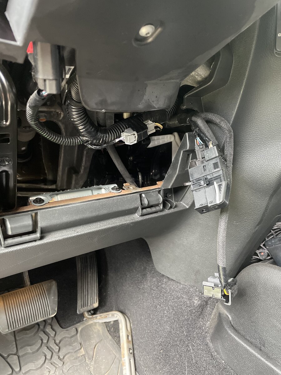

Was kinda looking at OBD placement in the Jeep and I could see myself accidentally hitting it with foot when getting out / in . So will probably just take it out when not using . I’m an accidental klutz sometimes .
I wouldn't worry about it. I have a magnet mounted on the panel under the steering column. It holds my gun when I get in, because in my usual carry it's uncomfortable and inaccessible while driving. The top of the slide is against the magnet. I don't kick it getting in and out, so I doubt you'll have any real problem with most of the OBDII bluetooth scanners.

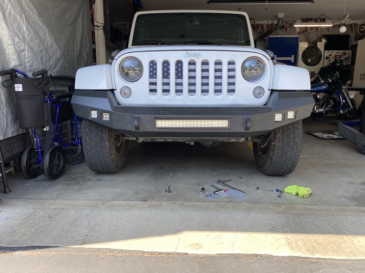

Bumpers are installed.
Not a bad process except the front was a really tight squeeze to tighten up.
No need for the upper “filler”, and haven’t decided anything about the skid plate.
Lights will be connected another day.
Make sure you have enough space between the top rear edge of the bumper and the grille to remove the grille if necessary. I added about 1/2" worth of spacer to the threaded bolts on the bumper to keep it off the grille a little. You need to pop off the grille to do anything with headlights and/or turn signals.

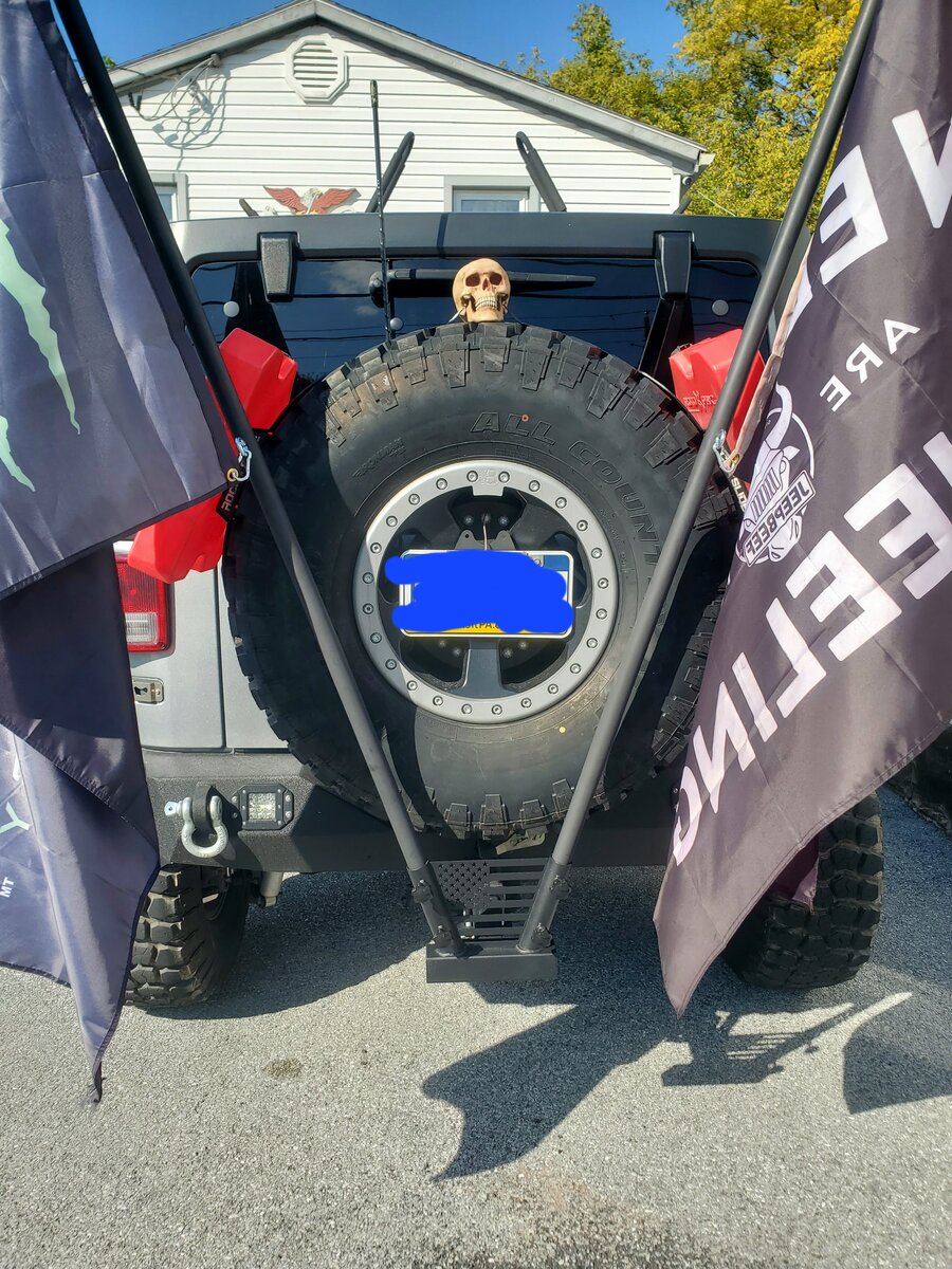

Finally got around to making my flag holder over the weekend. Got the hitch holder idea from one I saw online. Made it with a bunch of scrap material I had laying around. The poles are 1" scheduled 40 black pipe. Pole are painted flat black and I powder coated the hitch holder black. I used stainless steel eye bolts to fasten the carabiners and flags onto.
When I first read flag holder was thinking of the small high up off road flags .
I was wrong . That’s some pretty serious flagging going on the back of your Jeep.
Looks good !
