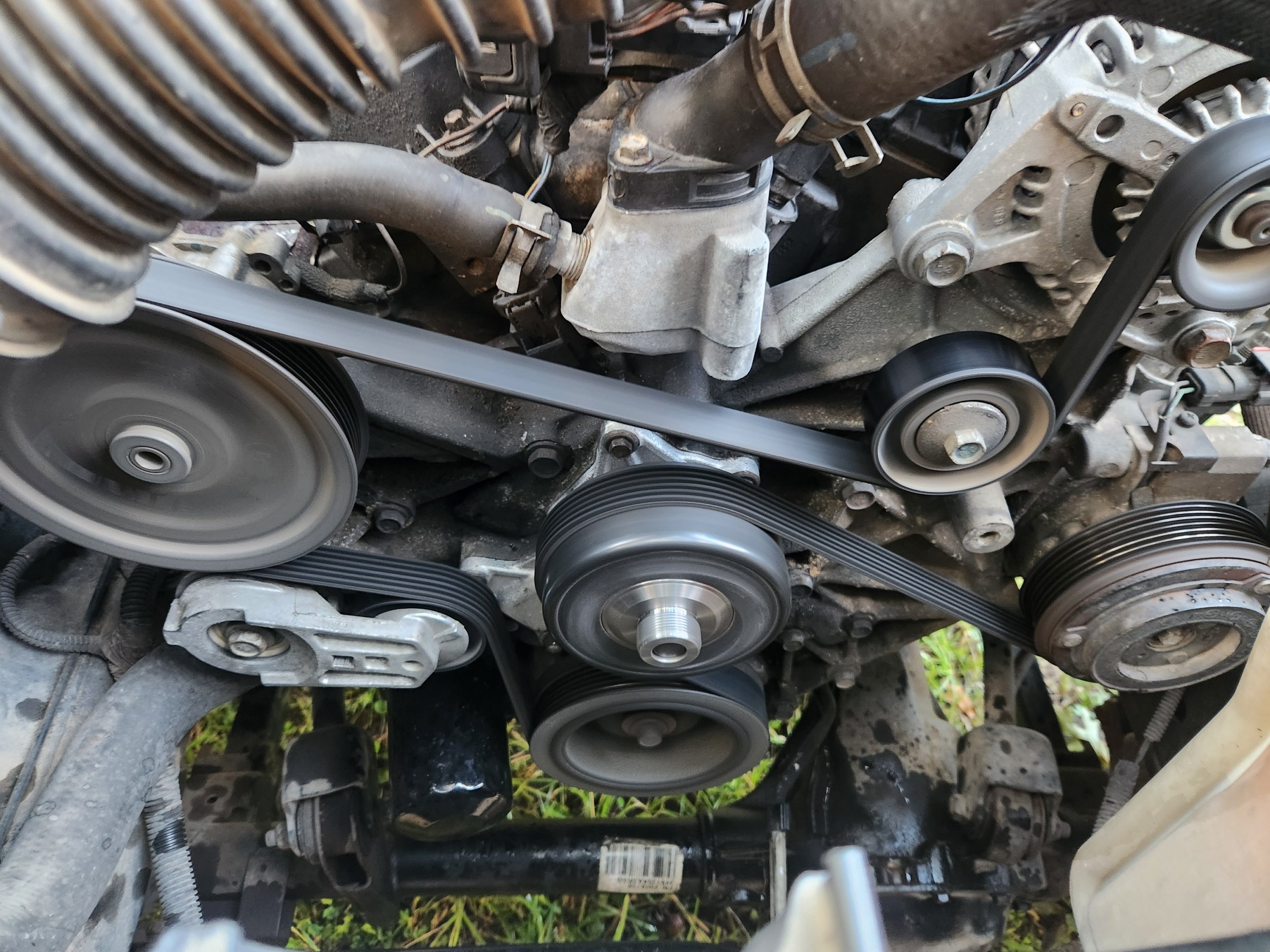

Heard a mysterious noise coming from the front of the 3.8 today.
Got home from taking Dad to church and took a gander at it.
Took the serpentine belt off, spun everything that would spin, the water pump pulley was making a noise.
Fired it up with the belt off, no noise, put the belt back on and water pump noise.
Hopefully will be replacing it tomorrow after work.

Well got home from work, ate supper, started on the water pump at 6:30..... by 7:30 was finished, took BBJK for a 20 minute test drive.
Way quieter and no leaks!!!!!!!!!
