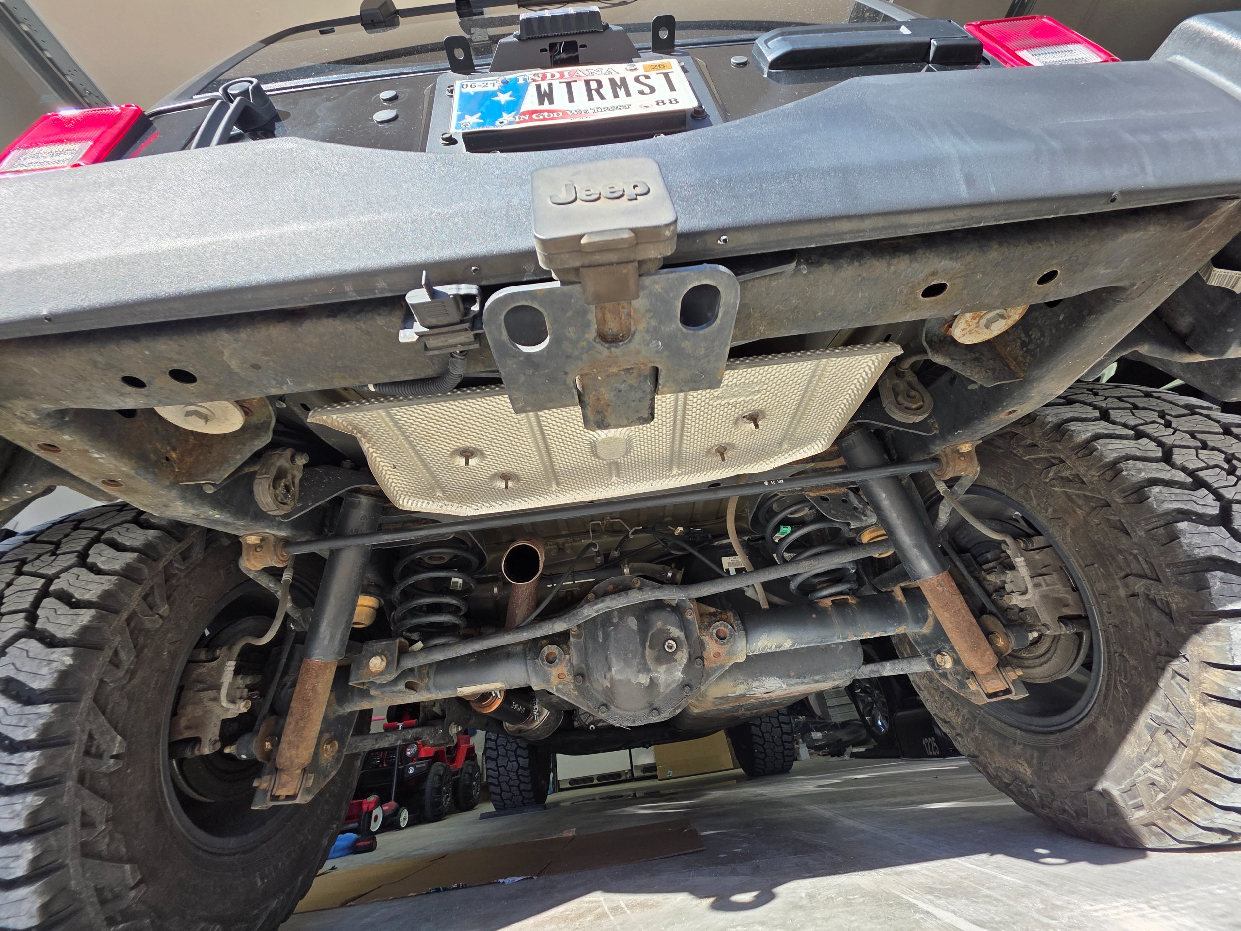

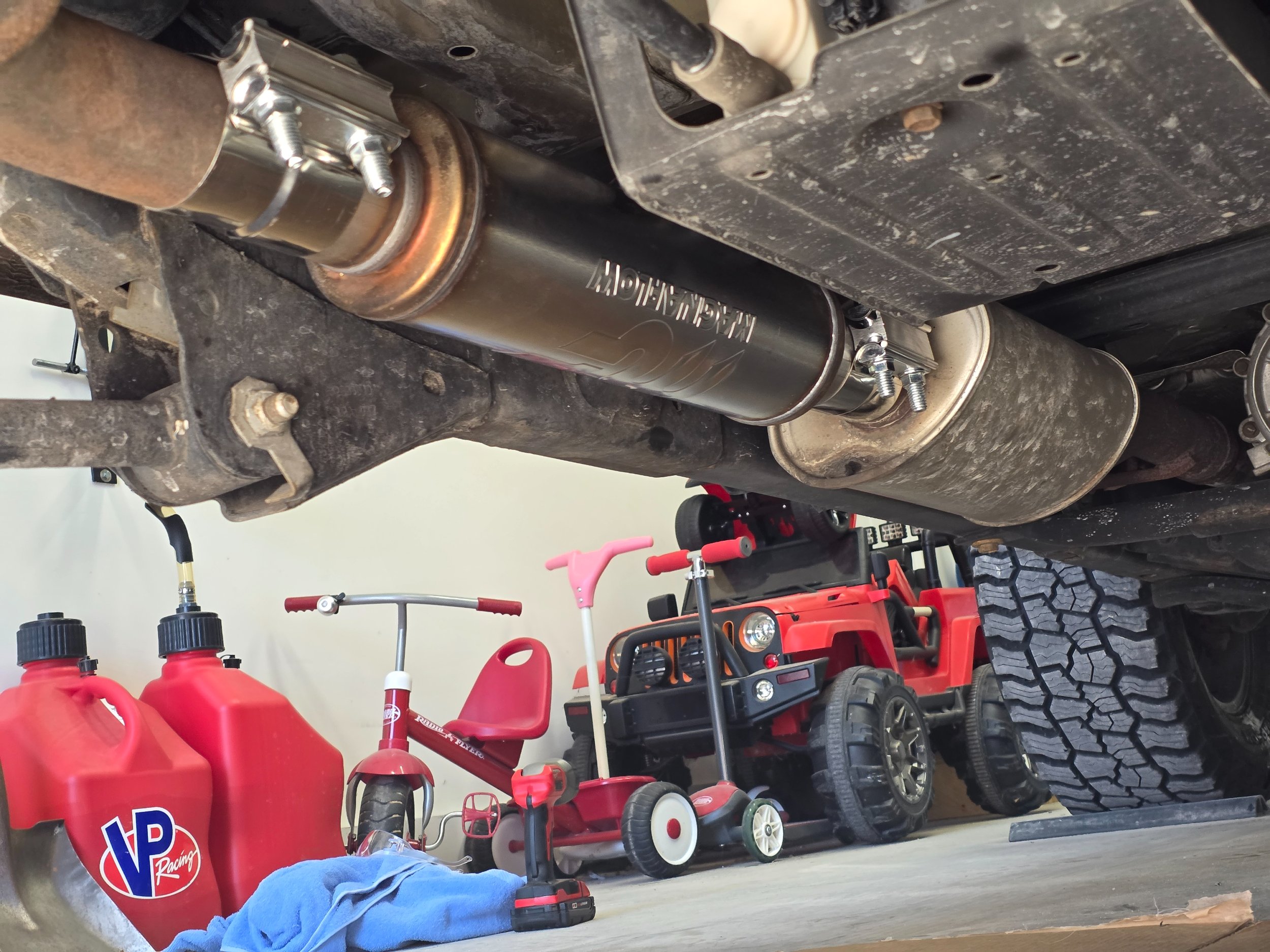

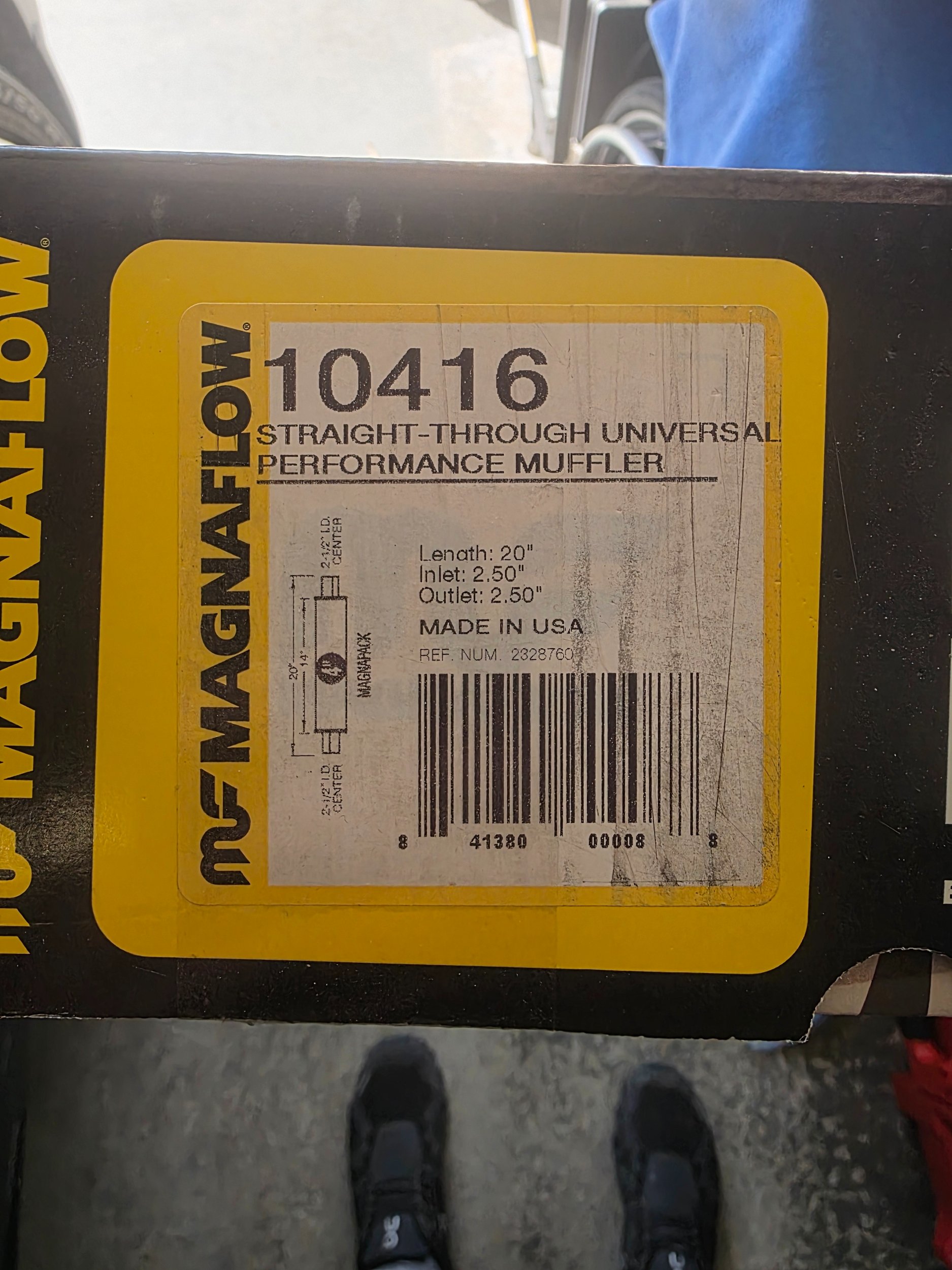

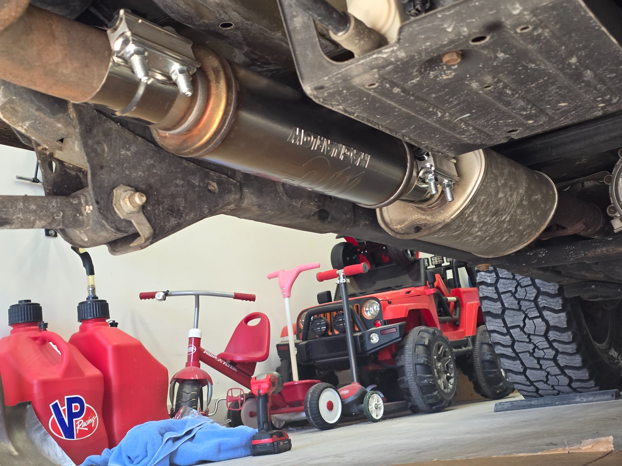

Mine lost and rebalanced weight. I ditched the large, heavy, and plugged up OEM muffler last week. I've driving it this week with just the resonator and it was too loud for me. I wound up installing a 4" round Magnaflow straight through muffler today. It sounds really good. When I removed the OEM muffler, I noticed a quick jump in fuel mileage. My only contribution to that was that it was the original muffler and it was clogged after 220k miles. Tomorrow, if I get a chance, it will lose a bit more weight by removing the heat shield.
Have a sound file you can post with the Magnaflow installed??

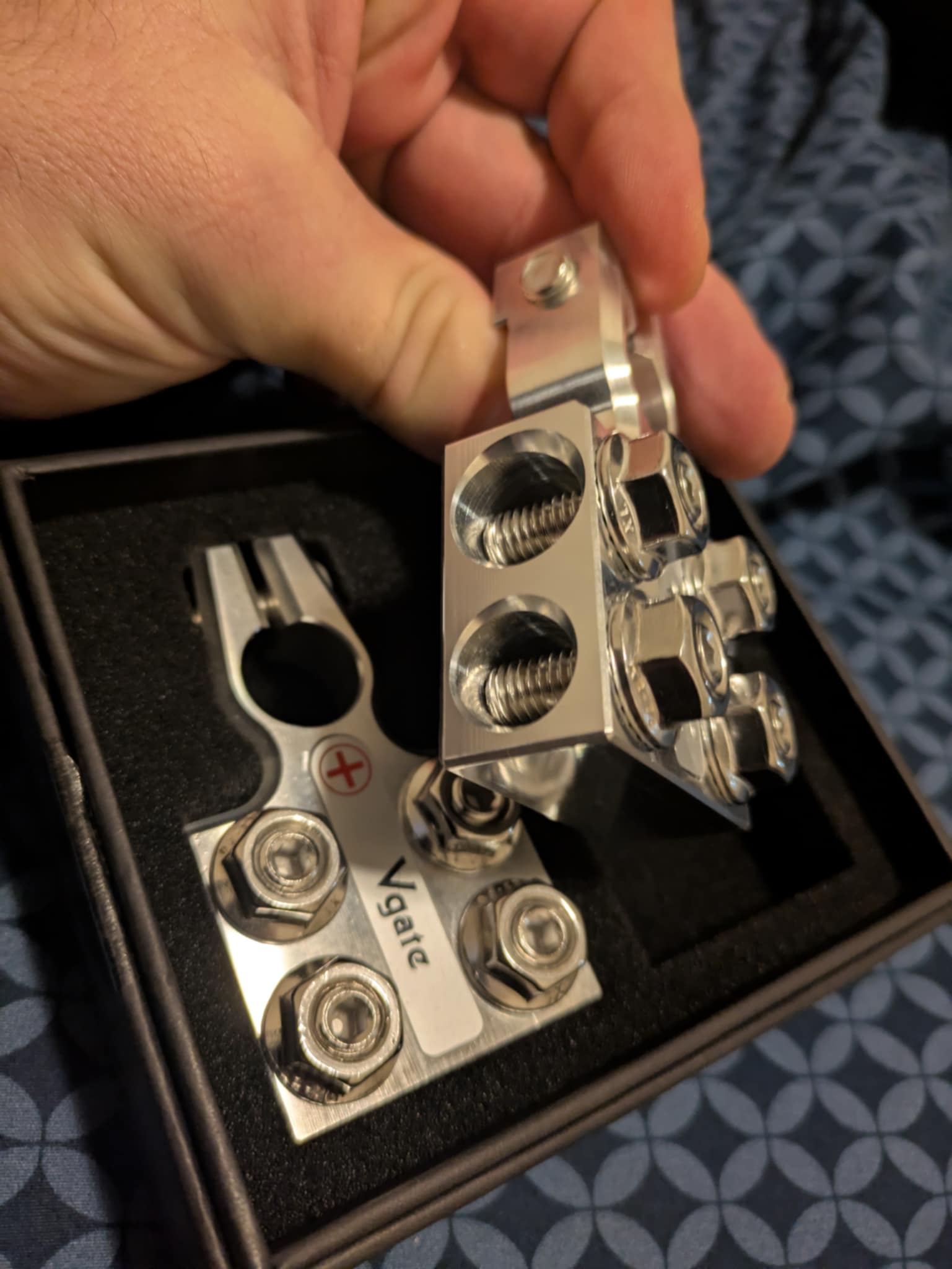

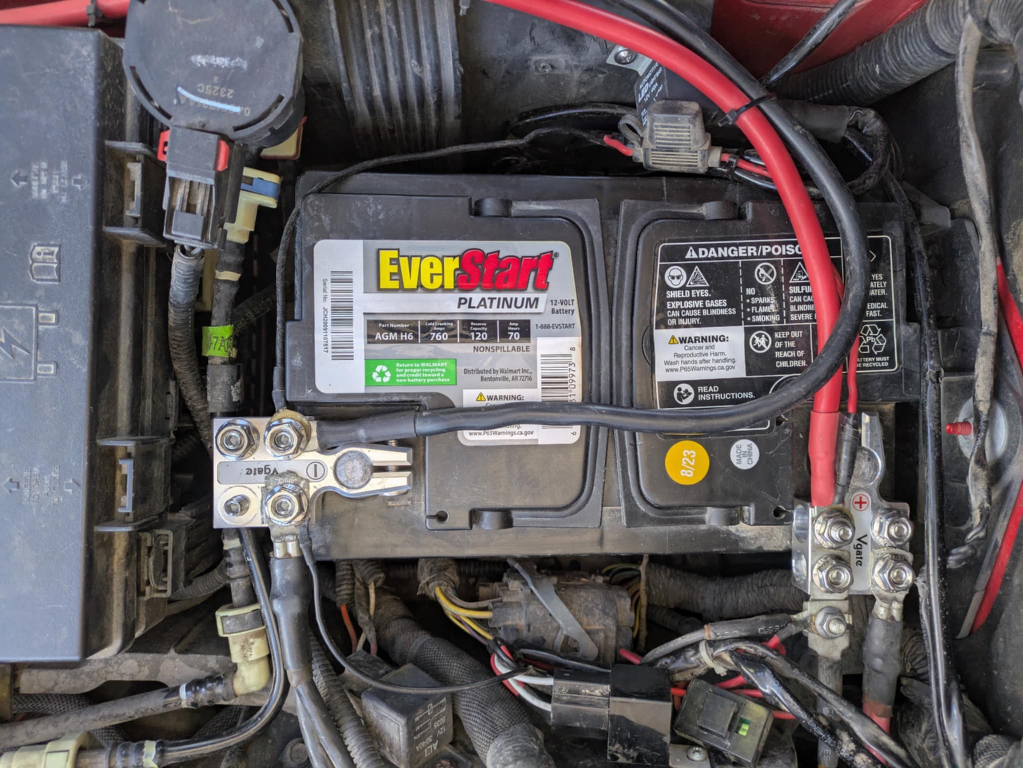

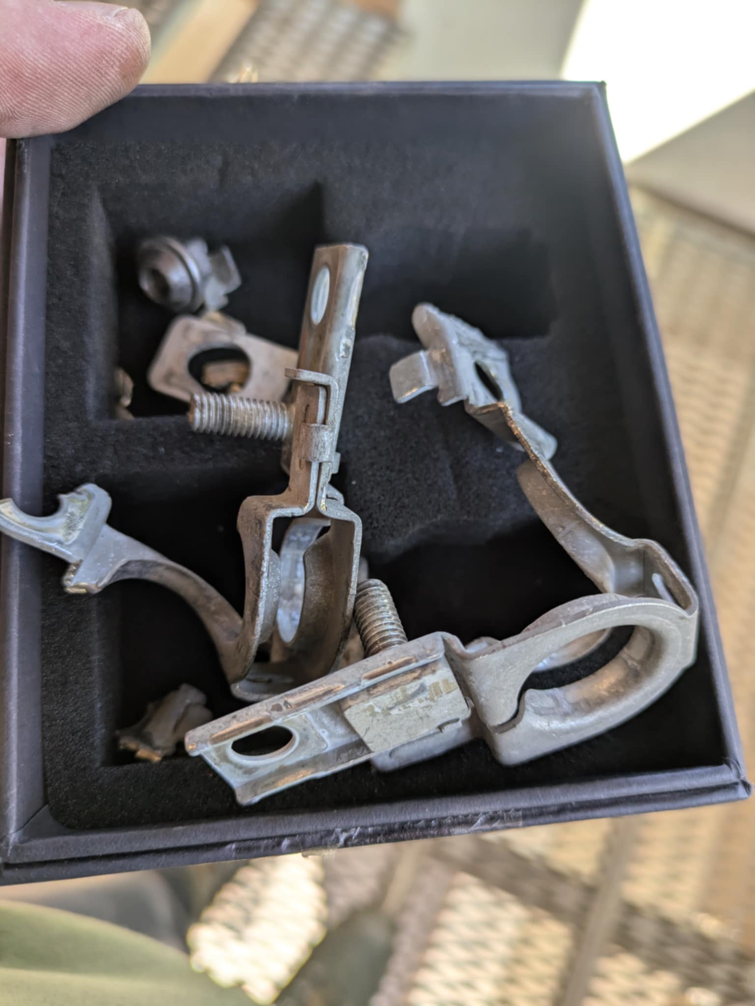

Nothing exciting but I've been putting it off forever. These crusty old battery terminals have been giving me hell for 2 years and I decided they had to go.
What an upgrade over OEM style.
The only complaint would be the allen key to tighten the new terminals is on the wrong side on the negative terminal and had to be rotated to mount into the recessed style battery post.
I cut allen key down to fit in the little opening. It would be nice if it screwed in on the other side.

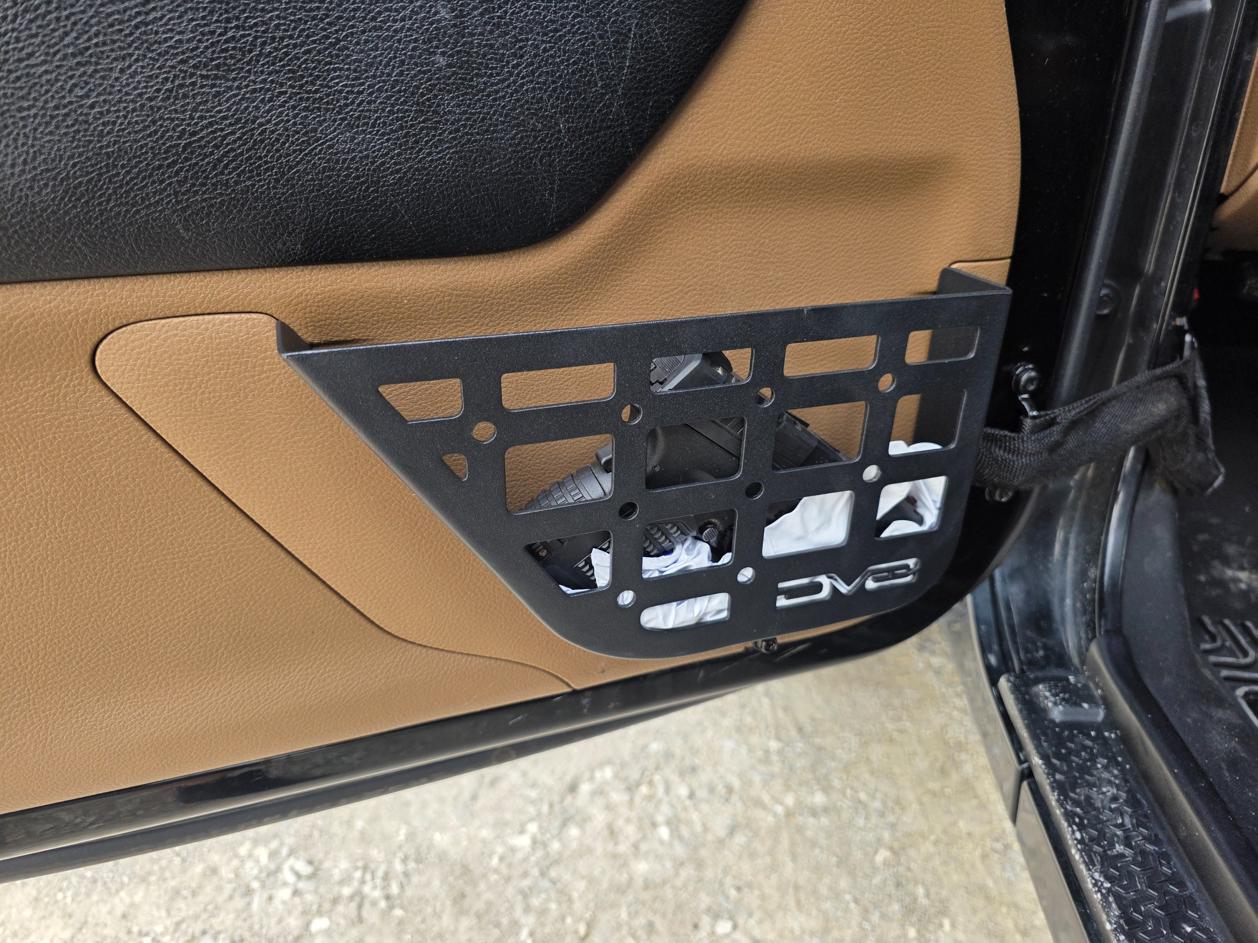

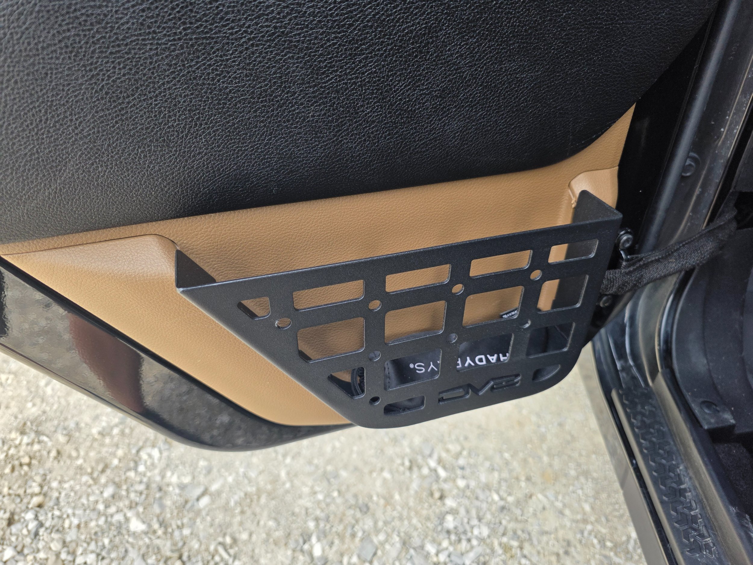

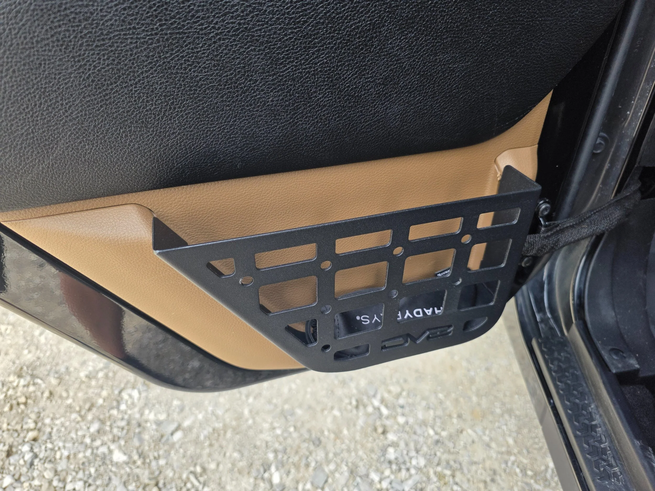

Installed the DV8 door pockets inplace of the cheap Amazon ones. These are much sturdier and mount much better. Now I need to find a good holster for my pew pew that will mount to the molle panel.

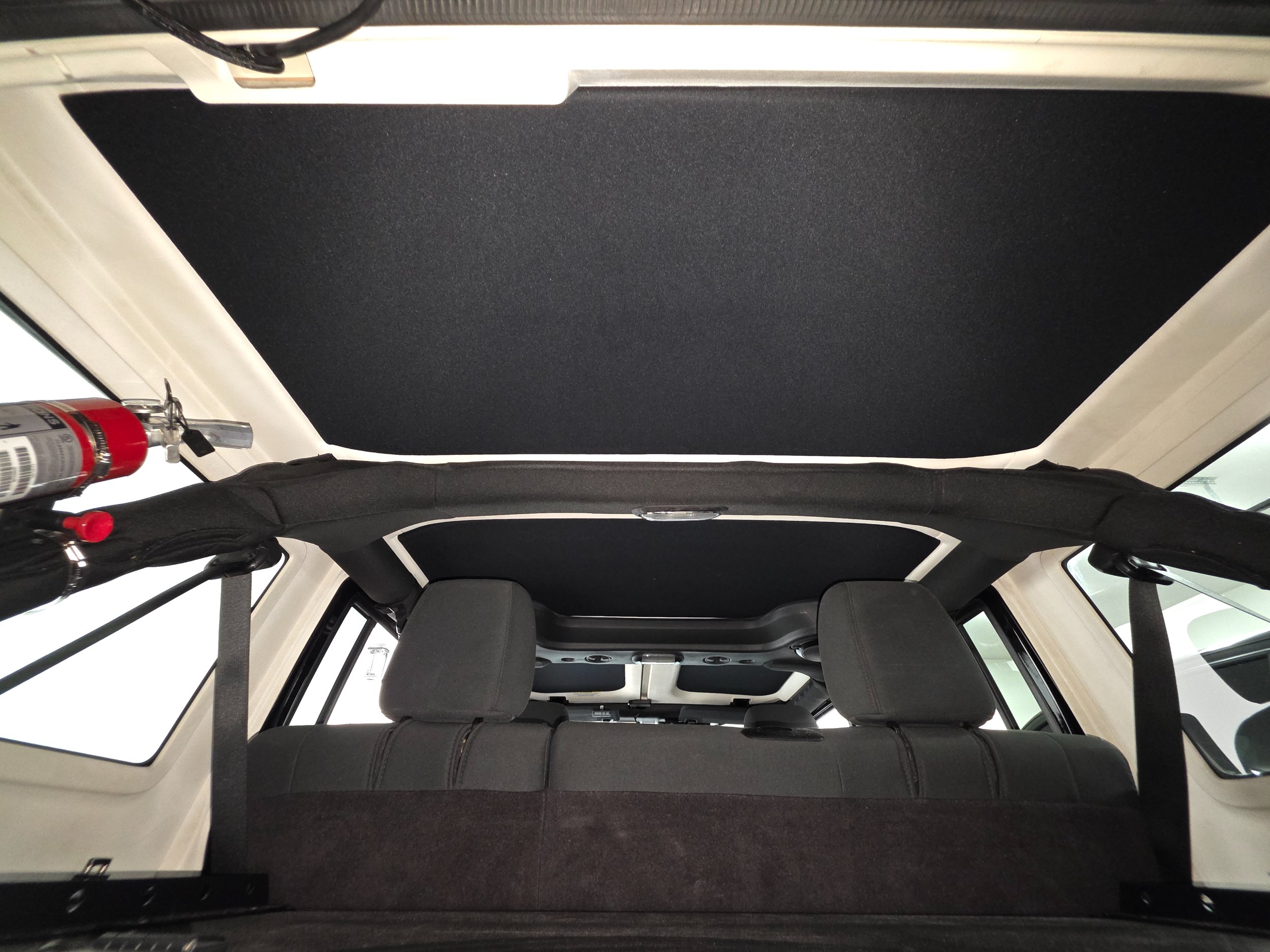

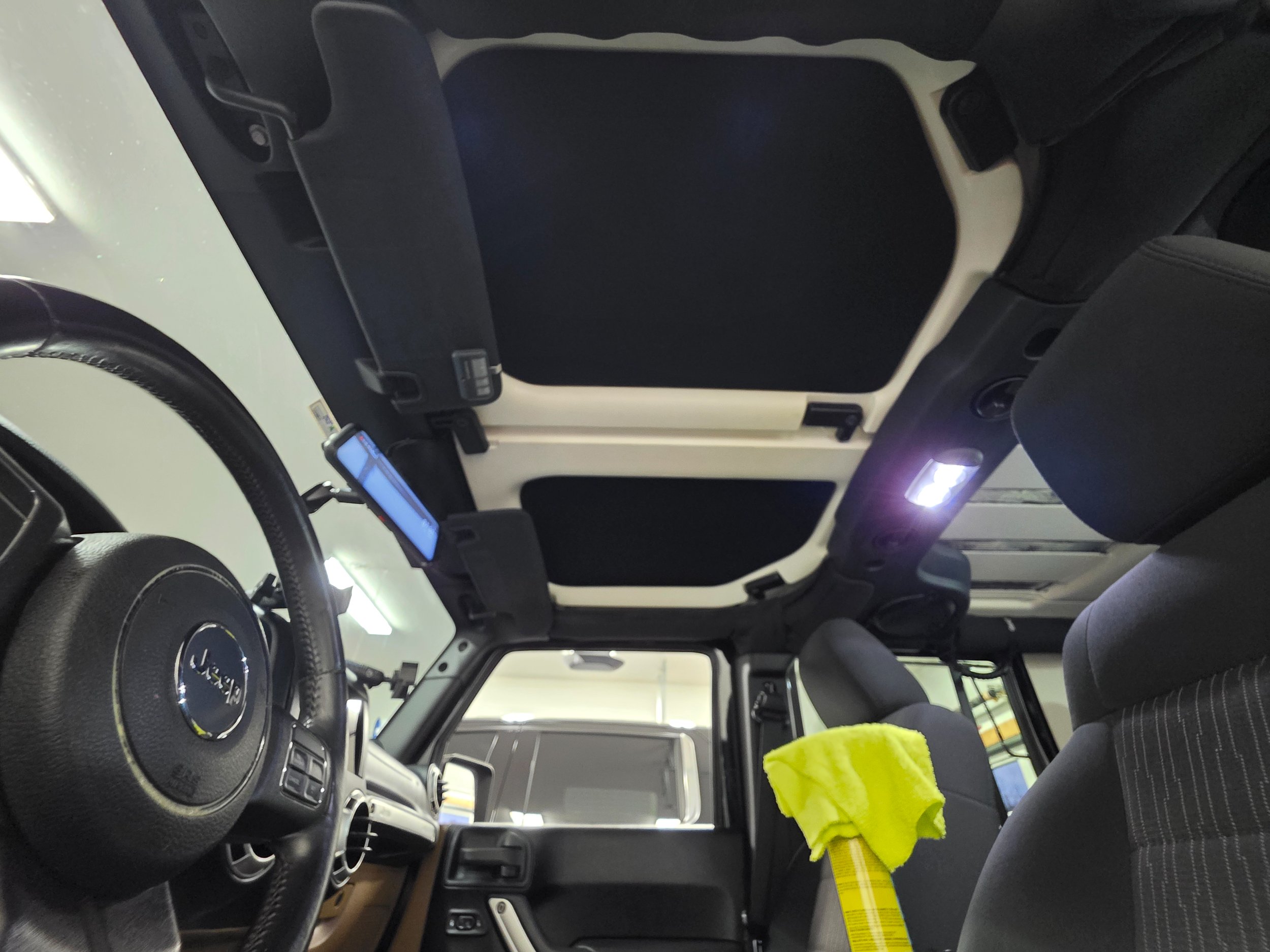

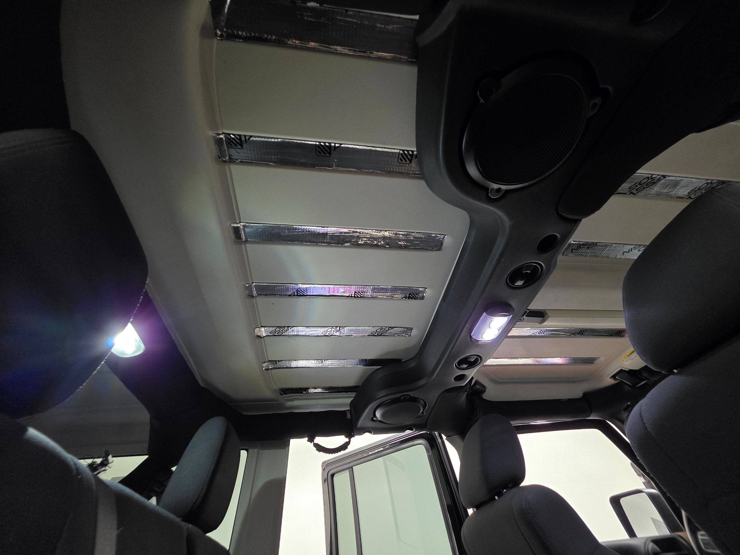

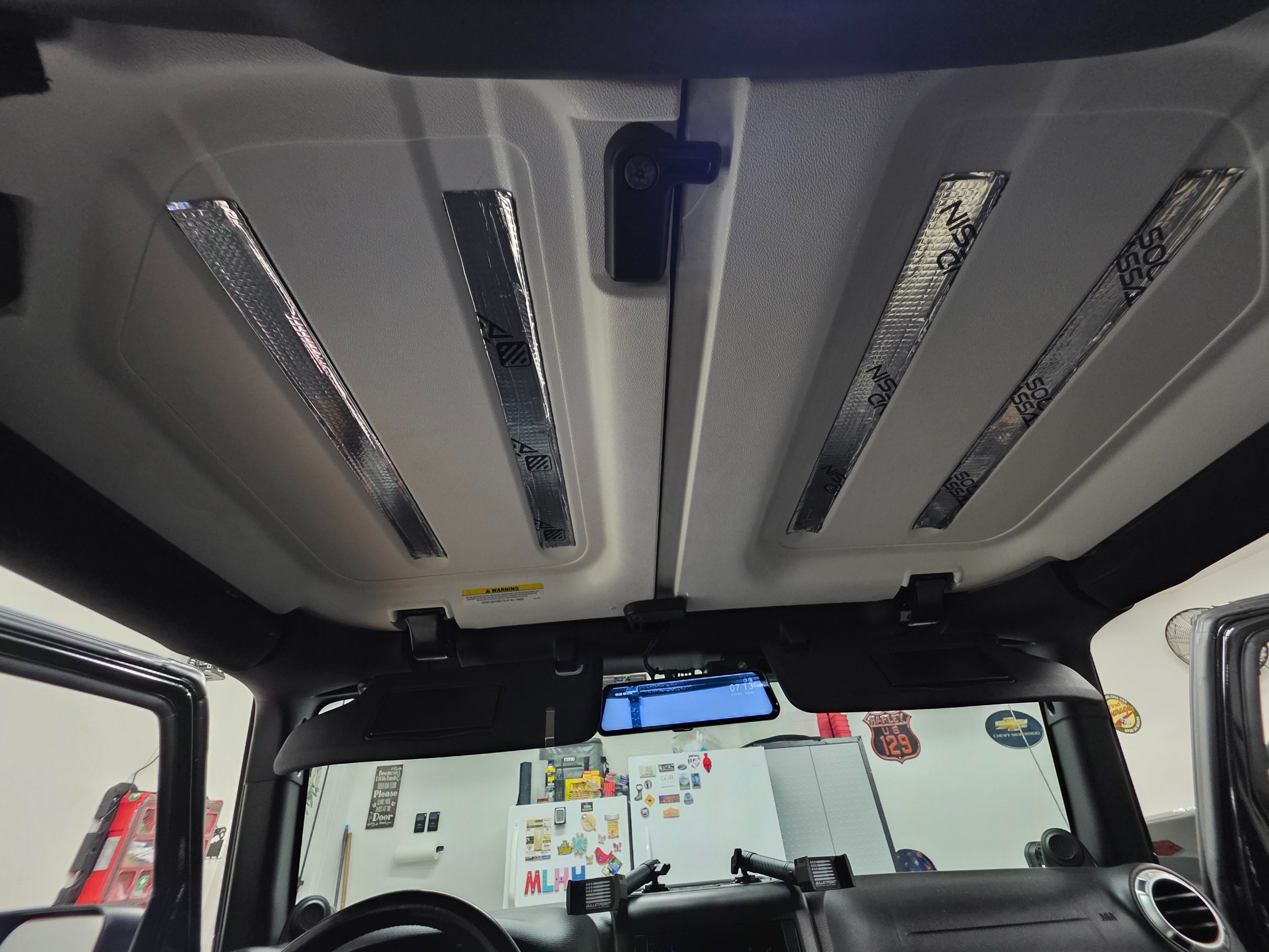

Installed the Hot Heads headliner and their sound deadening strips. The install was very easy. It only took me about an hour by myself from start to finish. Going to be interesting to see over the next couple of days how much improvement there is. I've got about 3-4 weeks before I pull the hard top and install the Bestop soft top.

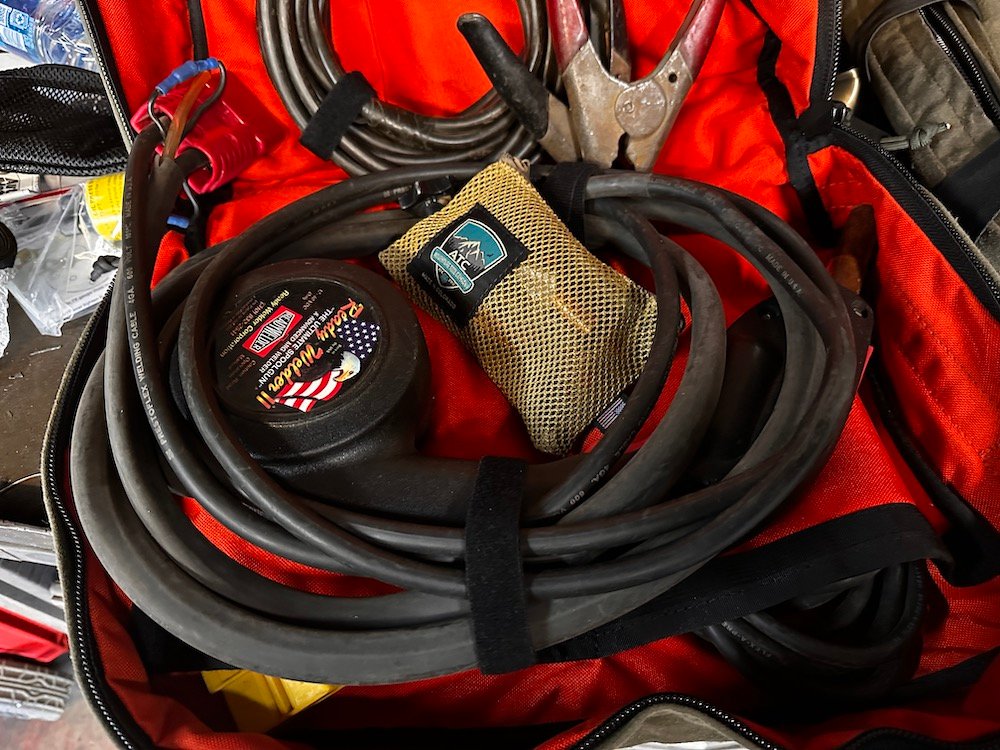

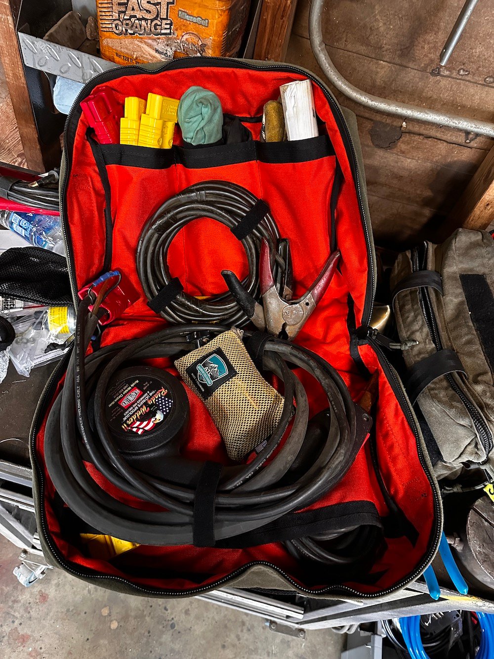

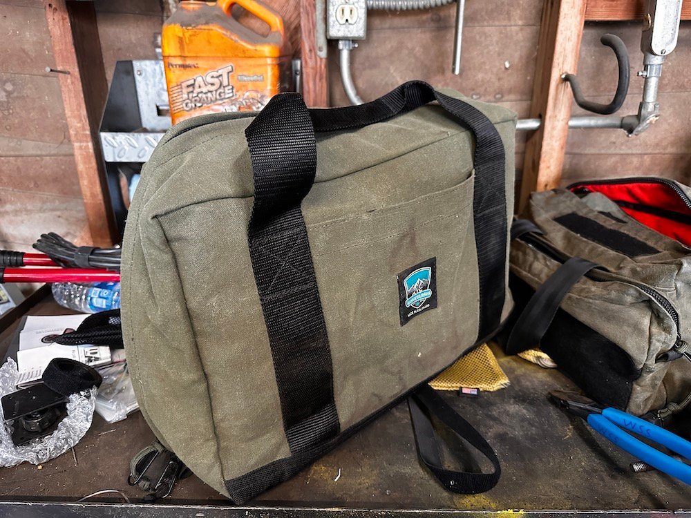

I fixed my last dtc code Friday! P2096, bank 1 on a hemi is different from the oe engine. Once I figured that out, bingo. 5 o2 sensors later (don't ask why 5). My plan with this rig is to do one "essential" and one "optional" project at a time. So now the essential dtc problem is fixed, I fixed up my readywelder kit. I transferred the gun itself and all the hook up stuff to a new ATC recovery bag. This kit has been on three Jeeps so far. I used anderson connectors to jump two 12v batts to make 24v. The issue on this Jeep is the second battery is in the rear now. But my jumper cables have anderson connectors on them (i had a anderson quick connect on the front bumper of my CJ and TJ). The combo lets me reach from the fornt to rear without much loss of length.
In the kit are gloves, mask, auto darkening goggles, spare consumables, 8' anderson extension, jumper cable kit, mag ground, arm sleeves, welding hat, manual and 24v adaptor/connector.
Very cool! Have you had to use the Readywelder out in the wild yet??
@WSS do you just use flux core with that or carry a gas supply? Ever tried aluminum? Thx!
I use flux core in particular Lincoln NR-211 in .030". Never tried aluminum, but it is a "spool gun". I have a miller spoolgun but no welder to power it. I have 4) dimenion 652's and 1) XMT 456, none of them are capable of running my spoolgun. I had big dreams of learning aluminum mig.
I have used it twice on the trail, once for a tie rod end and once for a shock mount, neither on my rigs. I like having that kind of stuff for some odd reason. The ReadyWelder can weld 1/2" plate easy enough with .035" and 3/8 with .030" double or triple pass. 1/4 like butter and looks good too.

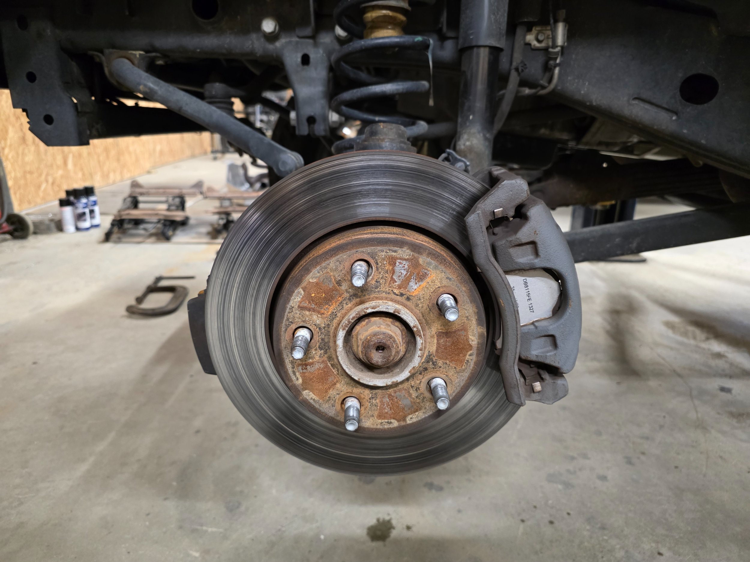

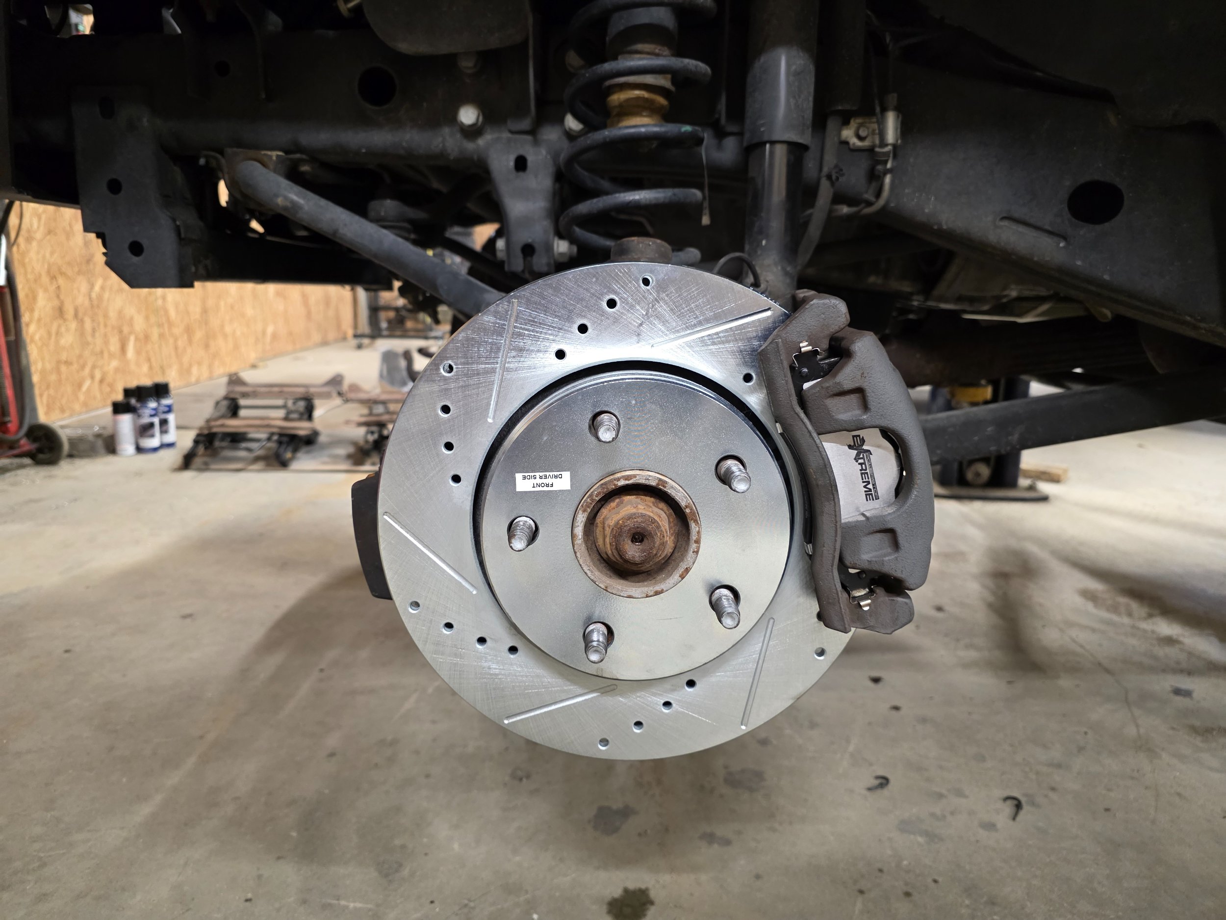

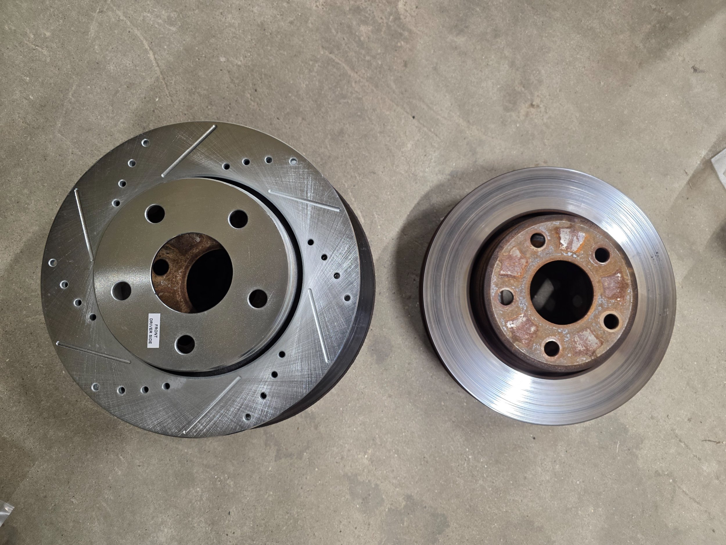

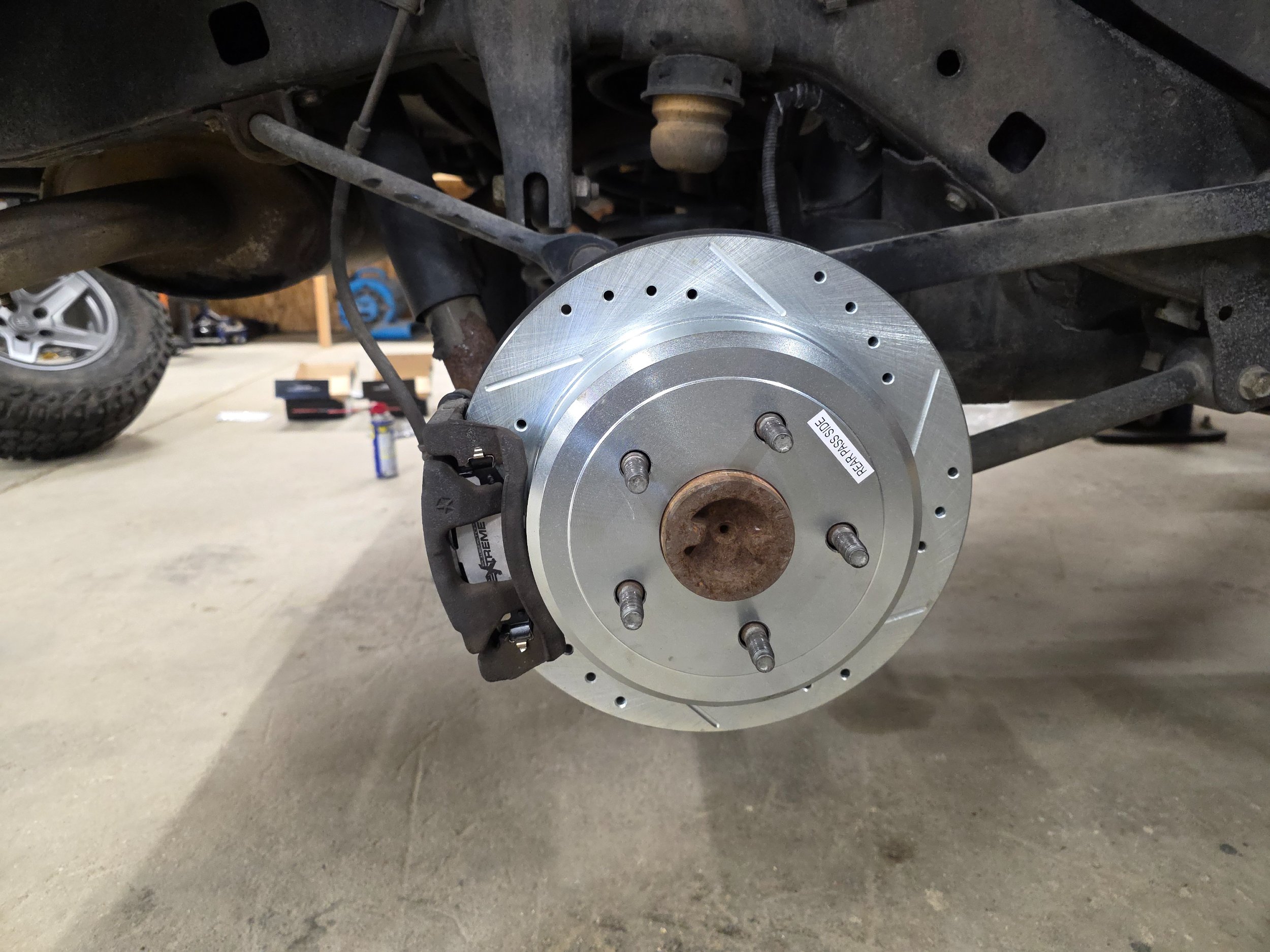

I changed the oil, rotated the tires, and installed the Power Stop Z36 pad/rotors. I'm trying out the Valvoline Restore & Protect 5w30 oil to see how it does on my 3.6 with 220k miles. I plan on changing the filter in 1k and 3k miles and then change the oil & filter again at 5k miles. I've read some really good reviews and studies on this oil. I really like the video Lake Speed Jr. did on it.
I've had great luck out of the Z36 brake kit on my TJ with 37's. I figured that if I was changing brakes, might as well try them on the JK. The picture of the rotors make it look like the big brake kit, but it is not.
I’ve got the same brake kit
Really happy with them

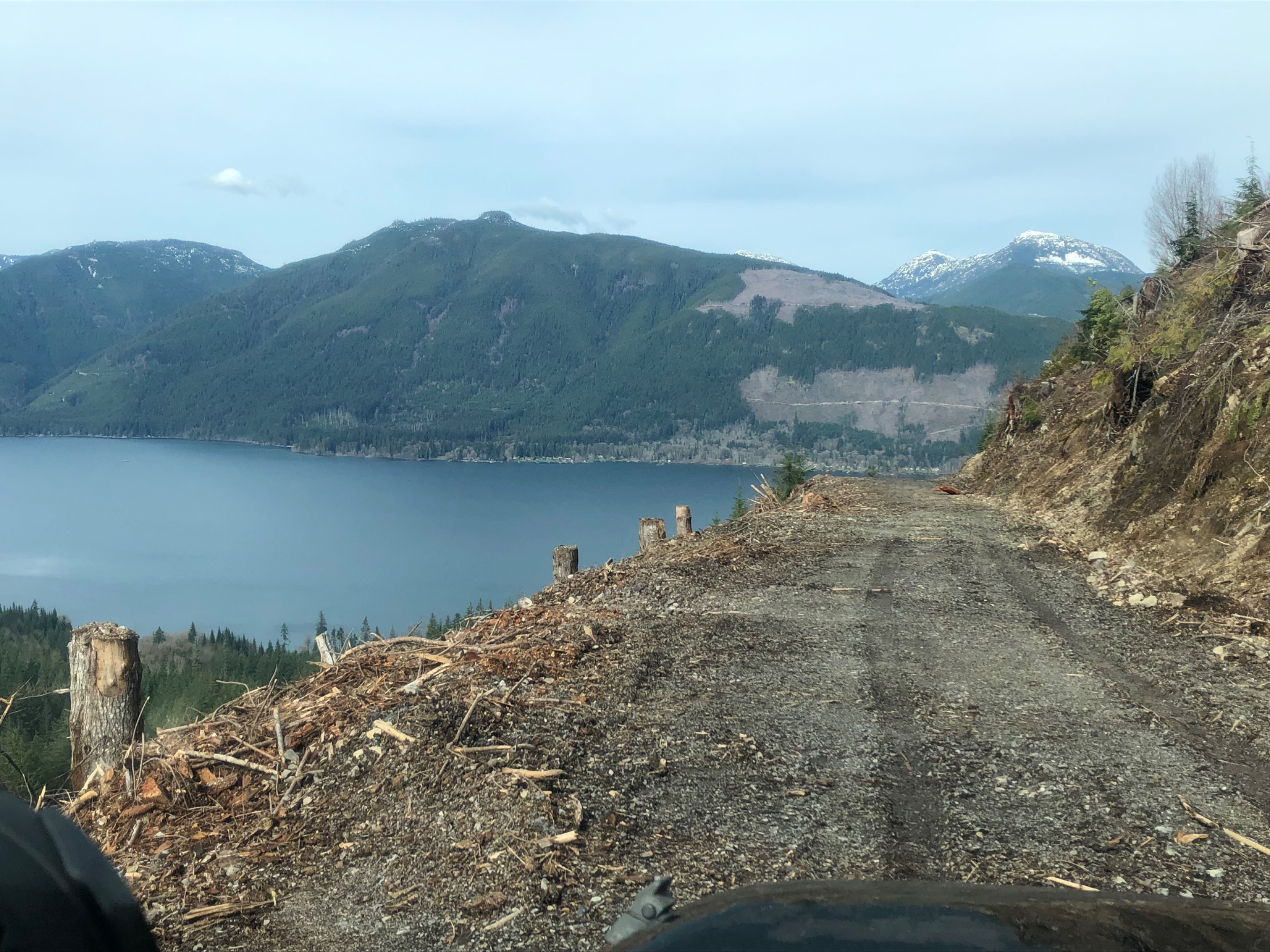

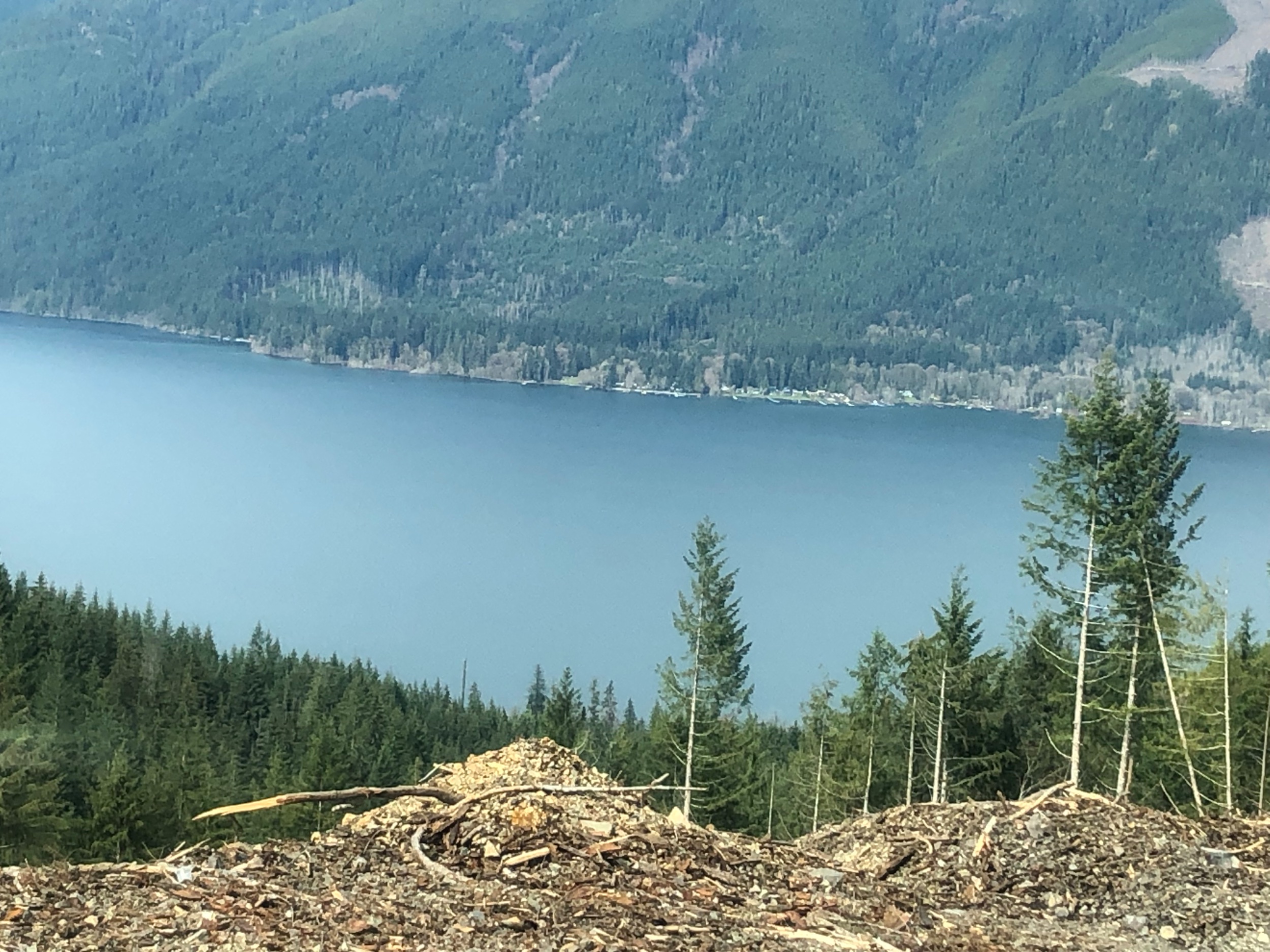

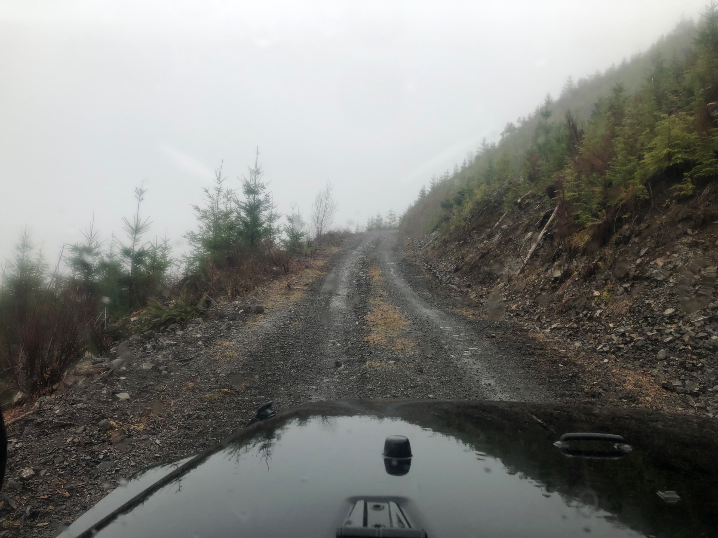

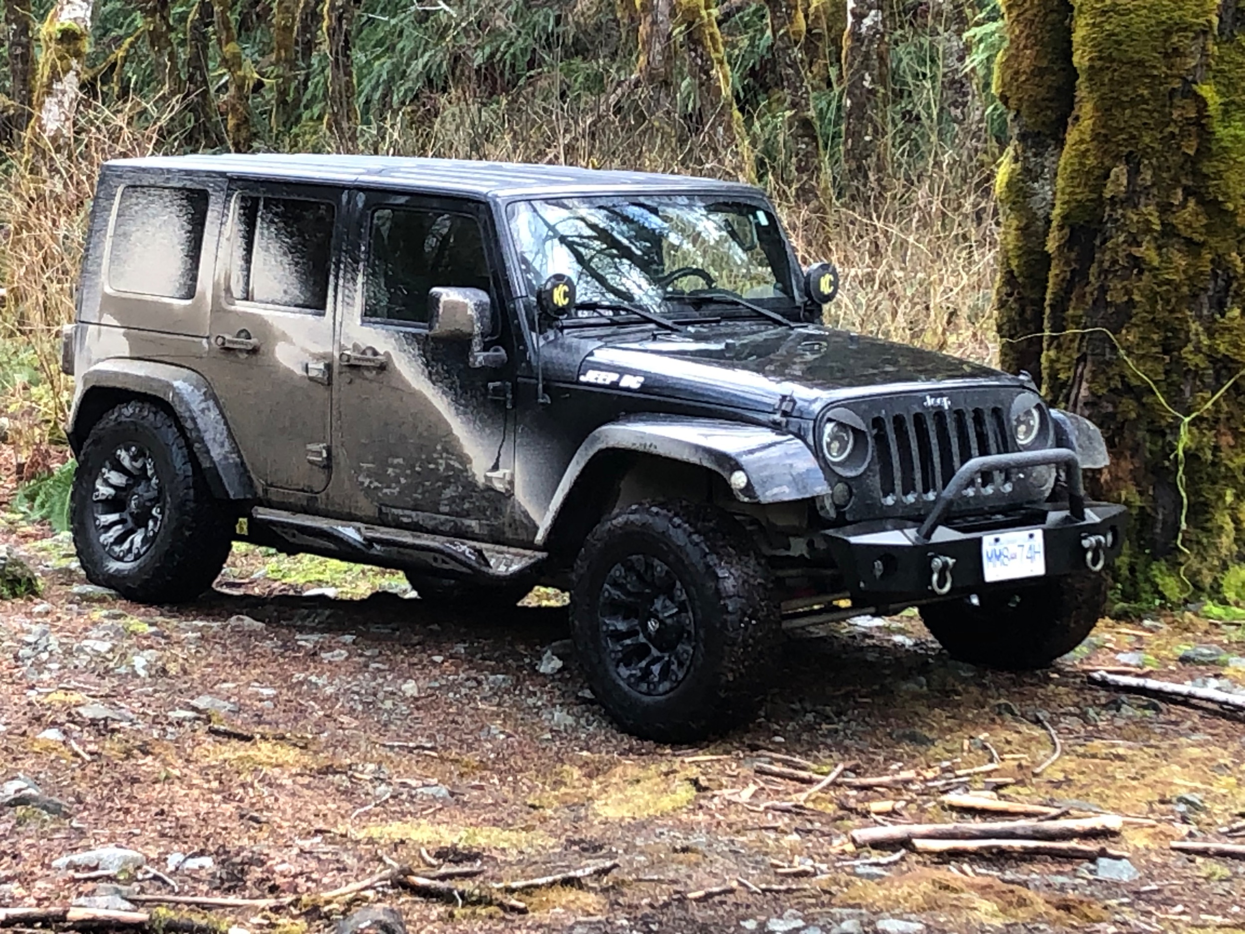

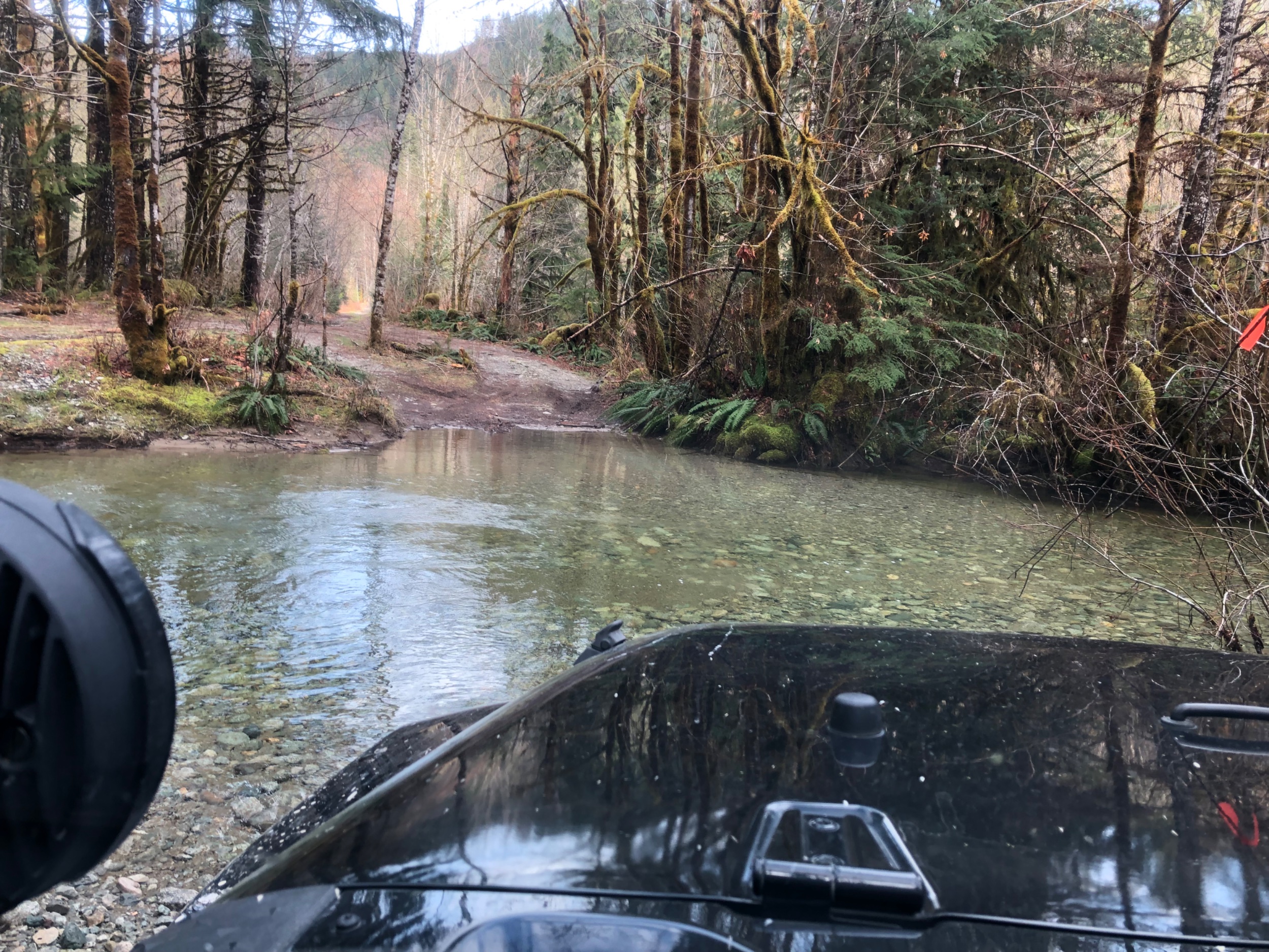

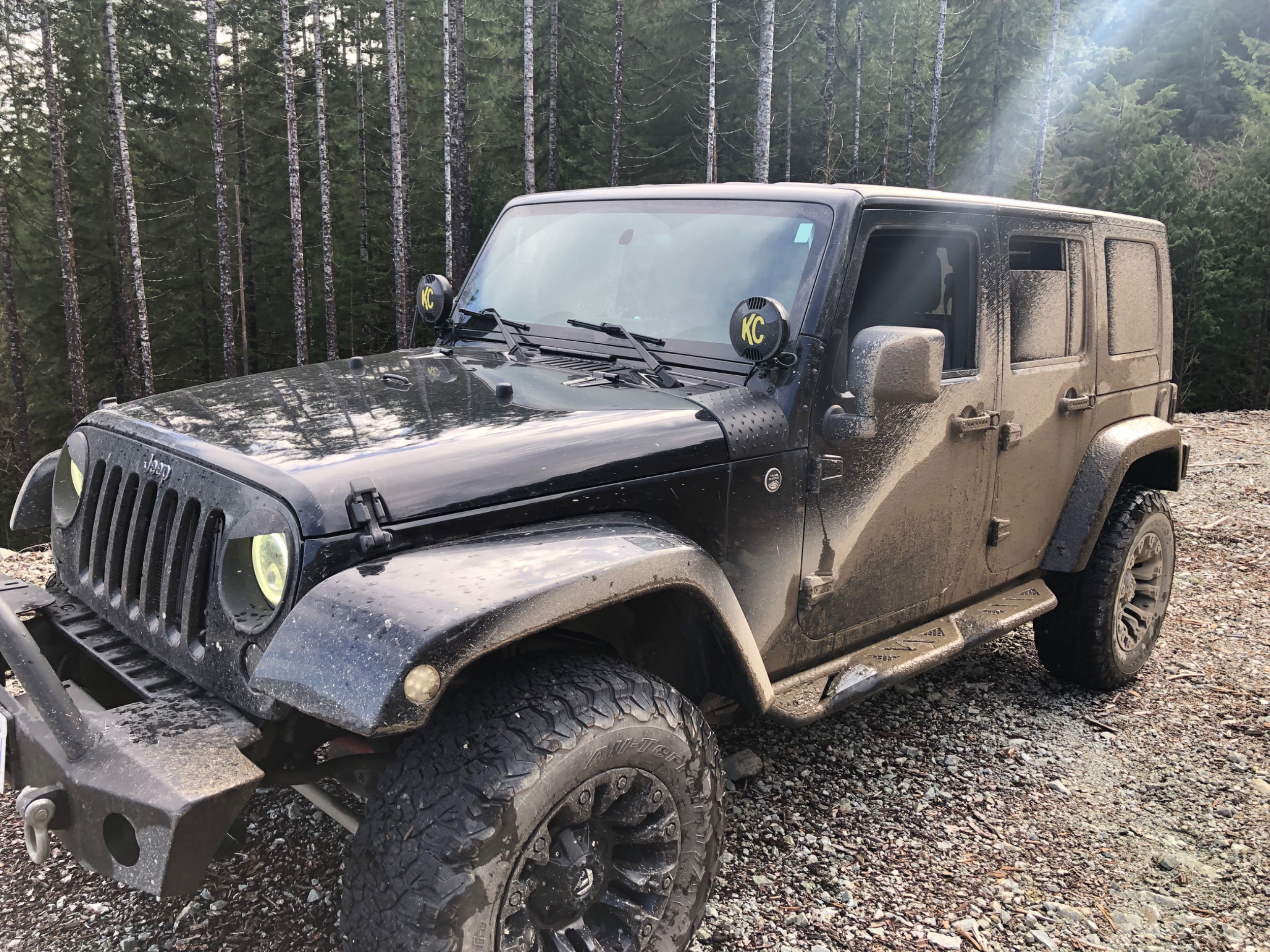

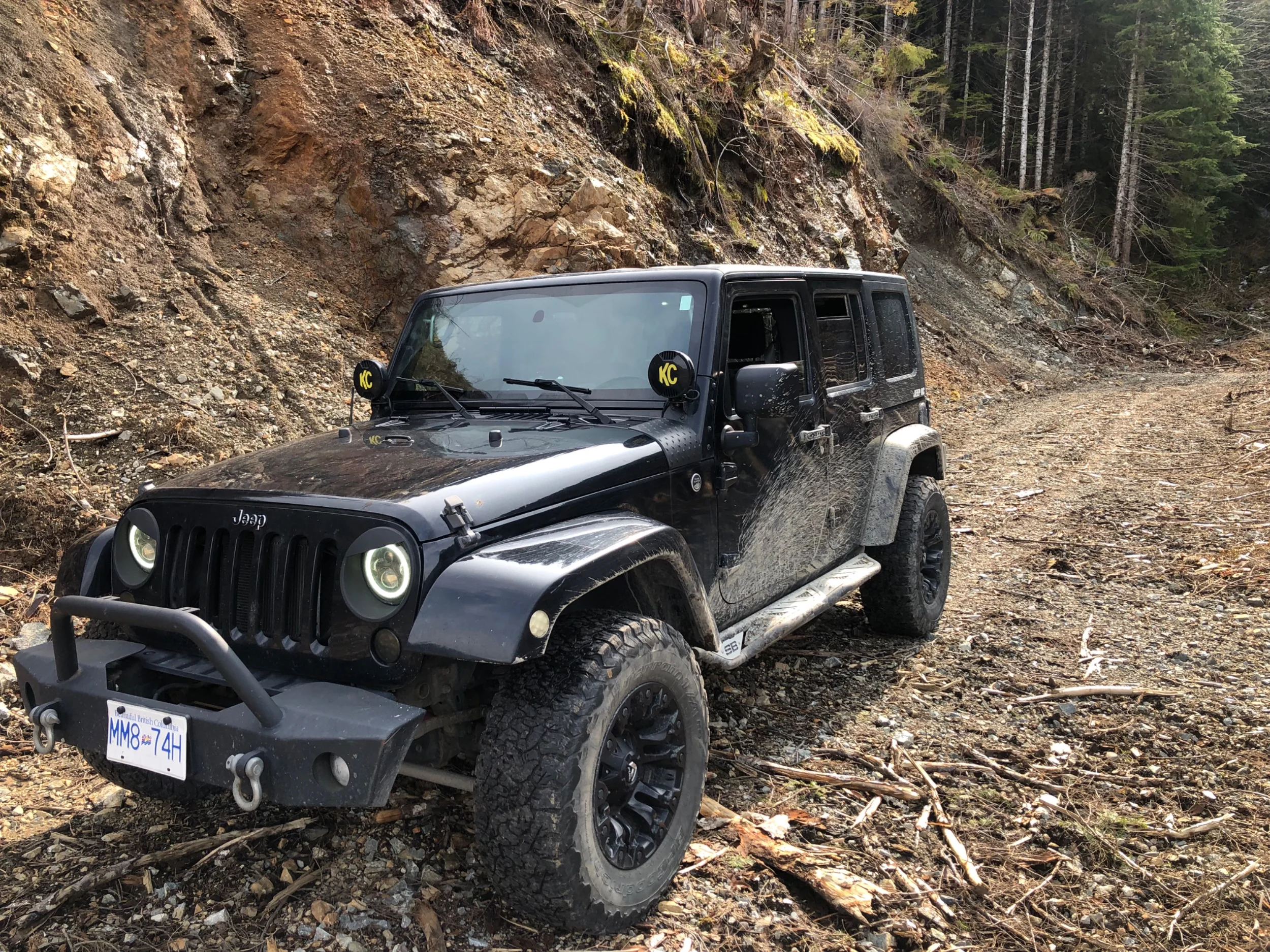

Been renovating the living & dining room in my spare time so haven’t been on a trail since end of Dec .
It was awesome to get bk on the trails this past weekend .
Did my deepest water crossing , up to the bottom of doors . Northern Lake Cowichan , Vancouver Island , BC .
Changed oil first.
