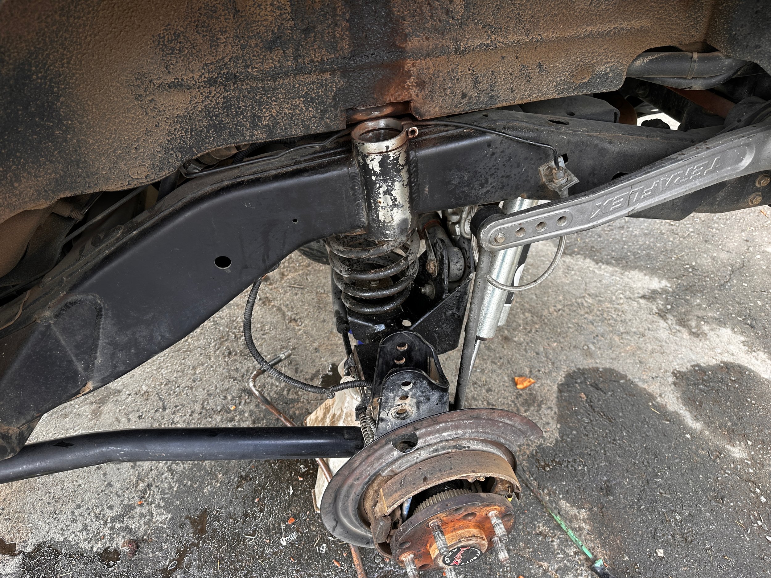

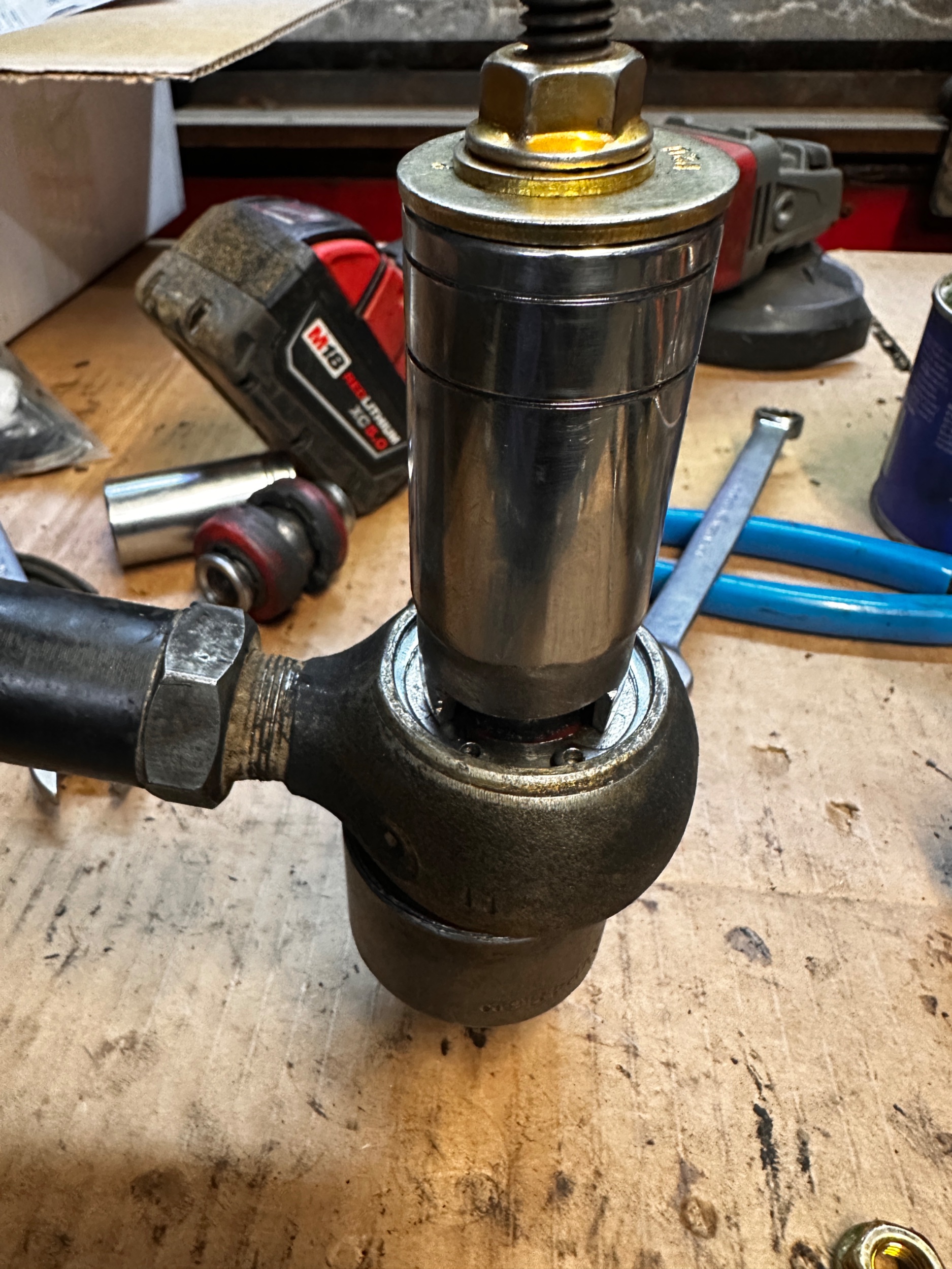

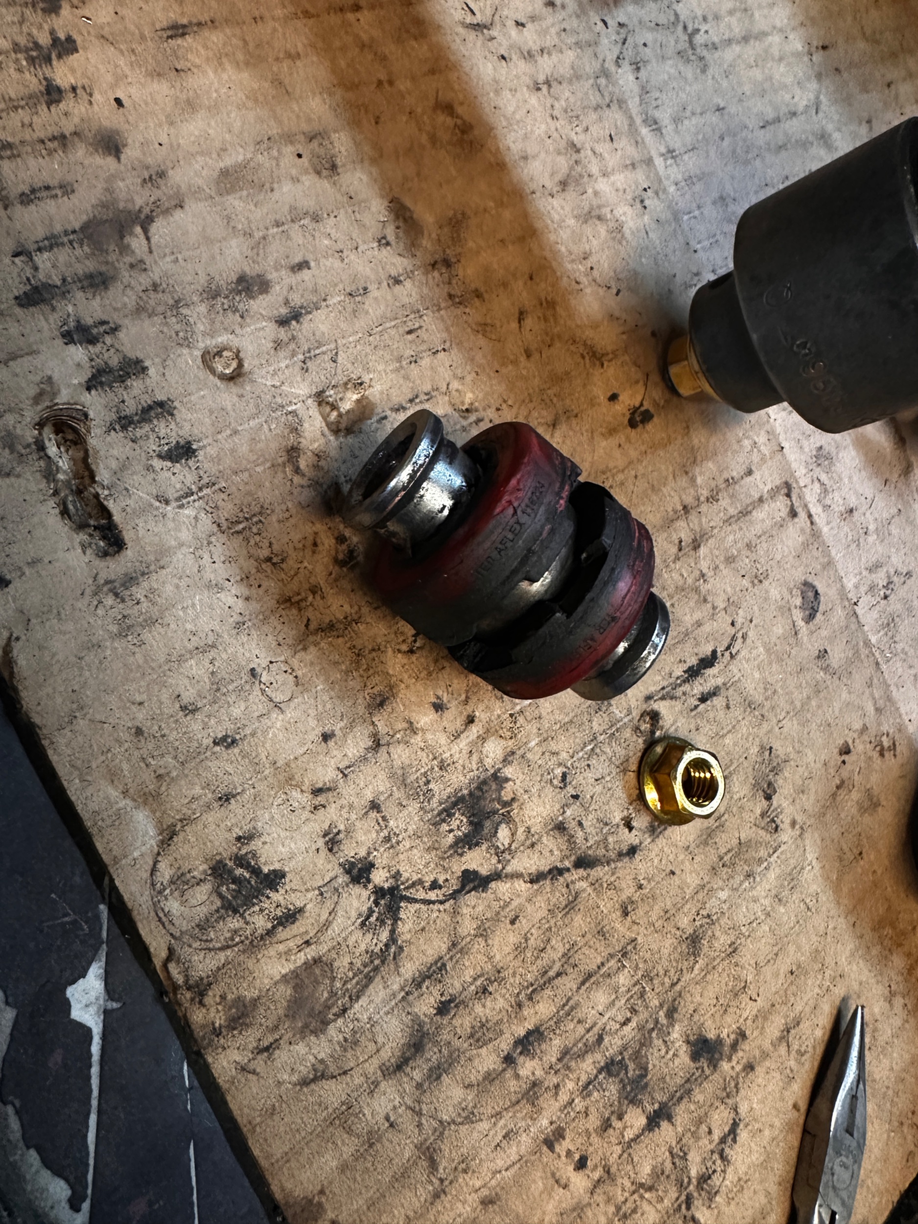

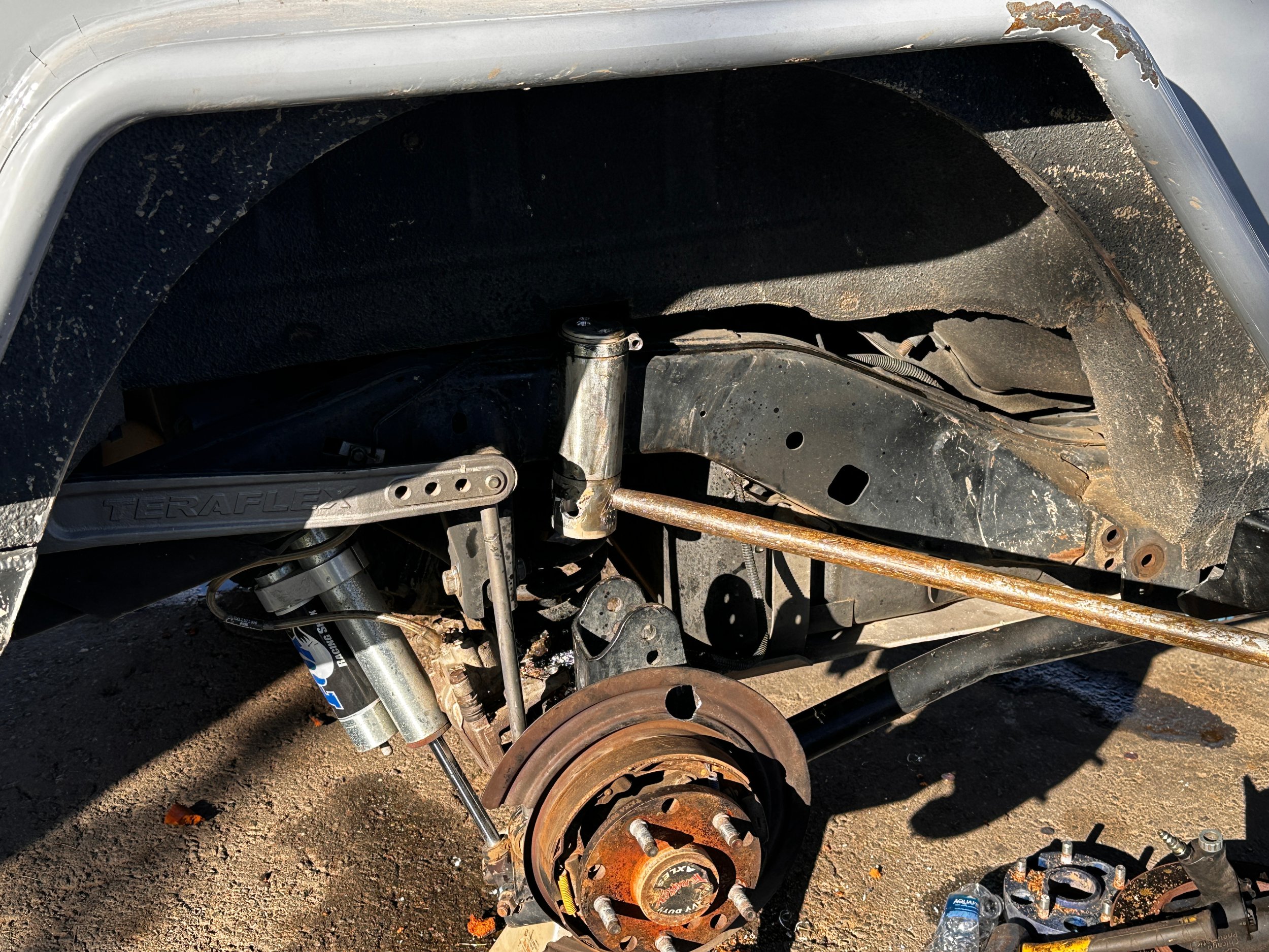

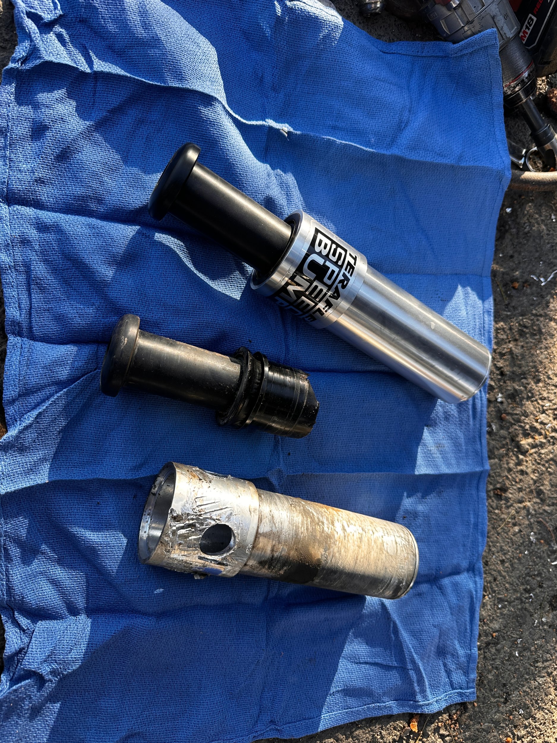

Started an arm joint rebuild on the rear upper arms. Pretty worn out. No grease was getting into the ball and bushings. It’s a Teraflex long arm set up. Had to make my own bushing compressor.
The saga continues.....

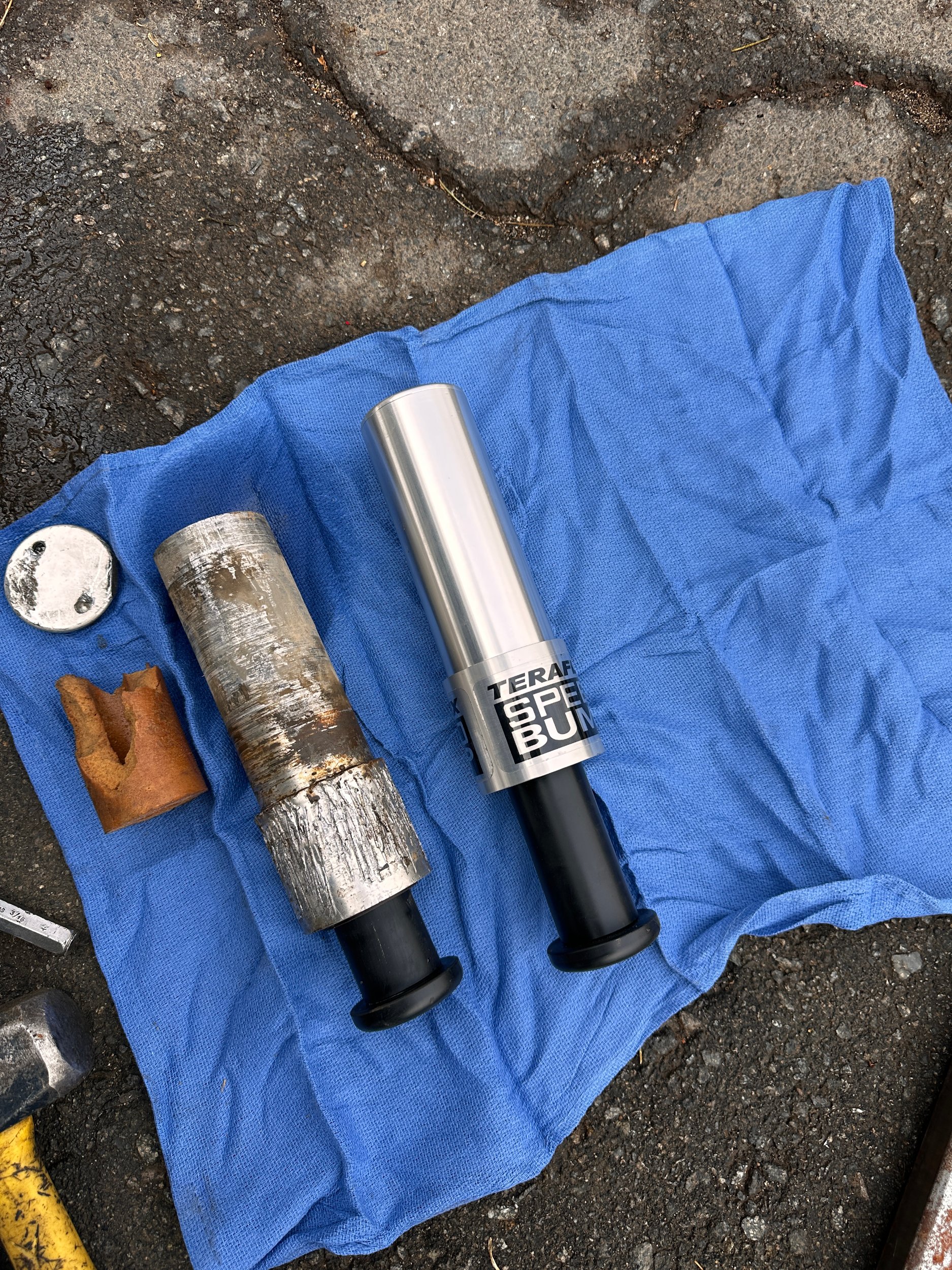

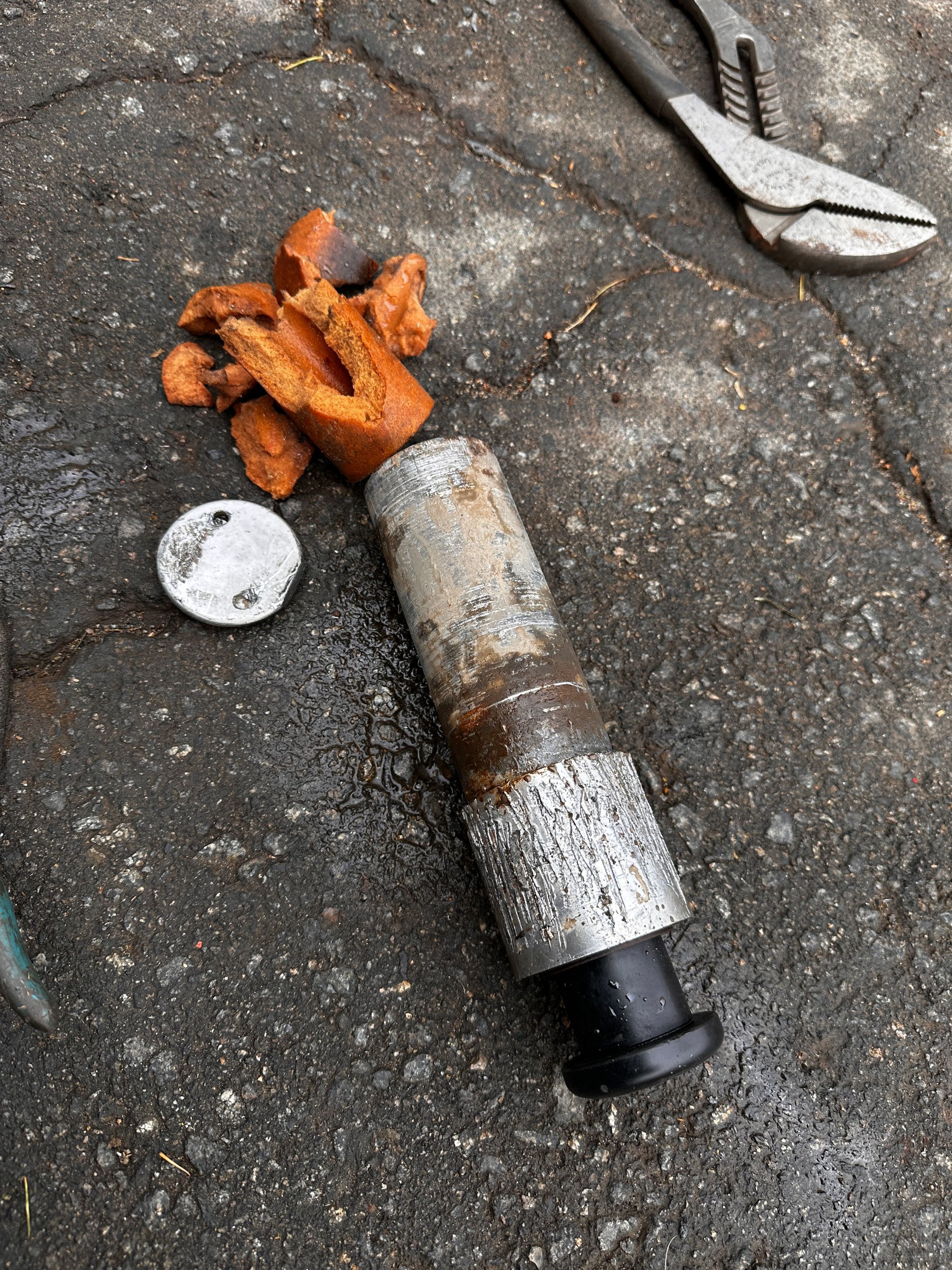

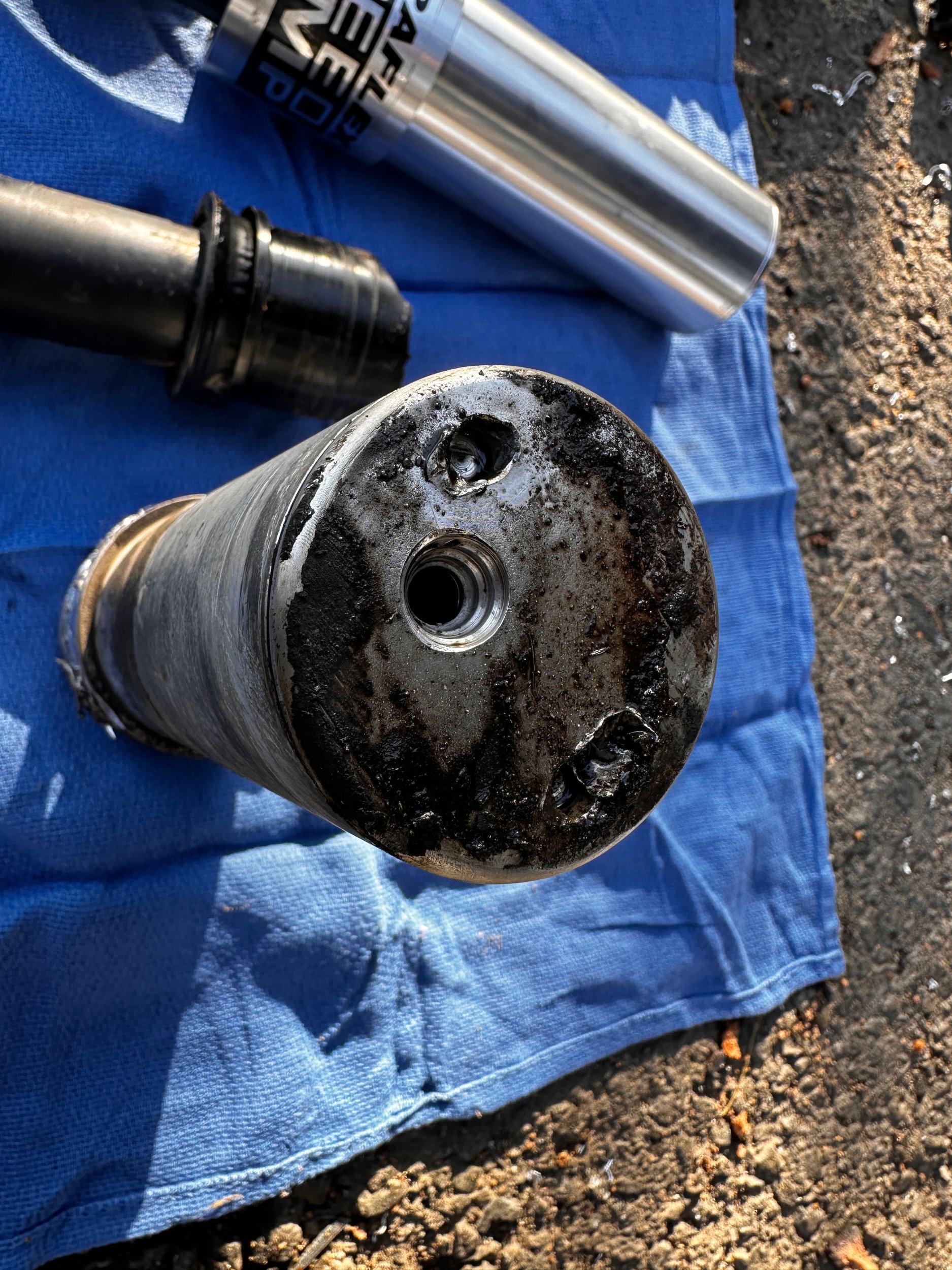

The bumpstops are corroded/rusted in. I did prevail though
EDIT: Passenger side was even better. The bottom popped off and the pipe wrench collapsed it enough that it stopped moving, the top cap locked up too, that was were I put cold water to shrink it. Had to drill 1" holes across the bottom and use a 4' pry bar to move it back and forth. Puppy's were really froze up.

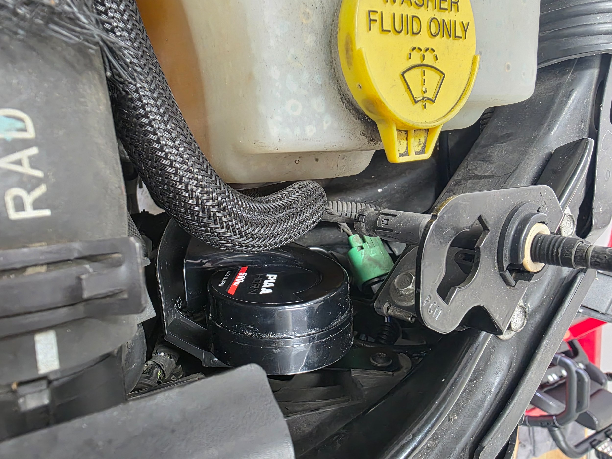

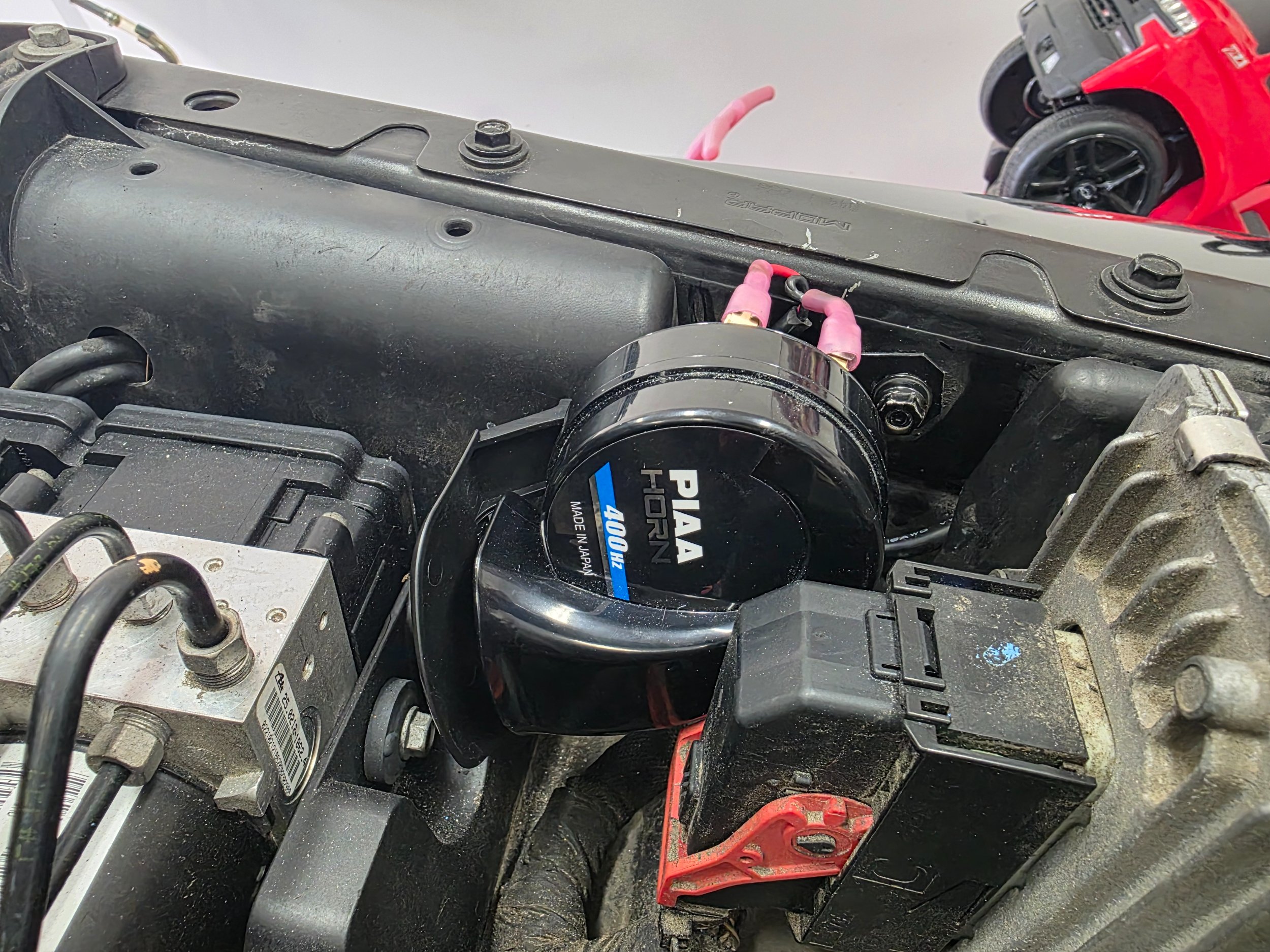

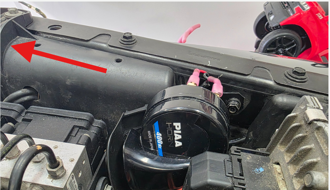

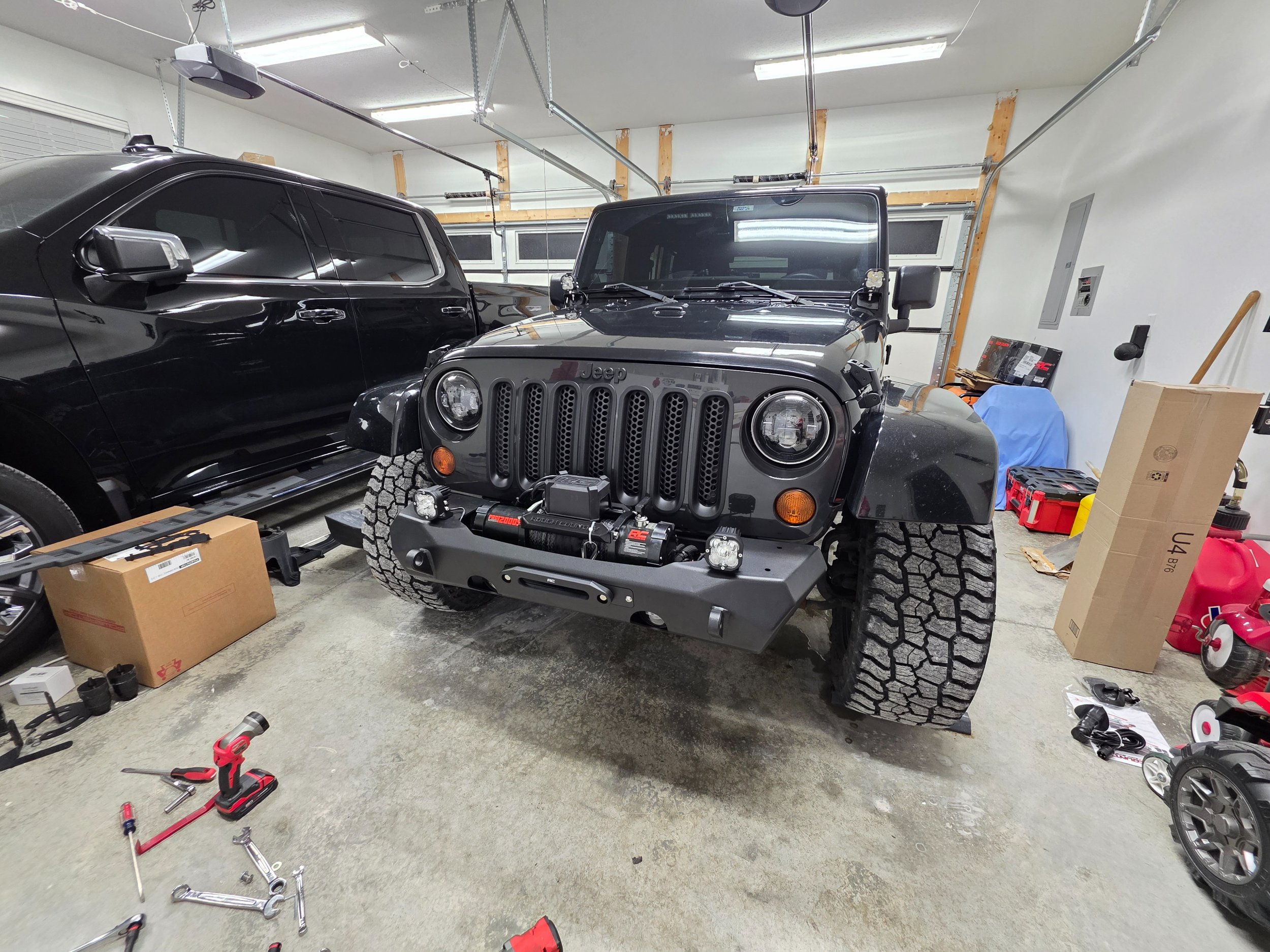

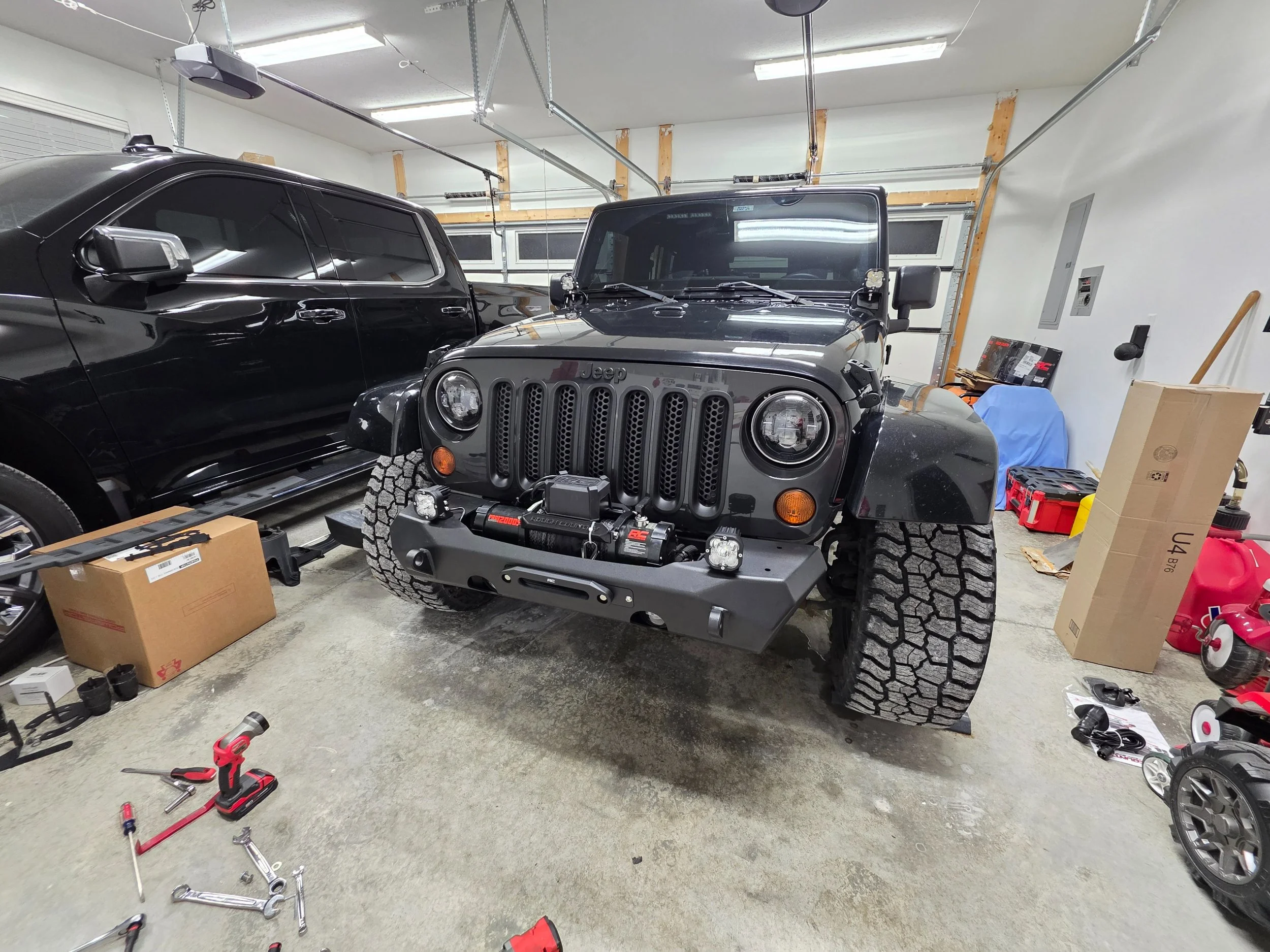

Swapped the wimpy factory horn for the PIAA 85110 dual tone set up. The second horn wouldn't fit in the same area as the OEM, so I moved it off to the side.
Reactions: JeepJeezy
Your JK doesn't have a second horn mounted on the fender near the firewall?
No and in my research for a good replacement, everything I saw only indicated the single horn behind the driver headlight.
It runs on the stock power / wires? I’ve heard some horns require a larger wire and more power.
It works fine on the stock wiring. The PIAA instructions just say to tap into the factory wiring to the other horn.

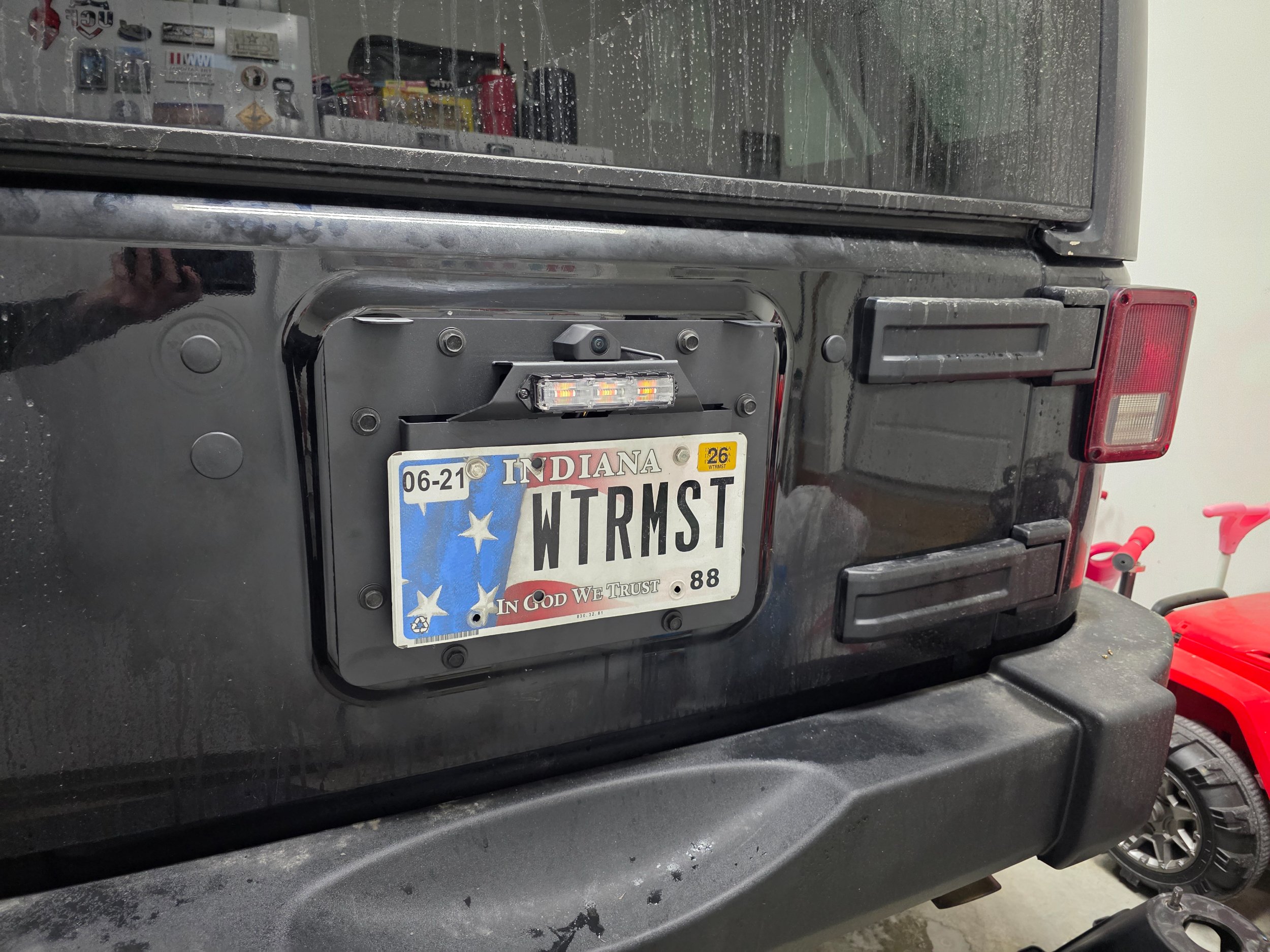

Deleted the spare tire mount. I'm using the Feniex Quad light as primarily the third brake light. When I turn on my POV response lights (VFD), the light will flash blue. The brake light will override the blue light, but when brake is released and the blue lights are active, it goes back to flashing blue.
Does that plate over the vent screw up the heating and A/c flow?
Reactions: mjonesjr84
It doesn't completely cover the vent. There is a 1/4" gap between the part the license plate sits on and the vent. It still functions as normal.
I did order a new Mopar vent because the rubber on mine is falling apart. I'll take a picture of how it is tomorrow when I take the plate off to put it on.
