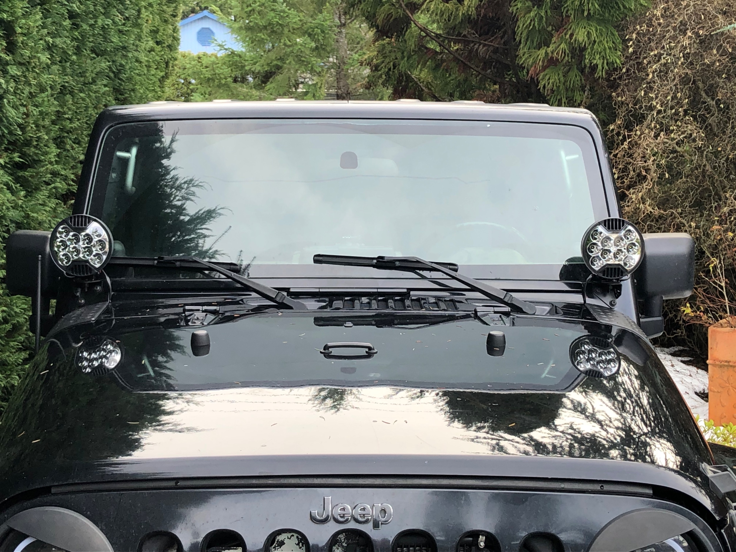

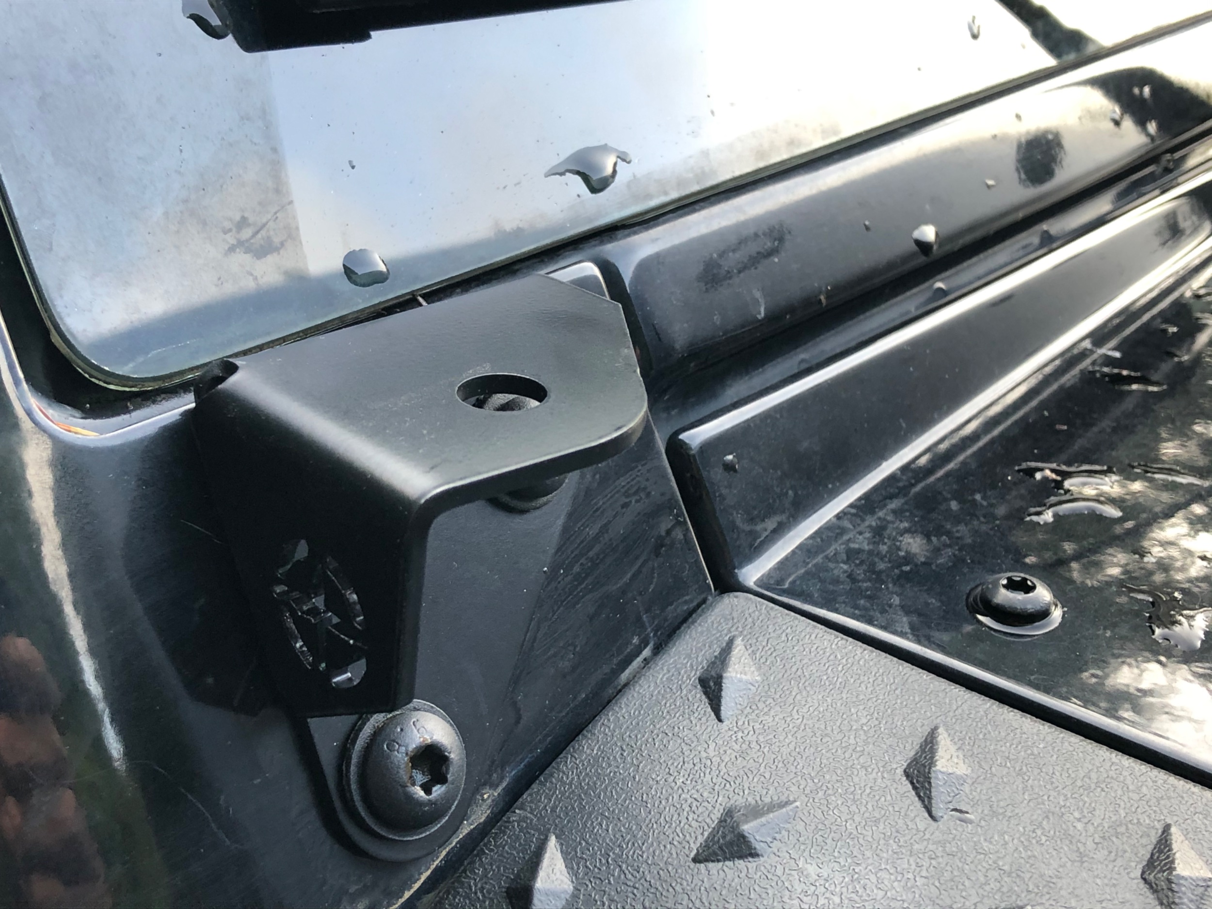

Installed my A-pillar lights. I'm not a huge fan of the brackets I got, so I'm on the hunt for different ones. You can see the front blue lights for the VFD.
I’ve got a set of EVO Manufacturing A Pillar light supports for my KC 100 LED Slim Lights . Very happy with the mounts . Got then off of eBay .

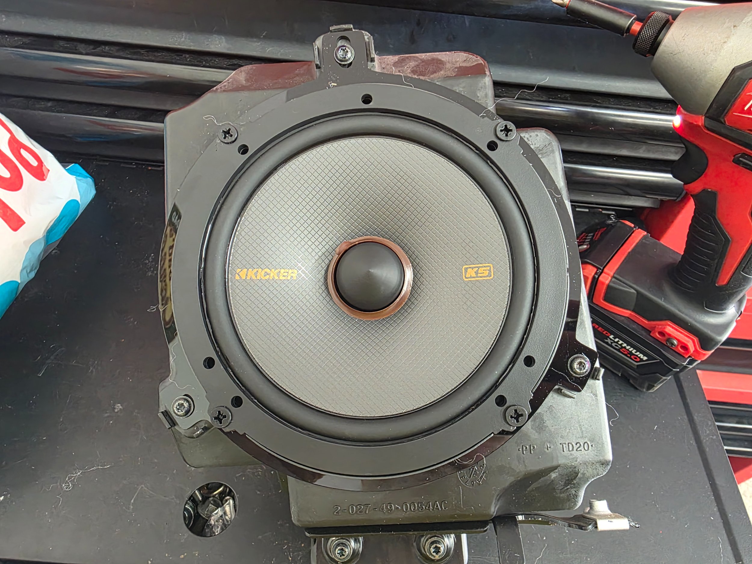

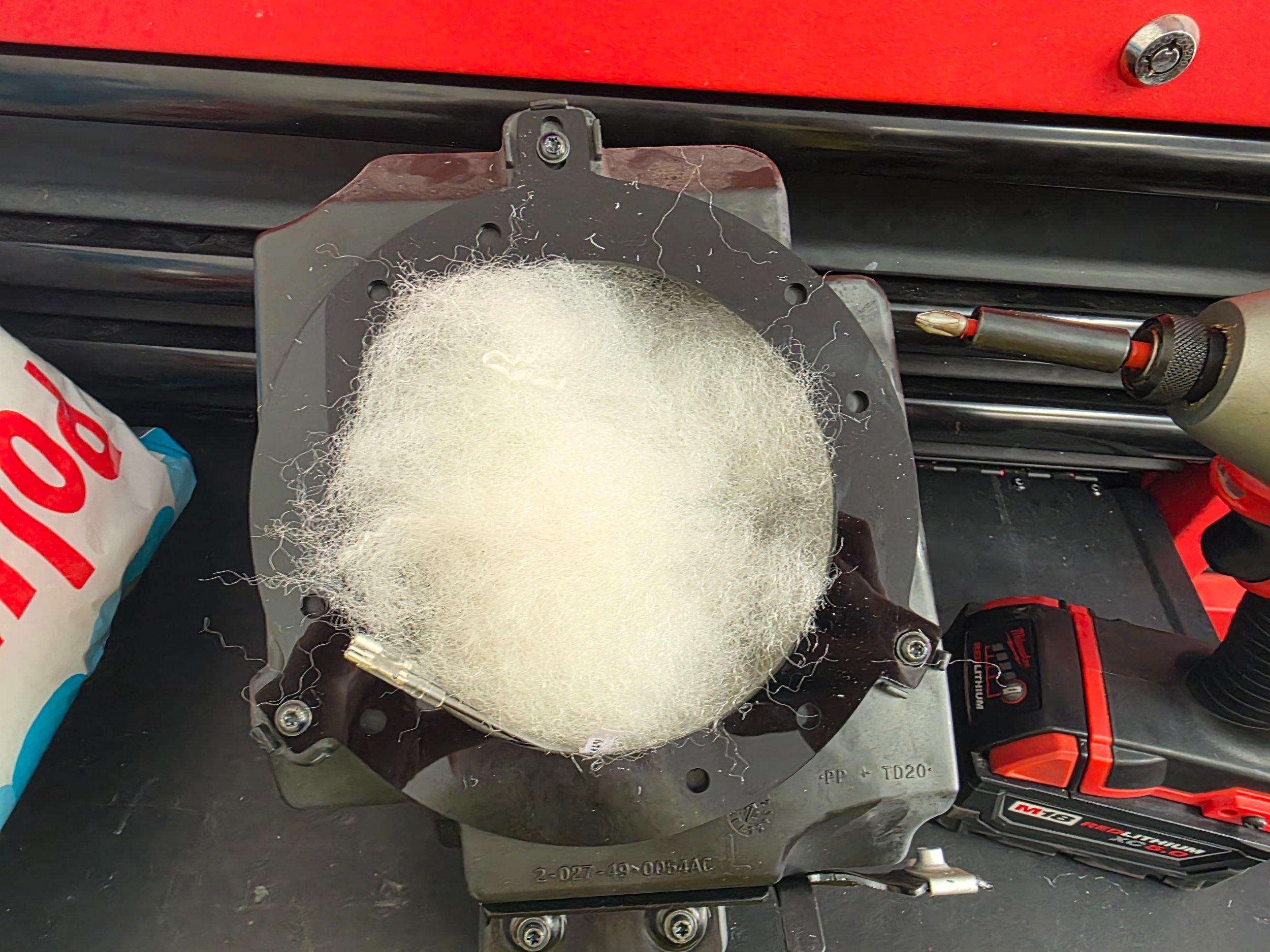

Swapped the factory speakers for a Kicker set up from Bantam Overland. These are a massive improvement over the OEM infinity, even with the factory amp. Granted, I have a radio with an excellent equalizer in it. The fronts are a mid-bass with tweeter and the rears are full range. They really compliment the OEM sub.

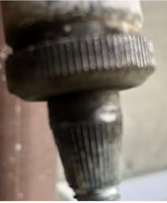

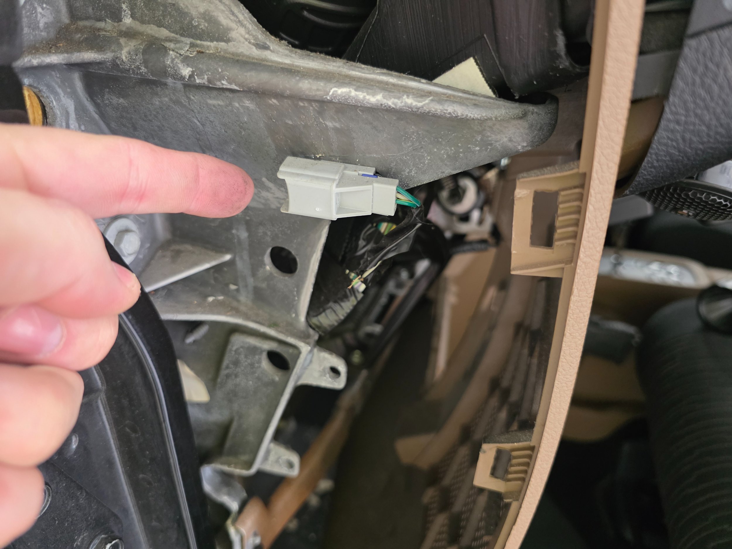

I found this plug in the upper side of the driver side dash area. Anyone know what it is for?

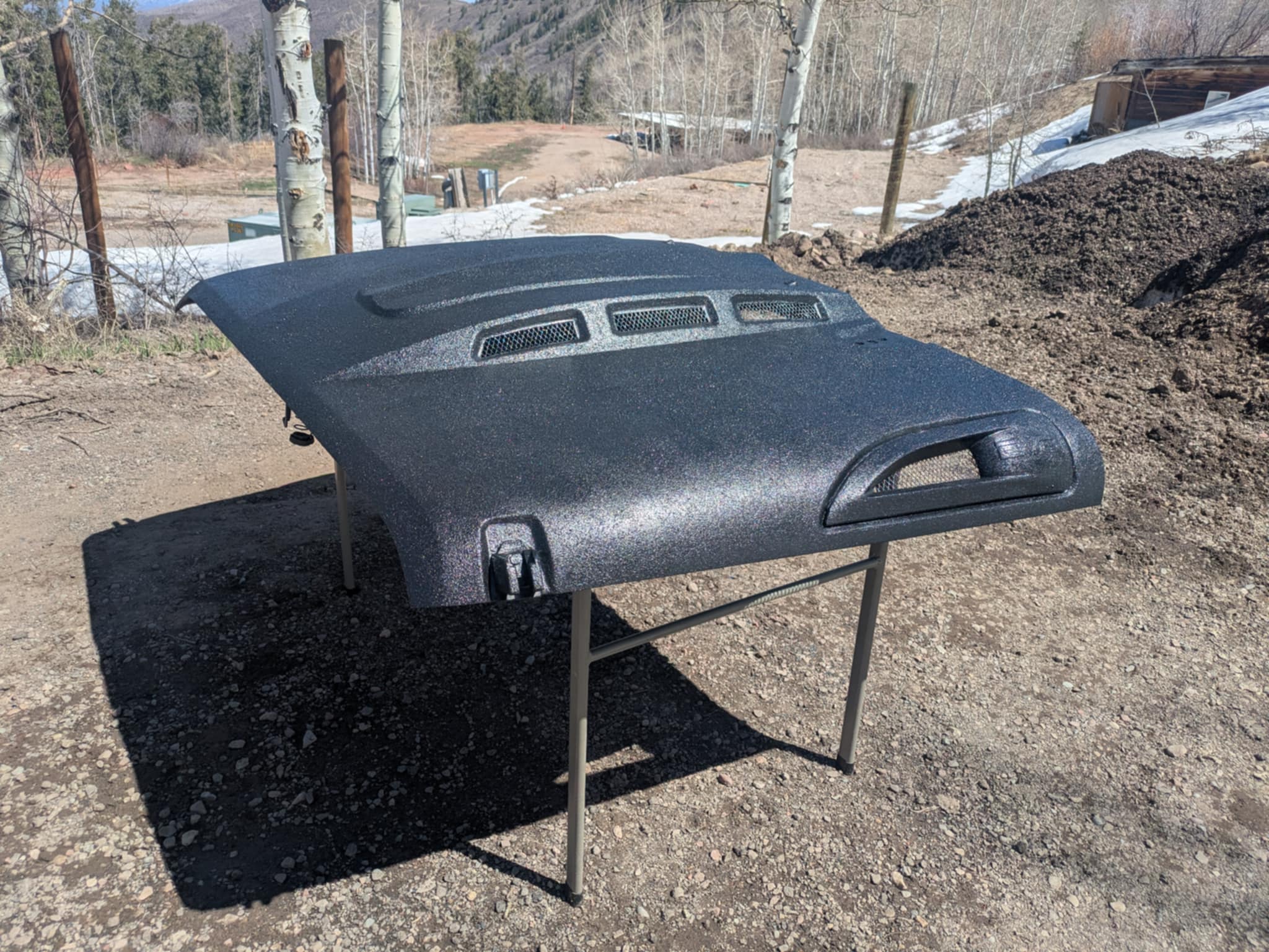

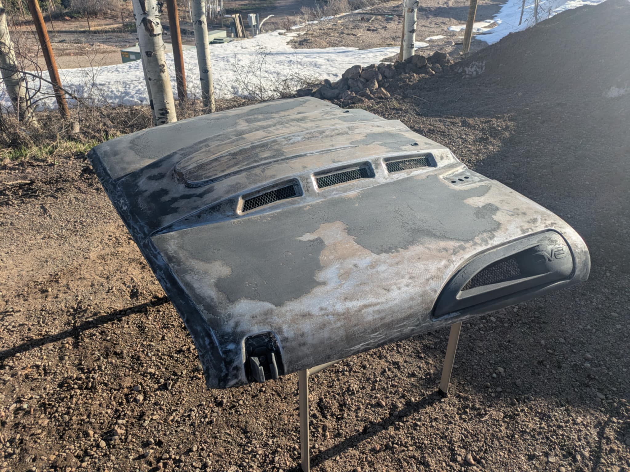

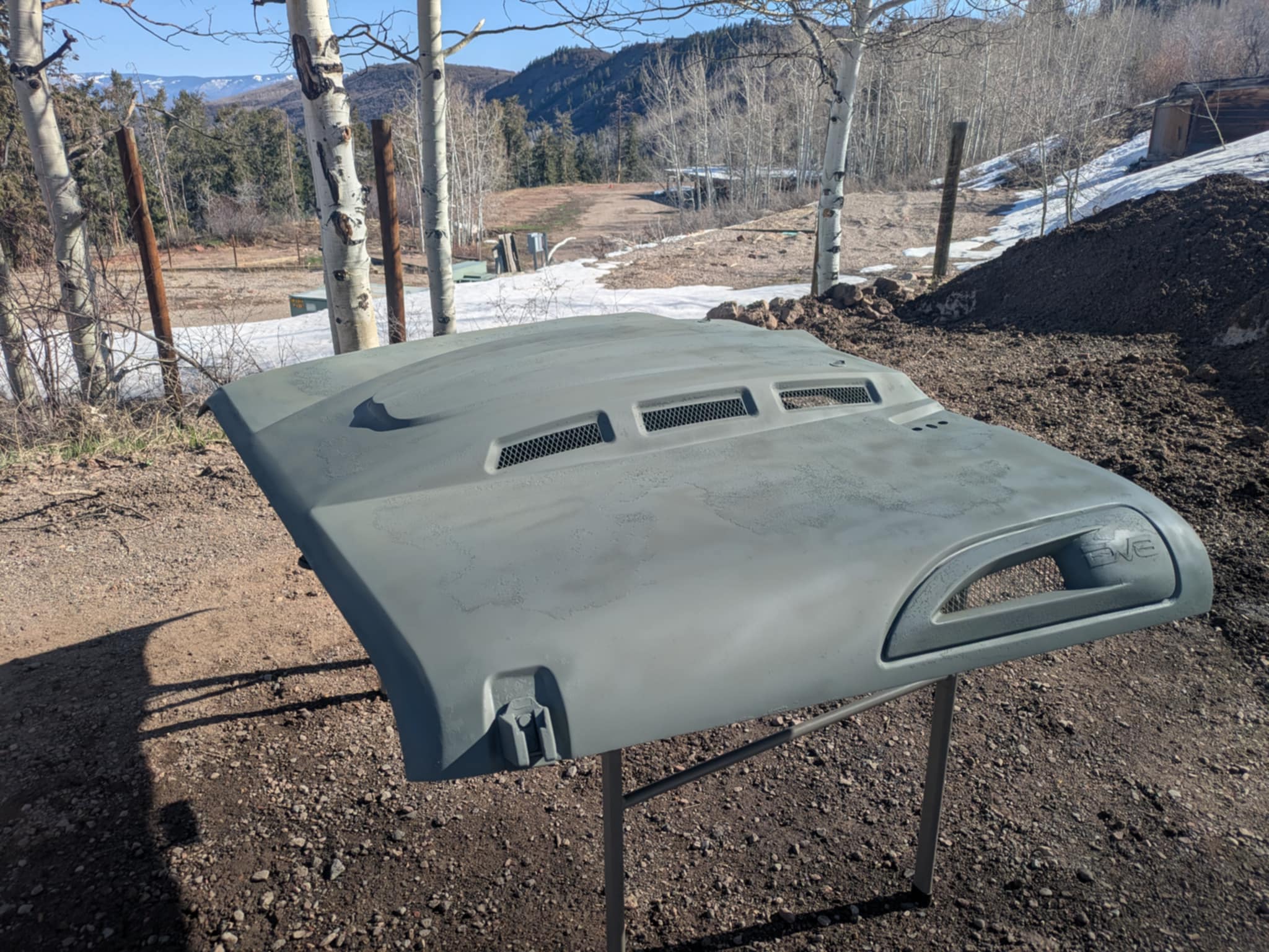

When I got my Jeep the previous owner had installed a DV8 air flow style hood that was never coated properly. After a summer in Florida it was showing its age and starting to rust so it was time to refinish it. I live at almost 9000 feet and have been dying to do this all winter. It finally hit 60 degrees today so was a perfect day to paint. (YEP that is snow melting in the background.)
I just went with the cheap roll on bed liner and self ething primer after knocking all the loose paint off and a quick sand. The main goal was just to buy some time before having to replace the hood entirely. But I must say it looks a million times better.
For a couple hourds and $50 it will work until I find a replacement.

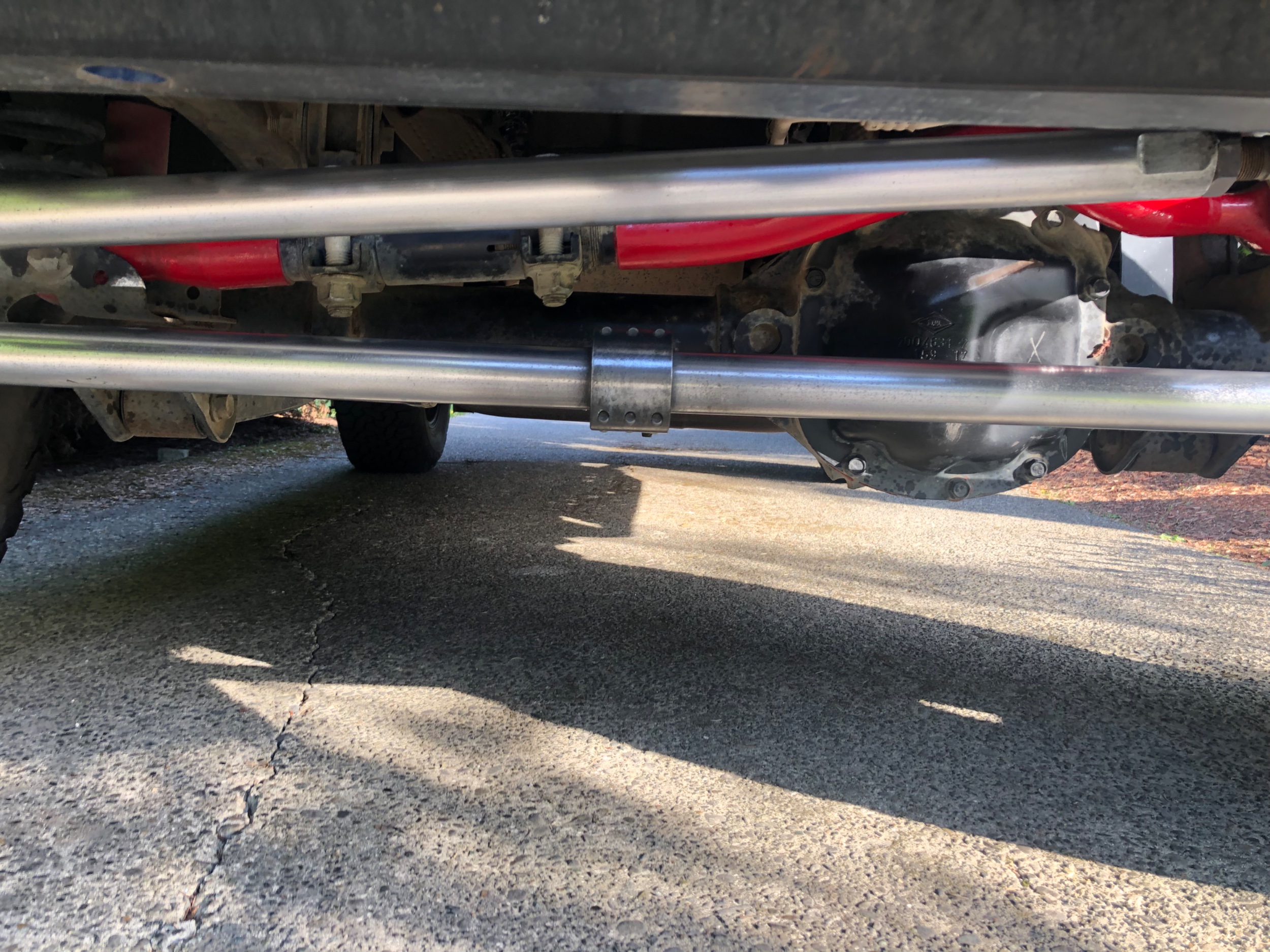

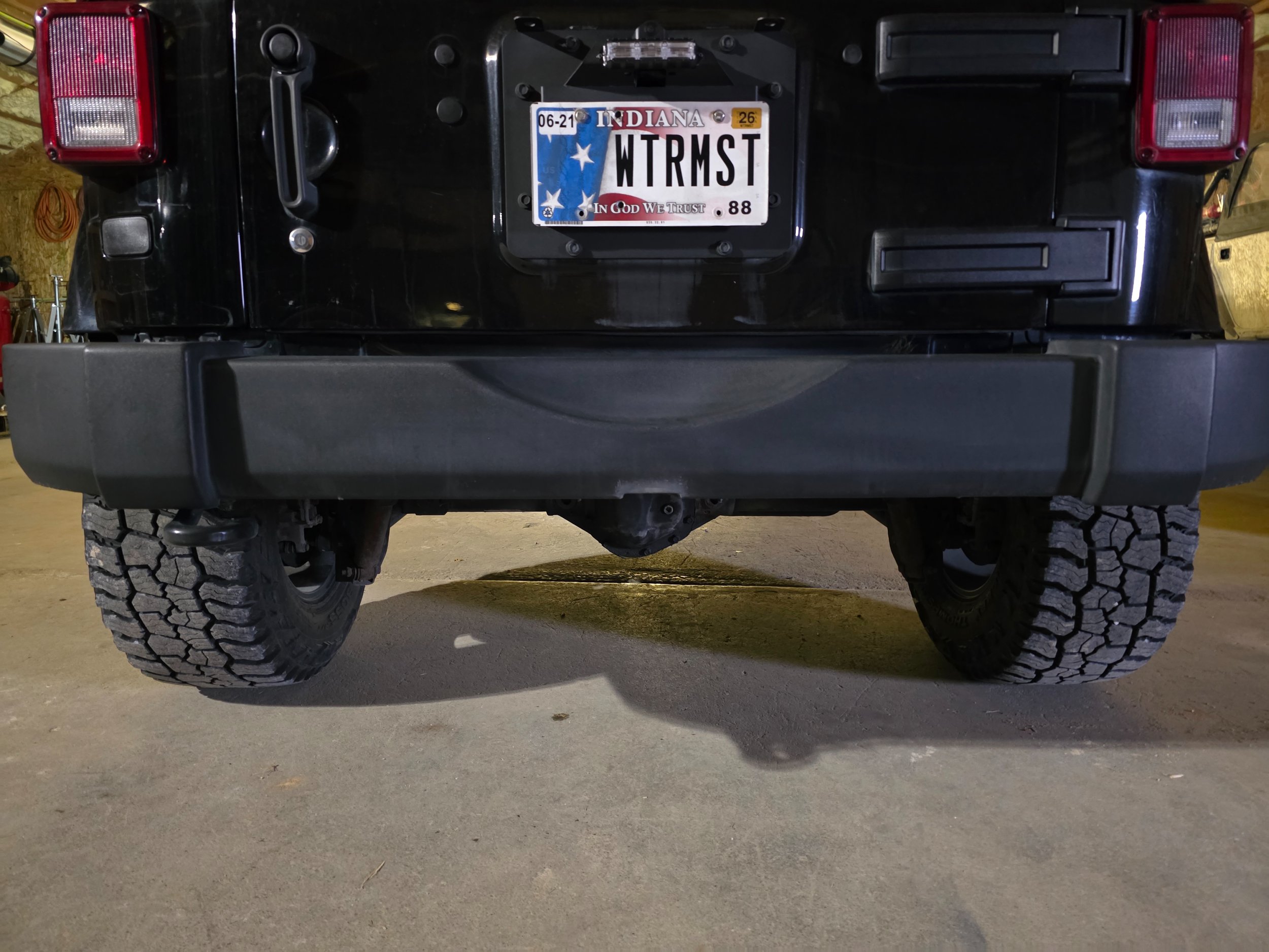

Replaced the wife’s power steering pump and steering stabilizer. Bleed the system and everything looked good. Put everything back together, clean up and then what I do I see? A little puddle of fluid. Wiped it up and only to see more. For some reason the return hose is leaking where it slips over the pipe. Not if the clamp is tweaked or the hose has a problem, Wasn’t leaking before. I wondering if the old simply is deformed a little from how the old clamp sat and the clamp not being in the same spot. Anyways ordered a new hose, clamp etc. and will replace it.

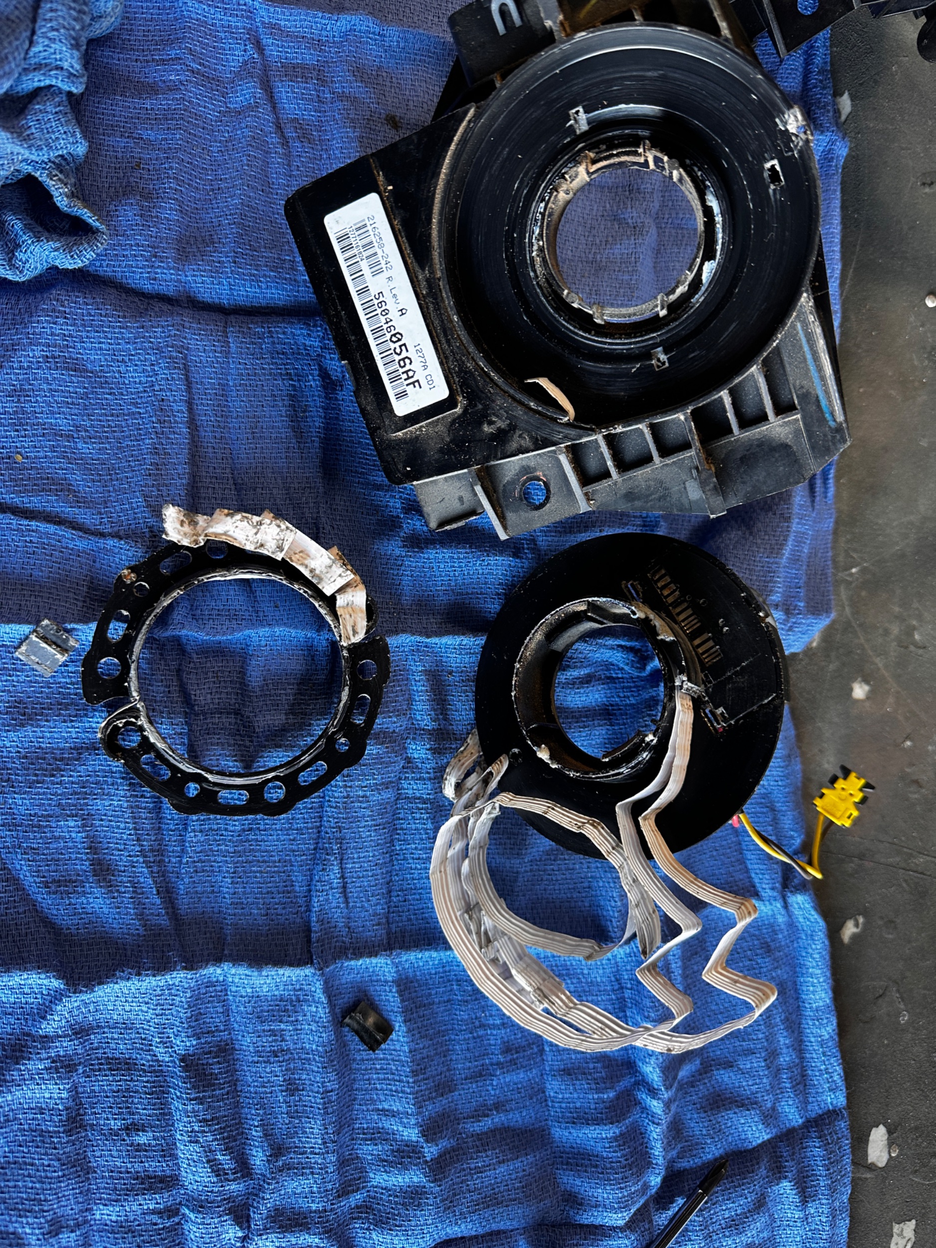

Attacked the clock spring today. I’m on the downhill side now. I pulled the old clock spring apart, it was puckered at one spot so it popped apart really easy. Found this. What dos that do? I am assuming it’s a shattered ribbon cable.
