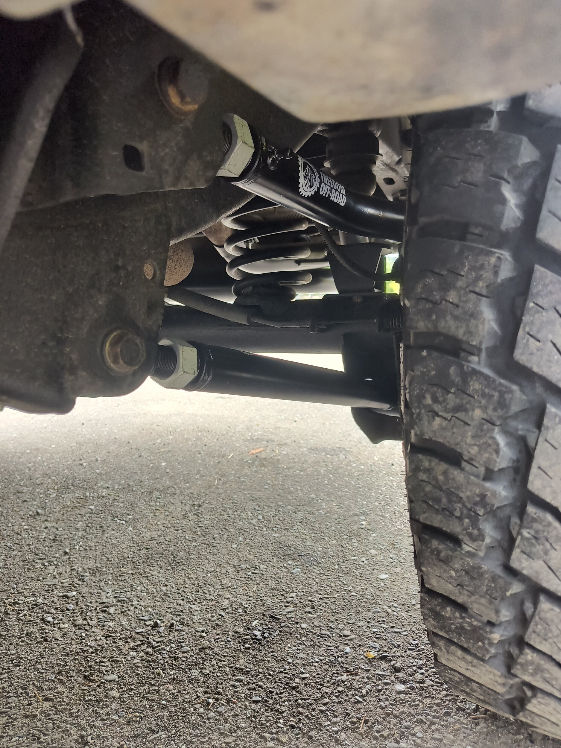

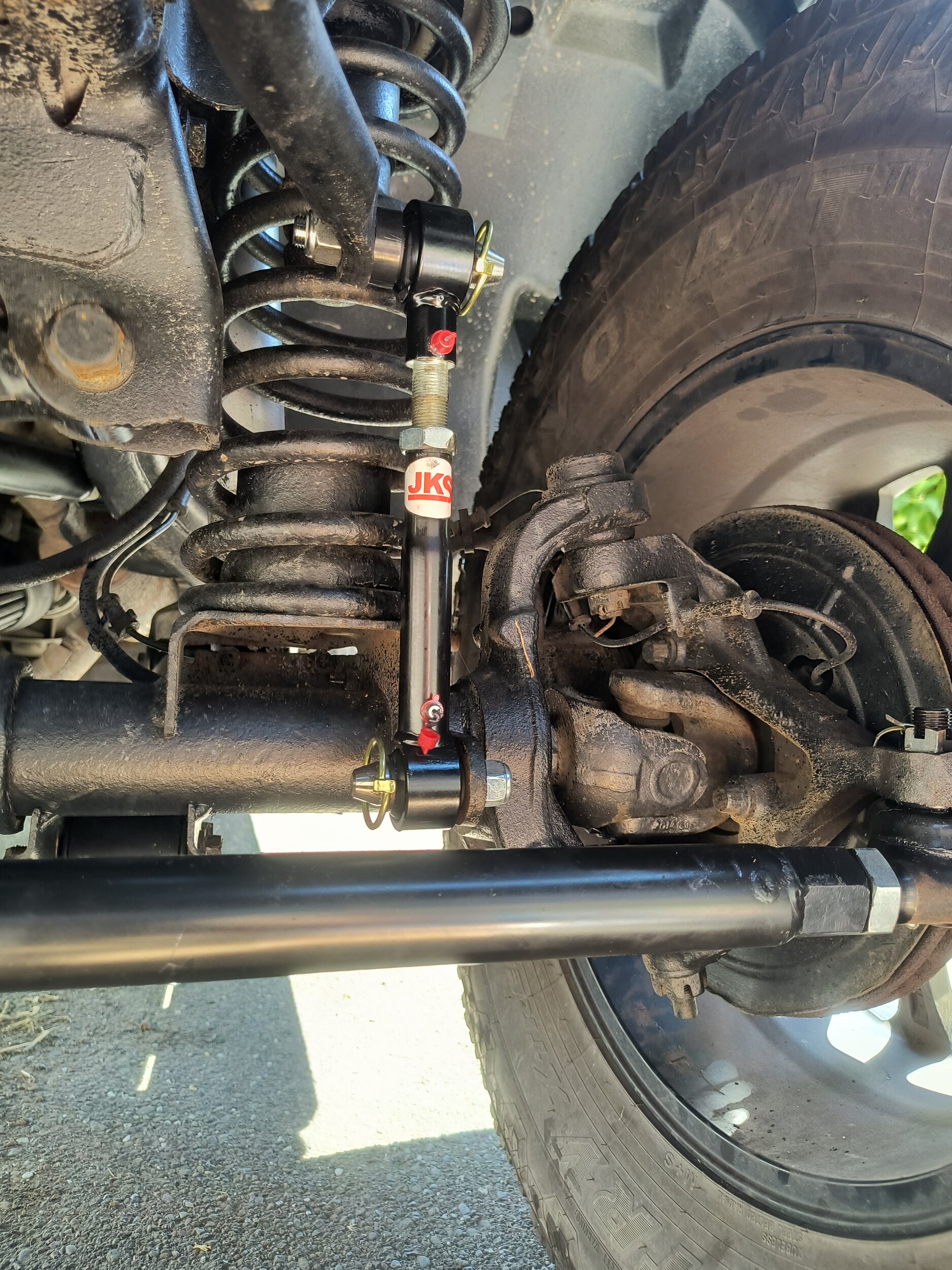

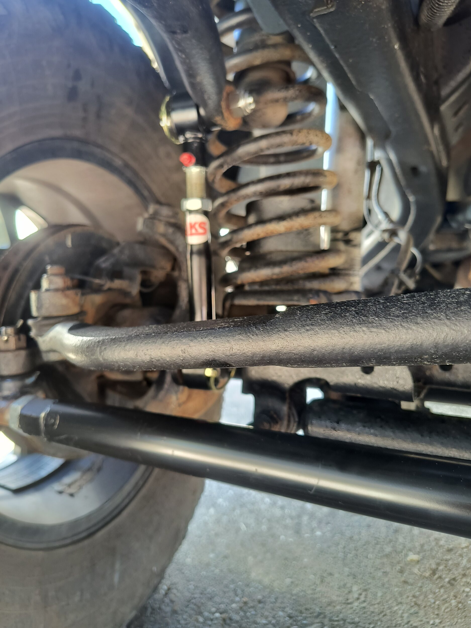

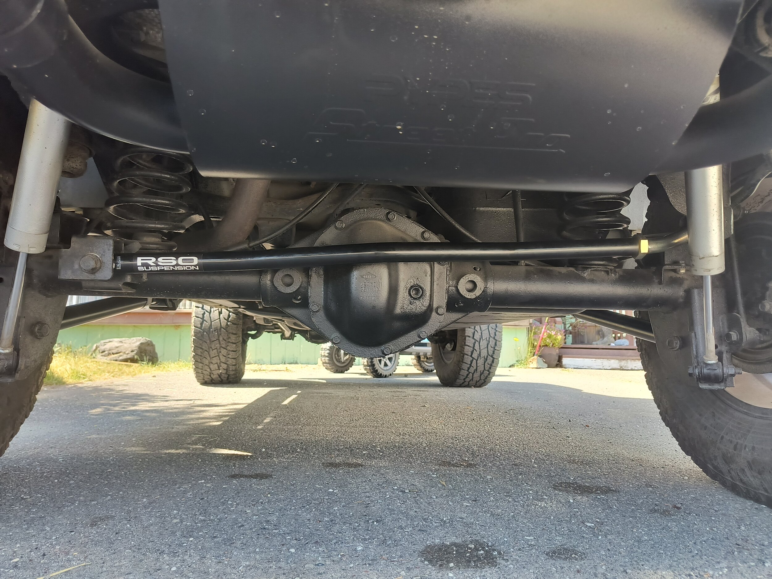

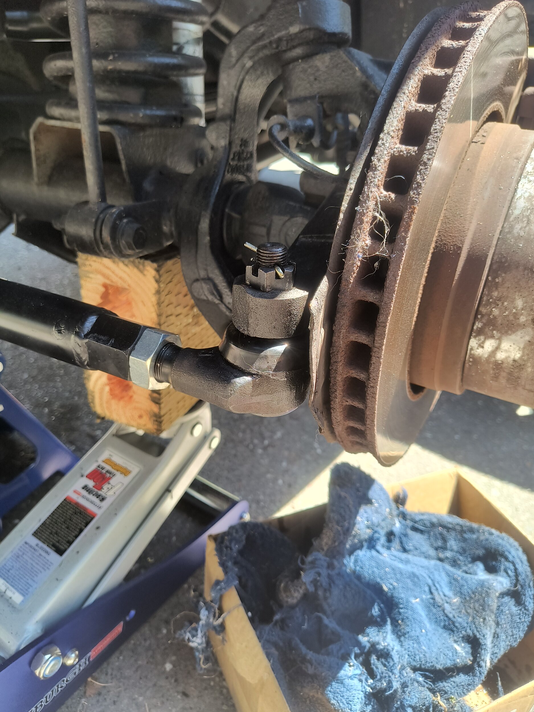

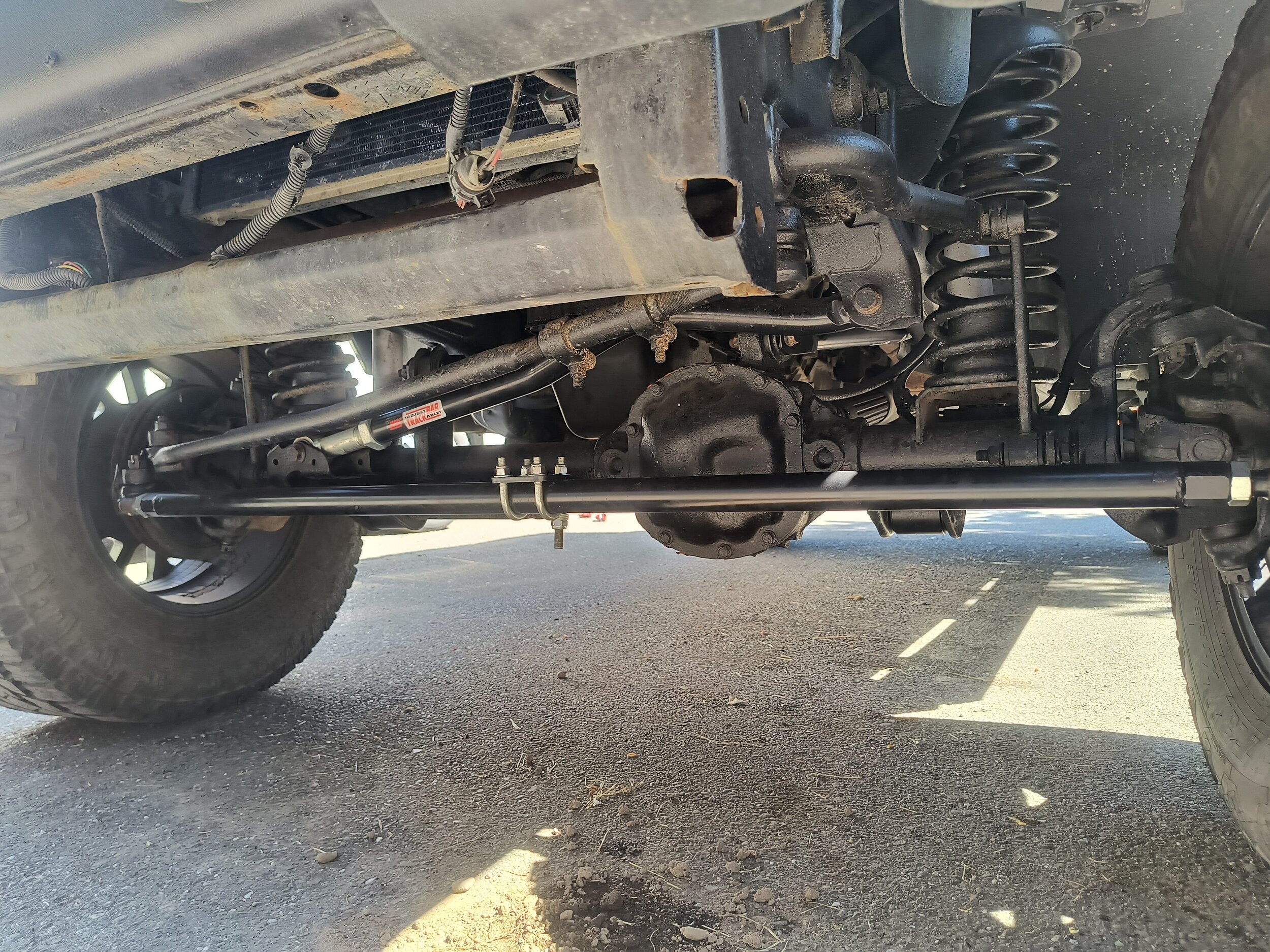

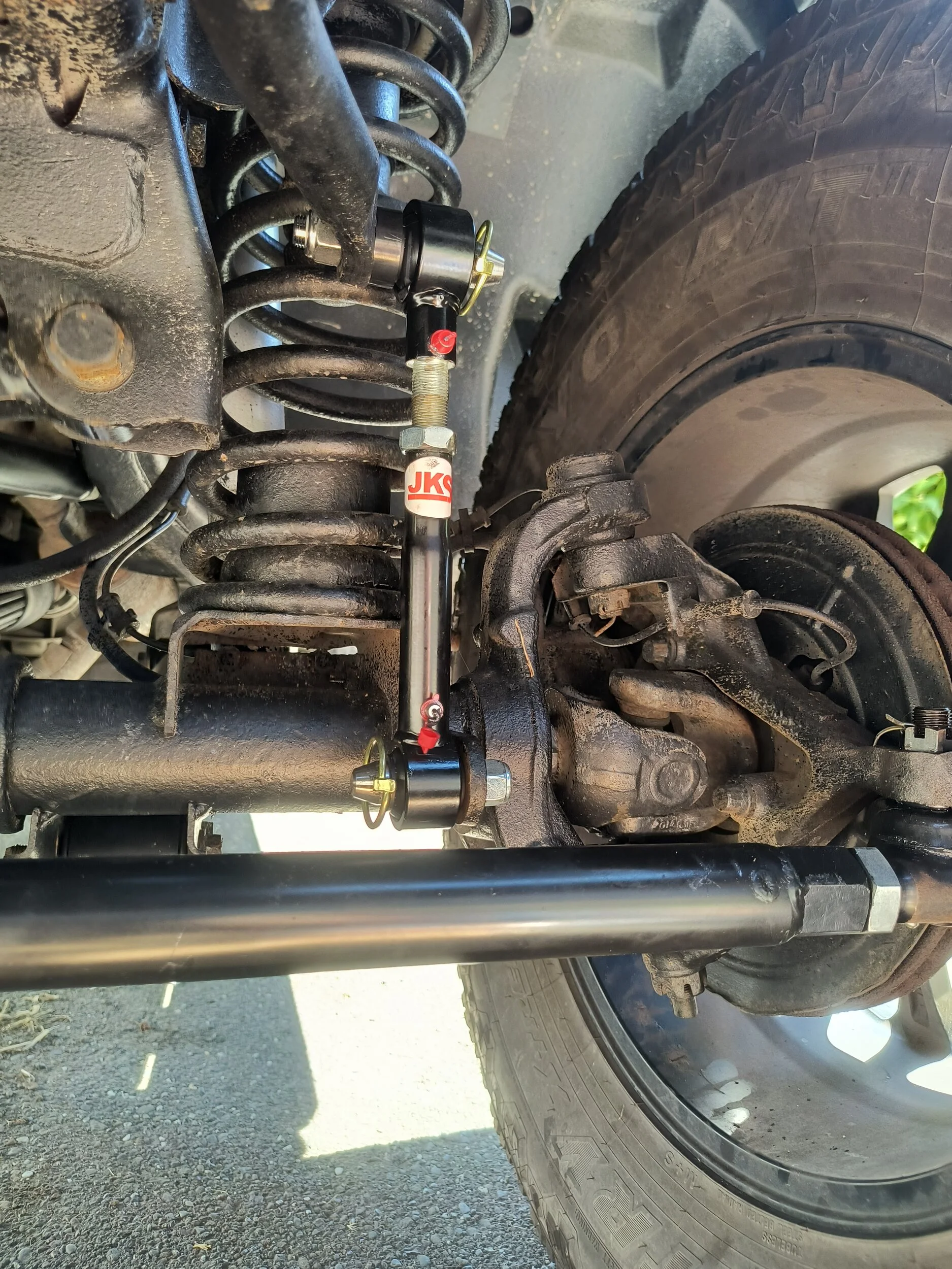

Installed all new control arms. Freedom off road adjustables. Set em to factory length right now untill I get the rest of the suspension suspension and steering parts in. Then a total alignment to recenter the axles. Other than the stickers all being the same so they sit wierd when installed I have no complaints. Def took a lot of the wander out of the jeep

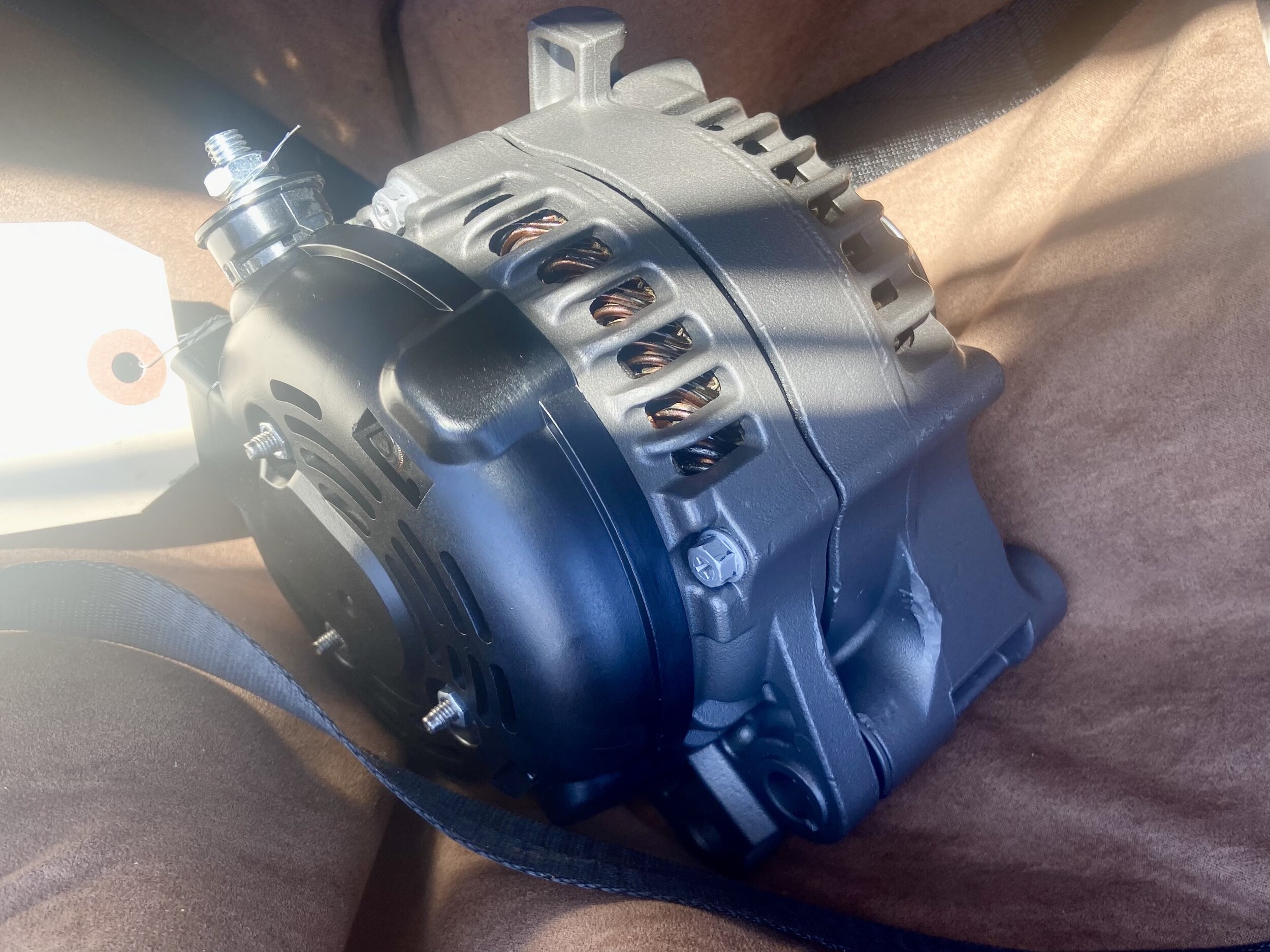

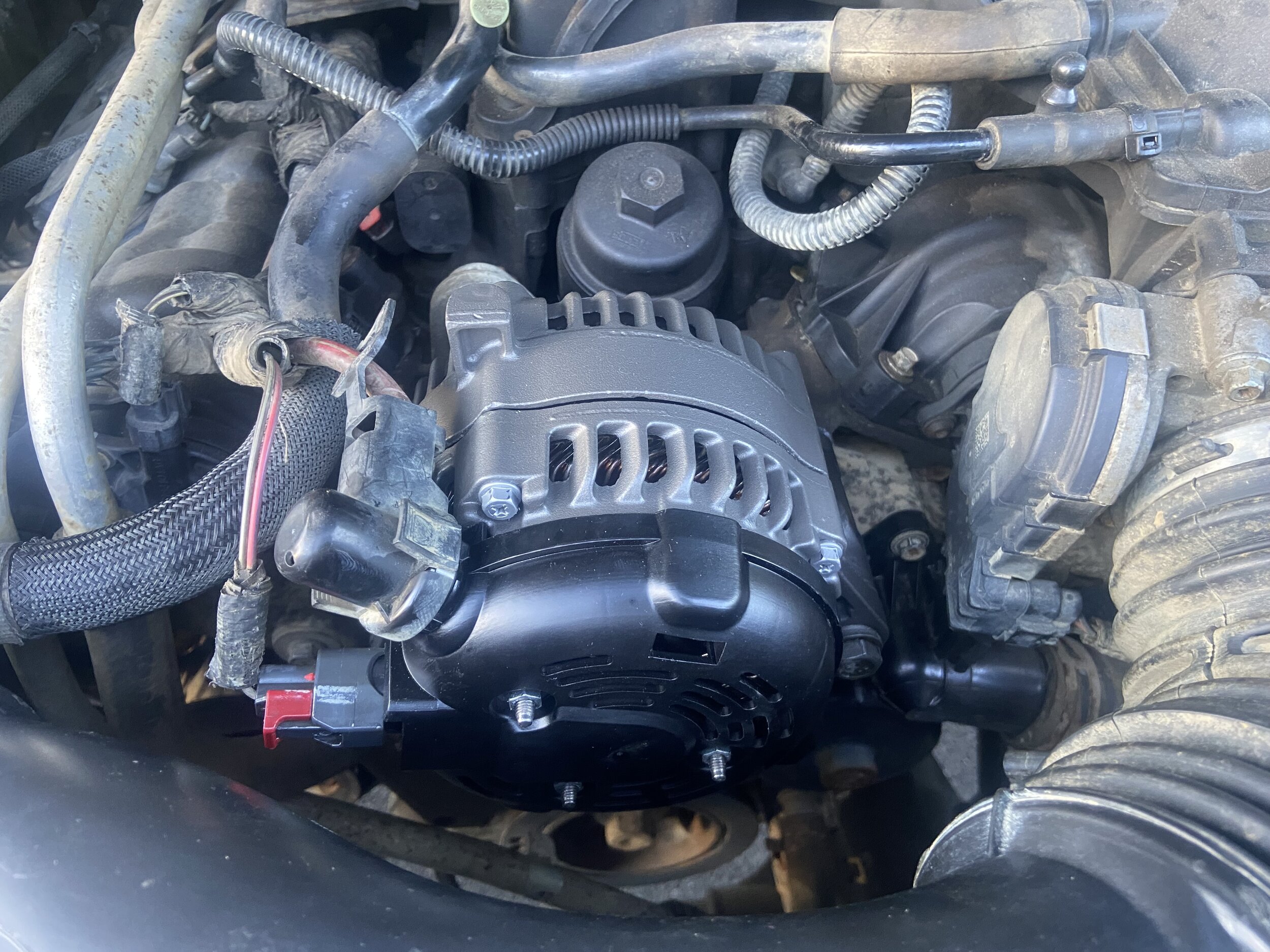

Battery light remained illuminated for three days straight. Prior to that it would illuminate in the morning and after a short drive, it would shut off. Which led me to believe it was actually my battery prematurely dying. But it wasn't. I also experienced lethargic shifting and a slight decrease in pep. Granted I only pushed it for approximately 2 1/2 days before I decided to pull the alternator. But I'm glad I did before I got stuck somewhere.

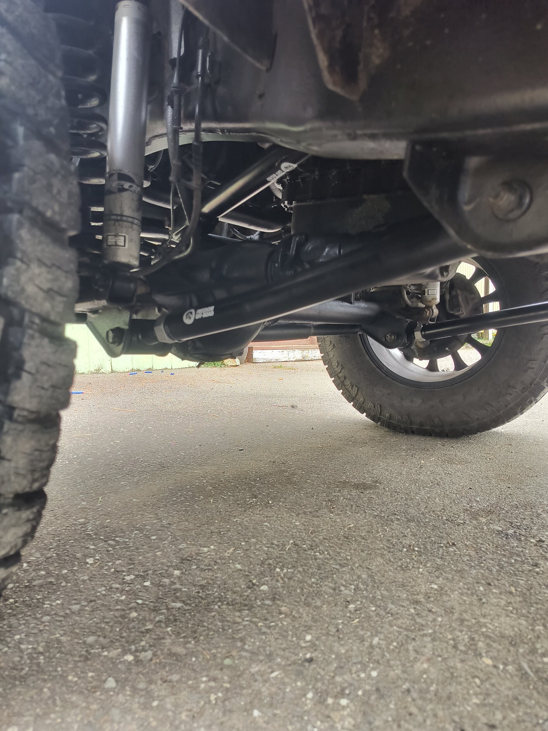

Still waiting on drag link to center axles and correct and steering issues. Don't really drive it alot as I work too much. Just been fun tinkering with
