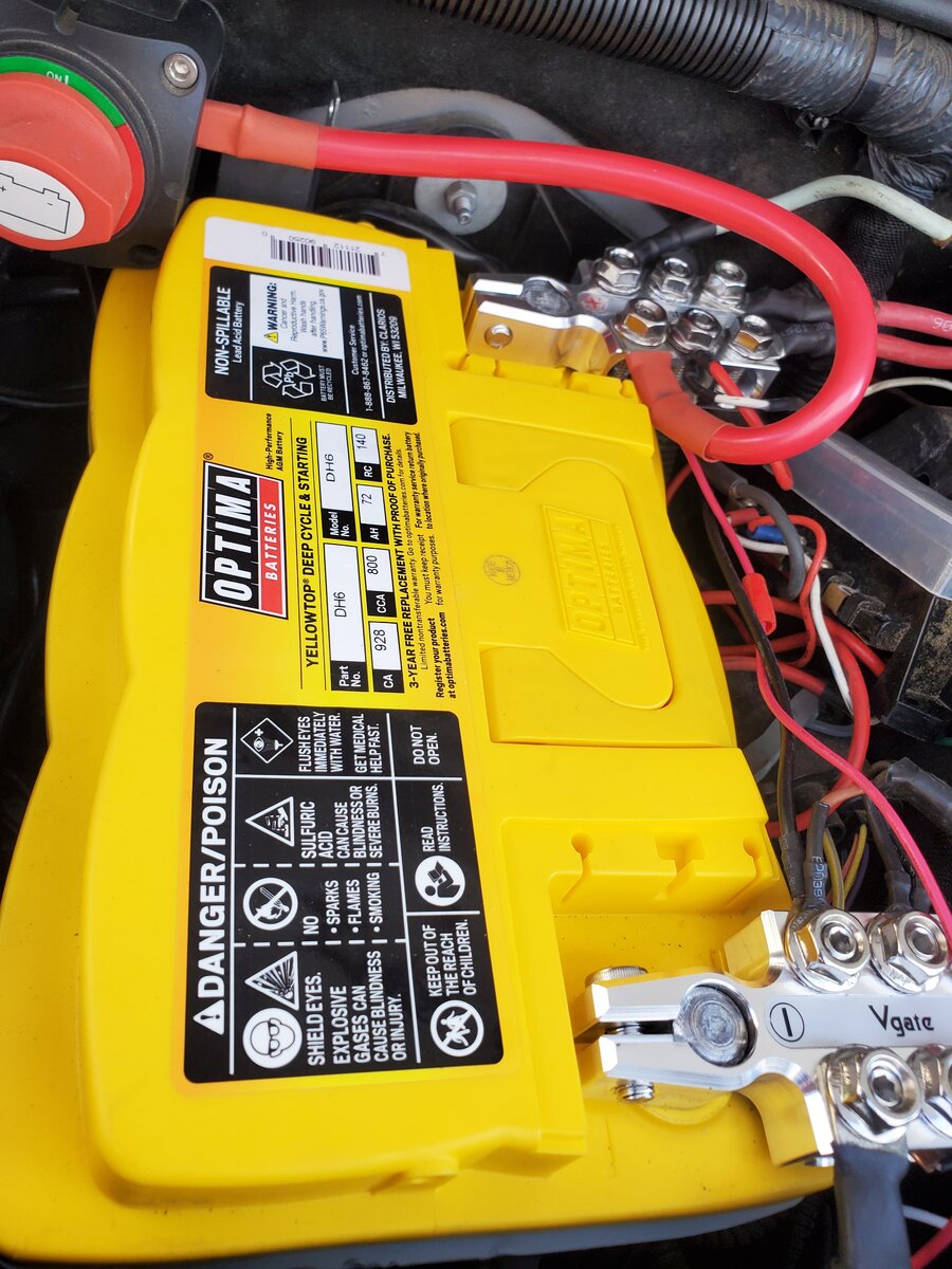

It's never ending. So my short commute to work and loose battery clamps caught up to me. It was time to replace the battery too. Let's hope this one can keep up.
While these clamps will likely work wonders for your multitude of add-on wiring, I’m not a fan of that giant positive terminal that is now exposed to all kinds of potential mishaps.
I wish it was insulated; that would satisfy my OCD.

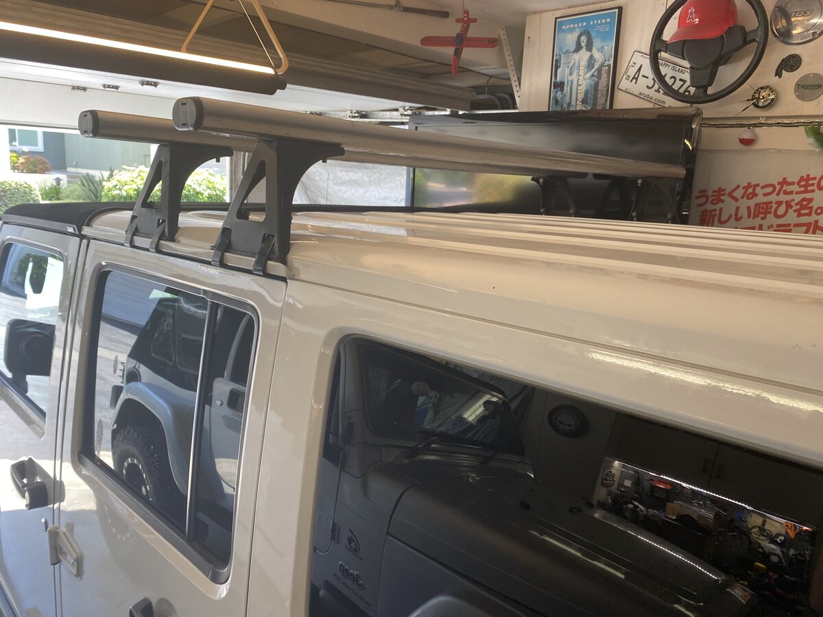

Today I finally added the short term roof racks in preparation of our upcoming road trip to Zion.
I call these “short-term” as I don’t intend on using them all that often or for very long.
They are mounted close together for 2 reasons:
1- We will still want to use the Sunrider feature, so attaching them above the front doors is not an option. They have to be mounted as far back as the rain gutters allow.

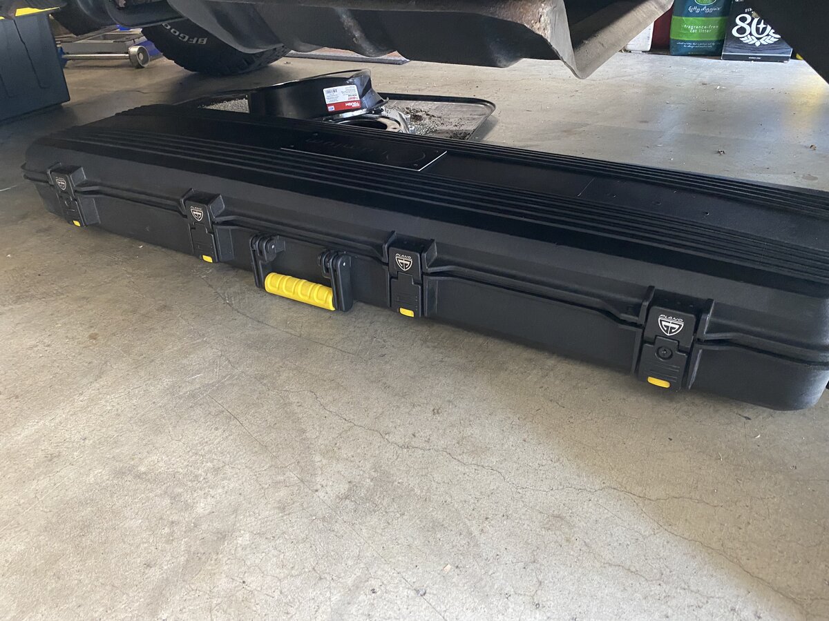

2- I only plan to carry our recovery box up there, so that it is out of the way and not taking up valuable interior space. It’s a box I hope doesn’t even need to be opened.

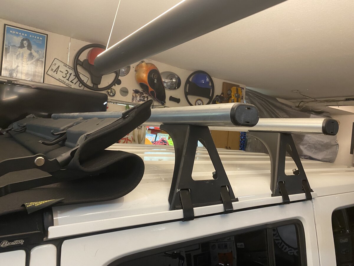

Dumb question, will the sunrider open / close with the recoverly box on top? Looks like it will protrude over the sunrider?
