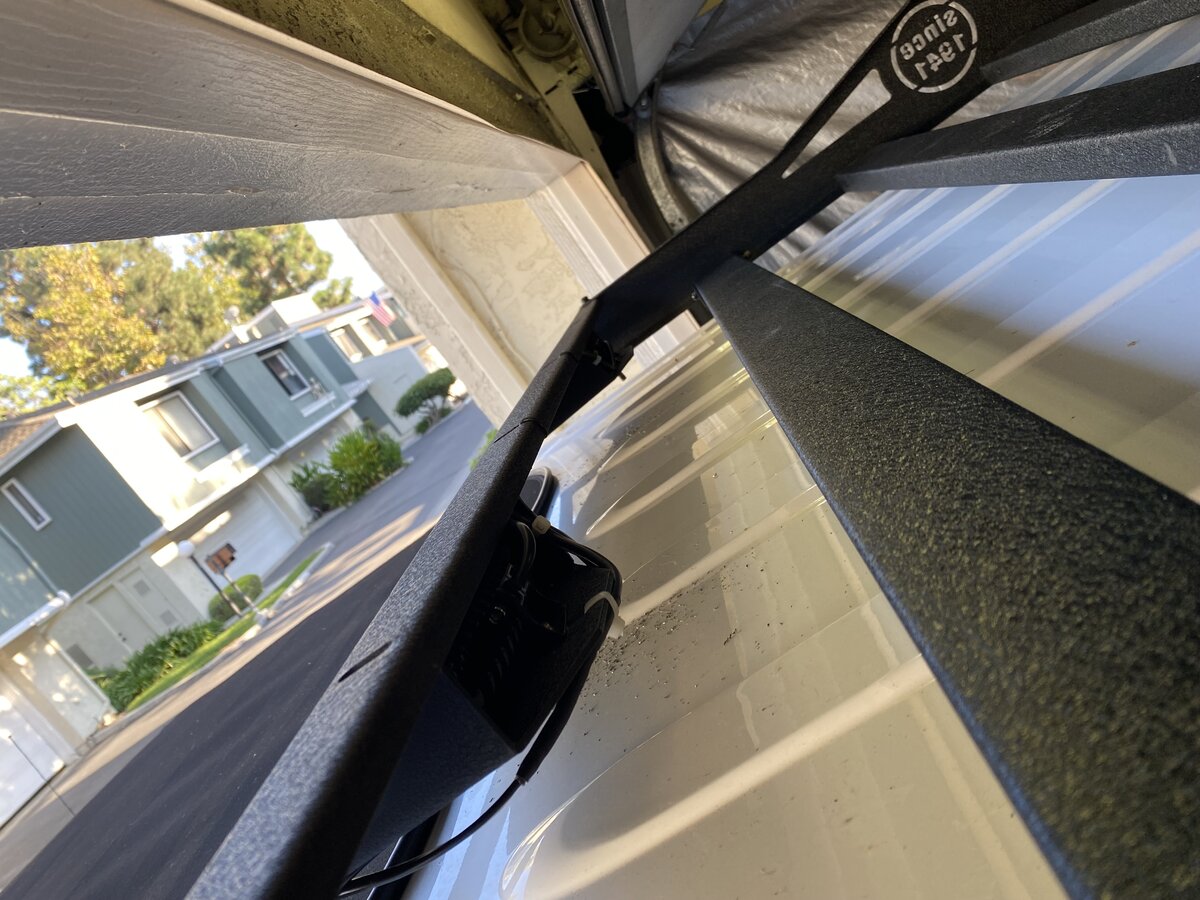

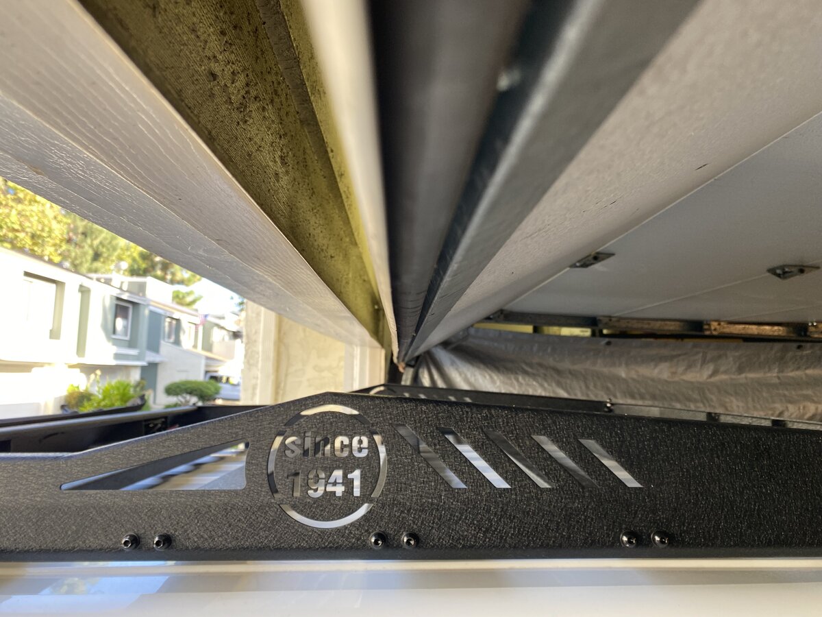

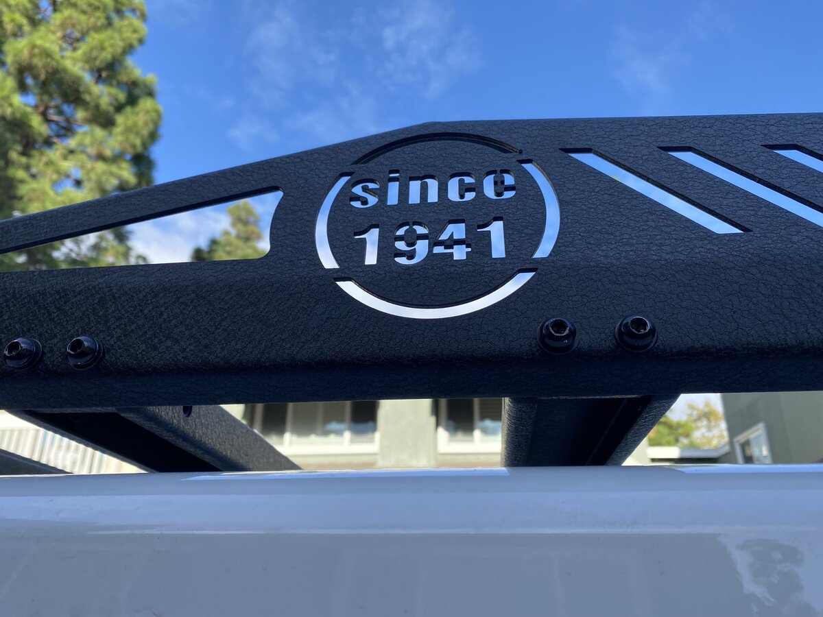

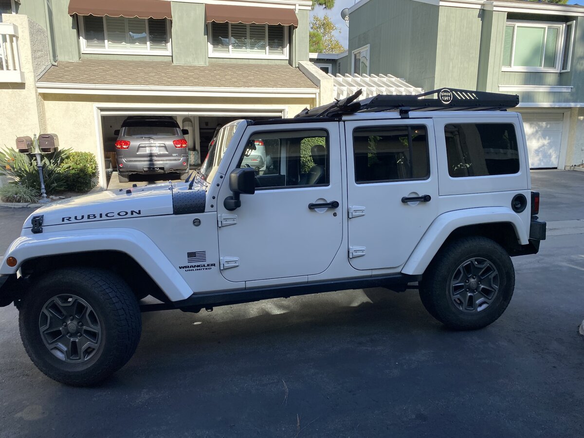

Got a screaming good deal on a new, uninstalled roof rack today.
It’s already installed.
There’s at least another 1/2” left for taller tires…

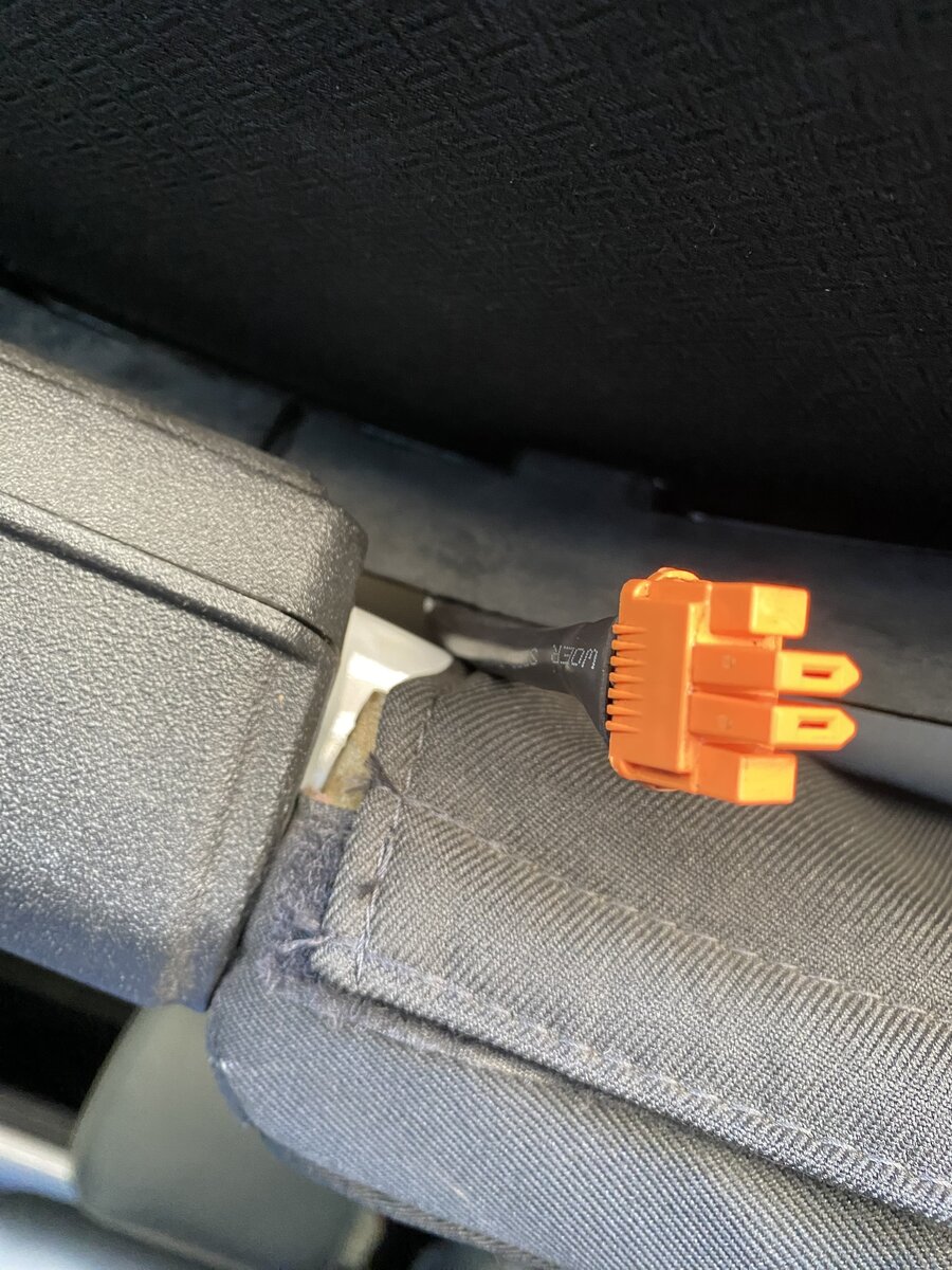

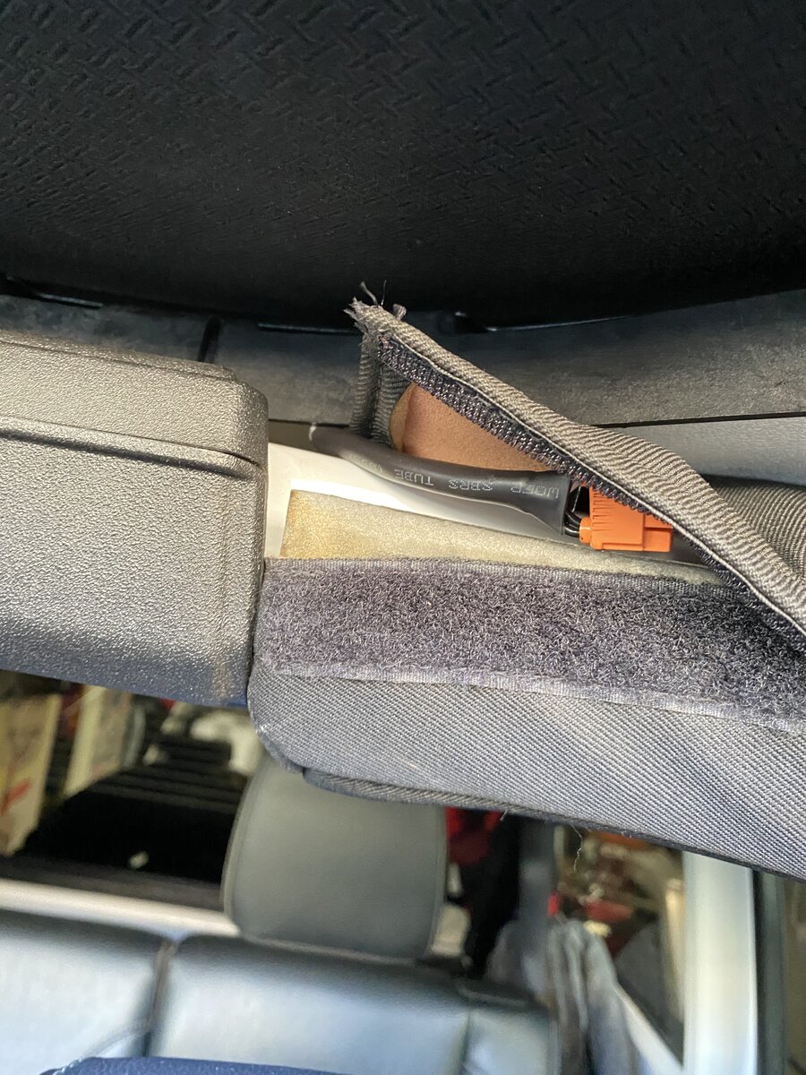

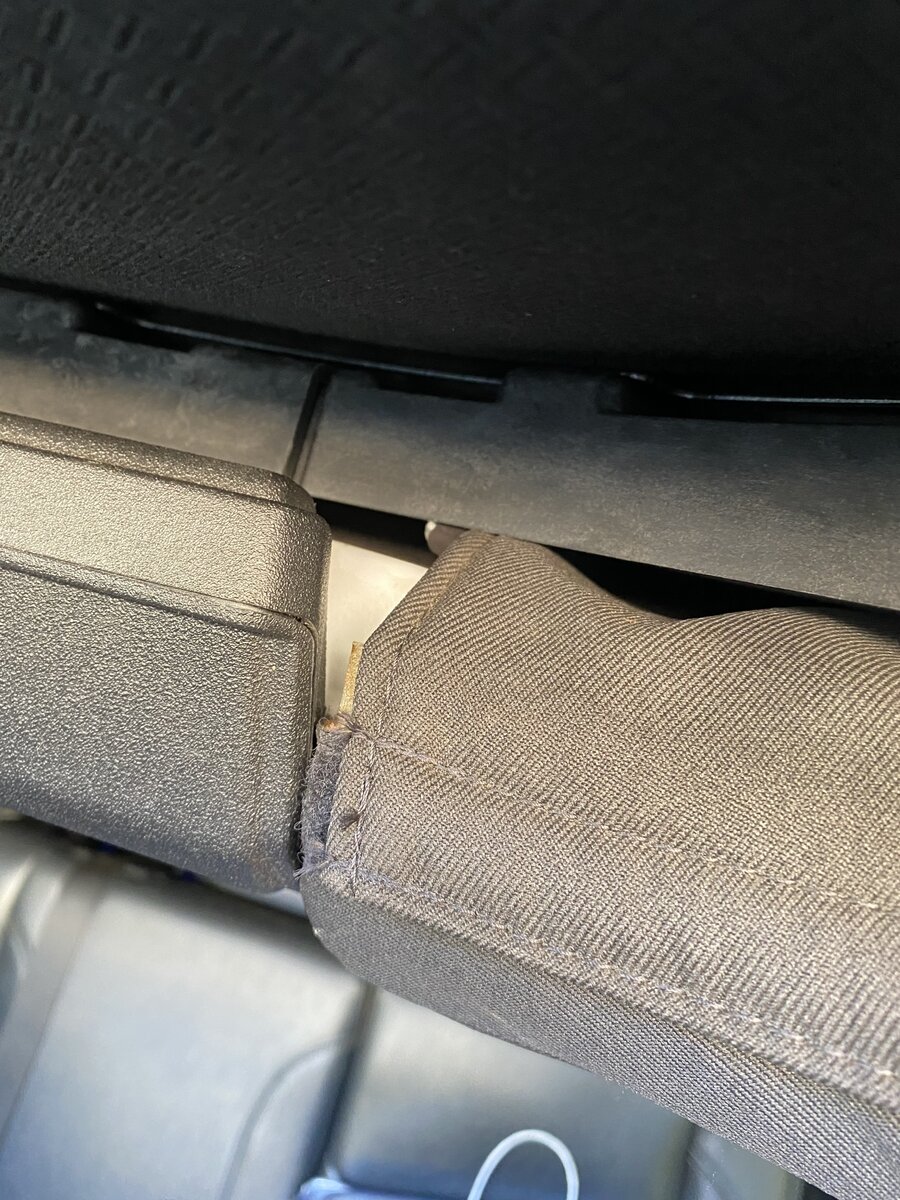

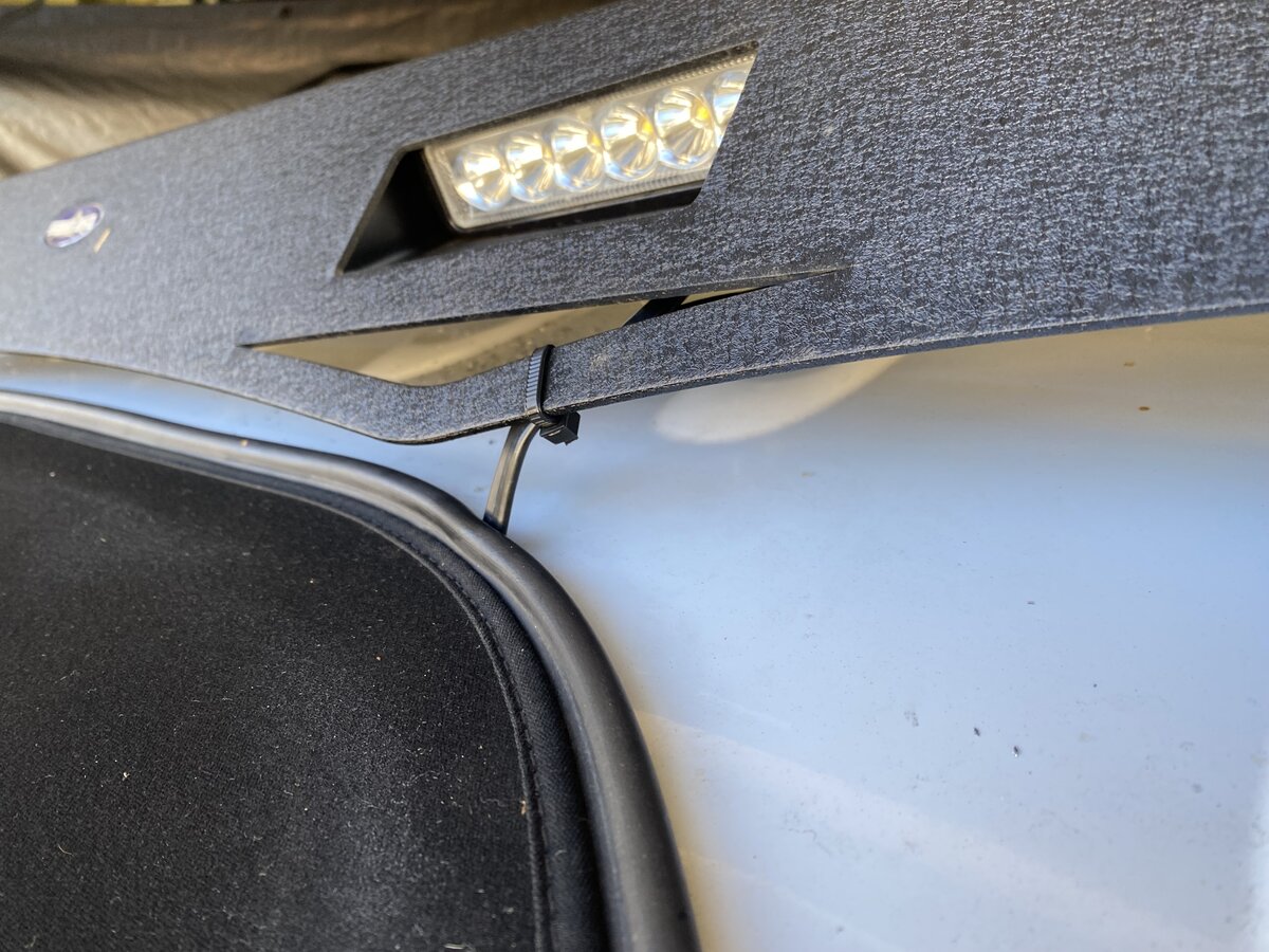

Finally made the wire harness for the roof rack lights.
Soldered and sealed w/ marine-grade heatshrink.
For convenience, I added a plug inside the top.
Ran the wires inside the roll bar padding to the front corner.
I just need to decide which switch I want to control them with.
I already have an open relay (fused) so I just need to splice in and hide the wires behind the trim.

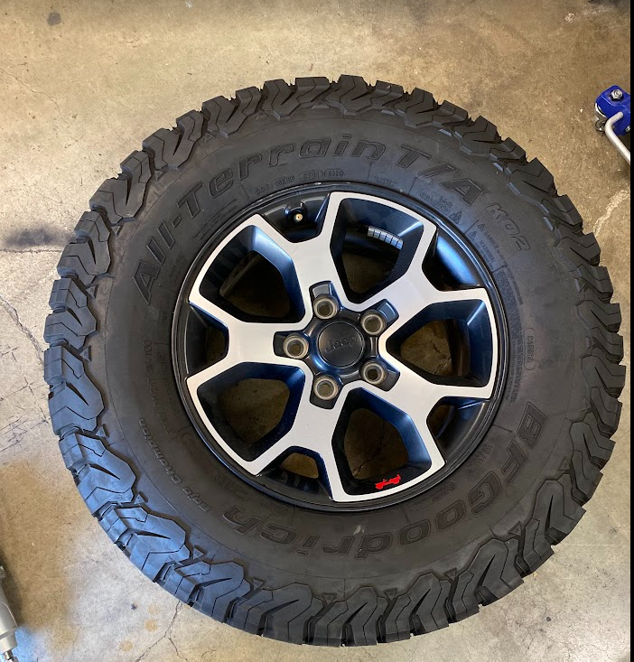

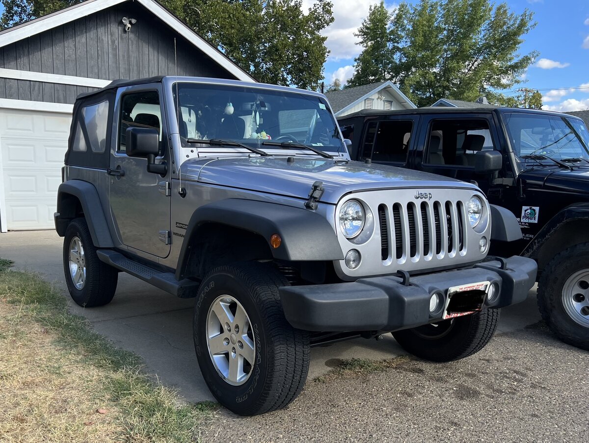

Today I finally upgraded from the 255/75R17's to 285/70R17 BFG K02's!
I found a set of takeoffs (all 5!) on 2022 Rubicon wheels for only $500.
They only had about 15K miles on them, and the spare had never touched the ground.
All that was required was to remove the rotor clips so the new wheels could sit flat against the hub.
From these:
To these:
Now I have a set of old wheels in my way.

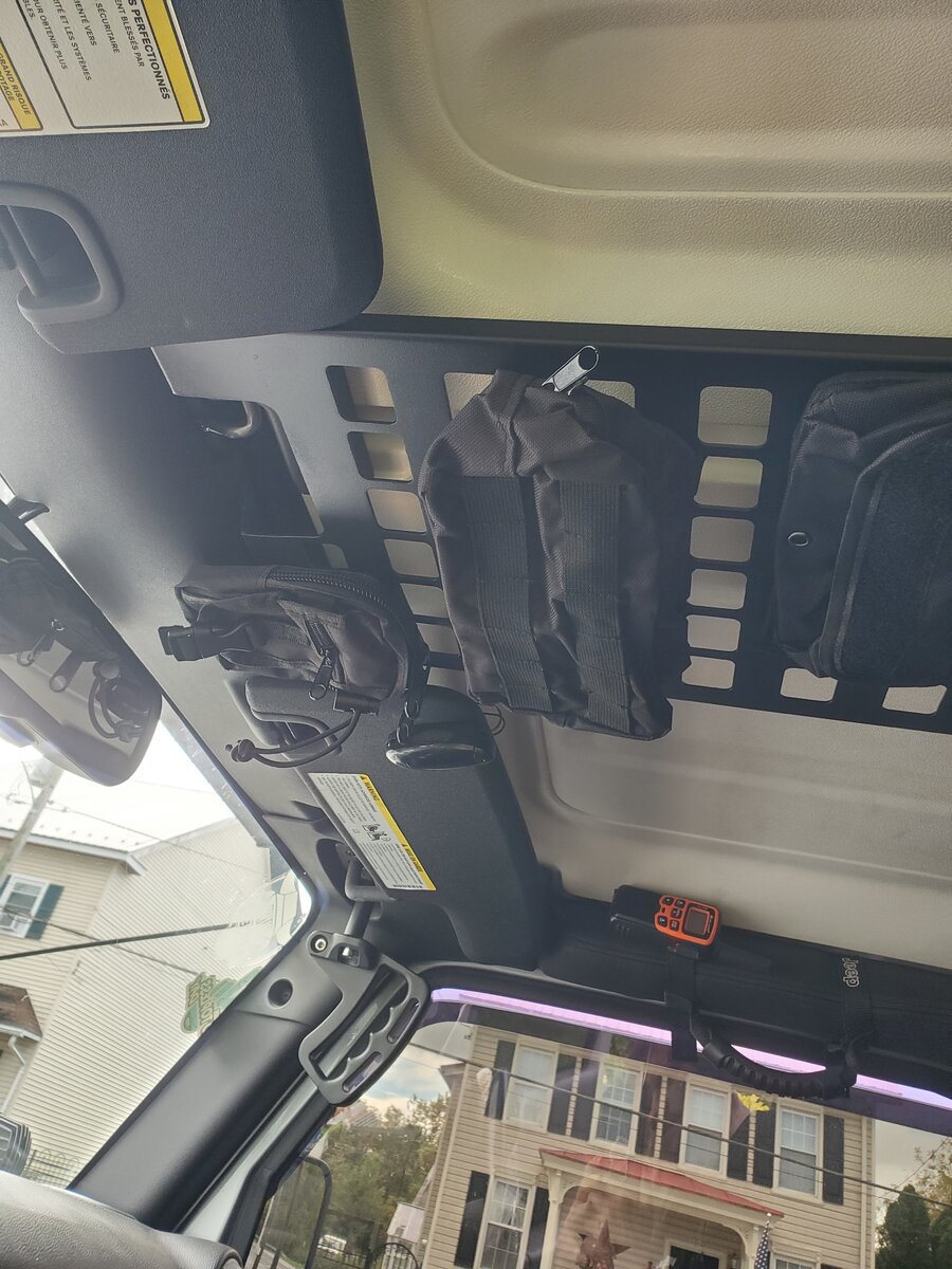

@JerryD Honestly, I was thinking it would feel more closed in but it doesn't. Now, I'm only 5'10", maybe it would feel more closed in if I was taller? I'm glad I got it. Was able to free up a bunch of clutter from the back and put into the pouches.
@Speartip https://www.amazon.com/dp/B096X245N6/?tag=jkforum-20 there are no instructions but it's easy. I did not use the rivets that came with it. I also had to trim the plastic piece above the rear view mirror for the molle panel to fit. It wasn't much trimming. Glad I bought it.
