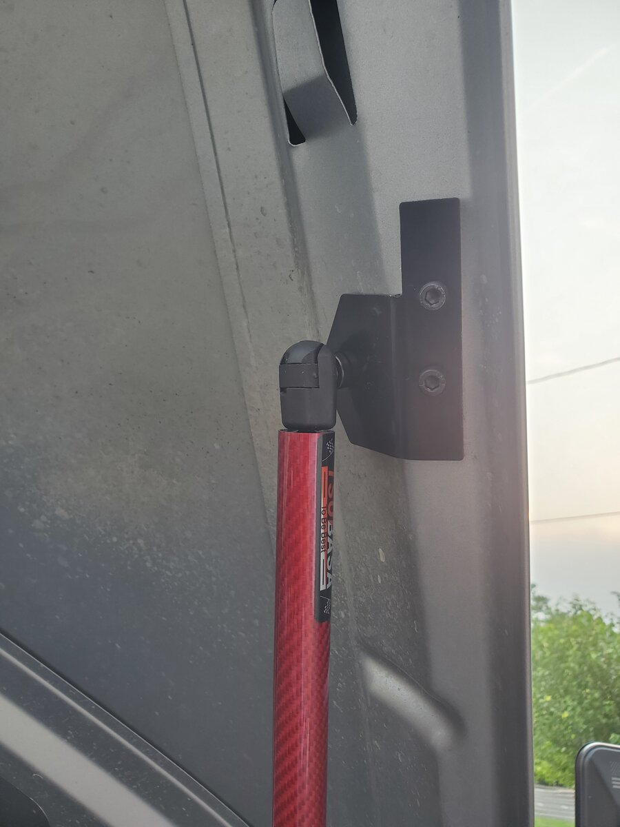

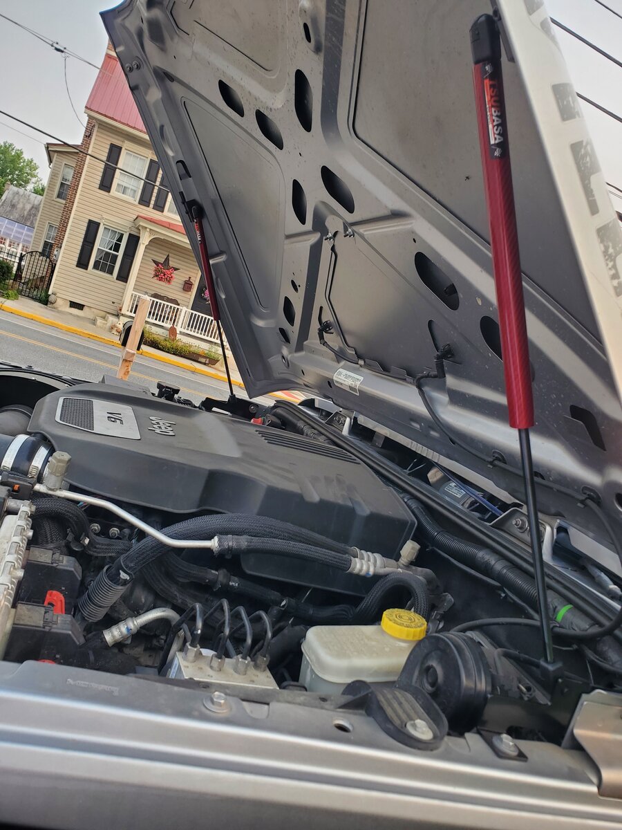

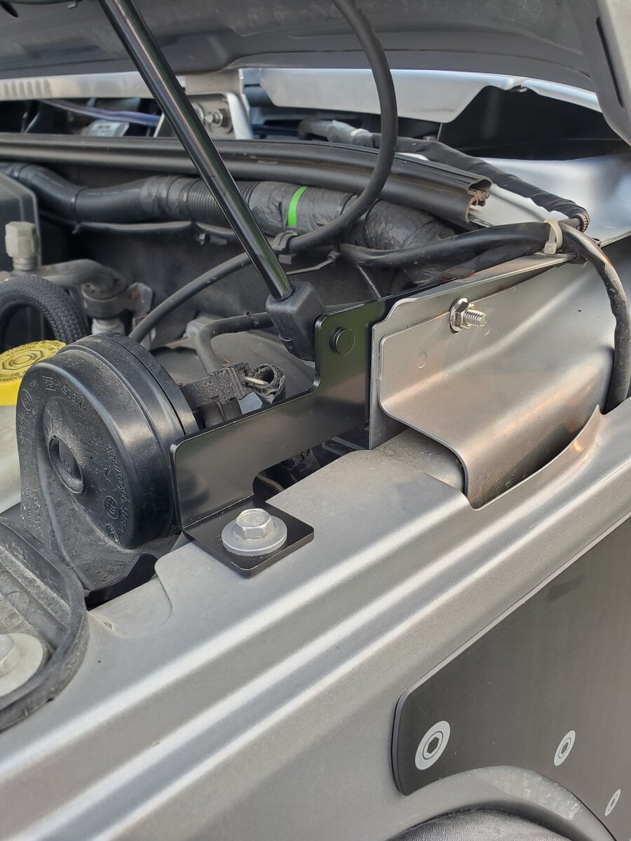

Installed my hood struts today. With my Jeep sitting so high, I always struggled to get the hood prop in the hole. I'm not a short dude either. I wish I would of done this sooner! Took 15 mins, a 10mm socket, 10mm wrench and a 4mm Allen wrench. The hood goes right up with zero problems now.
