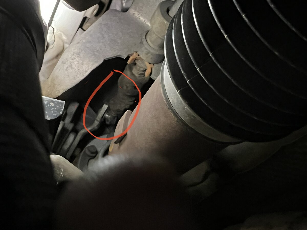

Went jeeping up to Wentworth Springs and did some playing in the snow. Stop for lunch, boy comes over and says “my Jeep is stuck in 4 low”. Sure enough the lever moved freely. Heard of this, but no experience with it,. He drove it for while, then the snow ended. So figured it was an issue at the lever, Tore apart the center console and that linkage was “okay” sort of. The plastic was pretty much ready to fall apart. Wasn’t the issue though. Did some more climbing around underneath and finally was able to see the issue, the linkage just came off. Managed to position it and get it slipped back on enough to get back to 2WD. A little wiser for the next time. Anyways here is a picture of the area in case it helps anyone in the future and it seems to be a common issue. His Jeep is a 2007, JK 3.8 with an automatic.

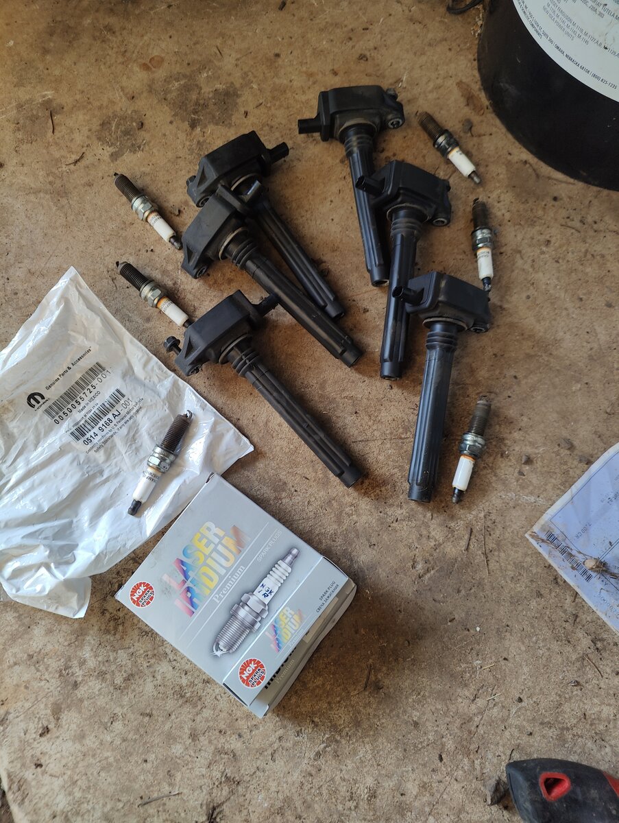

Today I pulled the intake off the JK and replaced the oil cooler with an all aluminum Dorman... really impressed with the construction and it came with new sensors and seals. Also replaced the coils and plugs...no maintenance history on this 2012 so I am assuming these are the originals with some 150k miles.
Valley was full of oil...took a lot of towels and break clean. Intake and throttle body were a mess. Broke 5 of the 6 coil plugs and zip tied the plugs to the coils. Going to find replacements and depin the originals.
YouTube videos make it look too easy. Took most of the day.

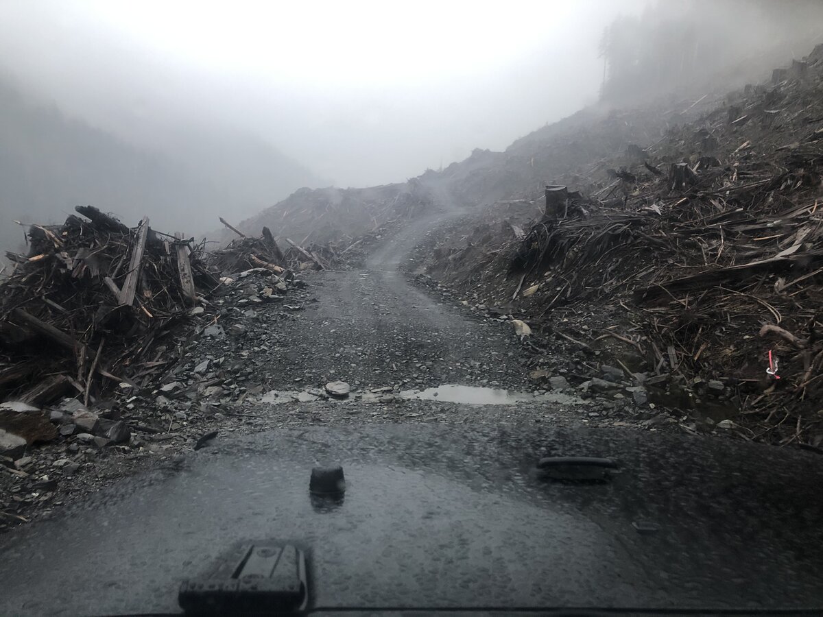

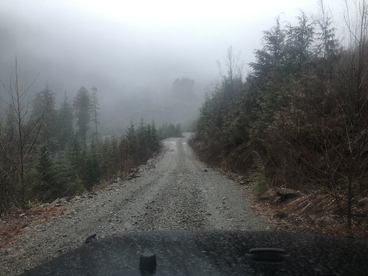

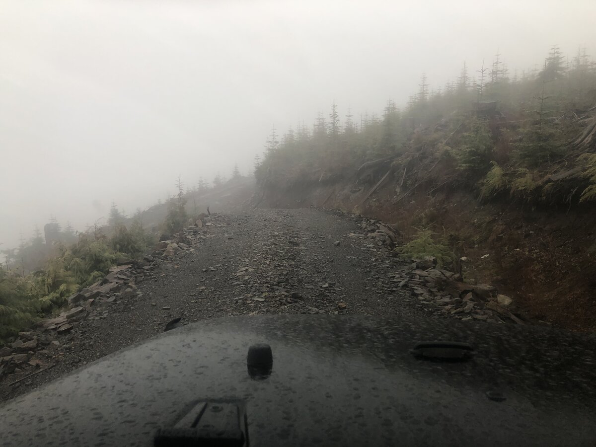

I've seen bears in this specific area a couple times.
It's very secluded so will come across them on the trail.
They sorta panic and start running than bolt off the trail.
When I do see one will stop and give them a couple mins
so they don't think being chased. Saw a mom & cub in the
spring. Didn't see any yesterday .

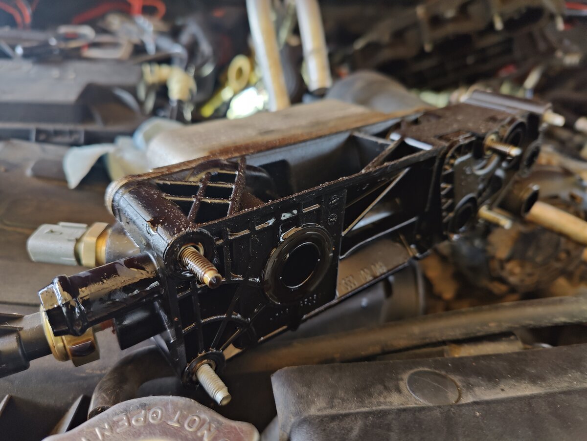

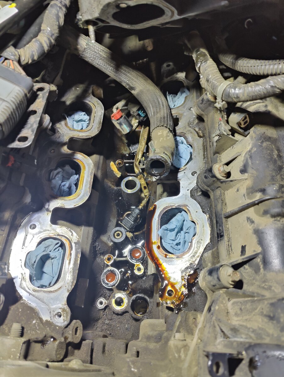

Back from wheeling at Brown's Camp over the weekend...took our JK and TJ and did Power line, Bates Trail, Firepower and Cedar Tree. Accidentally did a small section of Crusher and got about halfway through Firebreak. Got some great videos for YouTube once I finish editing.

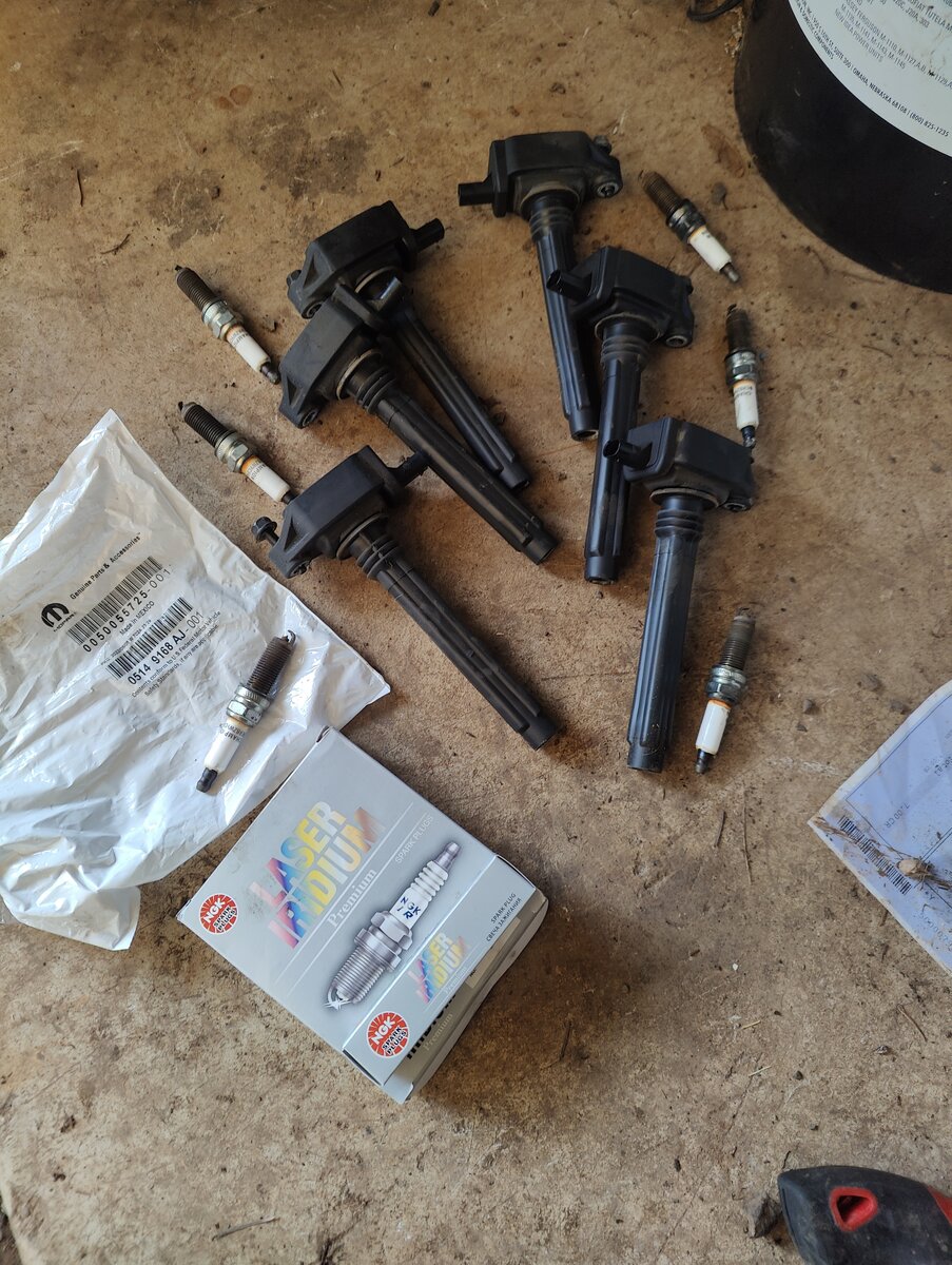

Least you got the plugs out without too
much of a hassle.
Went to do my plugs on the weekend.
The boots are seized to the plug. Didn't
want to destroy the wires as don't
have any replacements just yet.
Now kinda thinking about just bringimg
it in to get plug s done. Sounds silly but
I'm also concerned about getting the actual
plug out . I have no idea how long these
have been in.

Cut the top of the boot where it meets the coil...stretchy enough to pull up some...then fill some of the boot with silicone spray and it'll come right off...they spray some break free in for the spark plugs.
Facebook post I made has a time lapse...

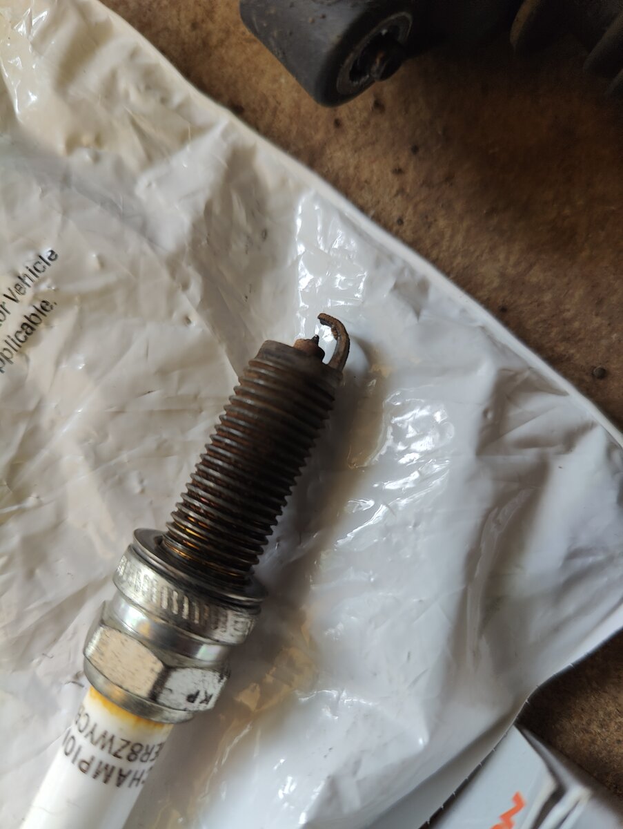

Mine have been in for 12yrs. I got the easy one out (and that was a Bitch), it was okay, gap to spec. I only have 72K Kilometers on the the JK, so forget the other 5. They will out live me.
