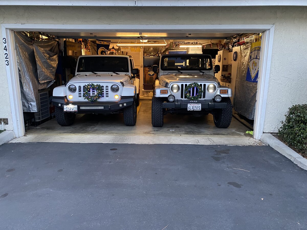

I had to do this today.

I finally ran the trigger wire and the output from the relay/fuse to the rear bumper lights.
Now they shine when wanted/needed.
On manually
On in reverse
Off
I’ve got to say that running wire inside the tub in a JKU is easier than any other vehicle I have ever owned.
When you pluck that carpet edge out from under the trim cover, you’ll ask yourself why the carpet feels so flimsy… don’t be alarmed, I t’s to help it dry better than standard carpeting with that thick pad under it.
It also snaps back into place with almost zero effort.
Also added the obligatory Christmas wreaths…
The TJ is wired to the DRL circuit, so it goes off within a minute after turning off the key. Stays off while cranking, and only works if the battery voltage is above 12.5 or something like that.
The JKU is wired in place of the front camera for now.
In an attempt to be different from others, I pulled the trigger power for my switches from the power window circuit, which gives the lights a few minutes of power after the ignition is off, so long as the doors remain closed (& the switch has been engaged).

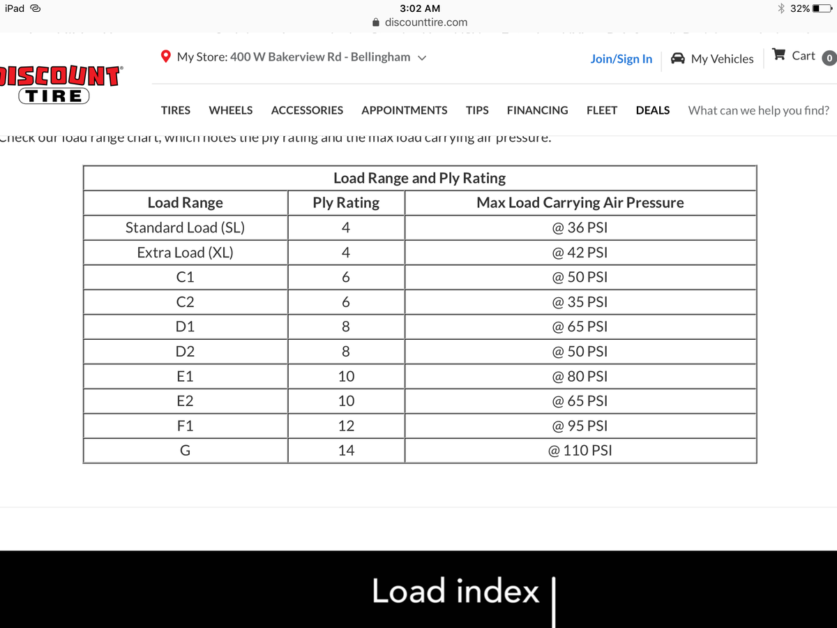

Thanks for the info. Out of curiosity went and checked her KO2 and they are load E rated. The E2 rating at worst case should be at least the same or better ride than the E rated ones.
TBH when you first mentioned E1 vs E2 wasn't sure what the number value
was as never heard of it . Did some googling . It's the max amount of air pressure
recommended for any given tire rating . This is just a general chart from Discount Tire
Individual manufactures may have dif specs for their tires but gives you an
idea. Already running an E ? I'm running factory Rubicon shocks in my Sahara and it
wasn't a good match . Maybe if your on aftermarket shocks so ride isn't as stiff ?
Either way can't go wrong with the C .
Either way can't go wrong with the C . View attachment 123168
Her Sahara has the AEV 2.5 lift with Bilstein shocks on it. They just called to let me know everything was in. I did a little research too and the E2 as you noted can run at a lower pressure which in theory is supposed to give more of a “float” fill since they can handle the same load at a lower pressure. The guy at America’s Tire claims with the E2 that they will be closer to a C than a typical E, and they won’t inflate to the same pressure when installing. I figured to keep them since she already has rated E tires on it with the KO2 along based on what the guy said.
