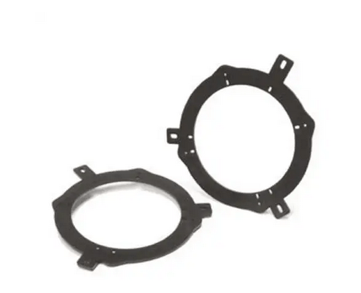

I hope you ordered a Jeep-compatible speaker.

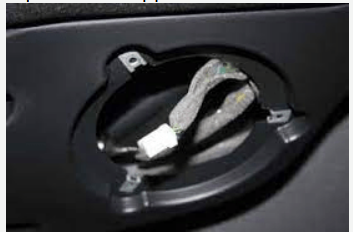

You'll notice the soundbar and front speakers have these 3 external tabs on them that bolt to a bracket inside the speaker enclosure:
Most car audio speakers don't have these three tabs, instead the mounting screws on the speaker are through a hole on the rim or frame of the speaker itself, such as the Rockford Fosgate Punch P1650s I installed in my JK:

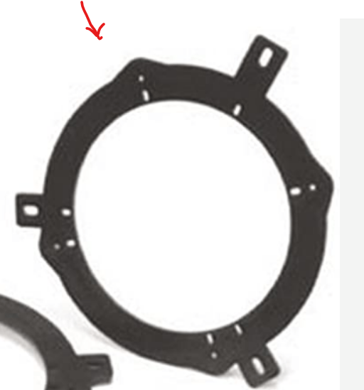

If you ordered an aftermarket speaker not specifically manufactured for a Jeep, like the Rockford Fosgates I put in mine, you'll need to order a pair of SCOSCHE SAC656 speaker adapters:
If you ordered Kicker upgrades that are Jeep compatible, no worries. If you ordered something else and find out they might not work, let me know and I can walk you thru my install.
I ordered Kicker CSC67 6.75" as well as the adapters but I can't seem to figure out how to secure the speaker to the adapter. It won't attach flush in the enclosure. Any tips?
The adapter mounts to the soundbar, the speaker mounts to the adapter.
That being said, when you remove the original speakers, you need to keep the threaded U-clips (speed clips) if the speaker has none with them.
The SCOSCHE adapters need to be trimmed once you figure out which of the tabs/holes align with your speakers.
The speakers will ultimately not fit flush inside the soundbar because the adapter will extend it down from the soundbar.
So, the 3 tabs on the adapter will mount to these u-clips or speed clips.
Then, trim off the 4 lobes from the outer edge of the ring if you're not using those for the speaker mounting holes. There are scored lines that you can simply run a blade along and then snap them off with pliers.
Let me know what's going on and I'll try to elaborate further.
I have the tweeters in my enclosure as well so my setup doesn't look like this. I'll double check to see if those clips are in the enclosure. Also my adapters have lobes on the inner edge that I'm guessing will need to be trimmed and then the speaker will fit better. I'll give it a go and come back with any issues. Thank you for the assistance!
I have tweeters in the soundbar, but they are separate from theses speakers. And, yes, the inner lobes will have to be removed as well.
What year Jeep are you working on?
2018 JKU. Yes, my tweeters are separate as well. I actually found a video that helped me. Different set up on the sound bar but same speakers and adapters as what I have: https://www.youtube.com/watch?v=fbuLXd1BWy0
Turns out I didn't have any hardware to bolt the speakers to the adapters. Nothing loose in my toolbox would fit, so off to the hardware store to grab 8 nuts, bolts and washers to attach the speakers to the adapters and I should be good.

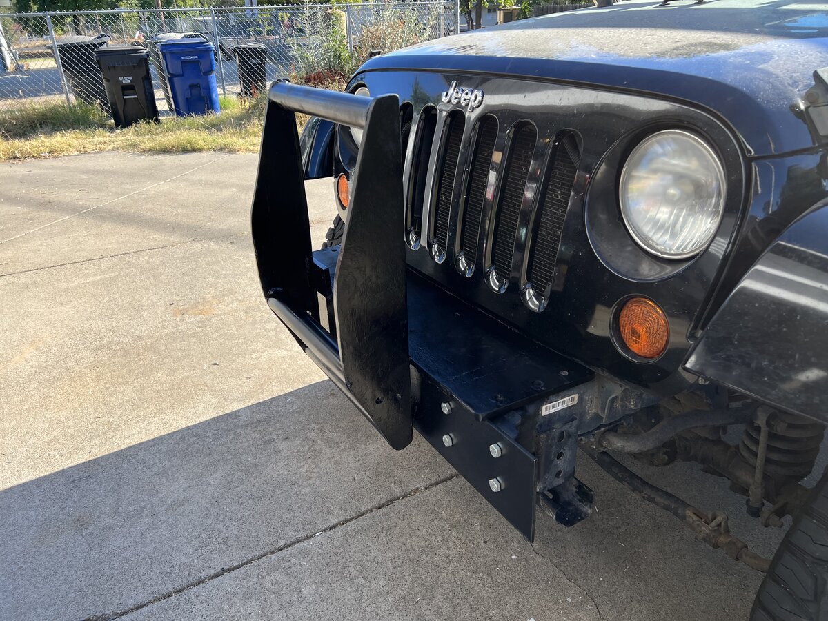

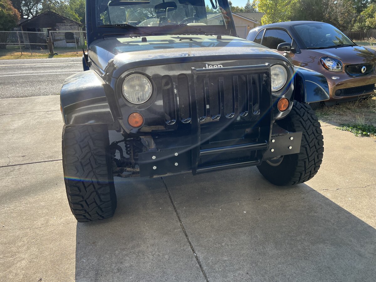

Put this bad boy on my son’s Jeep. Took a lot longer then I had anticipated but took a whlie to get the holes lined up with the winch that will be installed on it, to get the front plate centered to the rest of the assembly. Not done yet but made good progress today, even though was 105+ out today.
Story is, my dad worked for Southern Pacific and he it made in the welding shop back in 1987 when I bought my YJ. It was on it for about 10 years and has been siting out in the yard for about 18 years now. The boy cleaned it all up, got the rust removed etc. It seemed easier to install on the JY, it basically sat on the front steel bumper then mounted to the frame.
