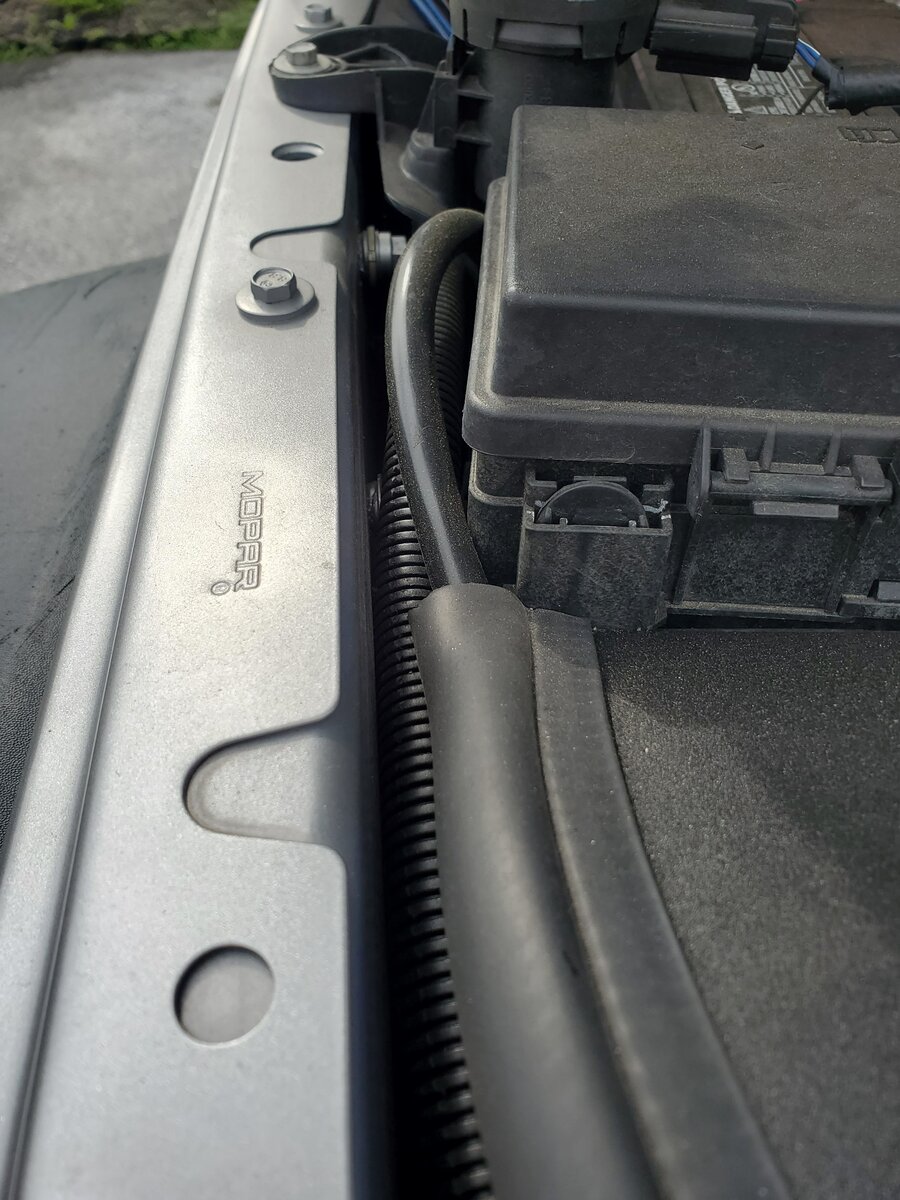

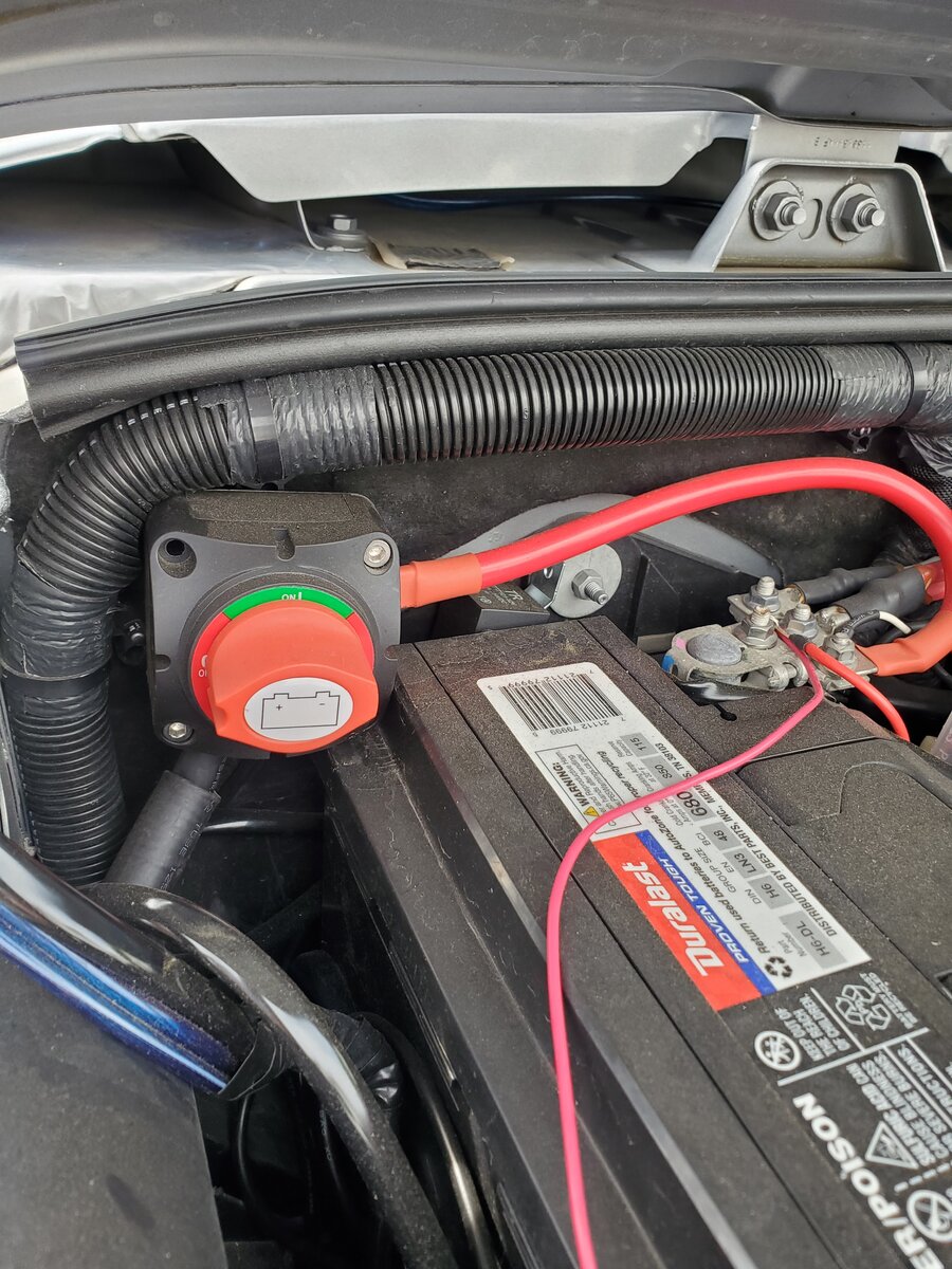

The negative wire was just long enough to reach the battery terminal the way I ran it.

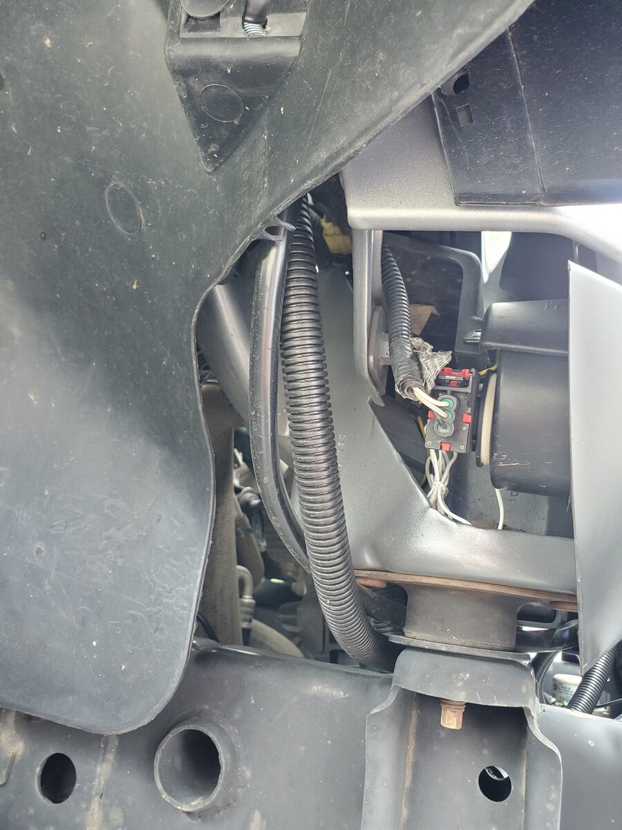

I have my wire ran from the winch, under the grill, up behind the passenger headlight and tight against the fender. I unmounted my fuse box to keep the wire against the fender and then tightened everything back up. I didn't use any of the extra wires.
Thanks for the pictures and information! I’ll take another look at my routing method.

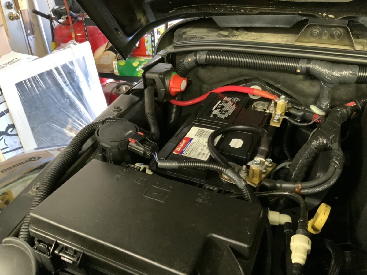

Call me stupid, but how in the world did you mount the disconnect box to the fire wall? The nuts are designed to go into bottom of the box to screw then bolts into (which area extra long). Given this this base doesn’t attach to the switch? Wire is routed.
Update - came up with a different solution and mounted the disconnect to the side adjacent to the battery. There is a picture in another post. Worked out well.

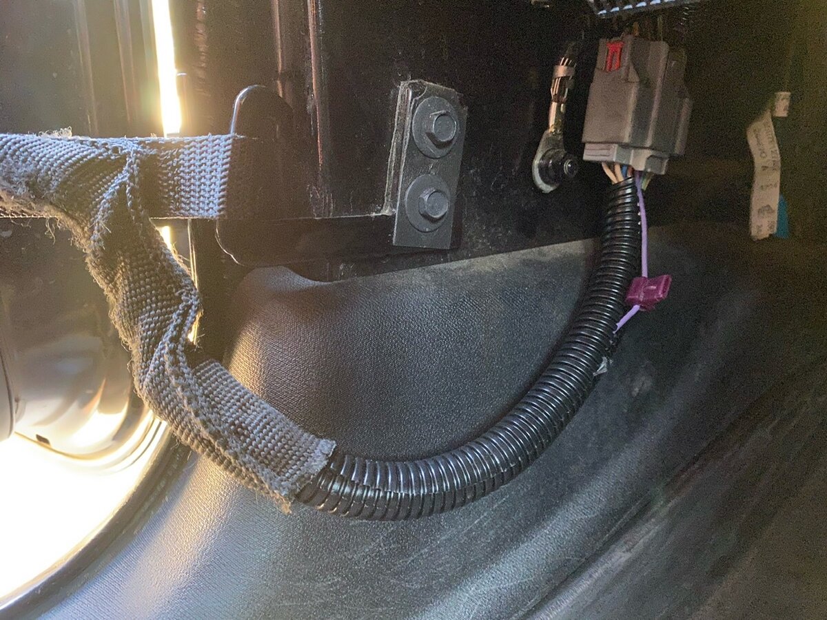

Did a a few things;
1. Installed door handles
2. Hooked up power for the winch.
3. Fixed the rats nest at the door harness from the PO who tapped into it. (See other posts)
4. Installed new RR WSS (no picture).
