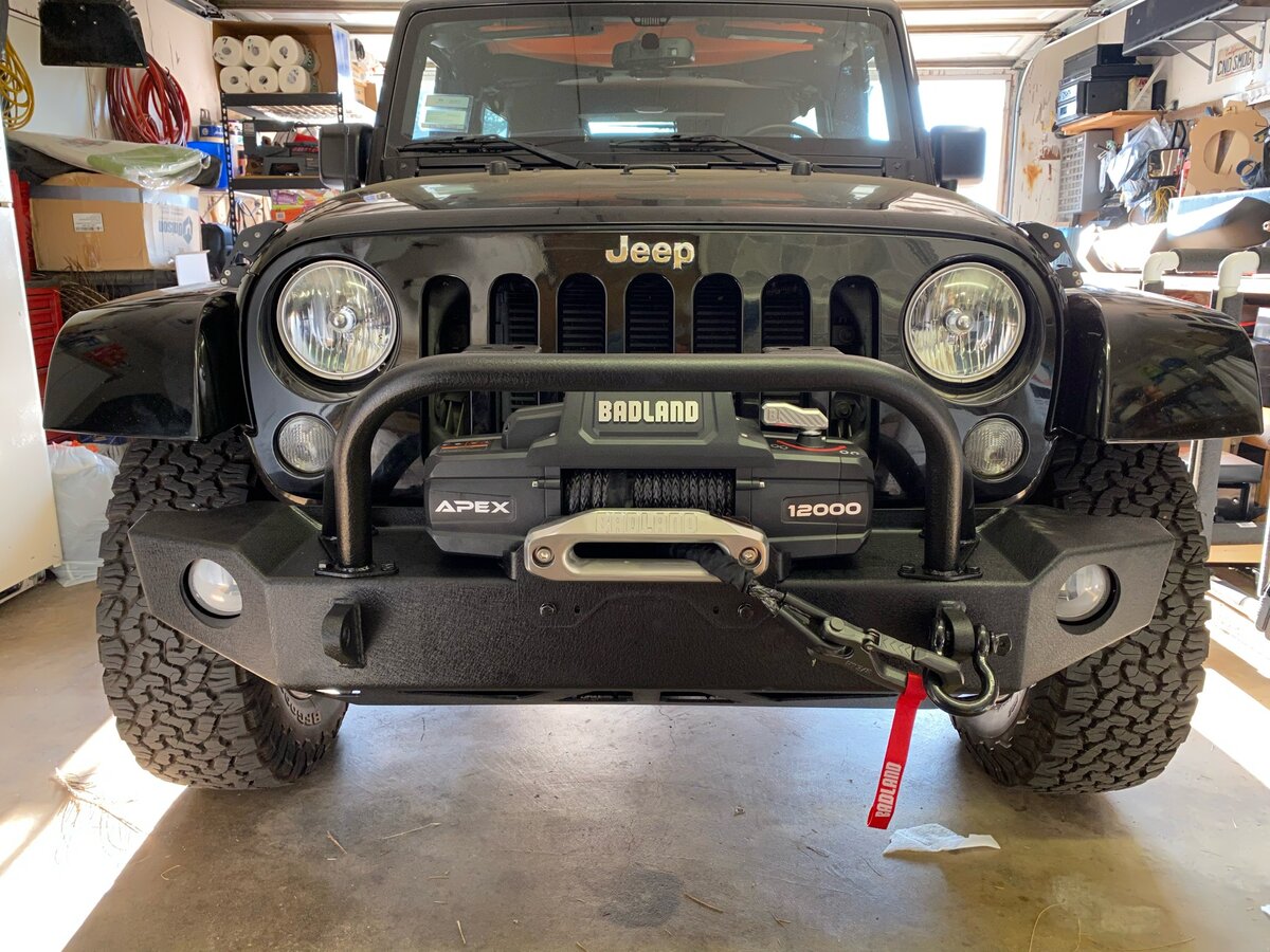

Removed the factory bumper, put on a steel bumper and the Badlands Apex winch. I haven’t hooked up the power yet, for one I need to figure out where to put the disconnect switch and how to mount it. There doesn’t appear to be mounting holes / brackets for it so will need to come up with somthing.
View attachment 119697View attachment 119698

No worries, we all have busy times. Thank you for the thoughts. Not sure what I will do, I’ve never installed a disconnect switch on a winch before and never had a problem. I was wondering if it had something to do with the fact the winch can be operated remotely. Wonder what the risk would be from someone else’s remote (or some device) being able to activate the winch? If I don’t install the switch I’ll need to come up with a method to lengthen the cable as without out the disconnect switch and the extra 12” of cable its too short.

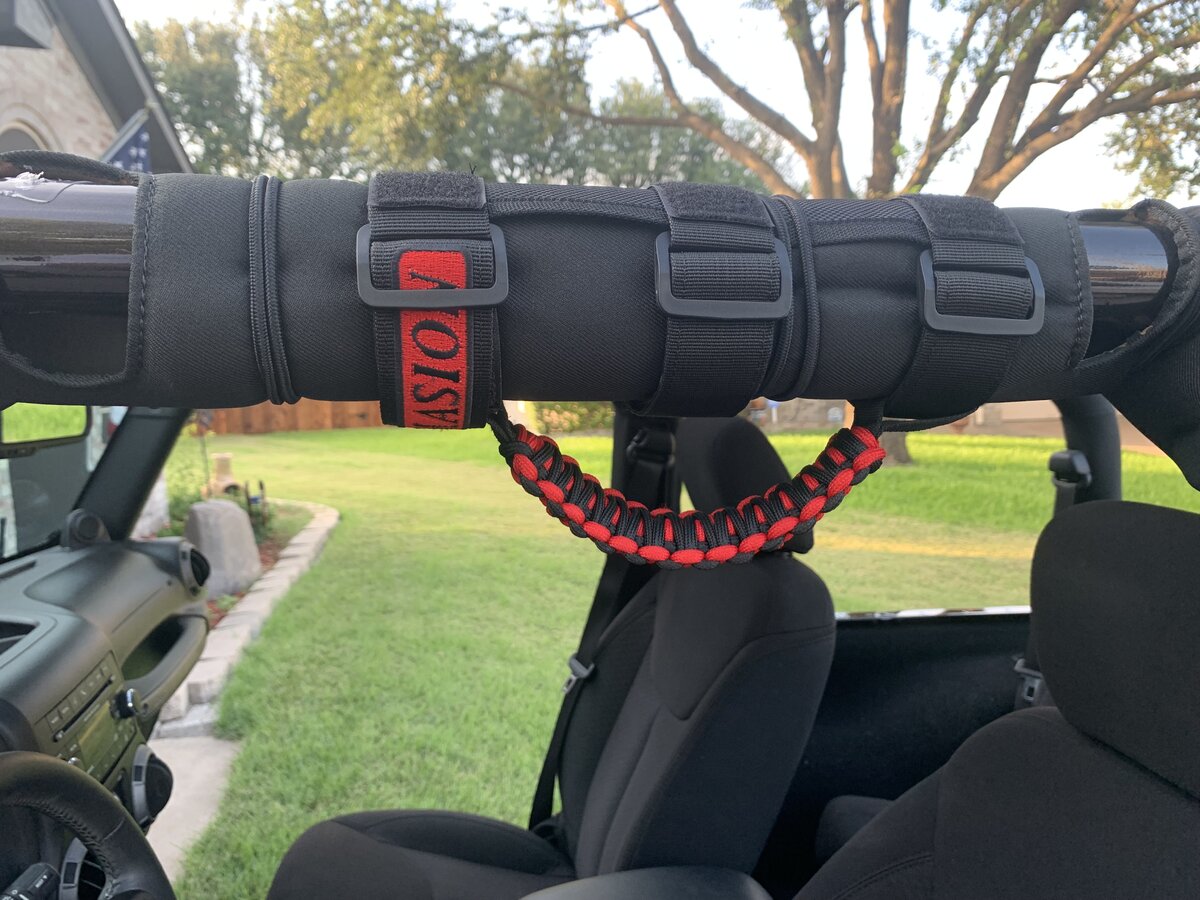

Added grab handles and grill inserts.

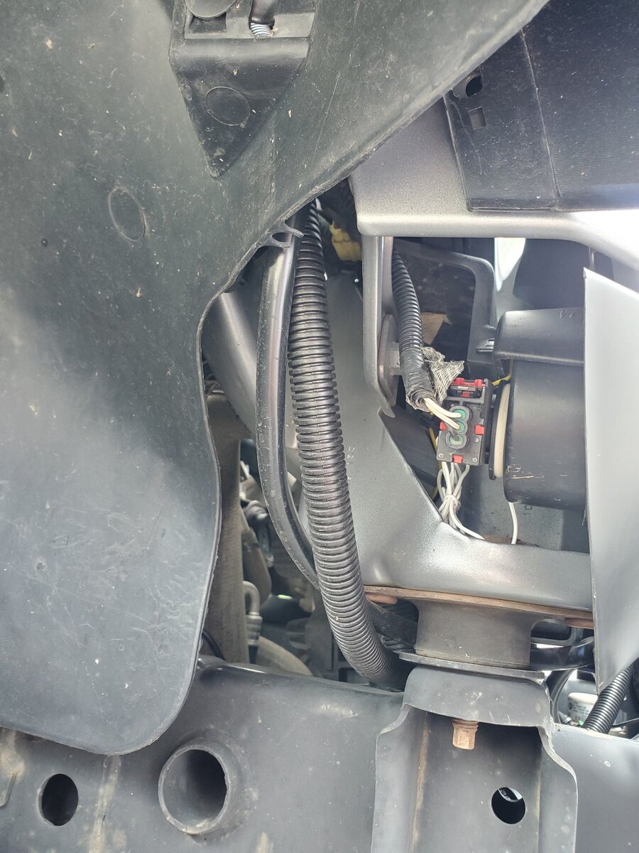

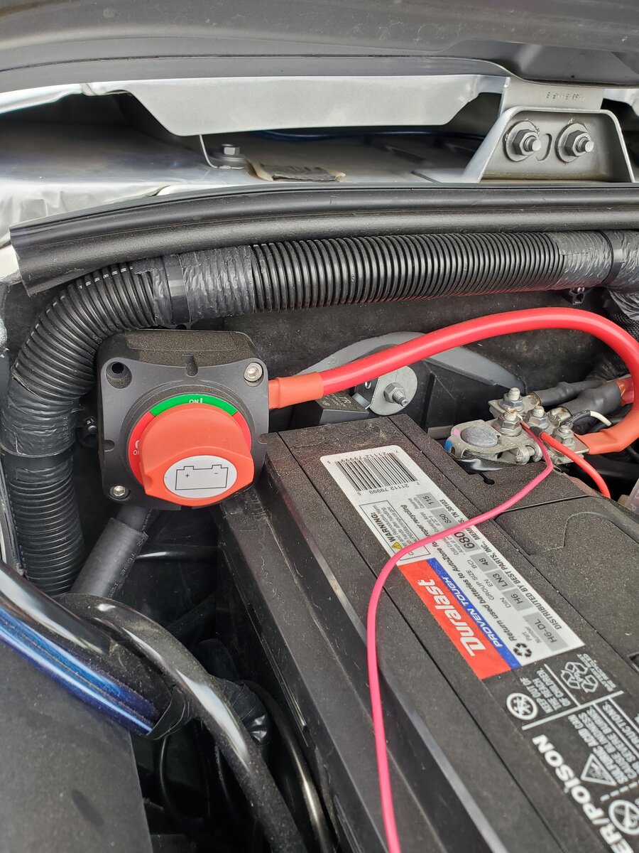

I did use it. I have it mounted to the firewall behind the battery. I'll try and get a couple pictures for ya.
That would be great. Did you switch out the cable from the winch then? Mine seems too short to reach that far. Maybe I should route it different. I have it routed to the passenger side fender area, up behind the headlight and then straight back towards the battery.

OK I'll get some pictures tomorrow after work for ya. I used the cables that came with mine.

I have my wire ran from the winch, under the grill, up behind the passenger headlight and tight against the fender. I unmounted my fuse box to keep the wire against the fender and then tightened everything back up. I didn't use any of the extra wires.
