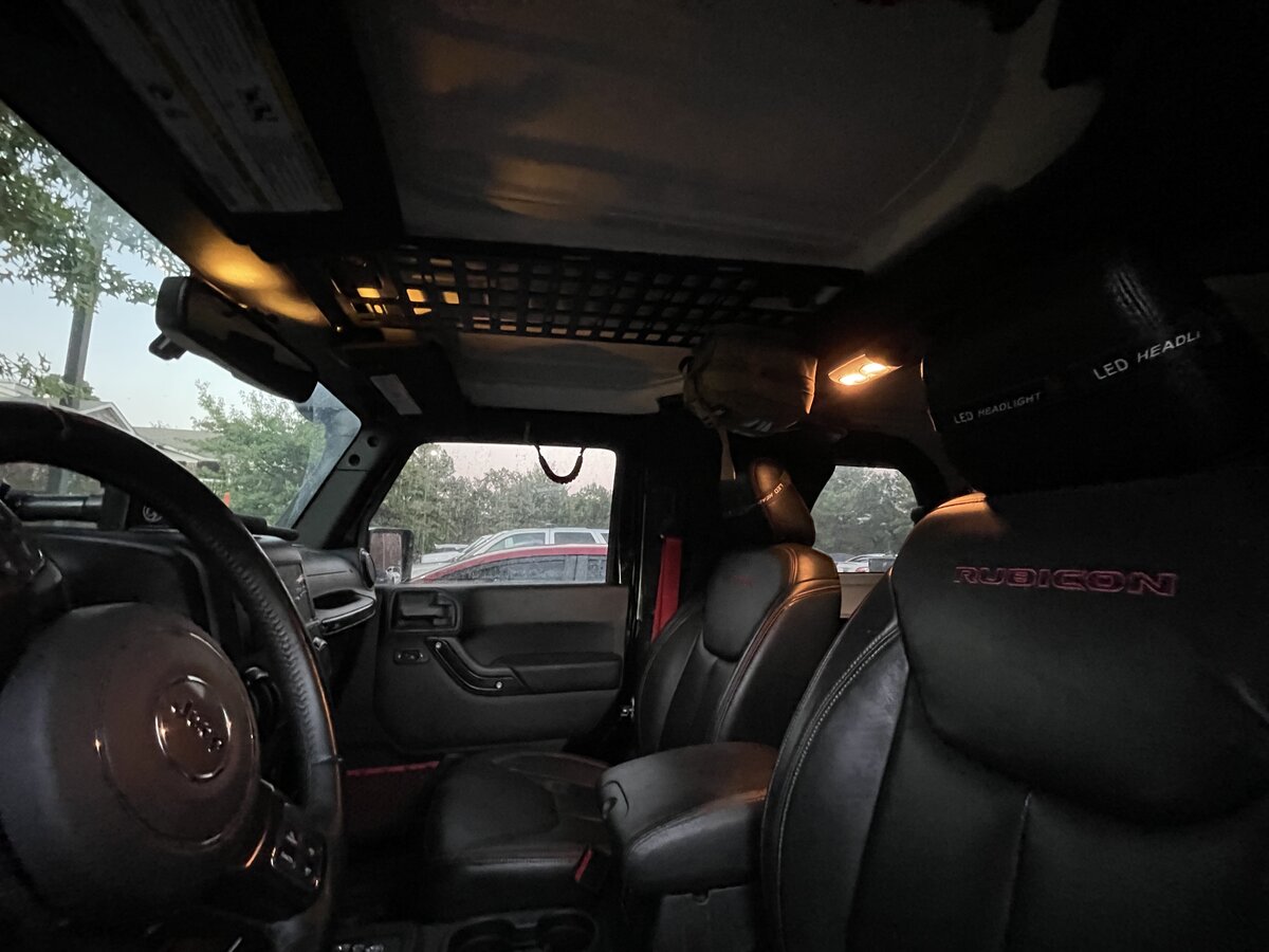

Installed the JCR Off-road Overhead Molle panel. Wasn’t able to get great pictures due to it getting dark, but only took about an hour.
also….nutserts are from the devil! Even with a professional nutsert tool they suck! One of the two spun on me, but luckily the bolt was in enough before it started spinning. Might try some JB Weld over the weekend.
Haha! Sorry... I do kinda agree that nutsert installation requires a certain "je ne sais quoi"... touch? Maybe it's part art form. I'm out of practice but have used them many times in the past and occasionally have had a spinner. Ah well. At least the install looks good ;)
If the metal is deformed even slightly, I think they spin. Damn things!

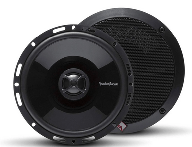

You'll notice the soundbar and front speakers have these 3 external tabs on them that bolt to a bracket inside the speaker enclosure:
Most car audio speakers don't have these three tabs, instead the mounting screws on the speaker are through a hole on the rim or frame of the speaker itself, such as the Rockford Fosgate Punch P1650s I installed in my JK:

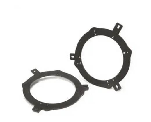

If you ordered an aftermarket speaker not specifically manufactured for a Jeep, like the Rockford Fosgates I put in mine, you'll need to order a pair of SCOSCHE SAC656 speaker adapters:
If you ordered Kicker upgrades that are Jeep compatible, no worries. If you ordered something else and find out they might not work, let me know and I can walk you thru my install.

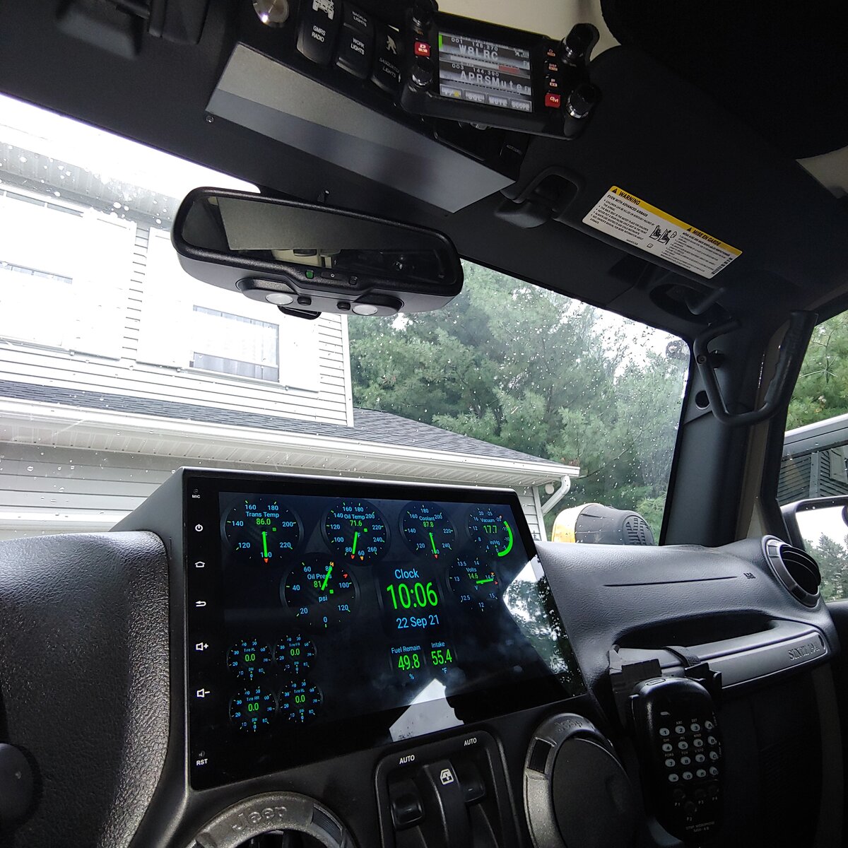

I took mine in to have a shop fix the AEV spare tire carrier (replaced the bushings). I have an android headunit, ham radio, over-mirror switches, a-pillar switches. Oh, and a dashcam. This is what the center stack looked like when I dropped it off. I was playing with Torque and dashboards and forgot where the setting was to keep Torque from automatically starting. Normally the head unit displays the radio as the "home" screen...
Just out of curiosity, I played back the dashcam video (forgot I had audio enabled, too). Listen to the commentary (the rattle is the carrier).

What headunit is that??
It's a Dasaita 10.2 inch Android, got it a few years ago. I would not recommend it to an Audiophile or someone that doesn't like tweaking things. It sounds as good as the stock unit (better with the right eq) and I expect it will improve when I eventually upgrade to better speakers. I wanted a full Android unit and not be limited by Android Auto.
Stock headunit isn't very good, why I'm looking to upgrade. I have the stock navi, so looking for android so I can use my own (waze).
