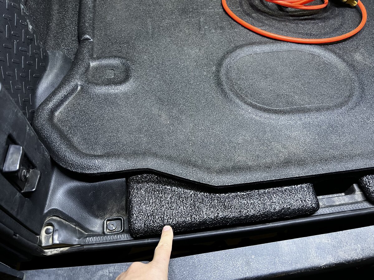

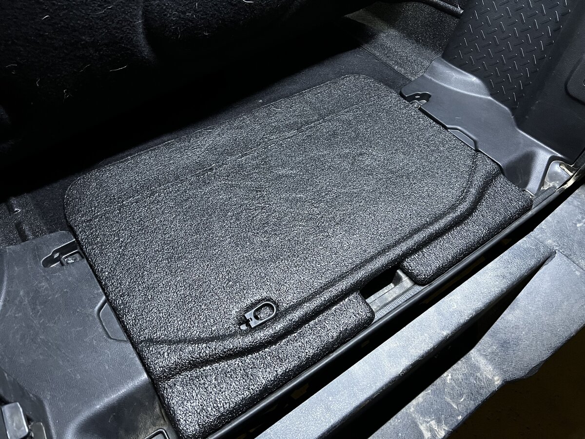

Acry-tech Duratex’d the carpet on the rear cargo lid. Took two pints but now it is rock hard, durable and easy to clean. It was the only carpet left in the Jeep, I have armorlite everywhere else. I hate carpet, I have a husky, and generally hard to clean.
View attachment 123317View attachment 123318
Looks good! When summer comes back, I want to ditch my carpet so I can spray bed liner inside. Did that to my WJ. Miss it on my JK.

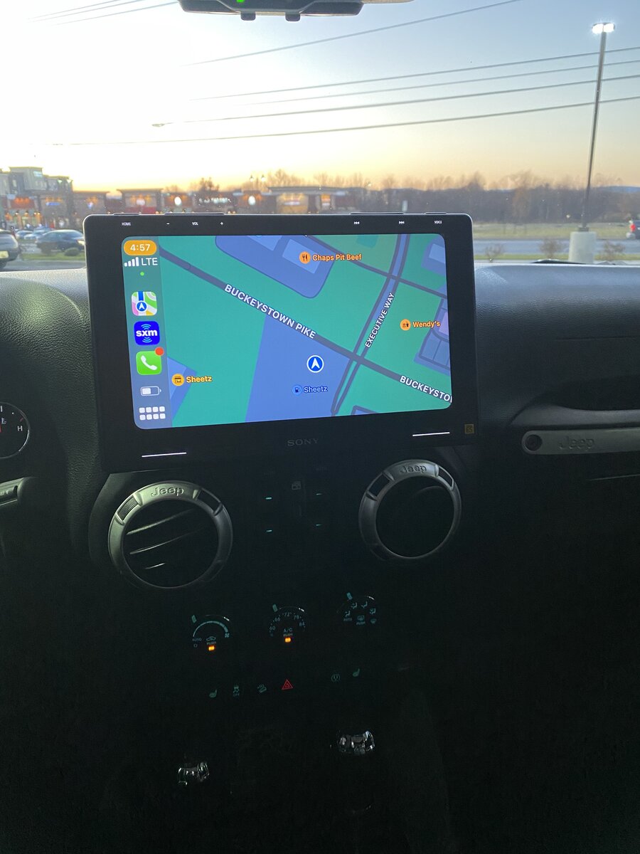

Installed our Sony XAV-9500ES which will launch this weekend at- Trail Seven!
Check us out for our current line of Plug and Play Sony Head Unit Bundles! Sony Bundles!

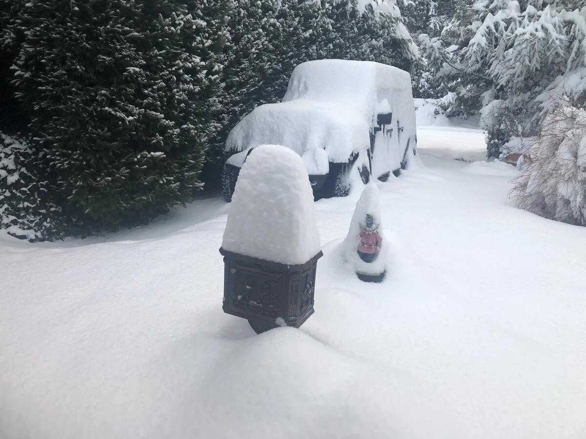

Stalingrad or the Donner Party. I have no mules to eat so I guess it is the Doggy, then my wife eats me next, she has some body reserves, I do not. All Good Merry XMAS forum. Have to save my UBOAT
batteries for my inverter now. Solar panels, what a F-ing joke, from my Prime Minster who is vacationing down in Jamaica right now.
