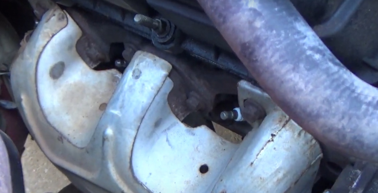

Once we started it up noticed smoke coming from the passenger side exhaust manifold area. It is coming from the front hole of the heat shield. He changed the oil and said he spilt some while pouring the oil in. Hopefully that is it, but seemed to smell more like exhaust. But it also continued to smoke after we turned it off.
Would be terrible if something else happened when it got hot.
