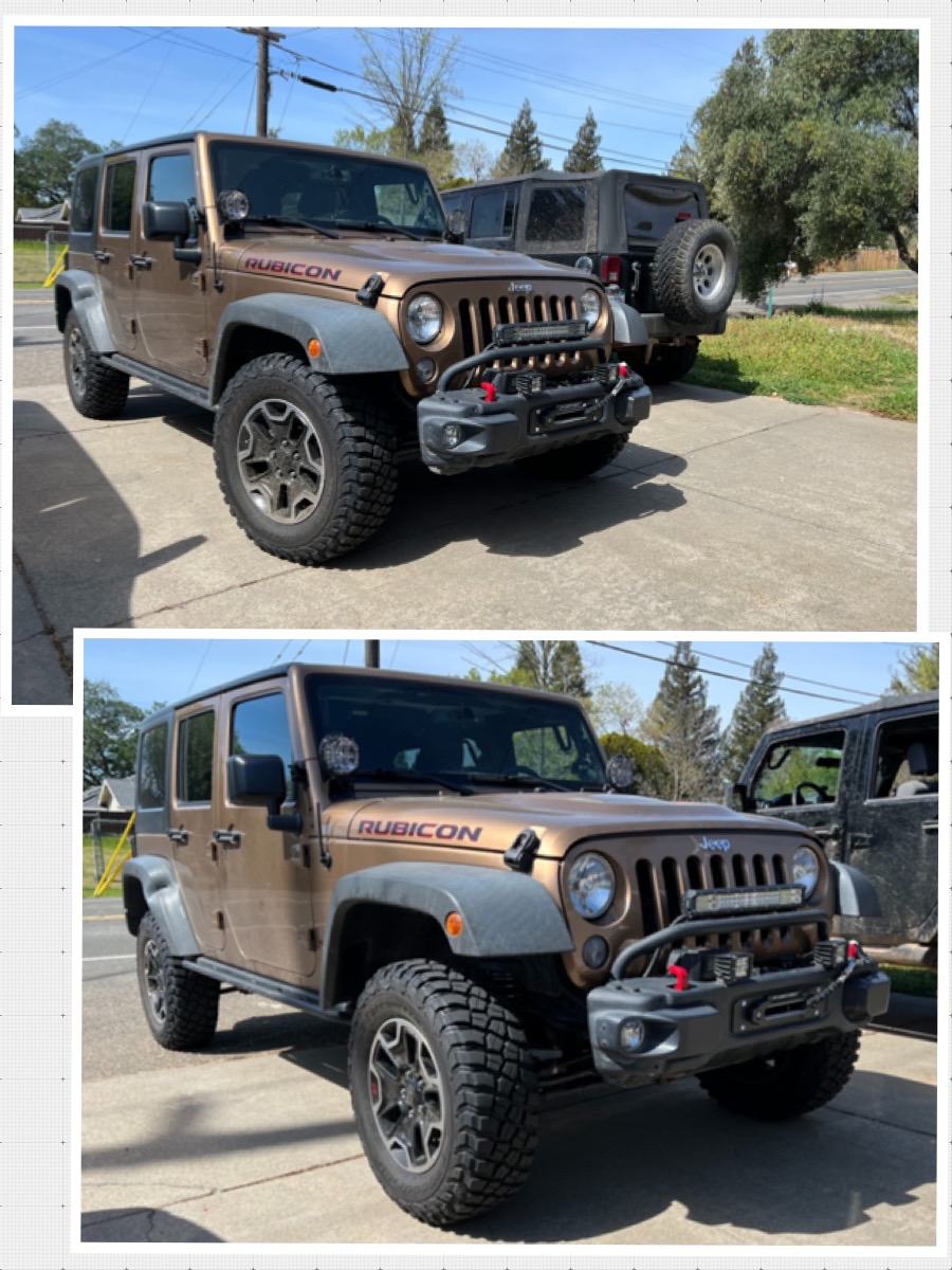

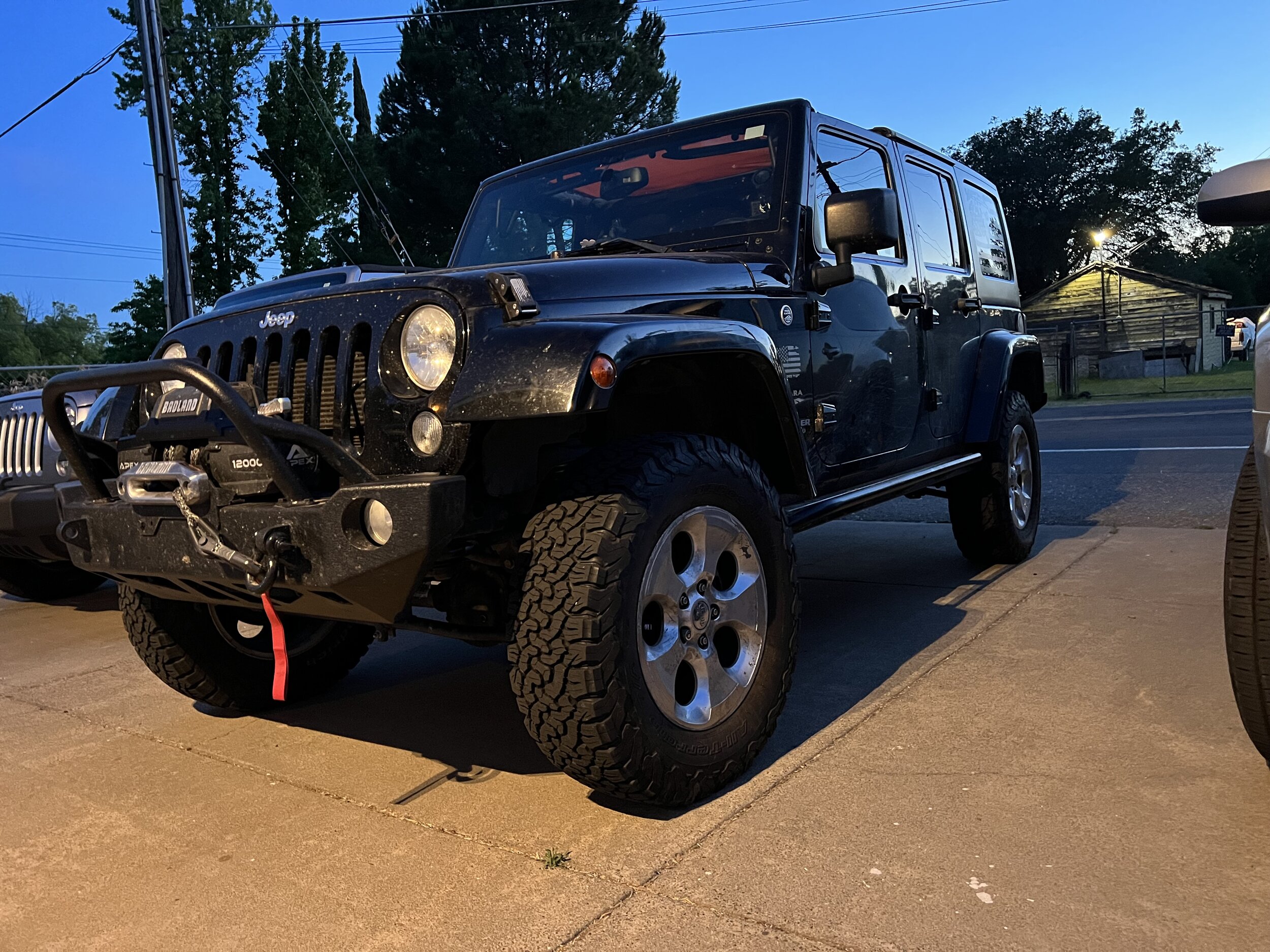

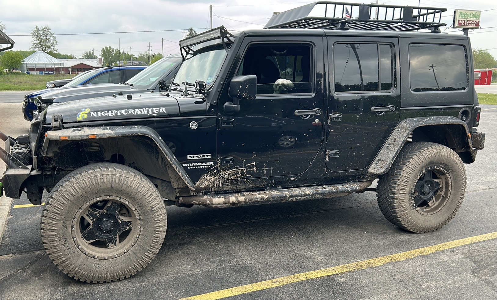

I did not use the drop brackets. I ordered them for the first lift, but never used them. They are sitting in the garage. Here are some before / after pictures.

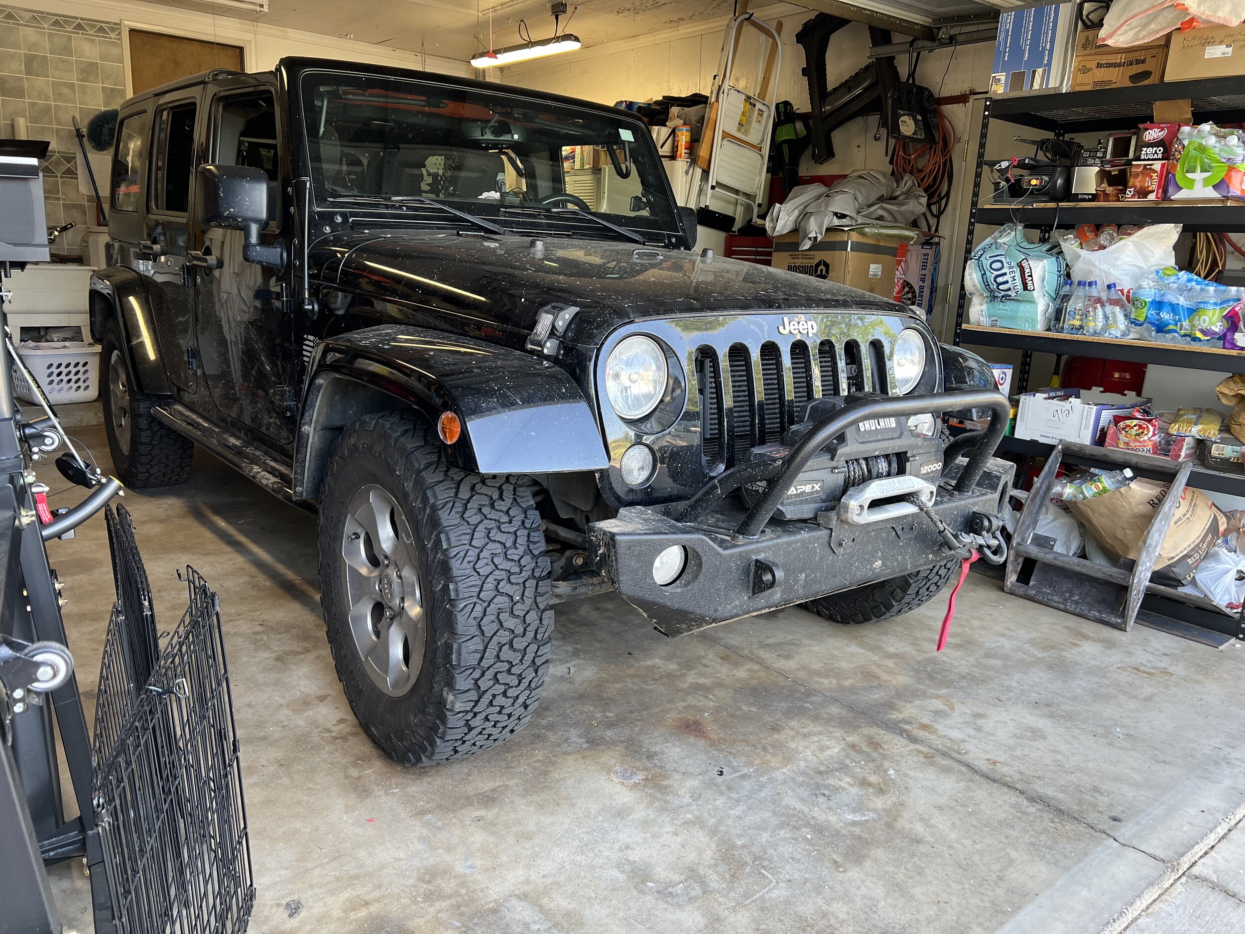

Yeah I'm really looking forward to this lift. I have some BFG All Terrains 285/17's that a friend gave me from his JL that will go on with the lift. The 33's shouldn't affect the gear ratio much, and I'll run them and see if I want to go to 35"s. But that will need a re-gear so we'll see.
Yes, I did order the geometry correction brackets as it seems to keep the front axle close to where it is setup stock.
I'll definitely post before and after pictures.

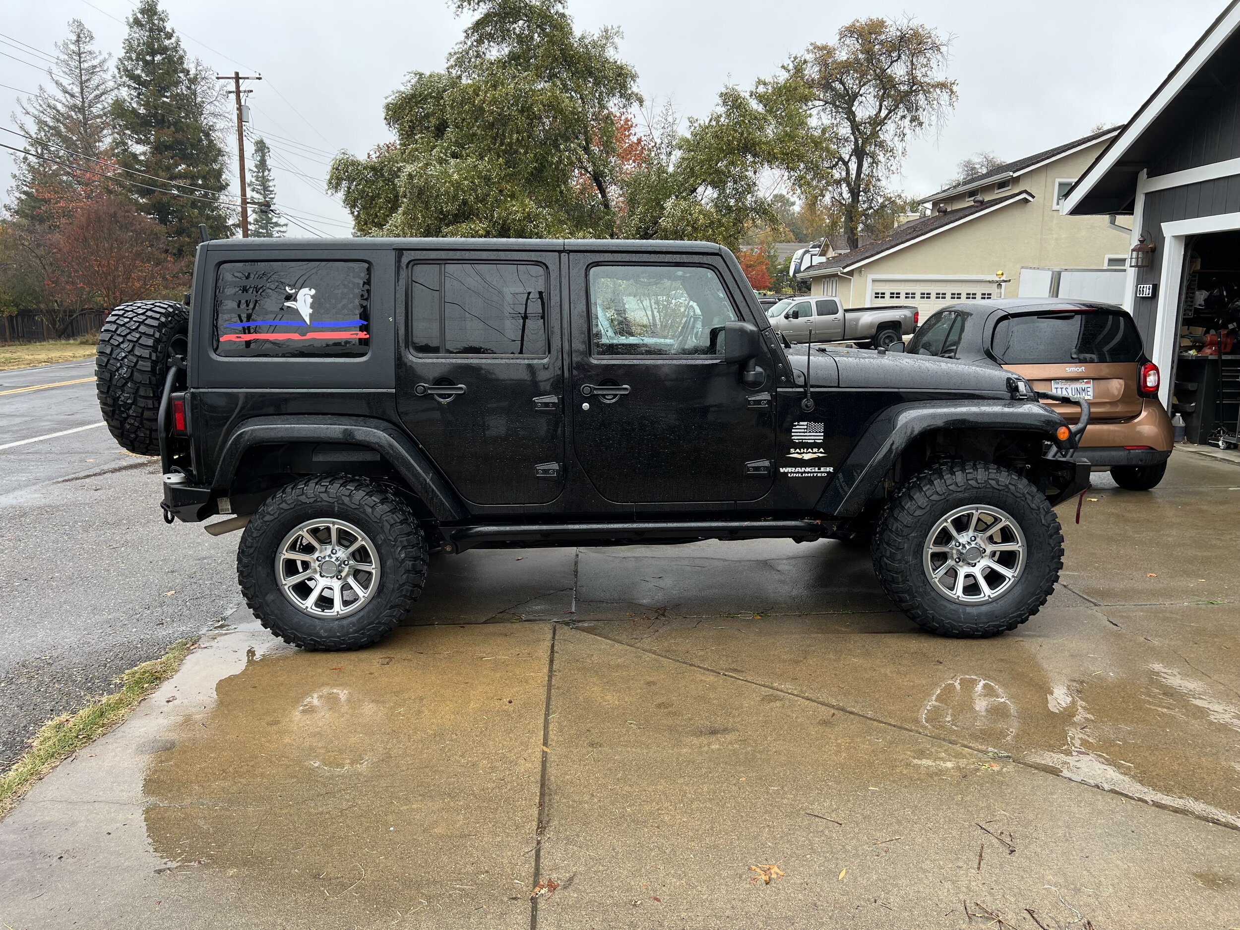

The wife has 33” with 3.73 gears and they work fine. Here is picture of hers with the 33”.

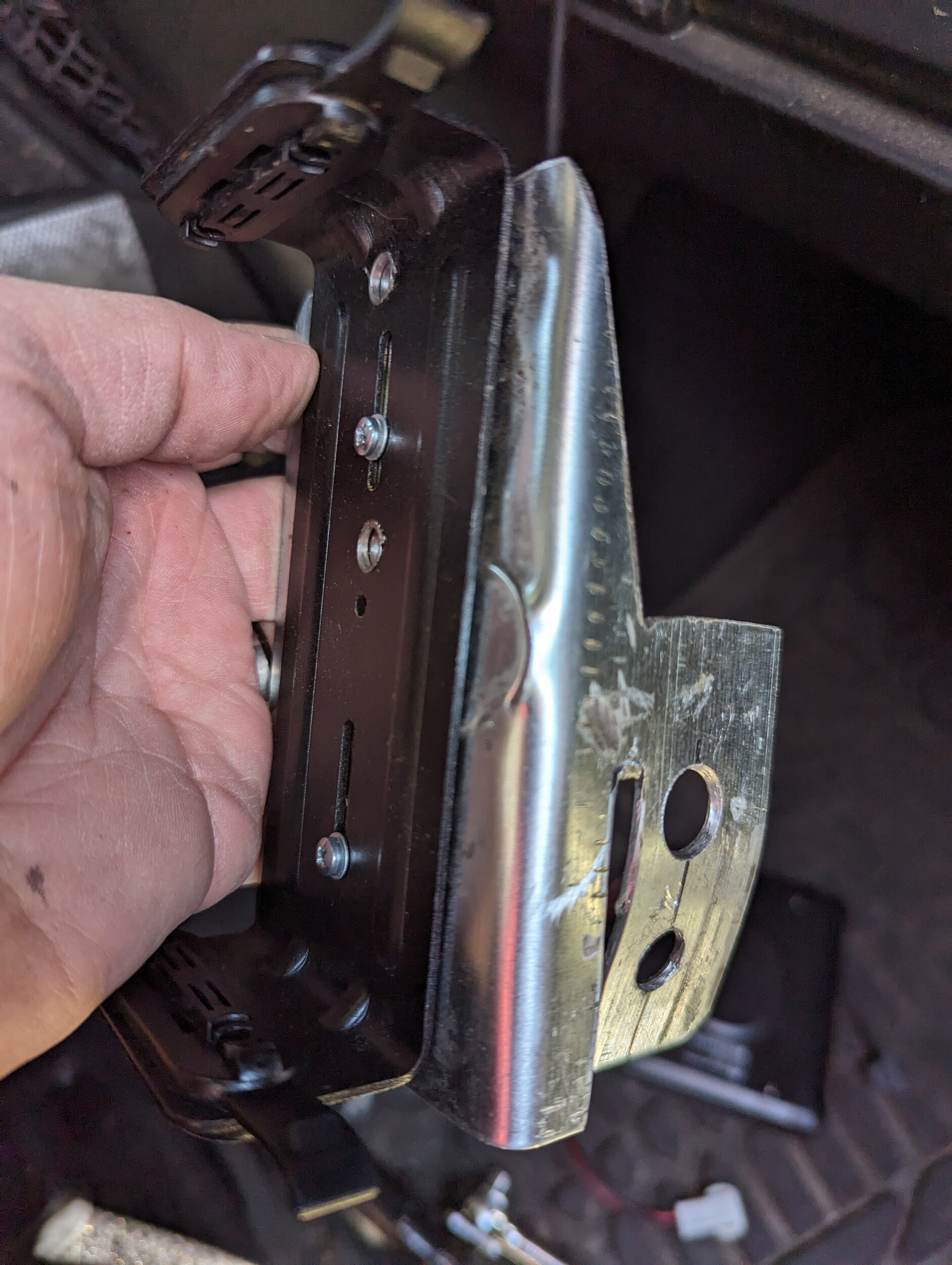

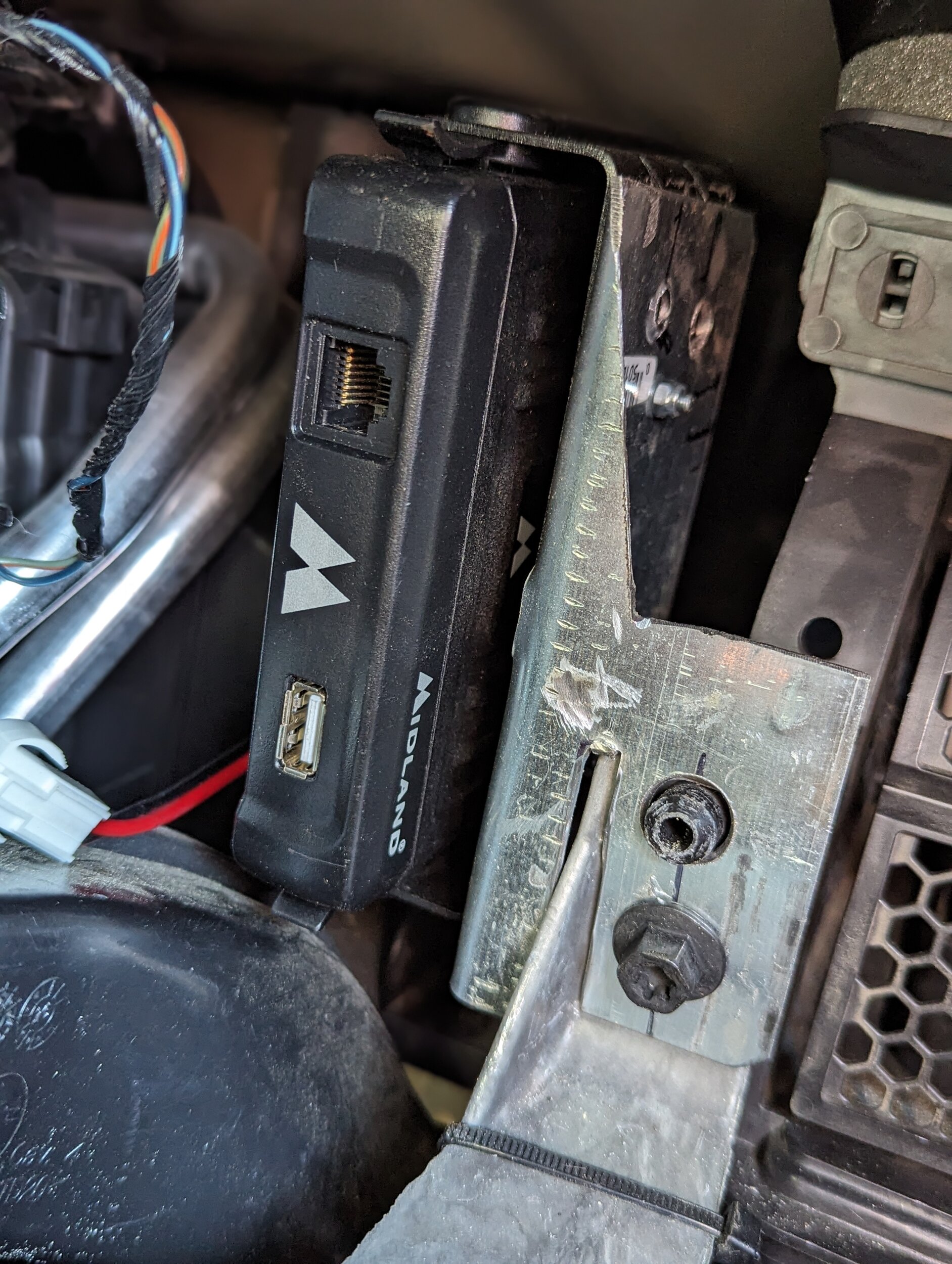

I have a Midland MXT-275 gmrs radio that has been velcro'd to the passenger side of the center console for a couple of years. I HATE it there, but have been flummoxed with where I should mount it. Available real estate in the JK cab is more like Manhattan rather than Montana, so I searched for ideas. Found a contributor in Reddit some time ago and copied his idea and since I haven't seen it on any other forum, thought I'd share.
I went rummaging in my stack o' stuff and found a 2-gang galvanized electrical box cover and some nuts/bolts. A little time with my grinder, drill and the vise, and viola!
It's mounted behind the glove box in it's original bracket so it can still be removed. I'll make an extension for the mic & speaker, but this gets the radio out of the way and isn't easily seen by ne'er do wells. Not too worried about heat generation since it's only a 15w radio.
Next is mounting the overhead molle panel which will be where this radio's speaker will live, along side my ham radio. And I still have to get my 1/2 doors painted! JEEP not only means Just Empty Every Pocket, but it also means Just EndlEss Projects!
