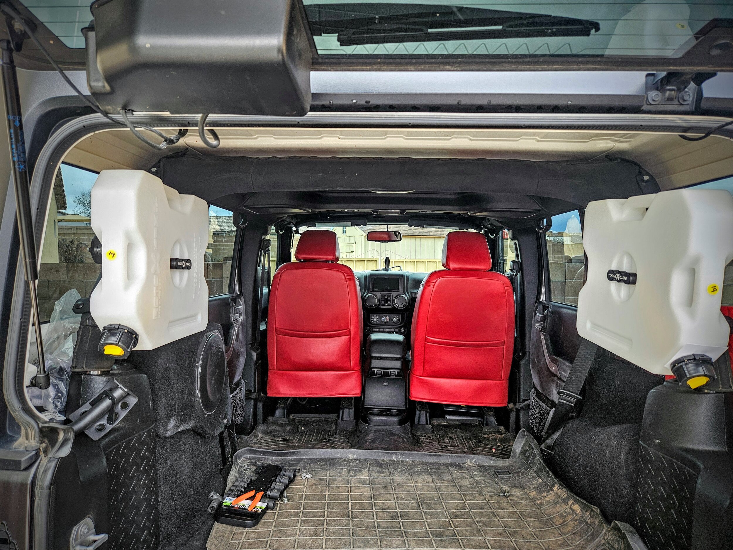

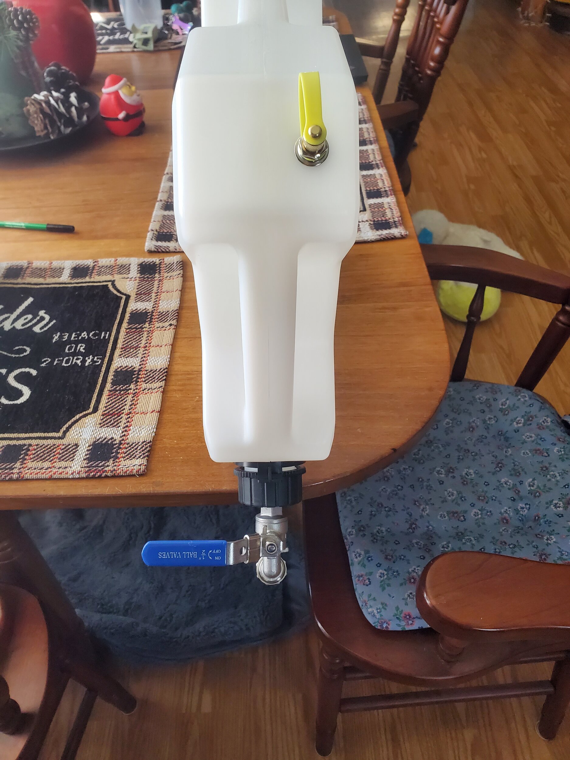

Purchased my 2017 JKU in January and wasted no time deleting the rear seats and adding a cargodog storage system, rotopax water holders, and Quadratec rock sliders before my hip replacement earlier this month. Hoping to heal up enough soon to actually get this out on the trails.
Looks nice! I added a stainless steel spigot and brass breather to my water cans. I was wasting too much water trying to "pour slowly."

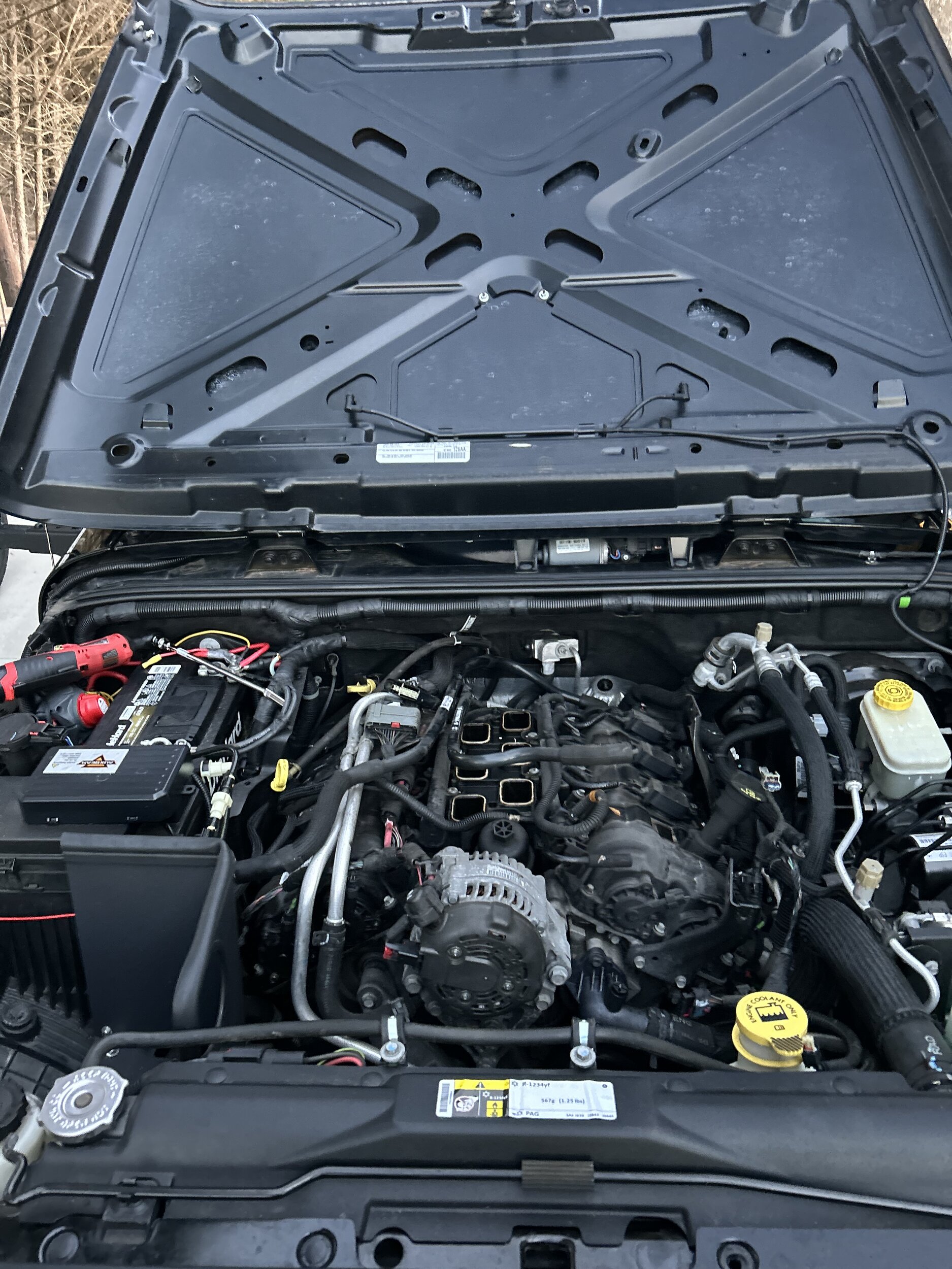

Took Moby out for a local spin again today; no codes, no stumbling, etc. BUT…
With the original ECU installed, my remote locks no longer function.
Here’s the roadmap thus far:
Failed CPS; replaced w/ aftermarket, cleared codes and drove it for a few weeks.
Lightning bolt, limp mode and codes; took it to the dealer who tried to charge me to swap my current sensors w/ known-good sensors from another Jeep… no thanks, replace the aftermarket one w/ a factory part and all was good.
Stumble, limp mode, & codes returned; replaced plugs (badly needed) and coil packs (for good measure).
Cleared codes and they returned almost immediately.
Purchased a pre-programmed ECU; installed and vehicle wouldn’t run more than a few seconds, then wouldn’t even start. VIN programmed into ECU didn’t match our vehicle (NOT plug & play as advertised).
Removed new ECU & reinstalled original ECU; vehicle starts and seems to be running w/o issue. Took a couple short drives and learned the lock/unlock/remote start doesn’t work. Remote start could be due to an active code, but the locks should work.
Returned replacement ECU for refund due to not being P&P as advertised.
Now I have my original ECU in, it runs and drives as expected, but no lock/unlock which SUCKS.
Next step is to reach out to my contact at JSCAN to see if they can help me get these locks working again.
I’ve programmed new keys before, but never “fixed” a non-working one.
This had better work.
On a whim, I swapped the battery on my non-working factory key and to my surprise, the locks now work as expected!
For giggles, I measured the voltage on the old FOB battery and was shocked to see less than 2V now, when I measured it the other day it was over 3V… strange.
That fixed the factory key, but my 2 flip-out keys still do not work the locks. 🤷‍♂️
Since I programmed these 2 keys using JSCAN, I’ll see if they can “re-learn” whatever went bad with them.

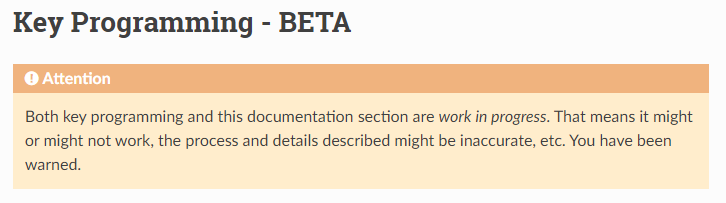

I retrieved the key code using JSCAN and I supposedly "reprogrammed" my flip key - which had stopped working last year, but had previously worked for all functions.
Not really looking for help anymore, as a bit of digging on the JSCAN site on my part has lead me to the light at the end of this particular rabbit hole...
I don't know how long this notice has been posted, as I followed the same programming instructions to program the flip keys over a year ago when I bought them without any issues.
It's actually the main reason I purchased JSCAN. :ROFLMAO:
I somehow got lucky for a while with working flip keys.
In any case, the flip keys are still able to be used to start and drive the vehicle, but the remote functions no longer work.
If we end up keeping the thing, then I'll worry about getting the flip keys programmed by a pro at a later time .
I just want the damned vehicle to drive and be somewhat reliable. I can handle maintenance, replacing and/or upgrading broken or worn out mechanical shit, but the electronics on this vehicle is just plain STUPID.
The lead engineer of this design should be banished for all of eternity.

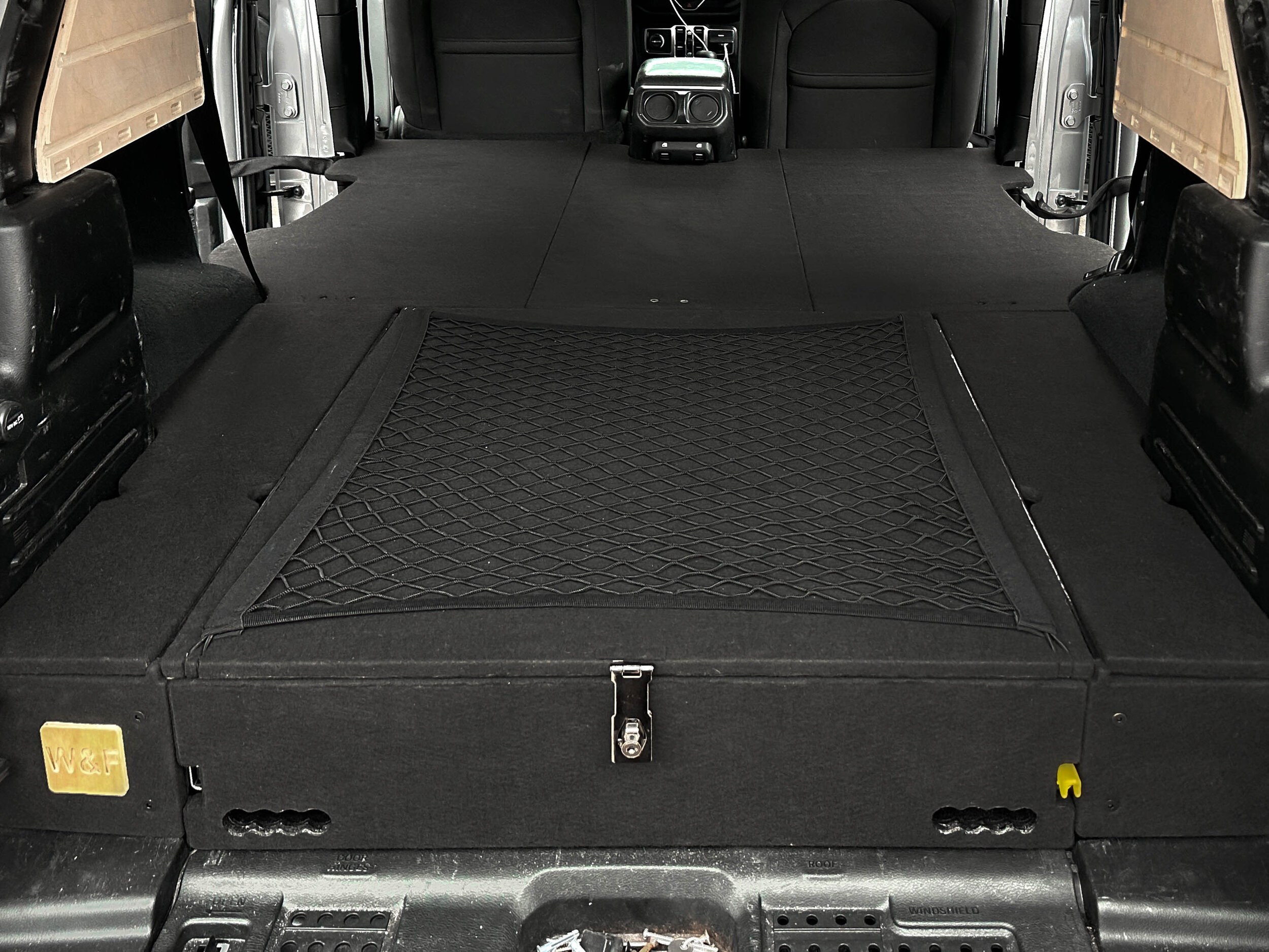

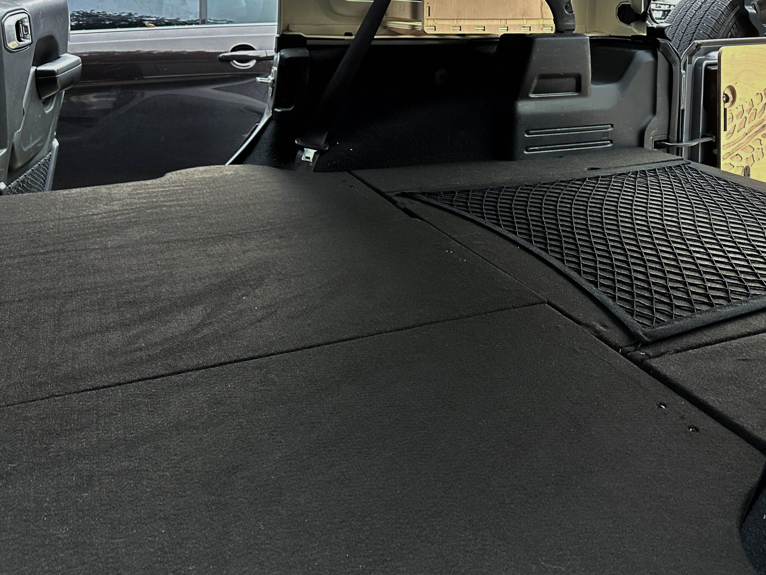

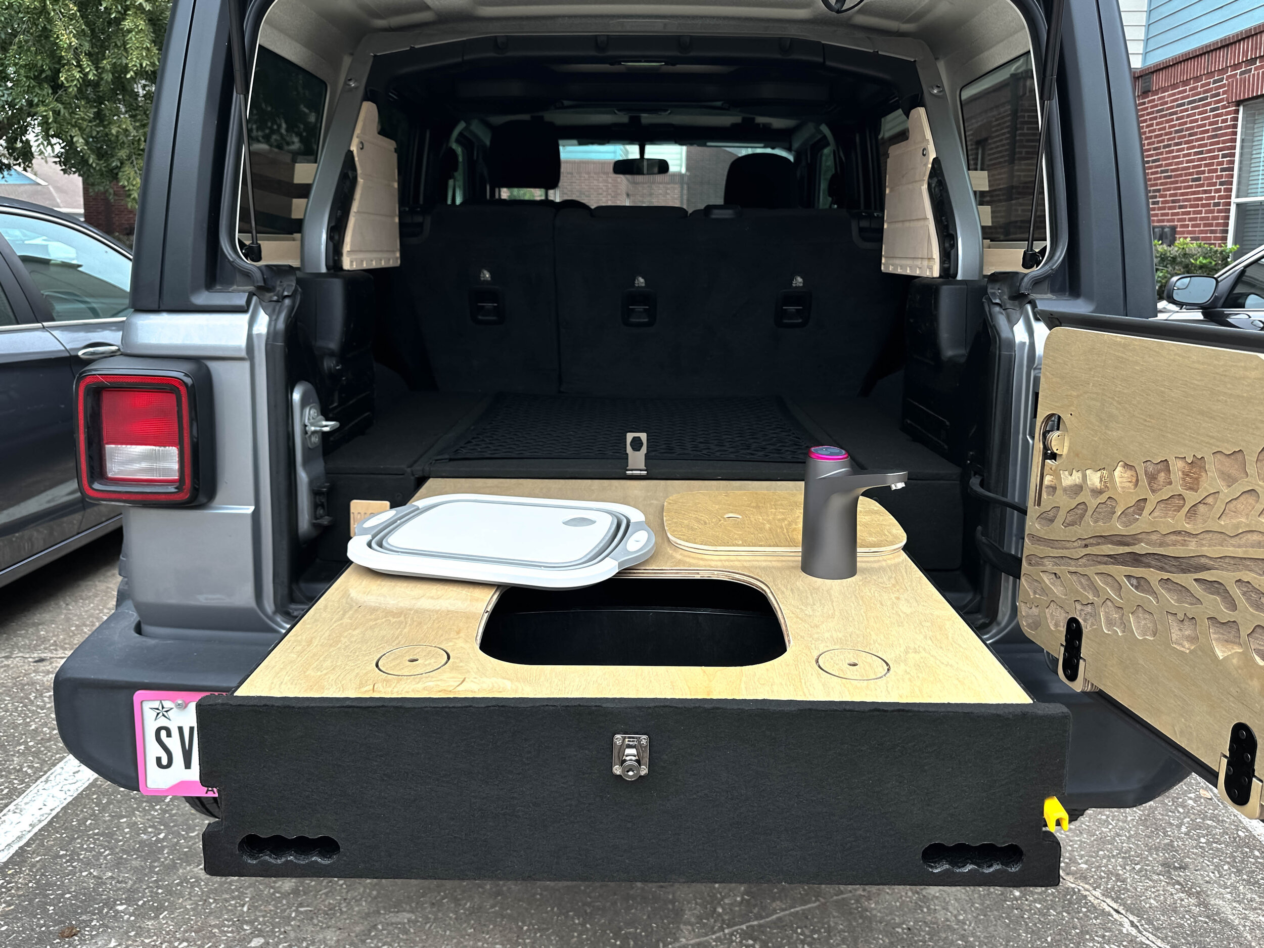

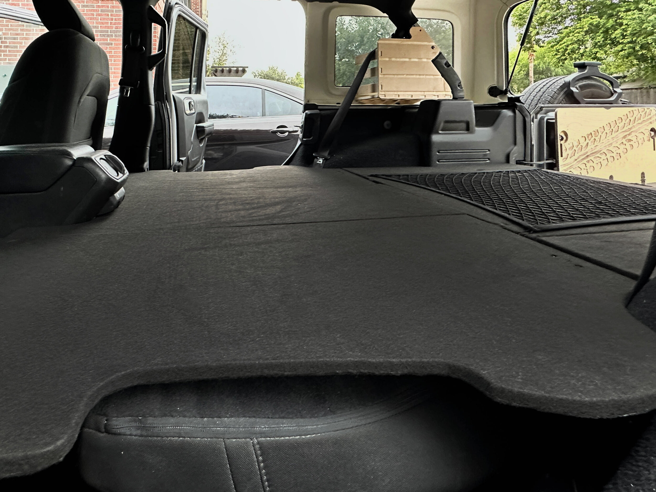

Checked on my carpet order annnnnd it was still sitting in the cart. Yay. Soooo...I made a trip to Hobby Lobby today. All fabric by the yard was 40% off. Bought 3 yards of black felt fabric. I got everything covered. The wind was NOT helping but I think it still turned out OK.
Looks great! I also made cargo drawer with soft carpeting. And extend it with sleeping platform and kitchen.
