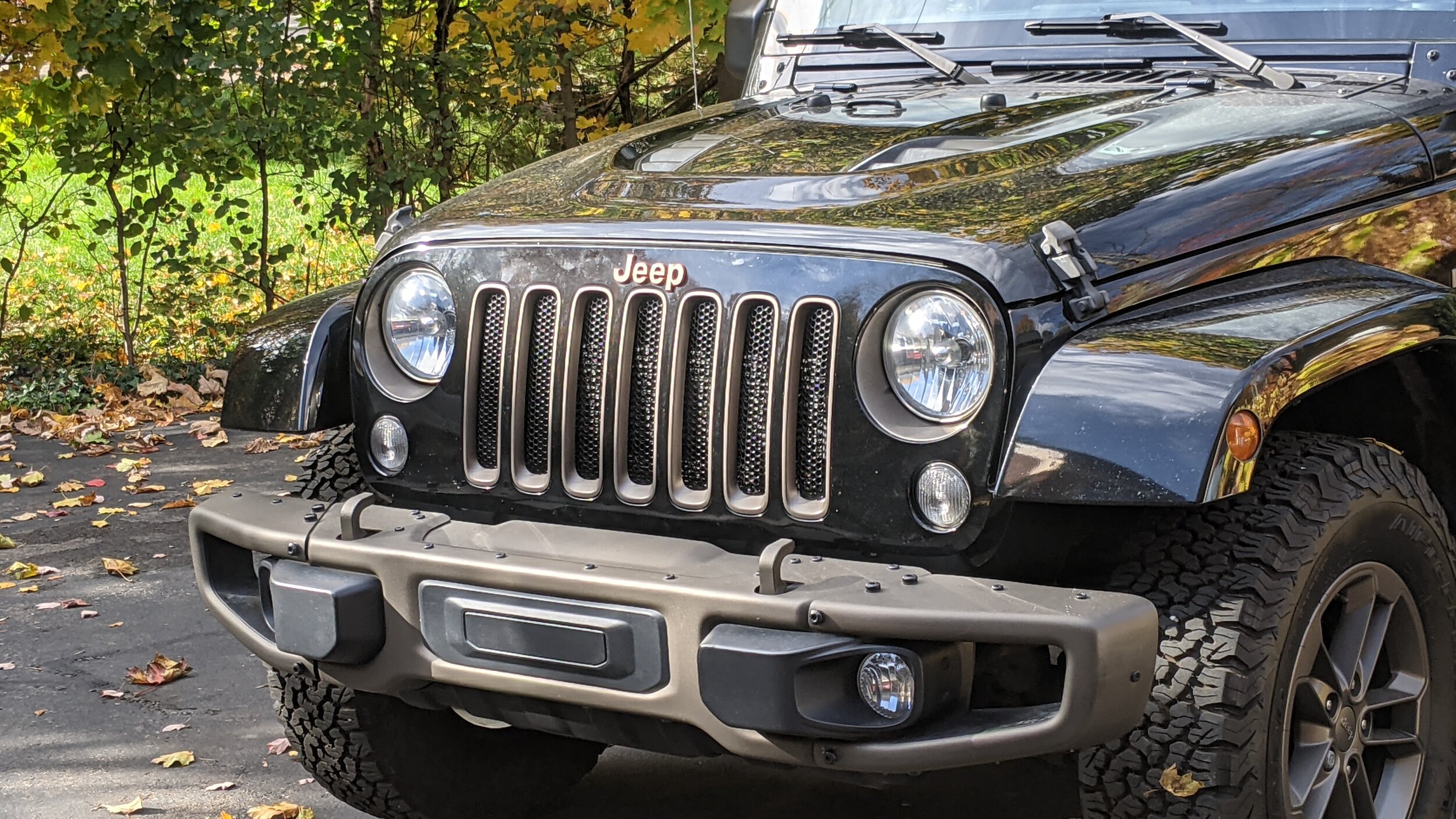

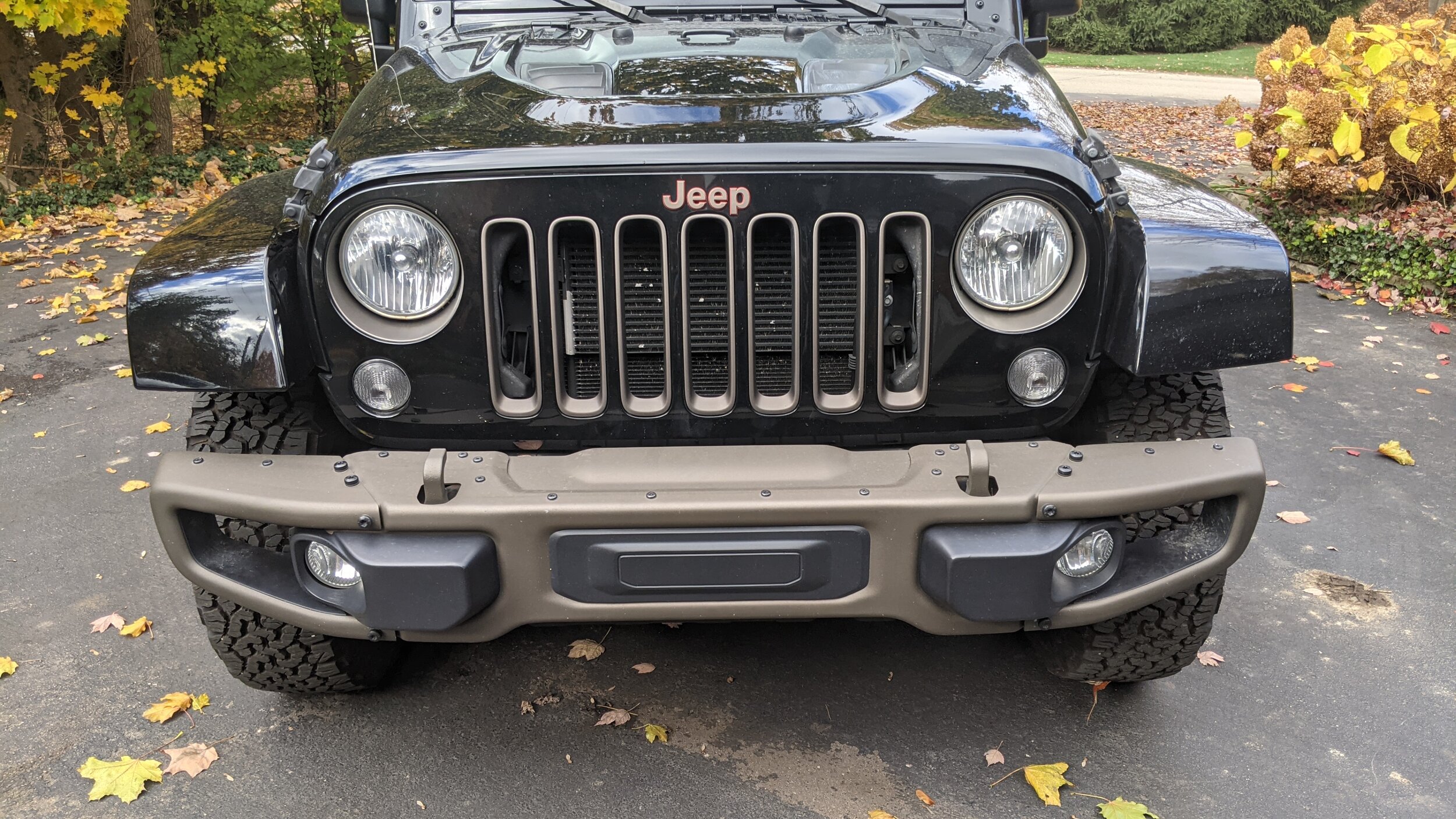

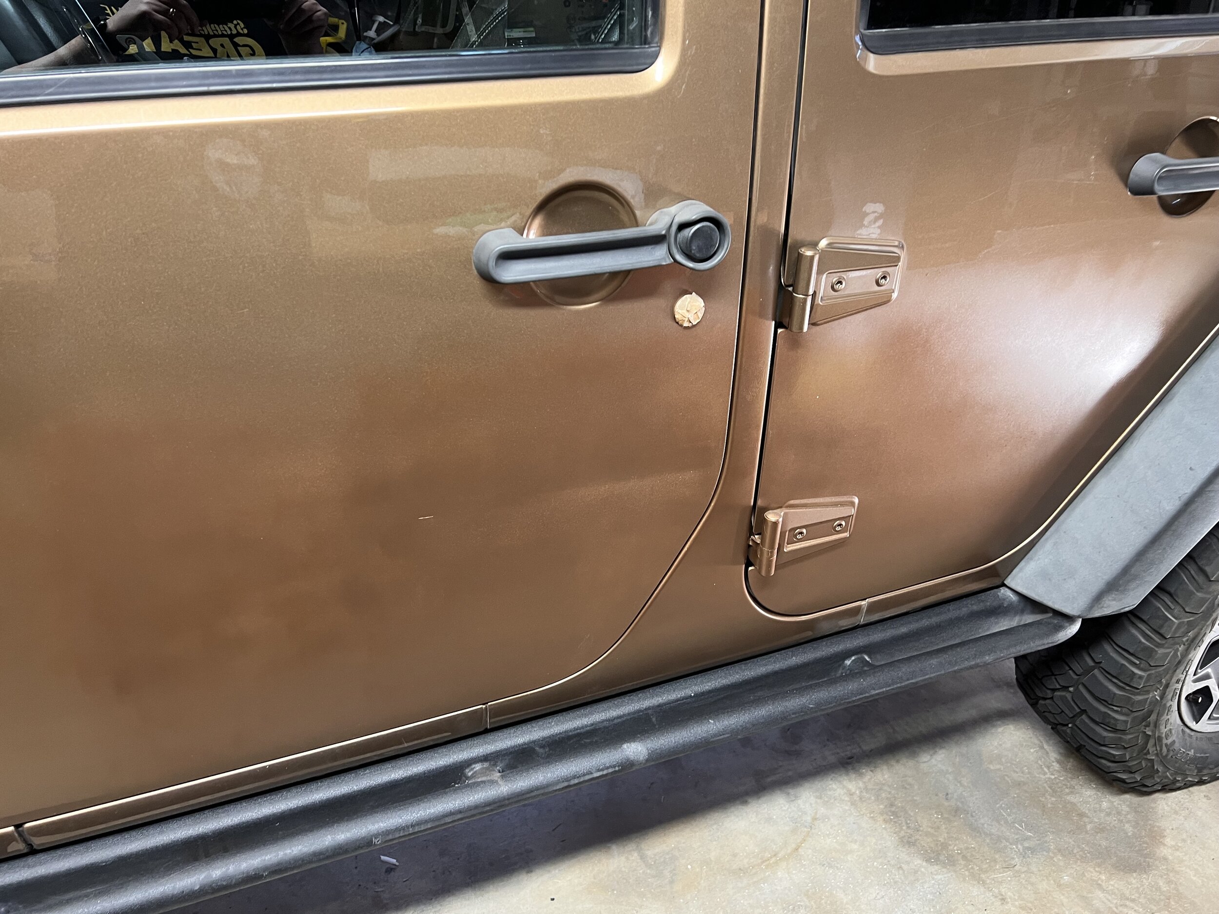

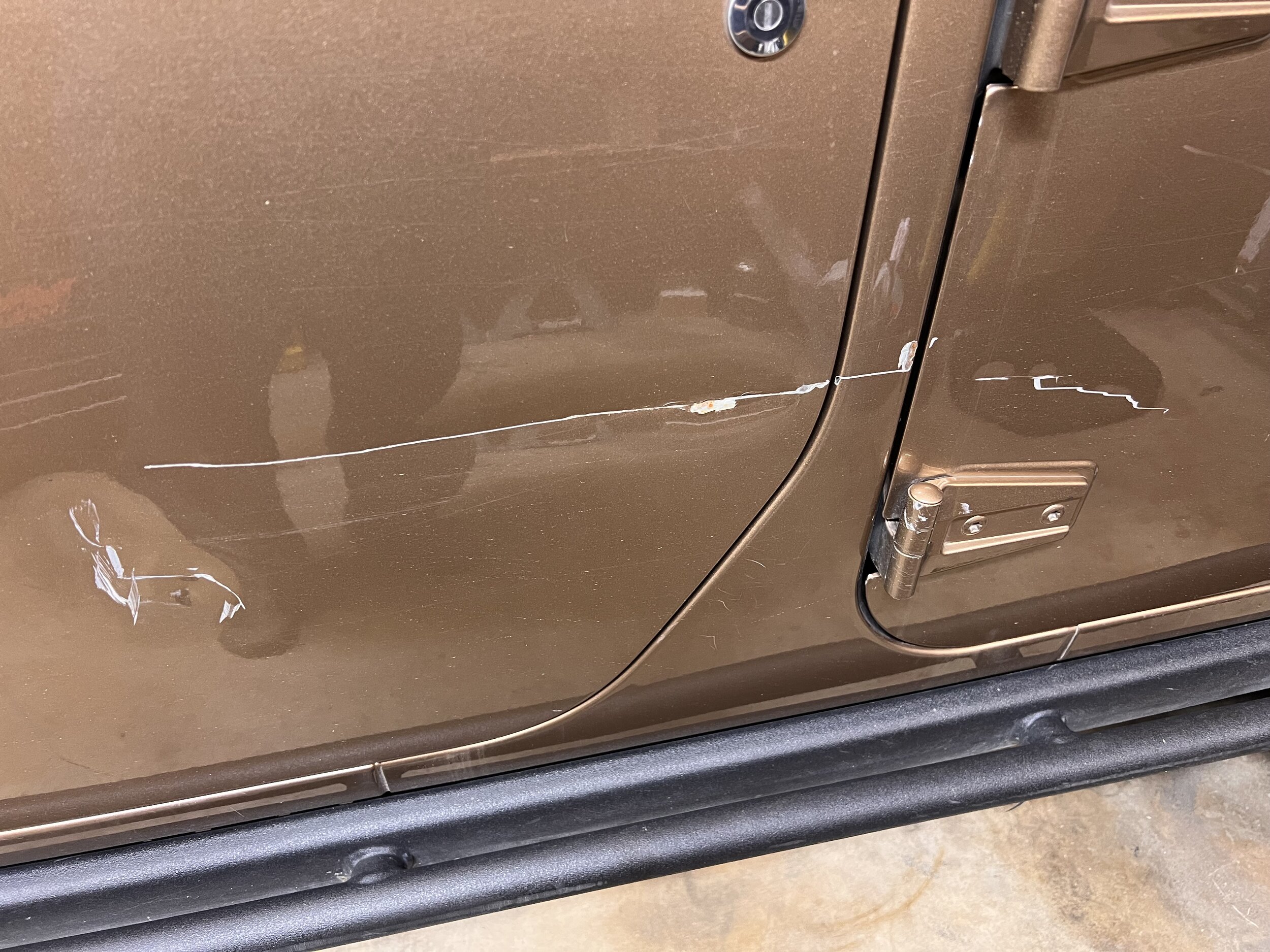

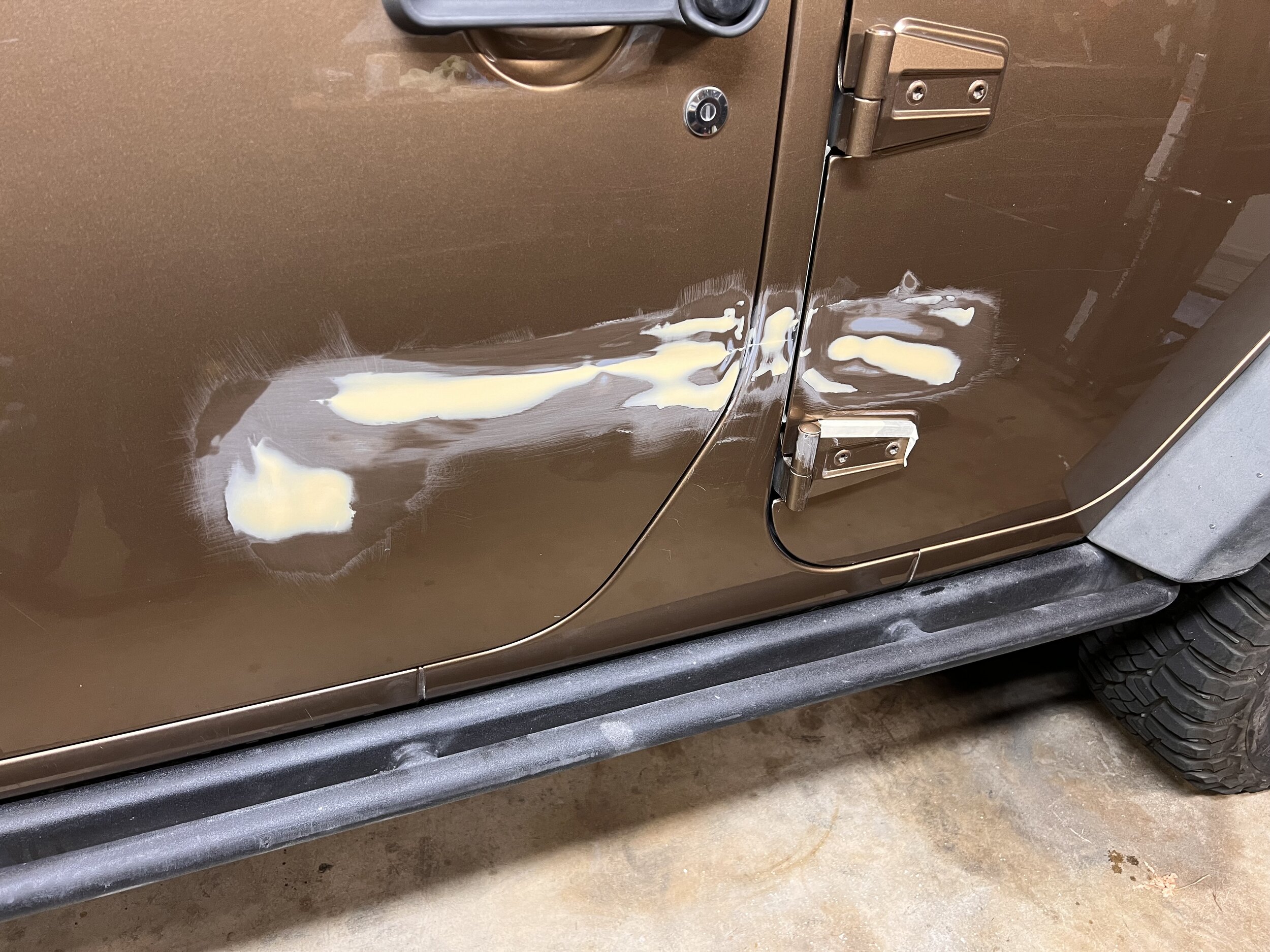

Spent last night and today repairing the big scratch from a snow trip earlier this year. Didn’t turn out as well as I wanted. Maybe after it sets a little bit it will look better. I may get a buffer and buff it out after it sits for a couple of days. First time trying this. I ordered the paint from Roberts Paint Care, shipped in decent time and great kit. Had two primers, the paint, clear coat, blending agent, epoxy based bondo, tool to spread it, two types of sandpaper and tape and masking plastic. I think if I would have taken more time it would have turned out better, but I am very task oriented so also wanted to get it completed today.
@Danarch, I think it looks pretty good for a home spot repair. I've always understood that you can't really color match and blend without painting the entire panel. I'd for sure give it a couple days and then buff it before judging.
Thank you for the encouragement and advice. I probably will buff it in the near future. Right now in person it has a spotted / splotchy look. Of course I am sure it still wet and curing etc. Either way looks better than the scratches and won’t rust. It won’t be the last dent / scratch.
Reactions: Dirty Dog
@Danarch, It doesn't look bad at all for a home job. Definitely wait 30 days before you buff it though! The clear needs time to cure/harden. You can speed up that process with one of those ol school clamp lamps with a spot halogen bulb that clamps onto almost anything and when you bumped the tin shade you got burnt lol. Clamp it onto something and keep it like 8-10in. away from the paint. Let it sit there for a good 45 mins. The paint should be hot buuut not enough that you cannot keep your hand on it. That will cure the clear so you can buff it. Buff it once everything cools off.
Thank you for wisdom. I’ll be letting it sit for a while before I buff it or do anything else to it. I remember those lamps, I think you’d be able to fry an egg on it. Thanks for the kind words too, I think it’s starting to look a little better, but it certainly could look better.
