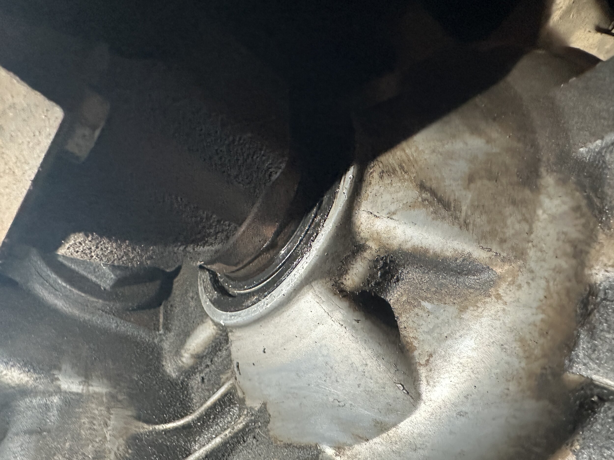

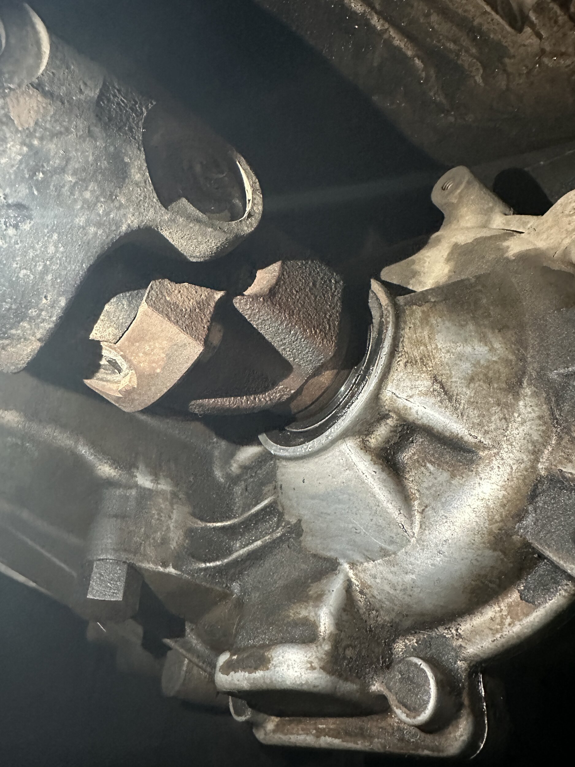

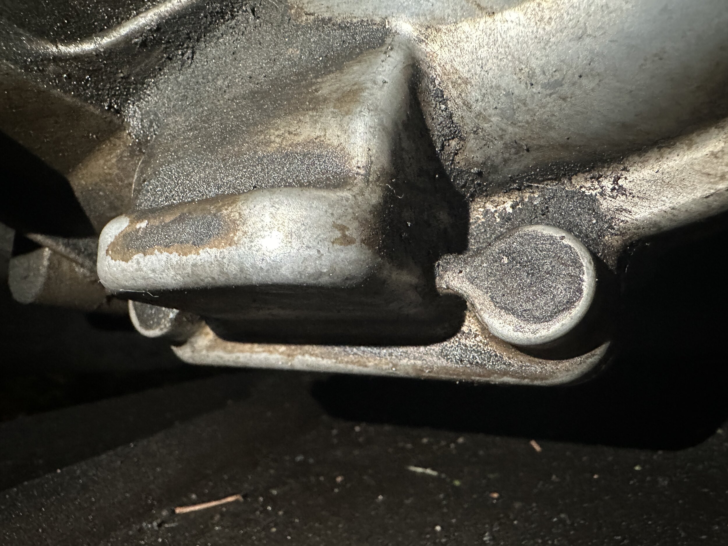

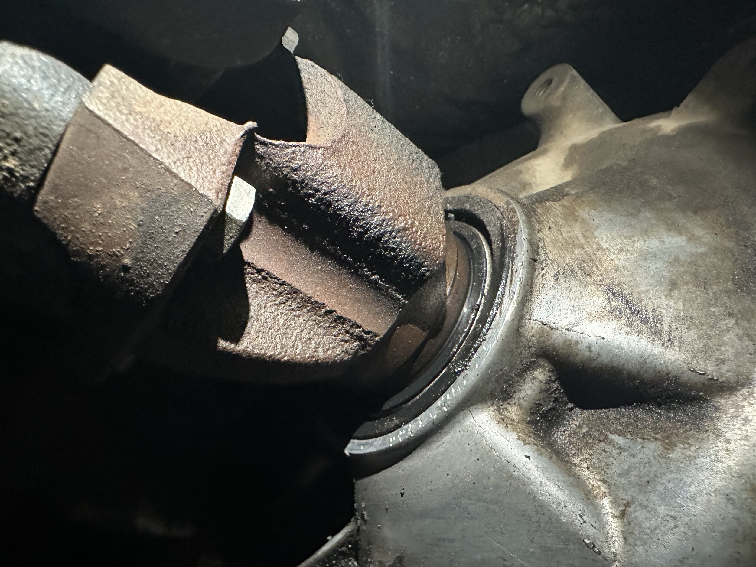

Got it back from getting the plugs changed and a new ignition coil for 3rd spot. Was under it and noticed a lot of grease here at the front driveshaft and trans case. Cleaned it off and definitely doesn’t look like anything is actively leaking. Any ideas?
Edit: i don’t have a rzeppa front DS, could the double cardan be throwing grease or is it just old grease?
It looks like your pinion seal could be leaking a little bit, have you checked your oil level? Doesn't look bad enough to replace it yet, might also check the differential breather to see if it's plugged up. A plugged breather will make oil leaks at the seals.
I had all fluids flushed and changed after I bought it and that was about 5k ago. Dumb question but how do I check the oil level for that?
I’ll find the diff breather tube and see how it’s fairing.
You check diff oil where you fill it, the oil level should be about at the bottom of the fill hole.
Reactions: BattJKU35
