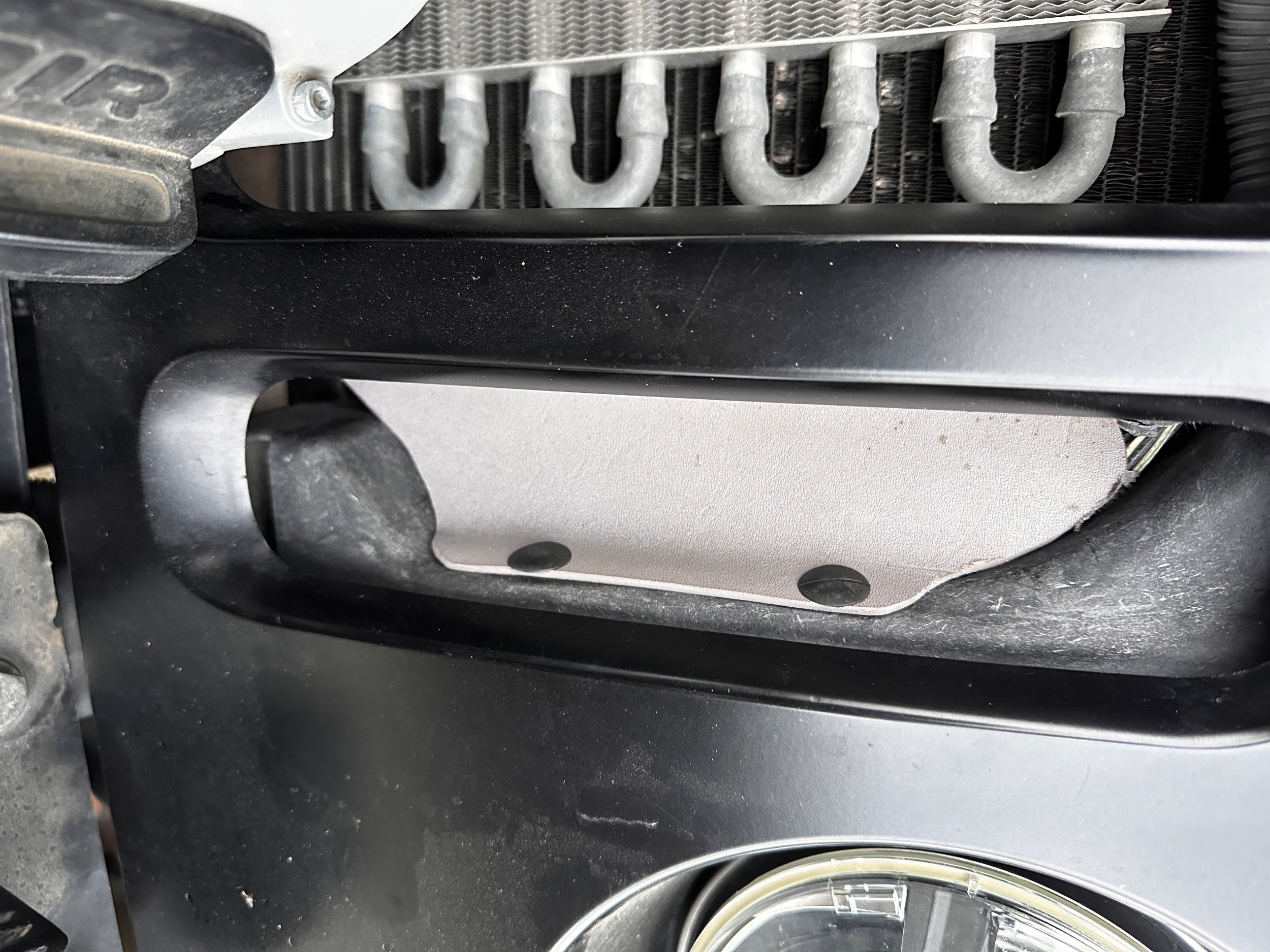

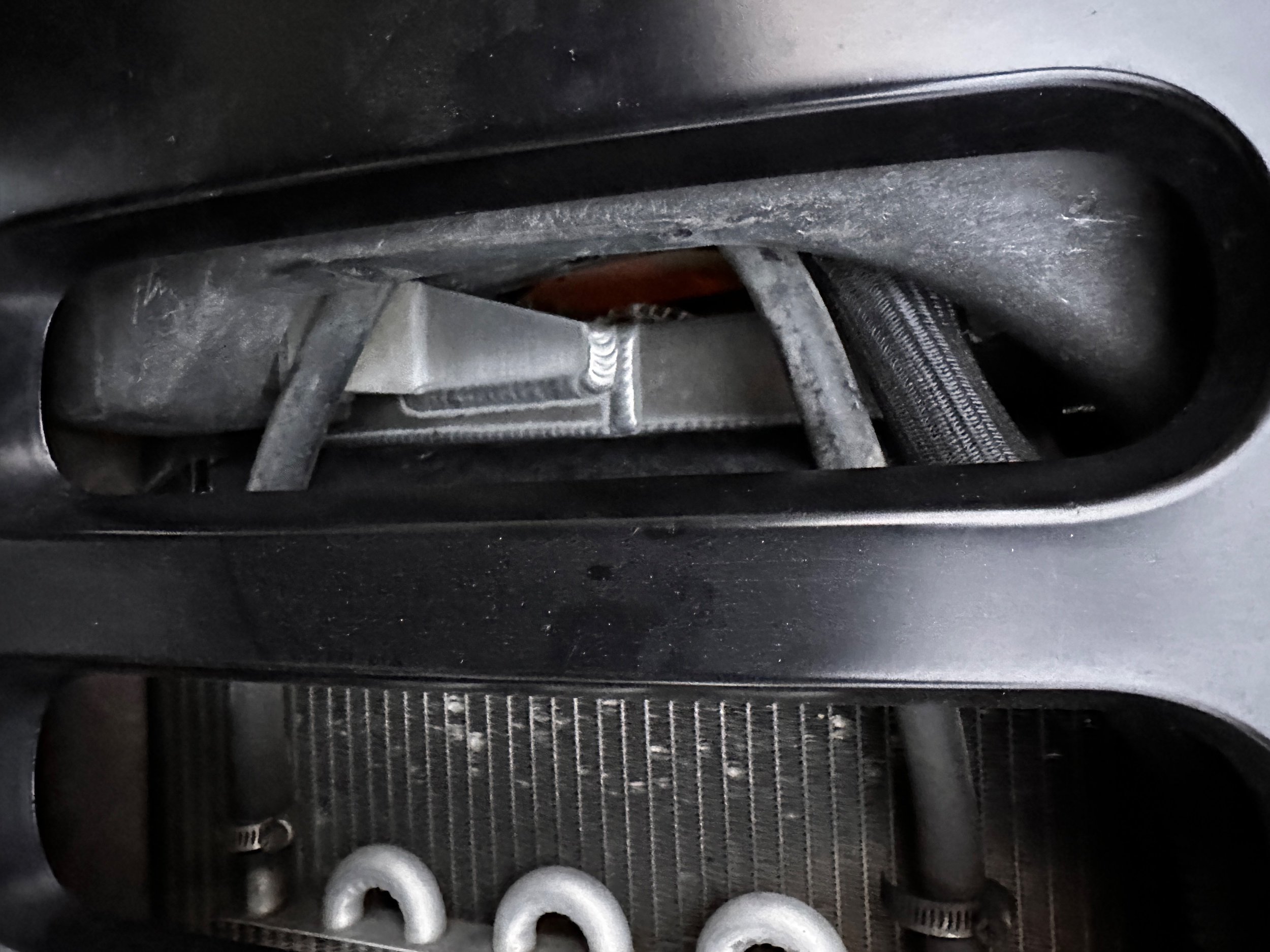

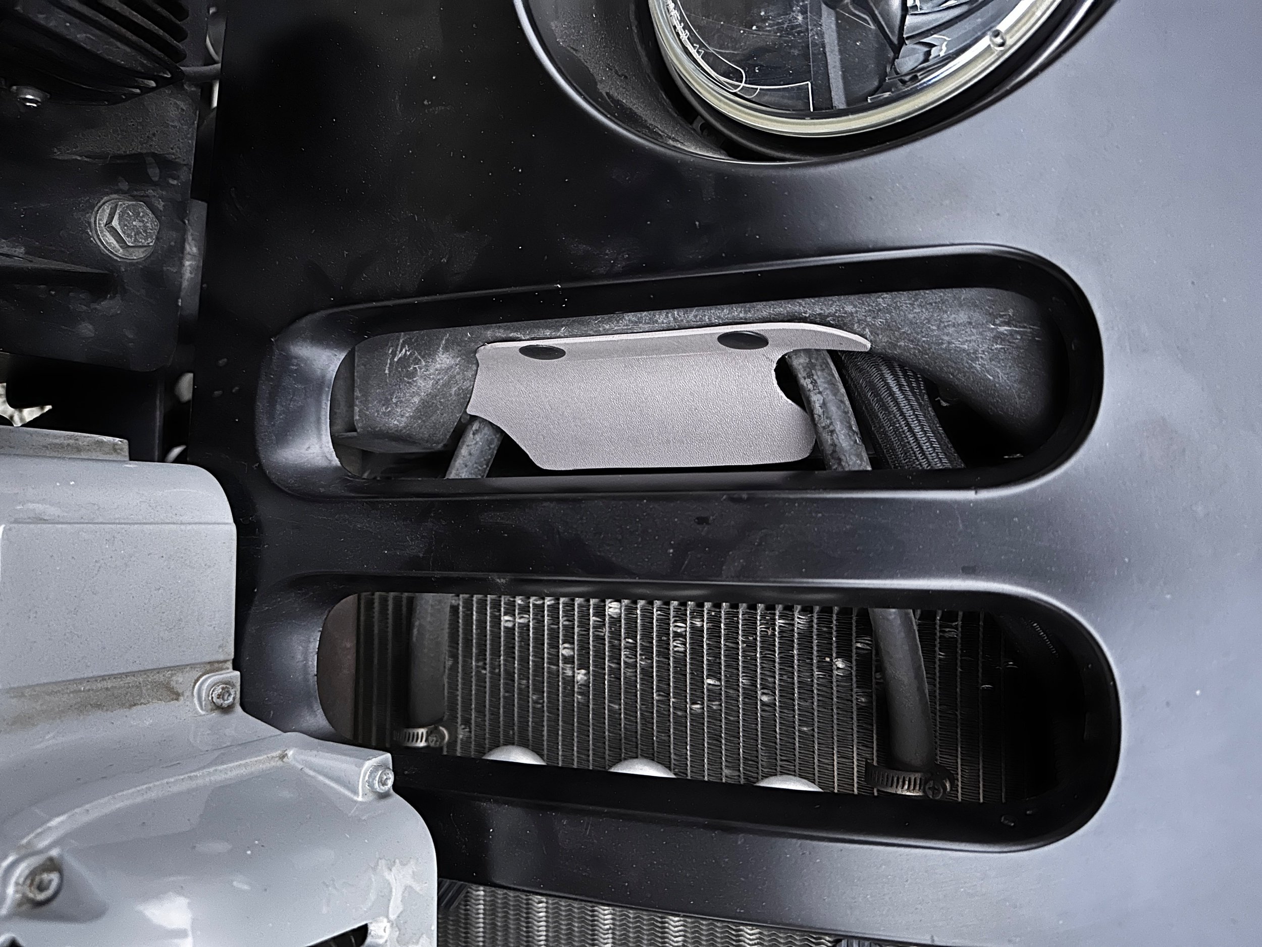

Did a small project that I hope has a good return. I put some air dams on the side of the radiator. The OE rubber dams were rotted and from the original radiator (has a big Ron Davis now) I have a slight heat problem when on the freeway and climbing.
The new air dams are not as flexible and cover the gap/holes at the sides. I used .080” kydex for the project.
Before:
After:
I used cardboard for a template the cut and formed the piece
