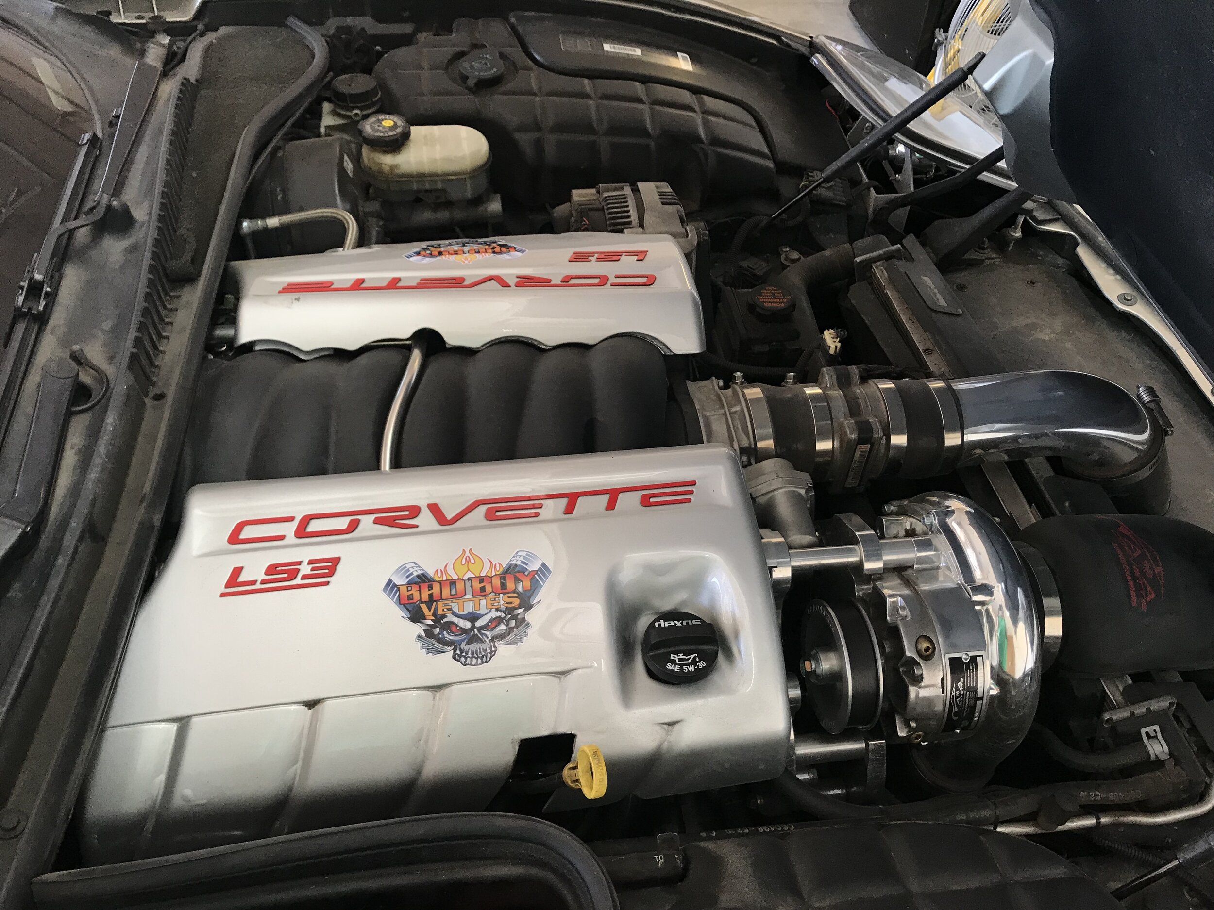

More trips to the parts store. I've got the new engine in and running, but I'm getting some odd errors. The system thinks my oil level is low, but it's not. The sensor is ok and it has power, so I'm thinking I've got a grounding problem. Have I ever mentioned how much I hate tracking down electrical gremlins? I'm also seeing some fuel pressure fluctuations that need to be fixed; the last thing I need is for this thing to lean out under boost.

This will be the third engine. I had a shop pull the 5.7L LS1 and swap in a heads/cam/blower 6.2L LS3. I drove and raced that for 70,000 miles and 400 passes before I collapsed a piston skirt at the track. OEM rotating assembly with 9lbs of boost will do that...
So I pulled it out, had the block machined and resleaved, and rebuilt it with a forged crank, billet rods, and forged pistons. I'm still chasing little gremlins. The weather got nice enough to take it on a test drive, and I found a tiny leak from the rear main, so I'm fixing that now.
