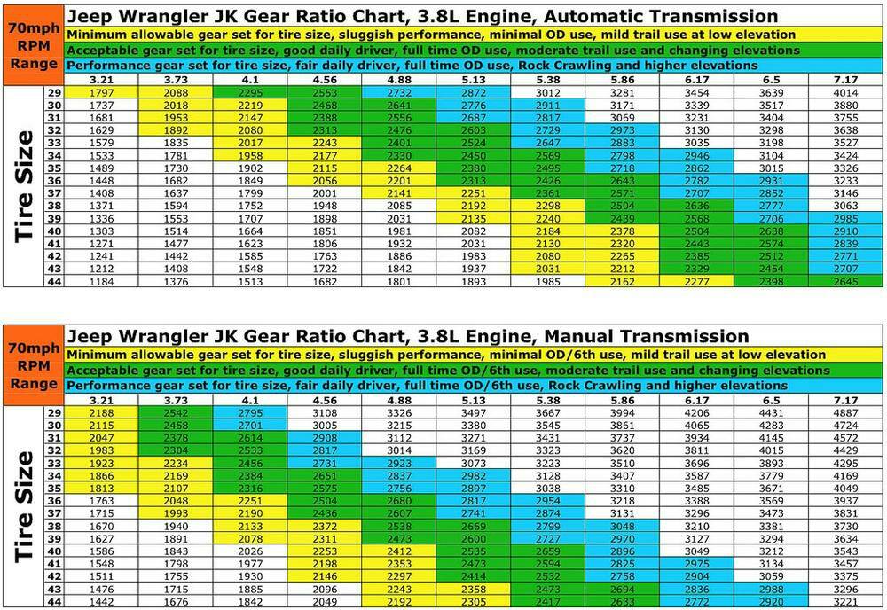

Sorry for the delay. I have confirmed that I have 373 gears. I have heard that the 3.8 lacks some power as it is. I have some factory 18's and some LT 275/70 R-18 which I think calculates out to a 33 in tire. I thought about those, maybe some wheel spacers and a 2 inch puck lift. However, if that is going to make this thing a complete dog, I will just stay factory tire size and maybe do the puck lift and then add the spacers. Thanks
They are a dog unless you get a throttle pedal enhancer, I have a Pedal Commander. They make it alot more fun to drive and feels like it has more power.
You should be ok with a DD with those gears and 33's.
