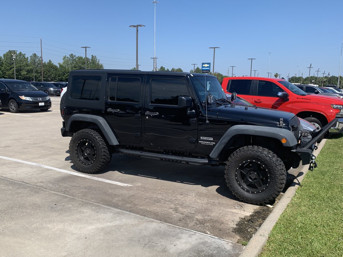

Mine’s the later model 3.6l 285 hp from 2016.
I bought it like this in September.

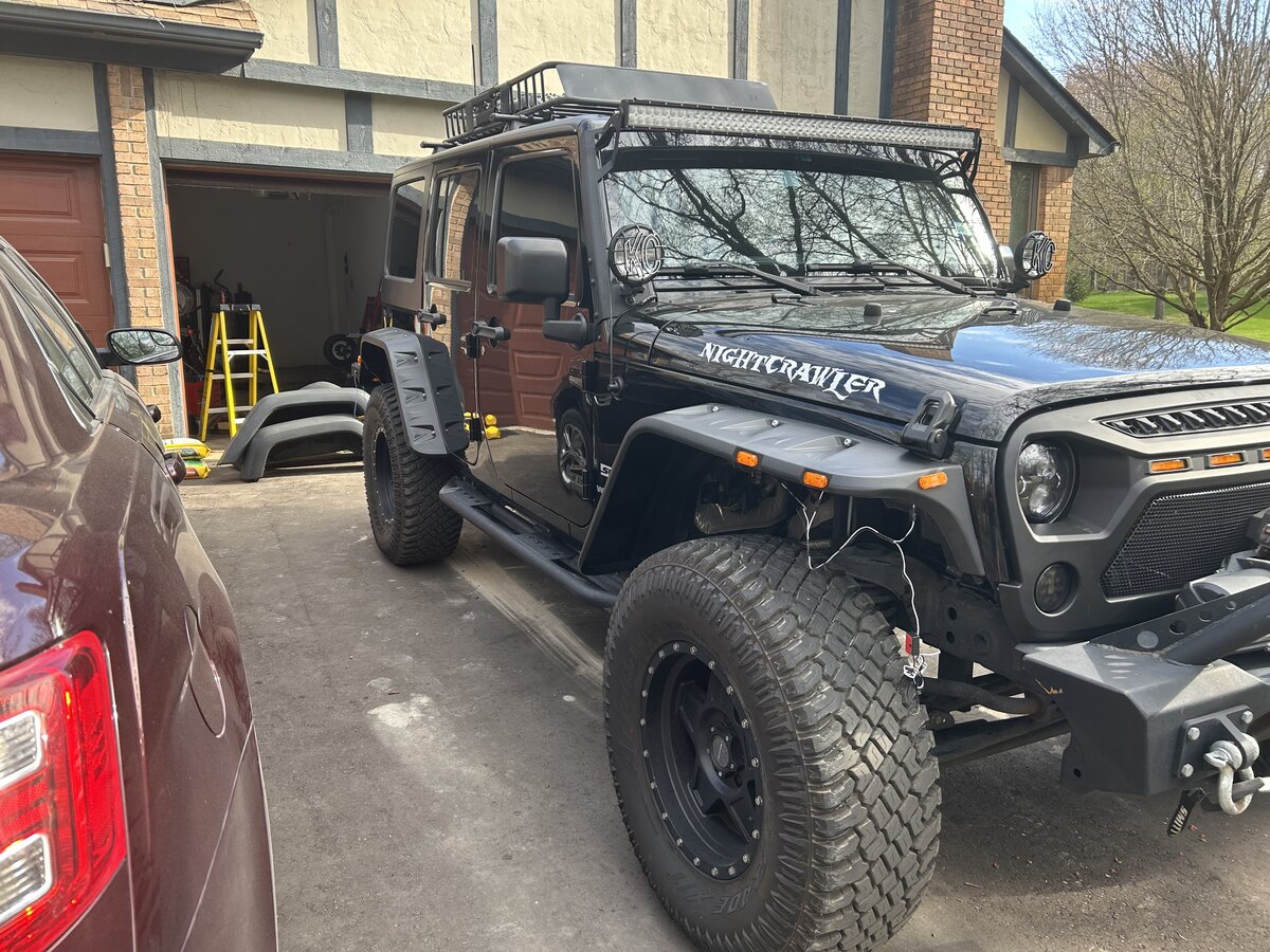

This is now. Those dangling wires are now connected, wrapped and sheathed for protection.
