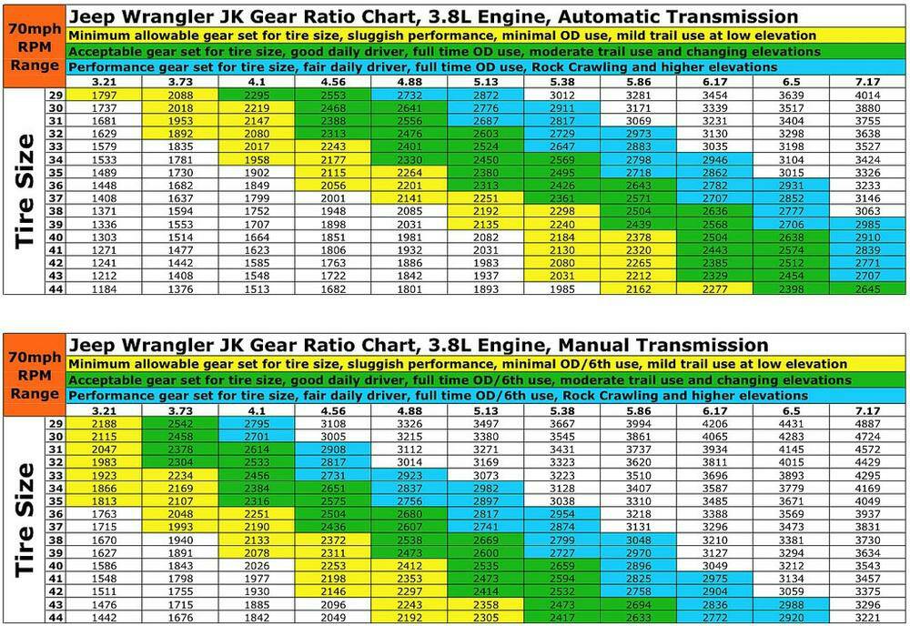

We are new Jeep JK Unlimited owners and I am looking for help deciding what size tires to go with. We purchased a 2010 Jeep JK Unlimited Sport ( Automatic ) with the 3.8 engine. We will be using for every day commute and standard adventure to include gravel roads, camping trips, and trips to the lake. I will be installing a 2 inch spacer lift and some new shocks. I have stock 18 in wheels and 2 in wheel spacers that I have not decided if I will install or not. My big question is the tire size. I would like go have a slightly more aggressive look and stance than stock, but I do not want this thing to be a dog on the highway and I will be running stock gears. Will the 2 inch wheel spacers cause me problems, or decrease performance? What would be a good tire size for my application and use. Thanks in advance.
