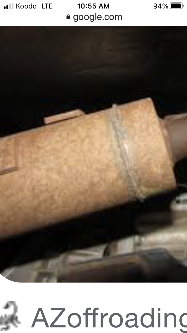

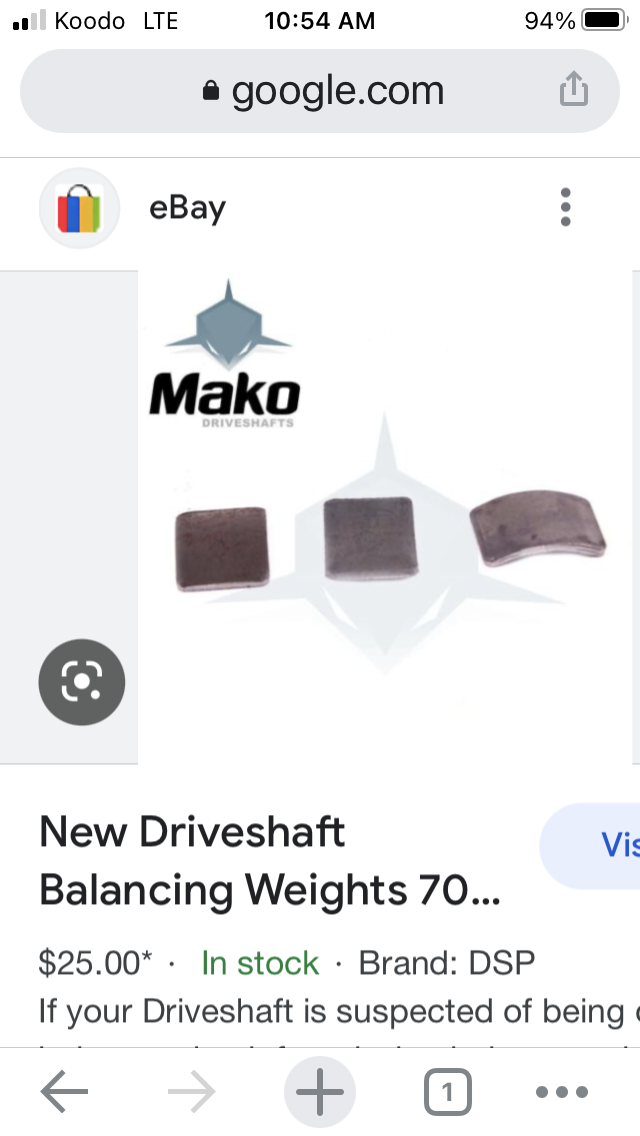

Here are 3 pics pulled off the internet showing weights .
Rectangular curved pieces of metal tack welded to driveshaft . If recently lost one there will be noticeable colour diff where weight was .
Most but not all shafts will have a balance weight . Sometimes the shaft will have been within spec and not needed one .
Most but not all shafts will have a balance weight . Sometimes the shaft will have been within spec and not needed one . View attachment 123186View attachment 123187View attachment 123188
Thanks! It does not look like it’s missing weight assuming it would have had 3 on there.
You cannot assume that it needed 3. Most driveshafts will need at least one balance weight, but some will need more. Some need none. The number and location of weights varies widely.

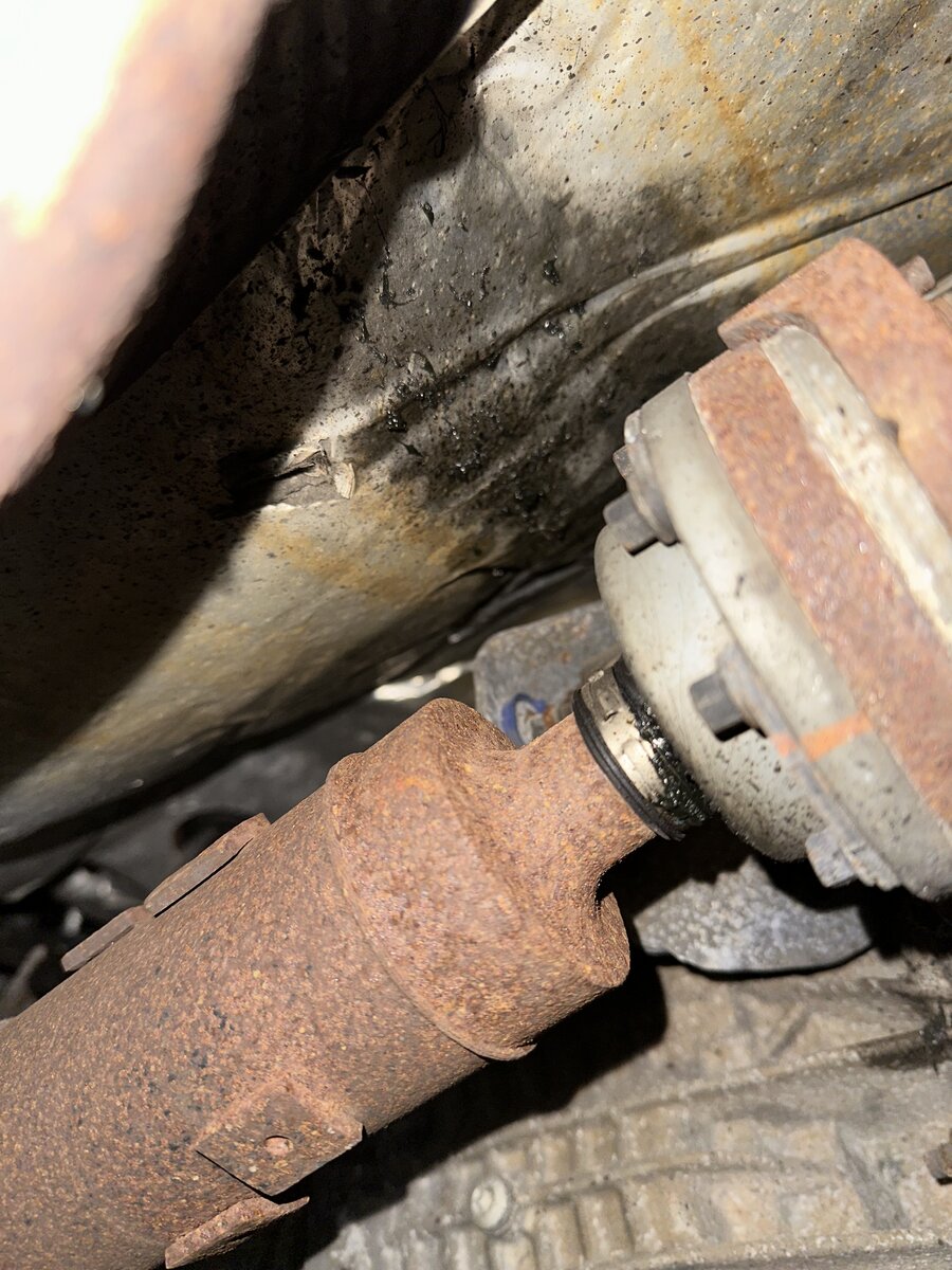

Haven’t replied in a while… been too busy to keep digging into this issue. But I did have some time recently to discover this on my front driveshaft CV joint. Looks burst to me. Am I diagnosing this correctly? My Jeep is not lifted.
The rubber boot probably has a rip in it, it's rubber and doesn't last forever. I'll never understand why they ever put a joint like that on these Jeeps.
So going back to my original issue (vibration at 45 mph) - any thoughts as to this being the culprit?
