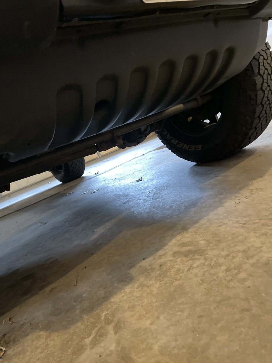

What about the air dam? It is quite loose. Can I remove that? Or does it serve a purpose?
For reference it is this part:
