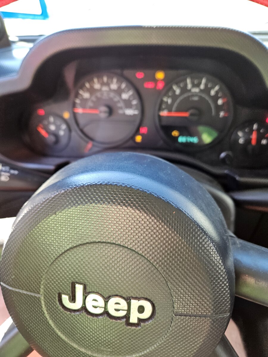

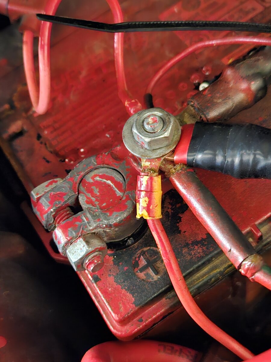

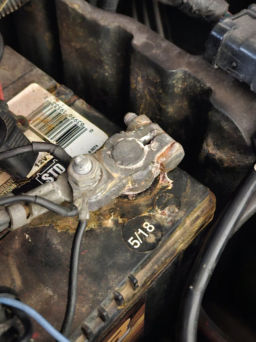

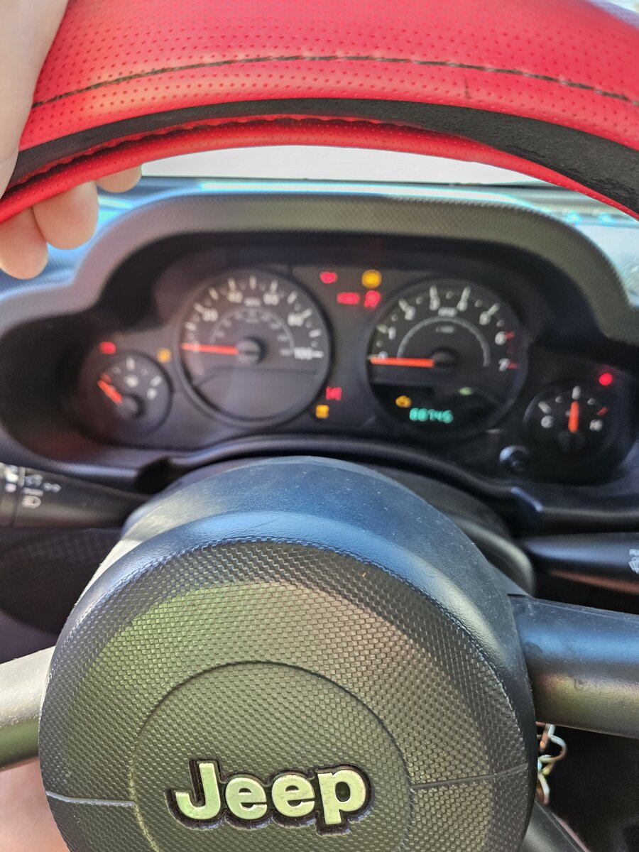

Hey, guys so I took the terminals off and cleaned them thoroughly and tightened the posts down tight. Here are some pics of the battery terminals and as best as I could shoot the crazy lights that come on the dash the first 5 mins while driving periodically while driving.
I am running out of ideas and am no master mechanic. Can someone tell me where the ground wire from the battery terminal connects to on a 07 Wtrangler 6-speed? Kind of hard to trace it...
Also, do you think I need to totally replace my battery terminals? As you can see there are like 6 total wires connected to each side of the battery. Might that be causing this issue? Do you think I should disconnect all accessory-powered items and just leave the car's positive and negative wires connected and drive and see if it still has the issue?

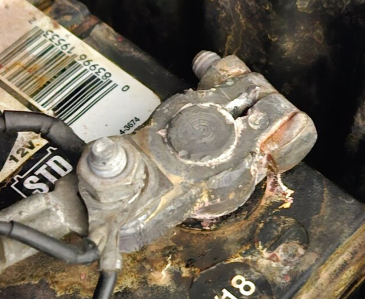

That negative terminal looks pretty corroded to me. Also the positive one looks loose, like there's a gap most of the way around the post. If the clamp can wiggle even a little bit on that battery post it causes arcing and all sorts of problems. Also, it is never a bad idea to disconnect your after market accessories when you experience electrical issues. It's usually the first thing I do.
As far as grounds go, there are many. Some are visible in your hood, some are under the engine, some are in your footwells.

All of those clamps and connections look like they need cleaned. The ground from the battery goes to the engine block.
That also looks like a 5 year old battery it could be on it's way out.

I don‘t mean to be rude but the negative post and clamp in this picture is not clean, there is too much corrosion on there. The clamp needs to be removed and clean the post and clamp with water and baking soda, and a battery terminal tool. Not only that the 5/18 sticker typically indicates installation date or mfr date so it’s basically 5 years old. It’s on its last legs. I‘d take it somewhere and have it tested.
