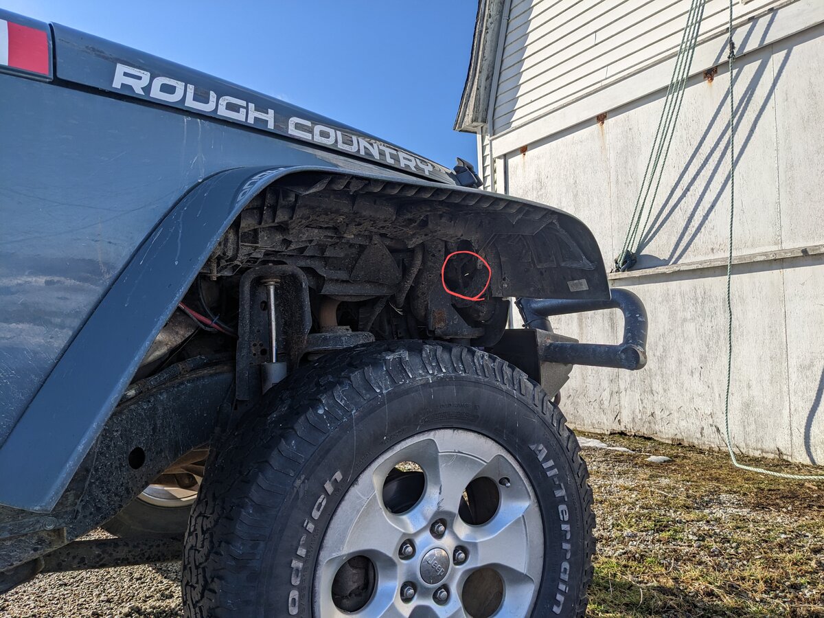

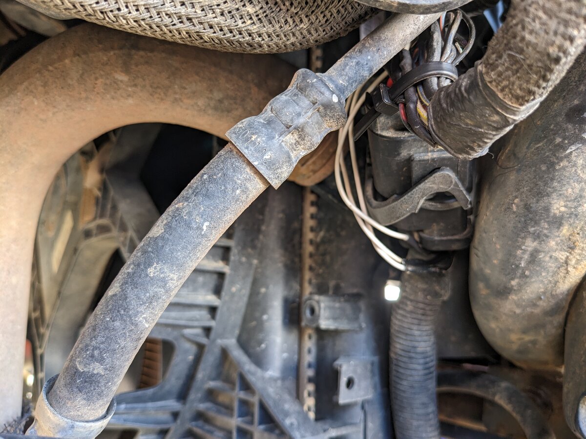

I got mine back from the dealership a couple days ago and it's been working fine. Here's the location of the connector that was causing problems for me.
there was some corrosion shooting some of the pins together. Honestly there are many connectors on the vehicle that could cause this problem.
