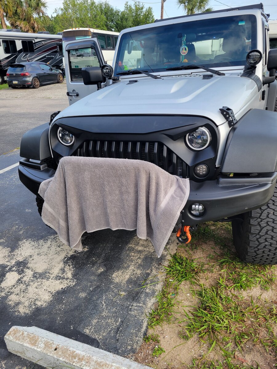

Wife found another use for the overrider bar

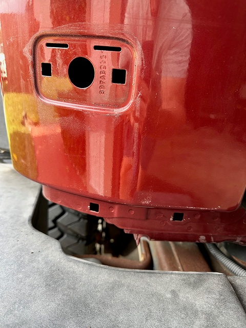

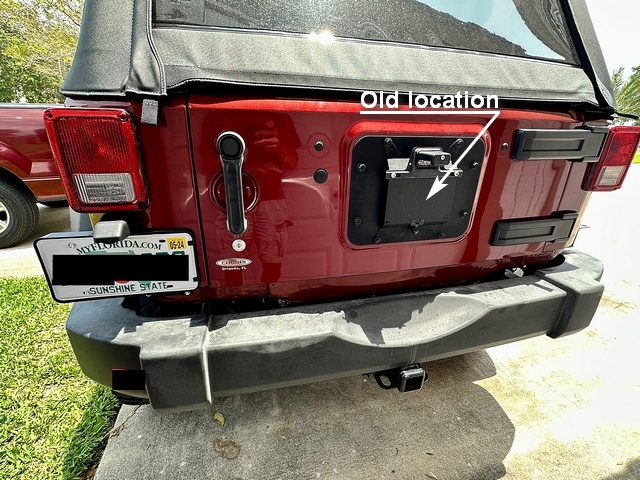

Relocated my license plate today. Previous owner didn't have a spare and had the plate on the tailgate where the spare goes. I'm getting a spare so I bought a bracket and mounted it where I'm guessing it was originally. Easy operation except I ran into an issue where there were no snap nuts (I'm retired IT and we called them "cage nuts" for mounting servers in racks) to bolt the new bracket onto the body.
I found some online but I was up against a time crunch, as I'm taking the Jeep in to the shop Tuesday to have the 2" body lift removed. This would make accessing those bottom holes a bit more troublesome. Online was $1.10 but wouldn't be here in time. Found some at the local Jeep dealer for $4.50 each. :mad:
Bit the bullet and bought 5. Only needed 4 but the way I work on things I usually drop an important screw down a hole. It's only money anyway.
Fortunately the wiring and connector for the original license plate light was still inside the body.
I used a mixture of 3/4" #14 and #12 hex head sheet metal screws to bolt the bracket to the snap nuts. 2 of the #14s just wouldn't work for some reason so I used 2 #12s.
¯\_(ツ)_/¯
Here's a list of stuff in case anyone does a search in the future and runs across this thread:
License plate holder on Amazon: https://www.amazon.com/dp/B07WFN9WYV/?tag=jkforum-20
Snap nut on Quadratec.com: https://www.quadratec.com/p/omix-ada/rear-license-plate-snap-nut-wrangler-jk-11233.12
Snap nut on store.mopar.com (part #6036683AA): https://store.mopar.com/oem-parts/mopar-snap-in-nut-6036683aa
Here's a shot of where the snap nuts go:

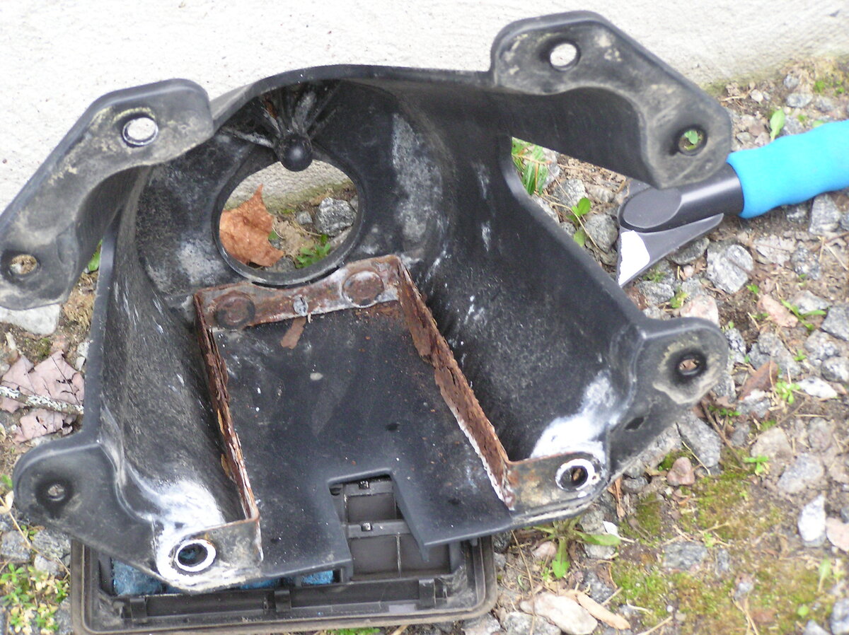

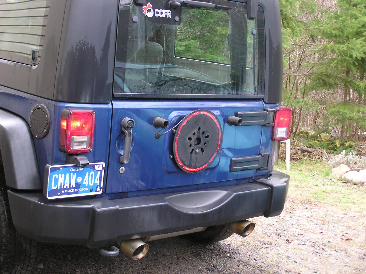

Removed the spare tire, to prolong replacing the tailgate hinges. Good thing, the carrier was cracked and BITCHED as well. 13yrs of salt and just a Girly 16in tire on the back. So I see the kids here have deletes where the spare went. Gorilla taped the vent (mice) and MacGyvered my funky third brake light. And I did not have to pull out the VISA. Good Times

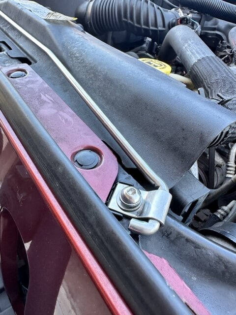

Installed a hood prop rod. A previous owner had removed the OEM prop rod. I debated whether or not to go with gas struts but just went with a normal rod. I'm not under the hood much other than to check fluids and stuff. Not fond of folding the hood all the way back onto the windshield every time. Bought one for $40 from Morris 4x4 Center: https://www.morris4x4center.com/kentrol-stainless-steel-hood-prop-rod-30594.html. Probably could have found one cheaper at a pick and pull junk yard but it's just too easy to have stuff delivered. lol.
Previous owner had drilled out the rivet and there's no way to get on the other side of the hole to put a nut on a bolt so I tapped it with a 5/16s tap. Not much metal to tap but it's holding fine so far.

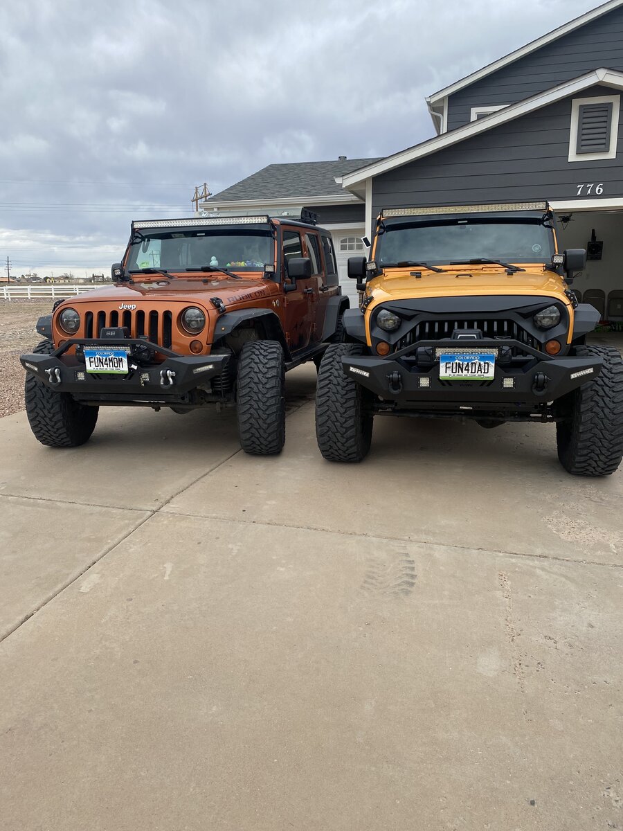

Today I prepped Thor for our trip. Leaving tomorrow for a couple days in Estes Park. No real Jeeping there, but some gorgeous roads in Rocky Mountain National Park, and one easy Jeep trail.
The week after we're off to Moab for a brief visit. We will only have a couple days to explore, and we have not decided what to run.

Welcome to the spate tire delete dark side . Lol
Was your rear vent missing the flaps ? When I did my delete discovered the flaps were missing so ordered a new vent .
