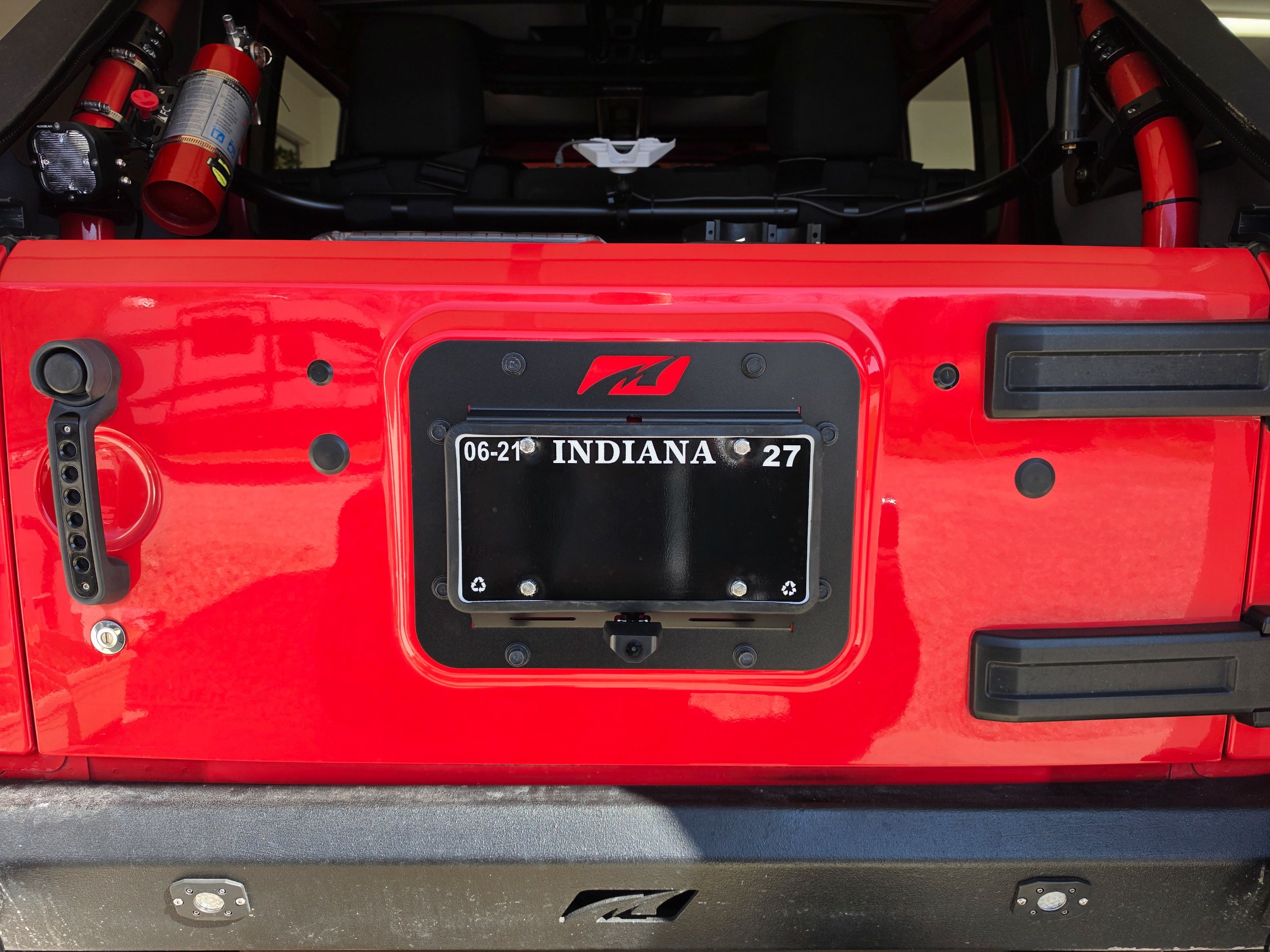

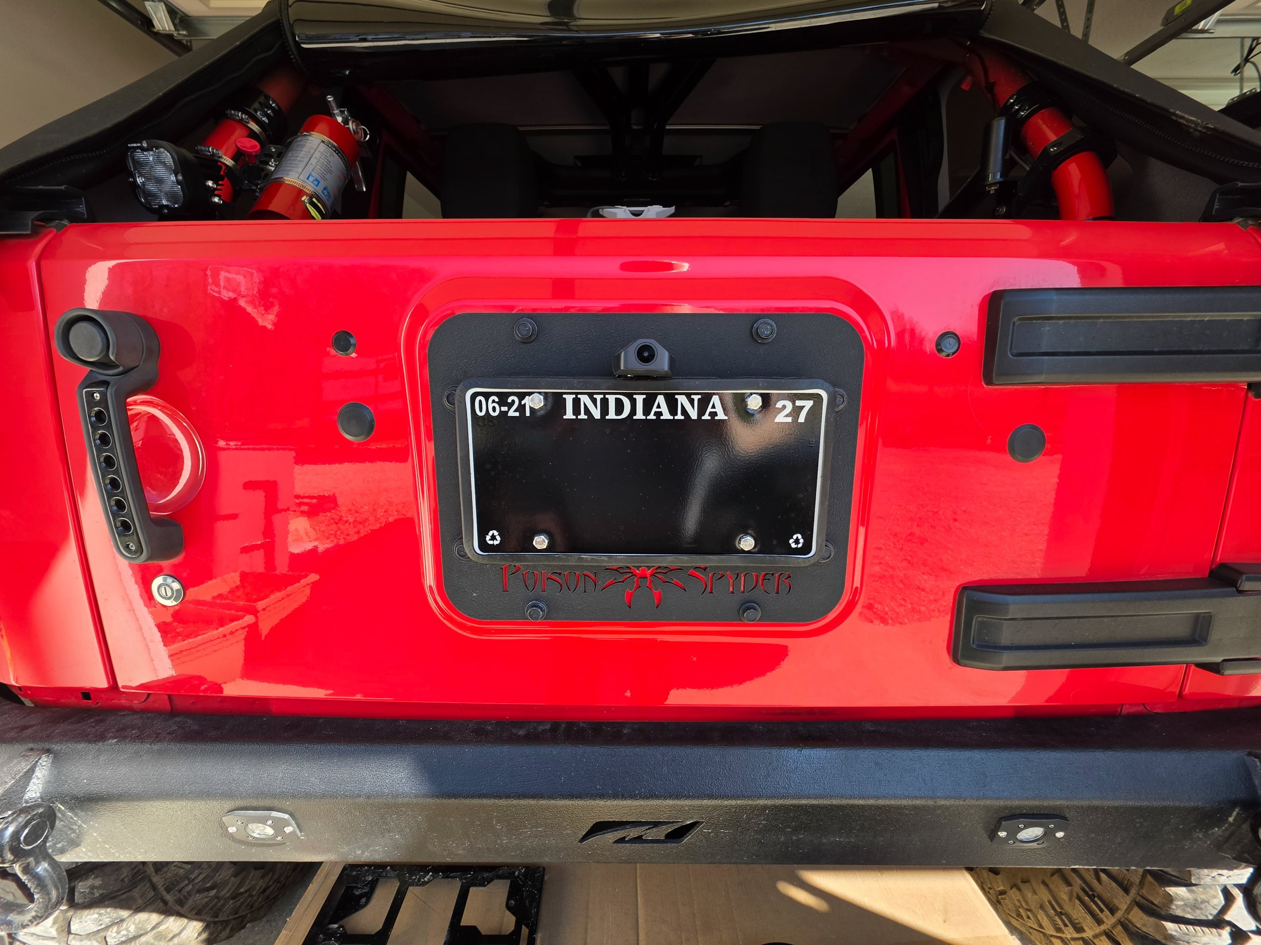

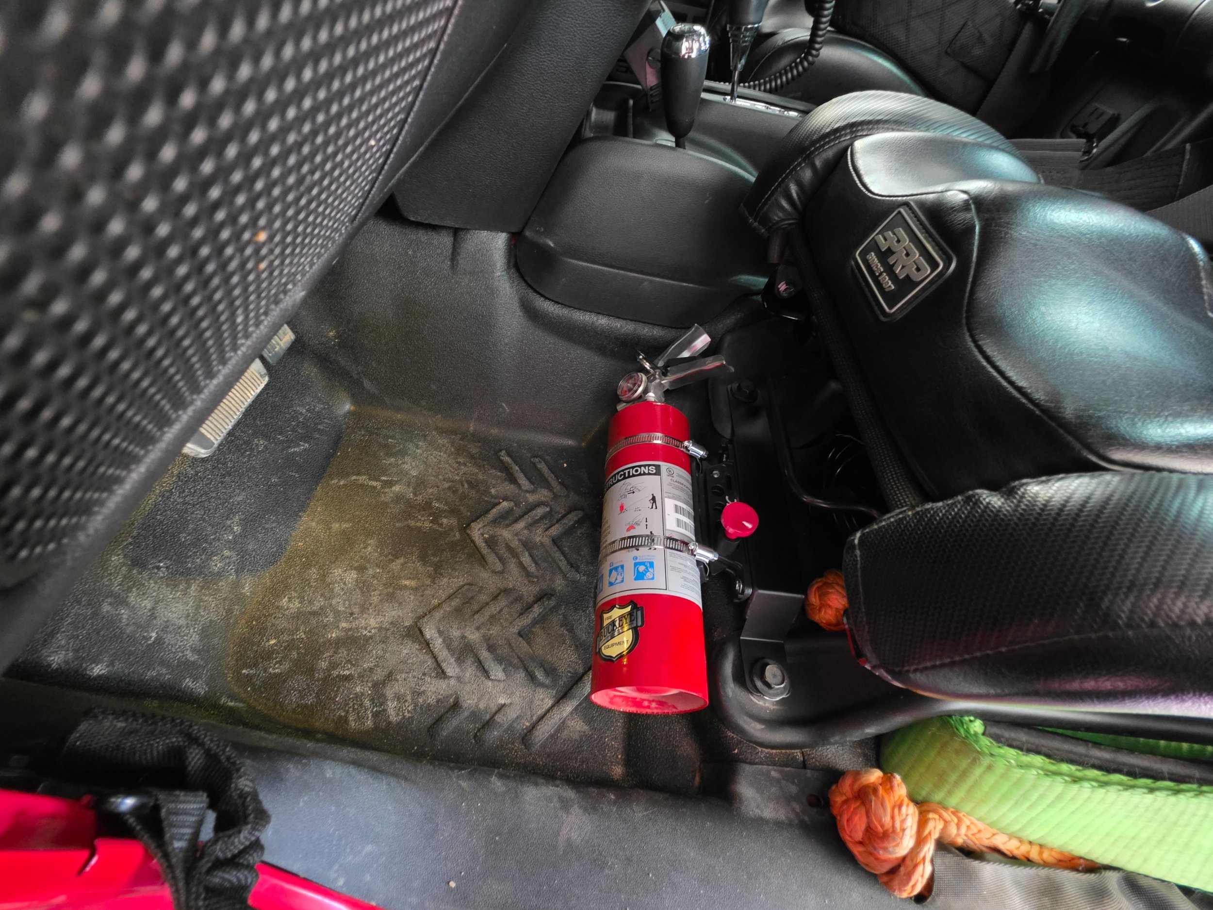

Installed a second fire extinguisher at my feet. The DV8 bracket is well made. We had a brake caliper on another JKU last trip out hang and catch fire on the way back to the campground. Luckily my brother didn't have his top on and was able to grab his quickly. Mine was under my TrekTop.
Also swapped out the Poison Spyder license plate bracket for a Motobilt one. Everything else on it is Motobilt and the PS was driving me nuts being different.
Love the motobilt vent frame. I get it when things don't line up and match.

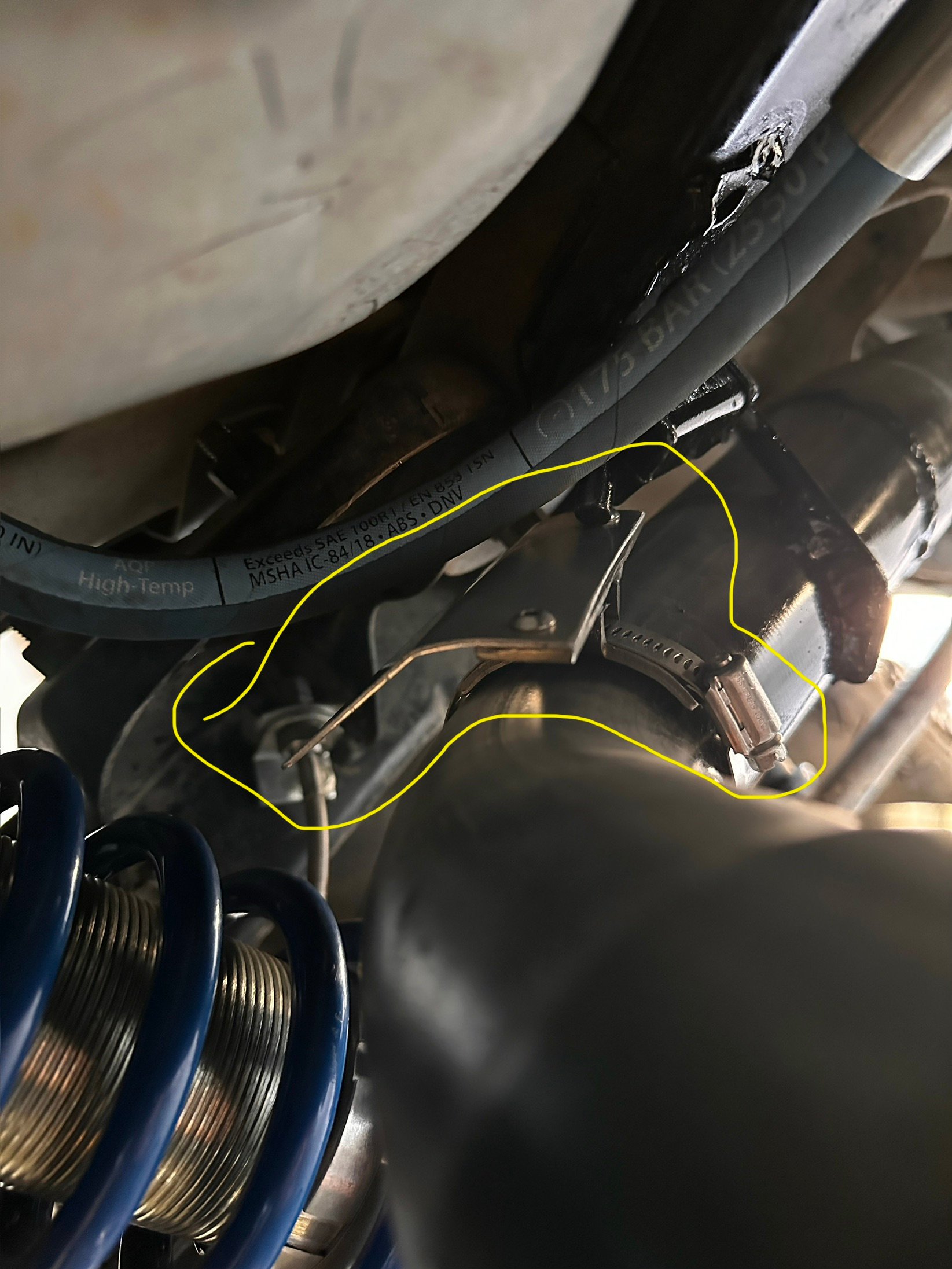

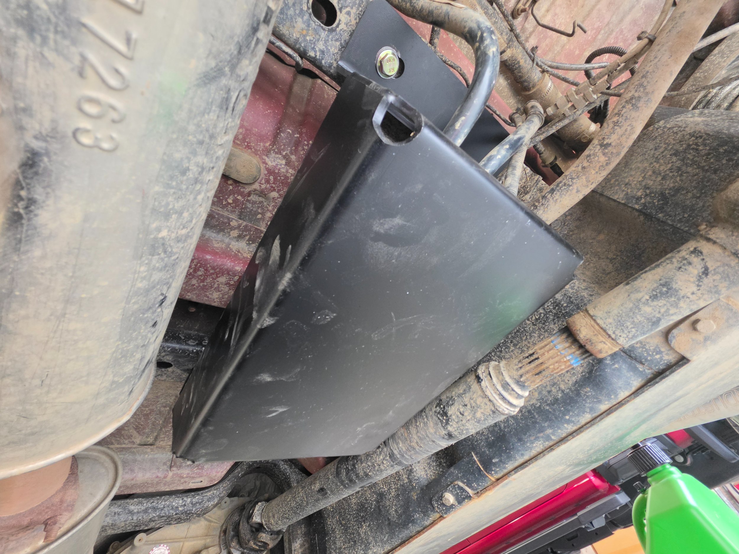

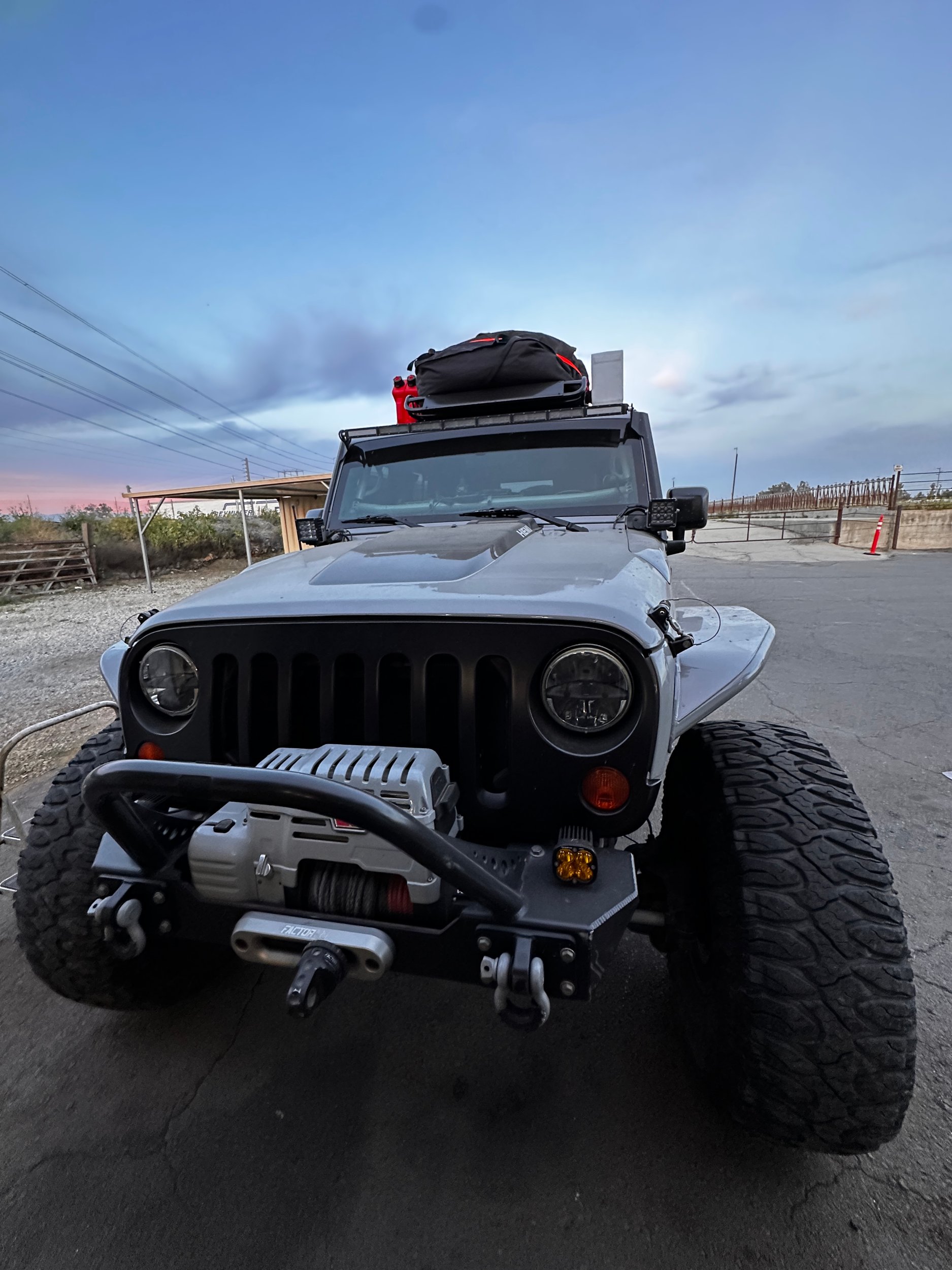

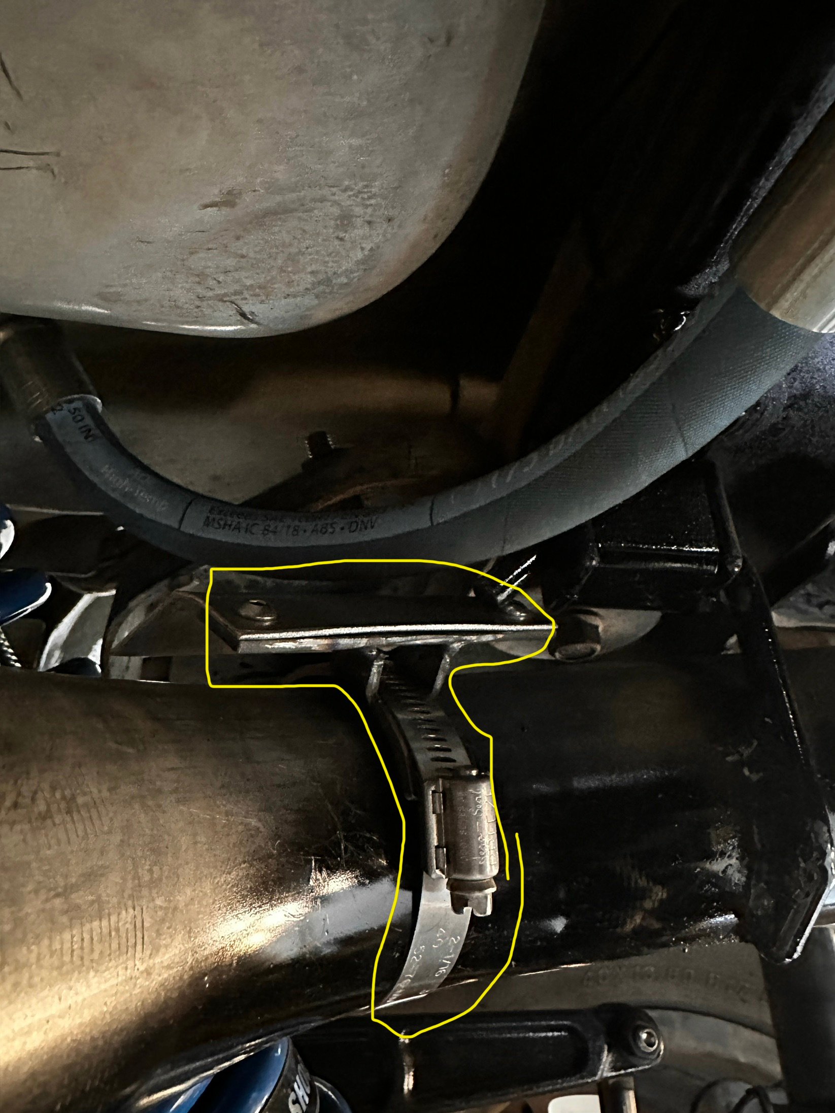

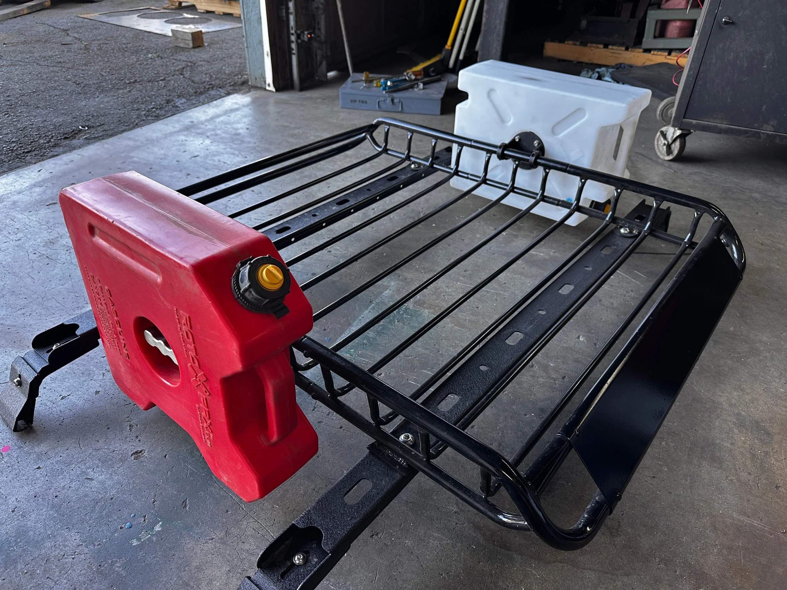

A few small things this last few days. Finished my rotopax mounts for my cobbled together roof rack and built a heat shield to protect the reservoir hose going from coilover to reservoir. I t crossed too close to the exhaust tube.

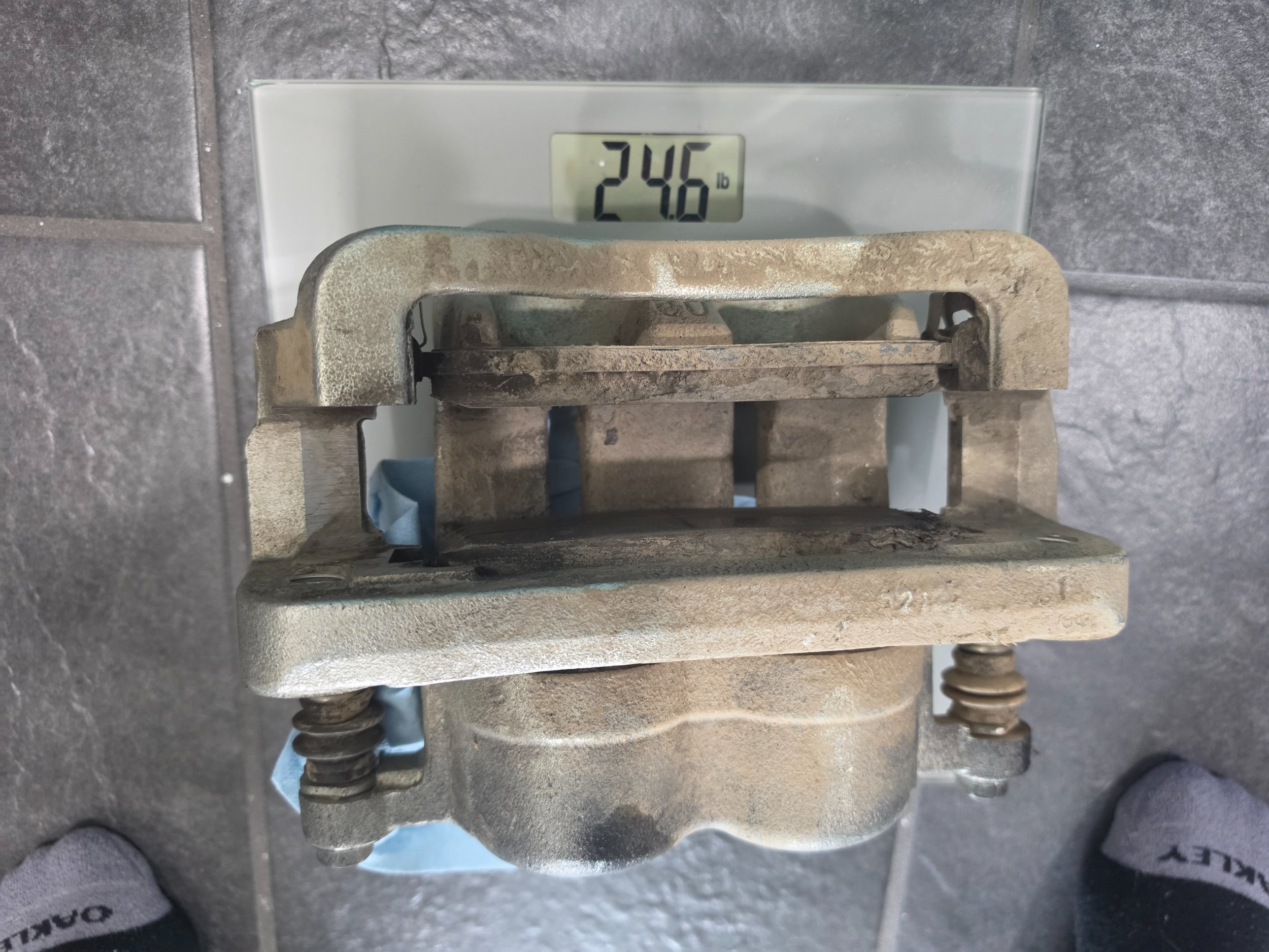

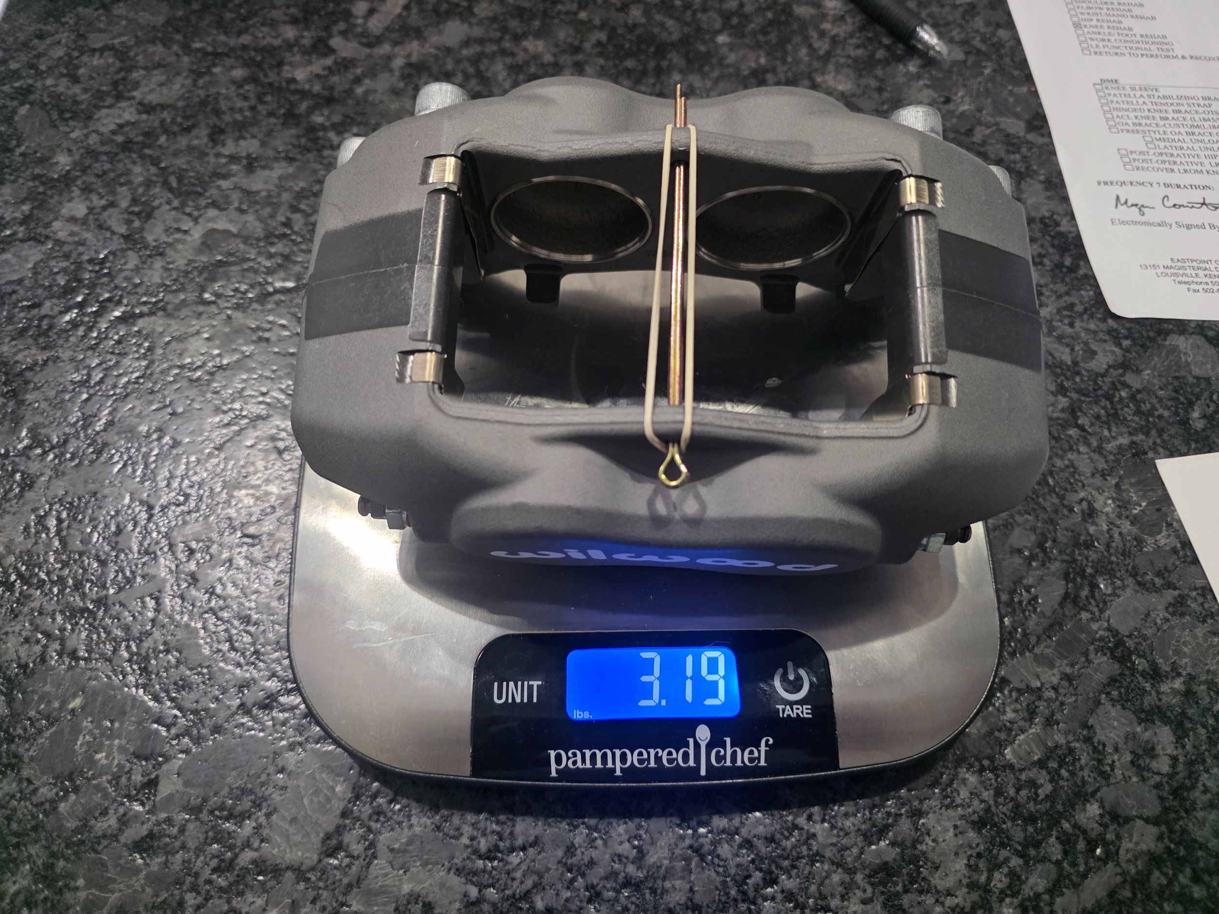

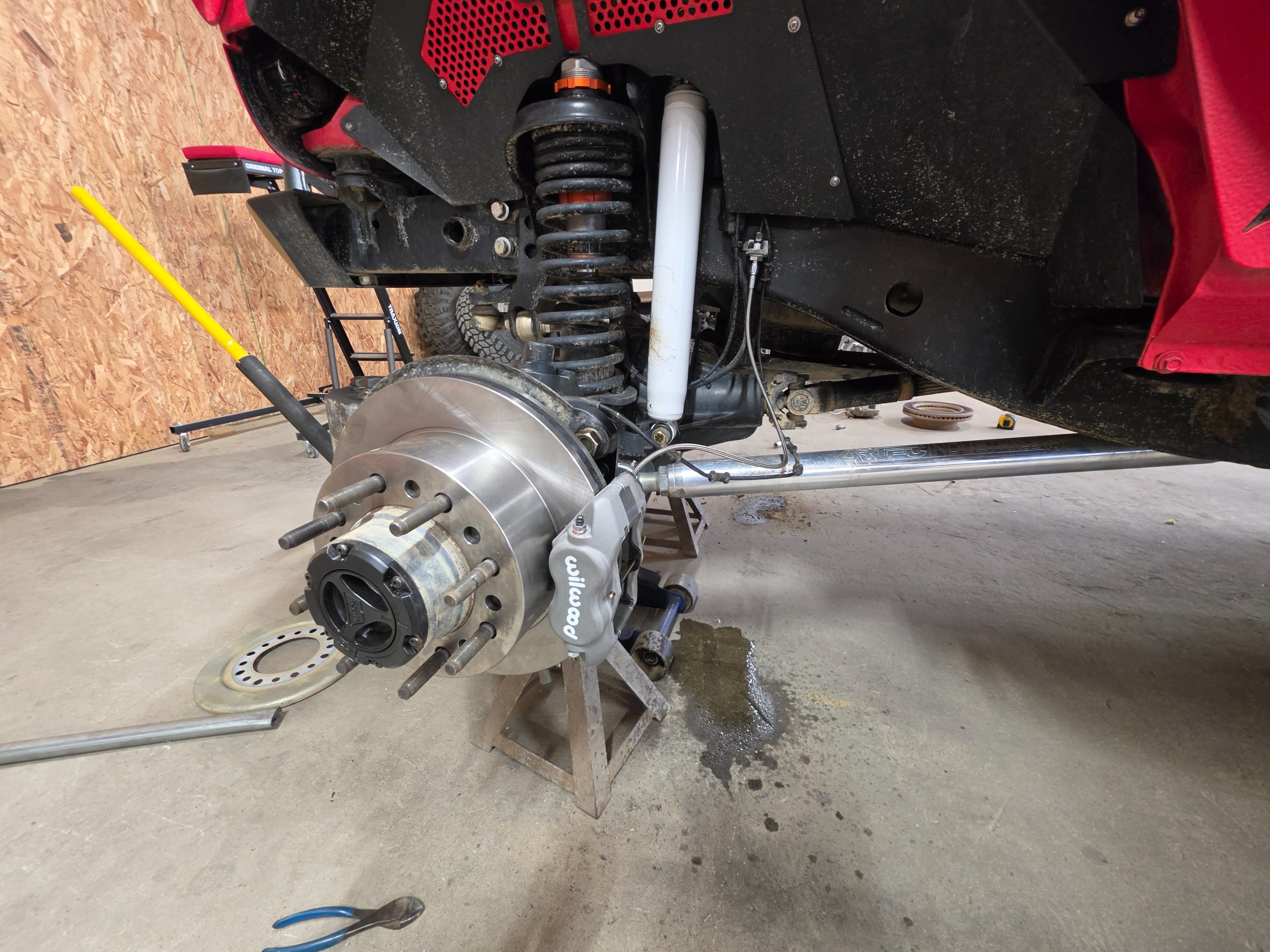

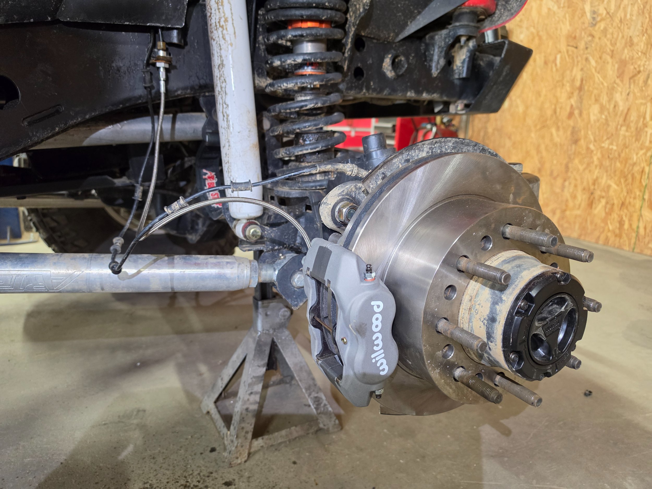

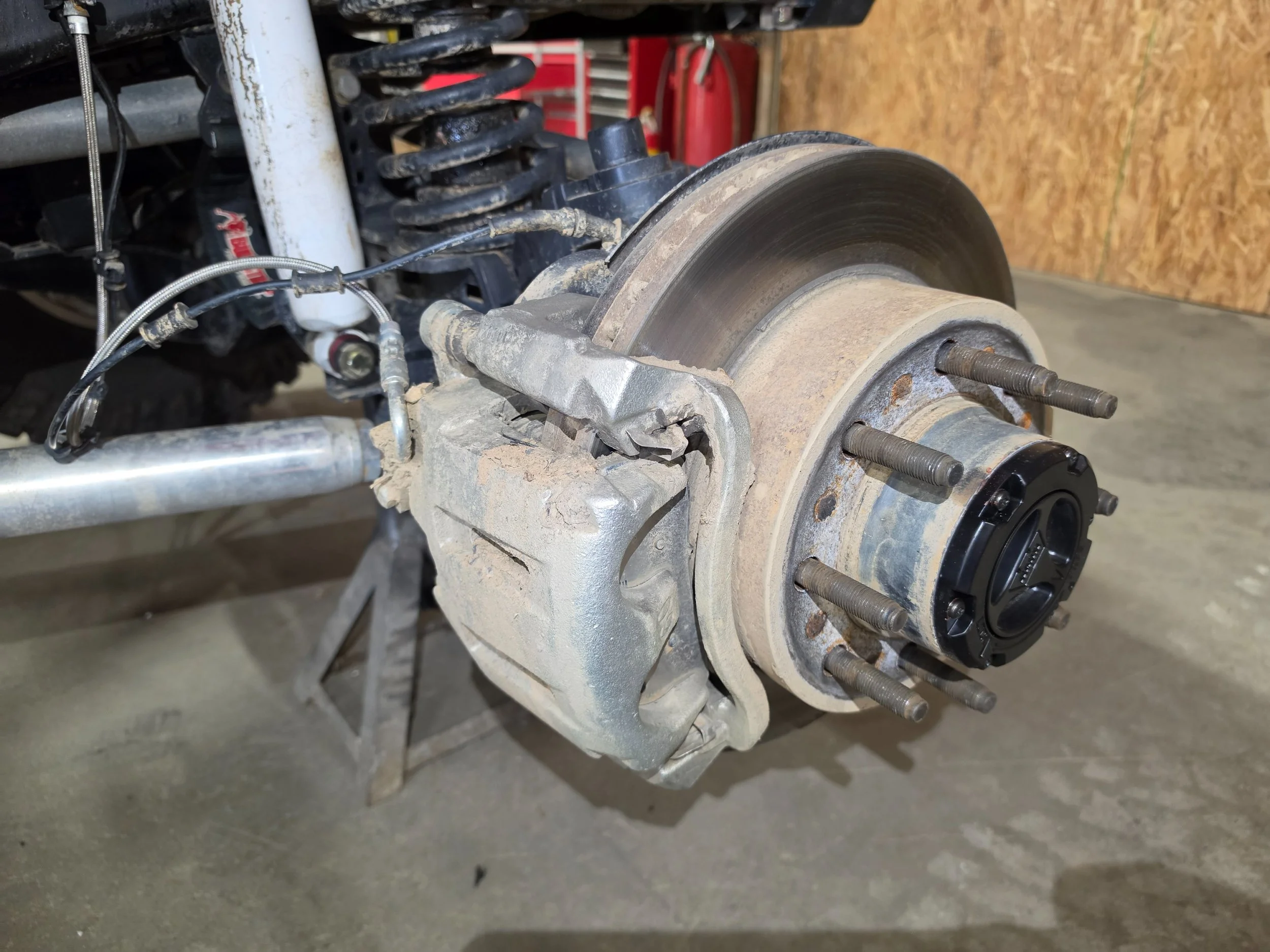

Got the Busted Knuckle Wilwood kit swapped onto my Dana 60. I'll bleed the brakes later today and brandish the pads in. This kit stops amazing on my brother's 2012 JKU so I'm looking forward to the stopping difference from the Super Duty calipers. The JK master cylinder just couldn't support the volume needed. These Wilwood calipers are over 21# lighter than the SD ones 😲.

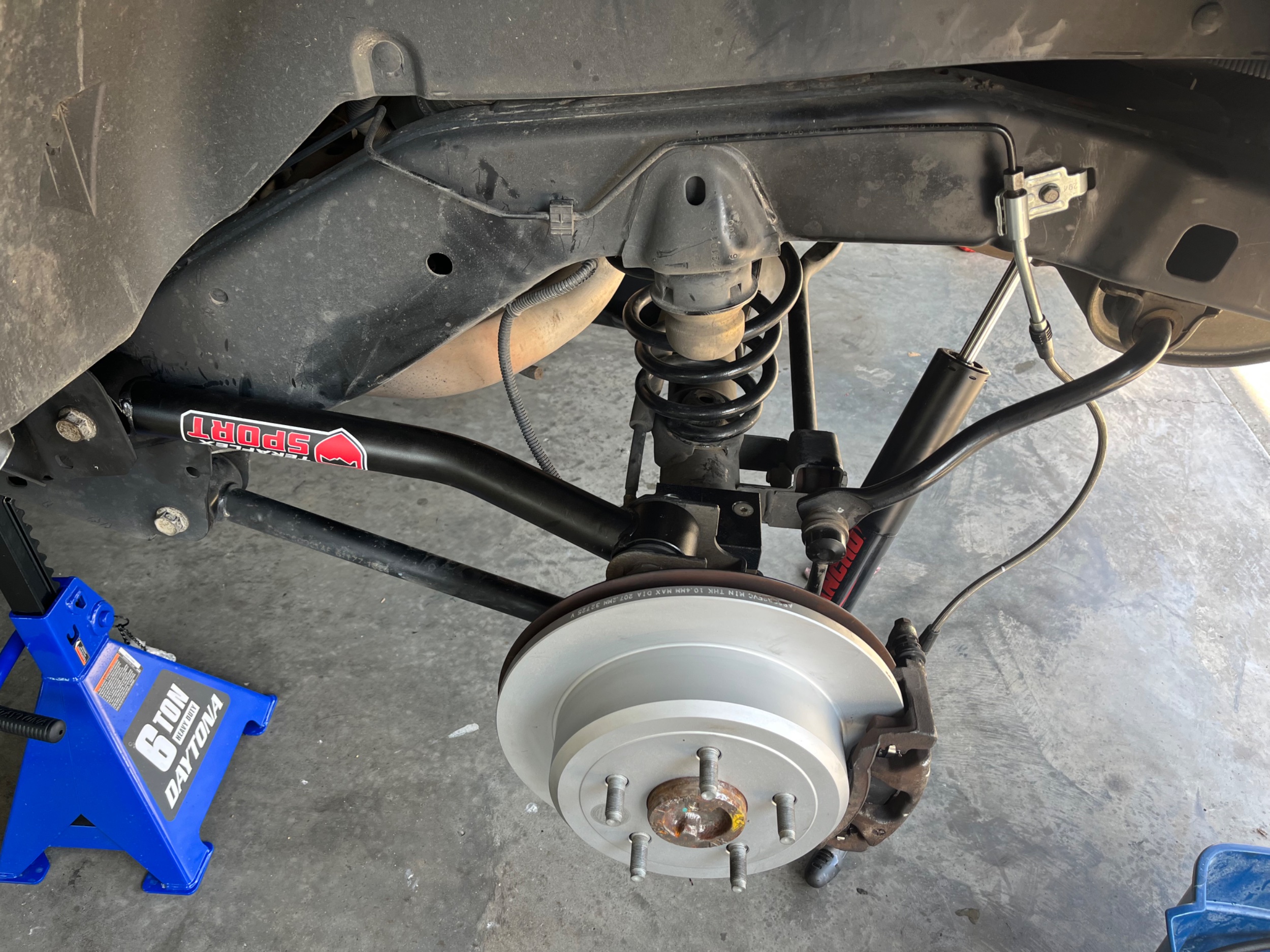

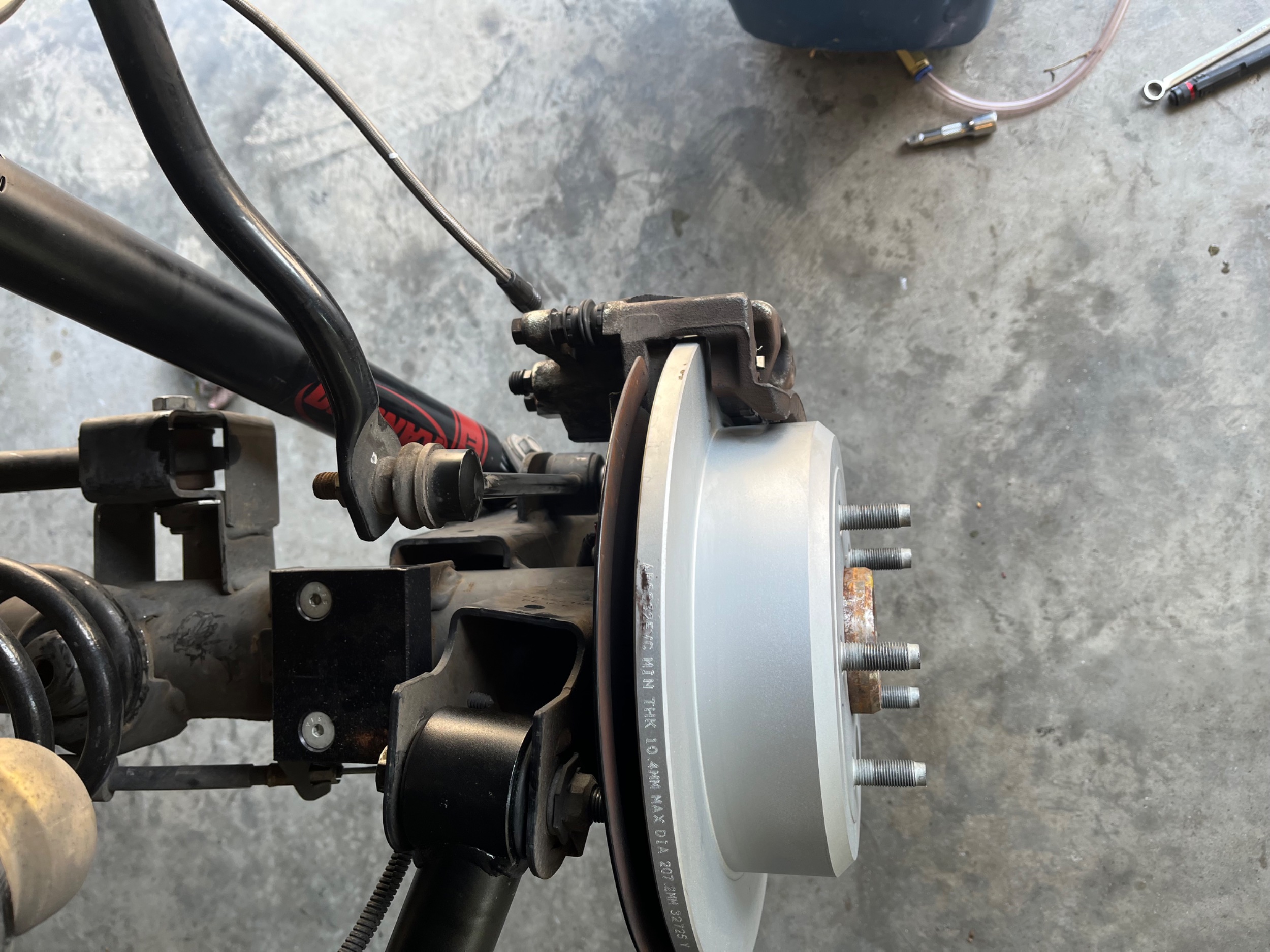

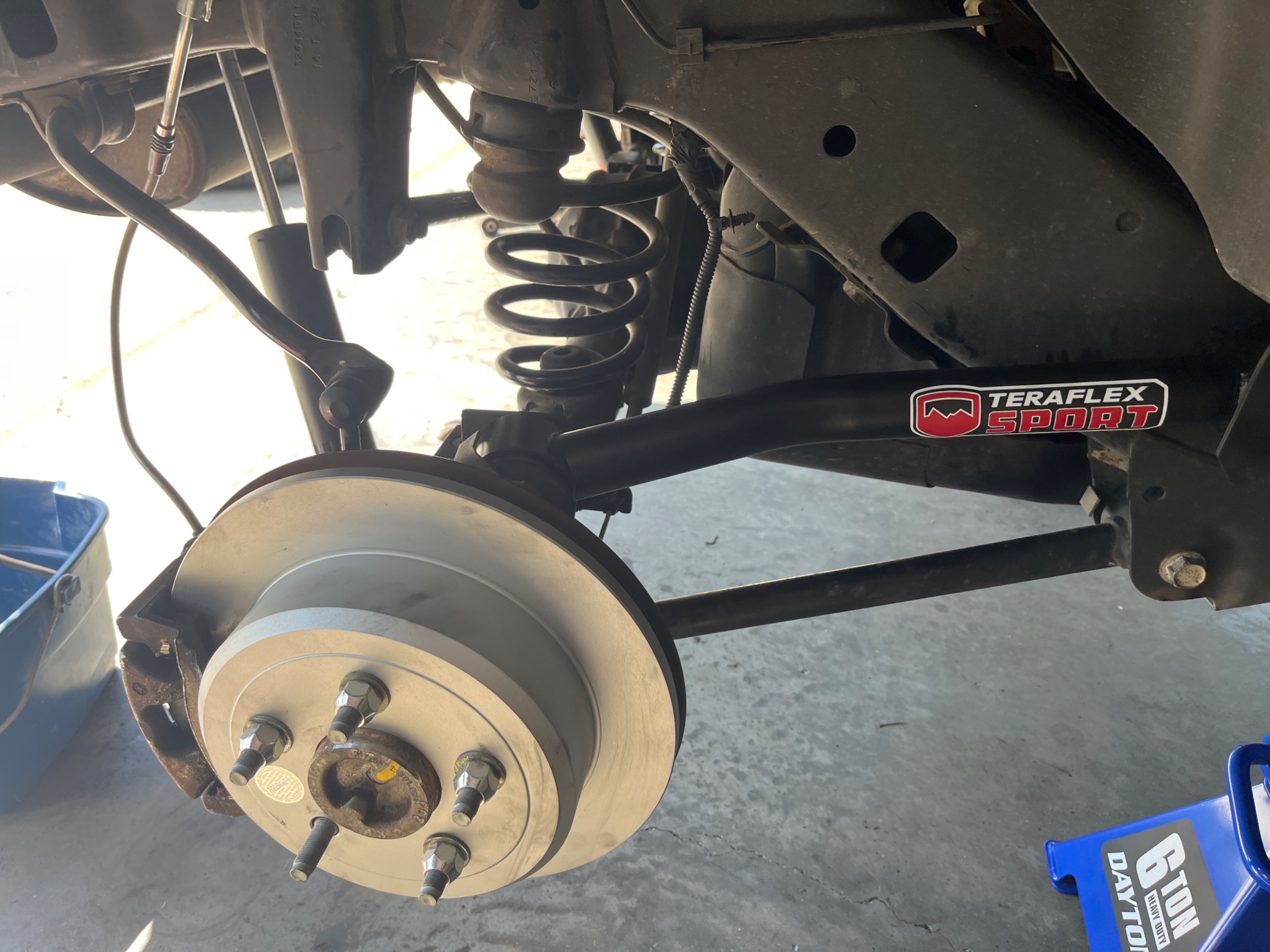

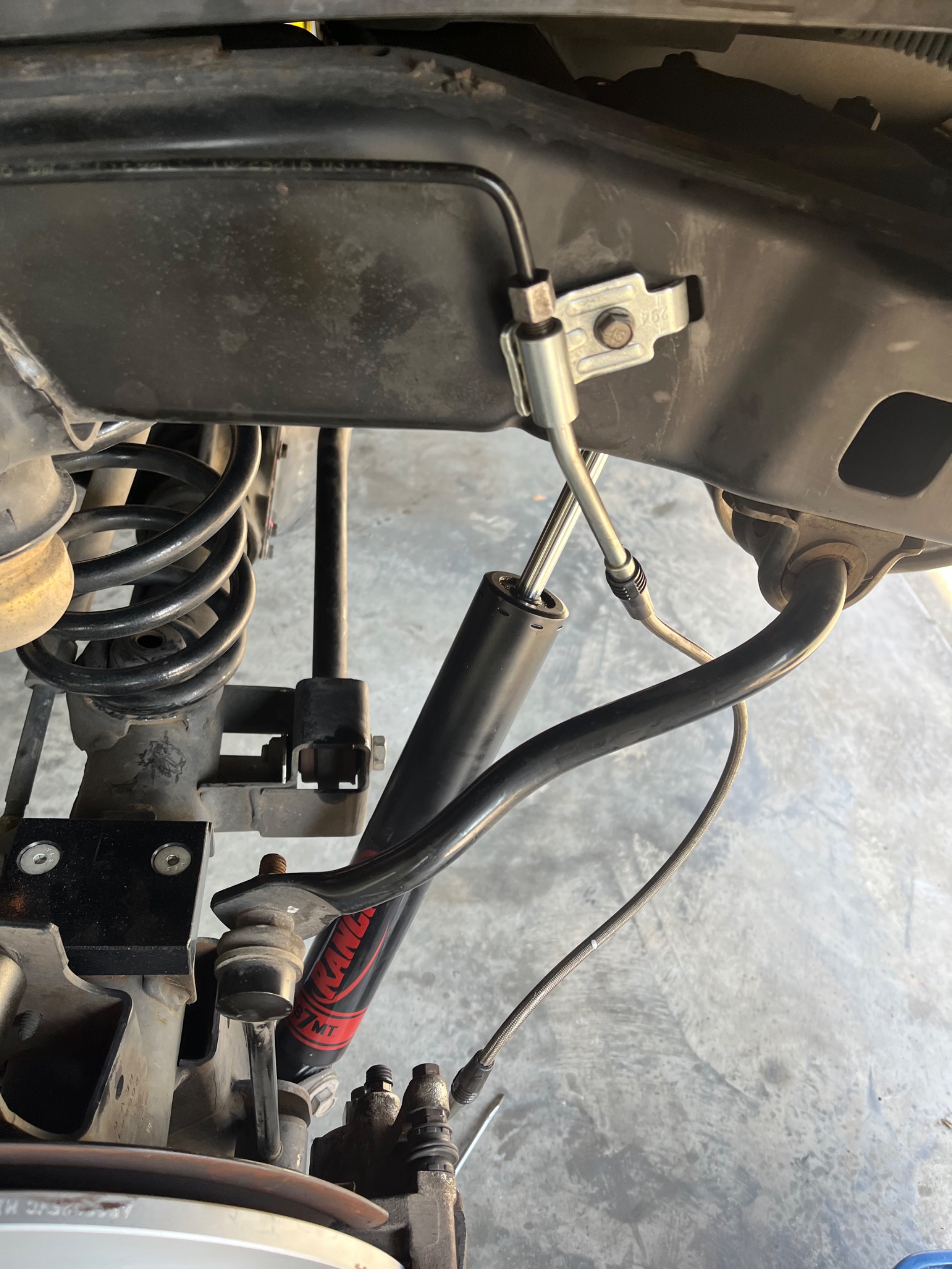

I adjusted the rear brake shoes thinking it would help with parking brake engagement but it still requires me to go all the way up.
That means you need a new e-brake handle as the clutch mechanism inside has worn out and is engaging too late in the pull... had the same issue with the Islander. It's a cheap and easy fix thankfully!

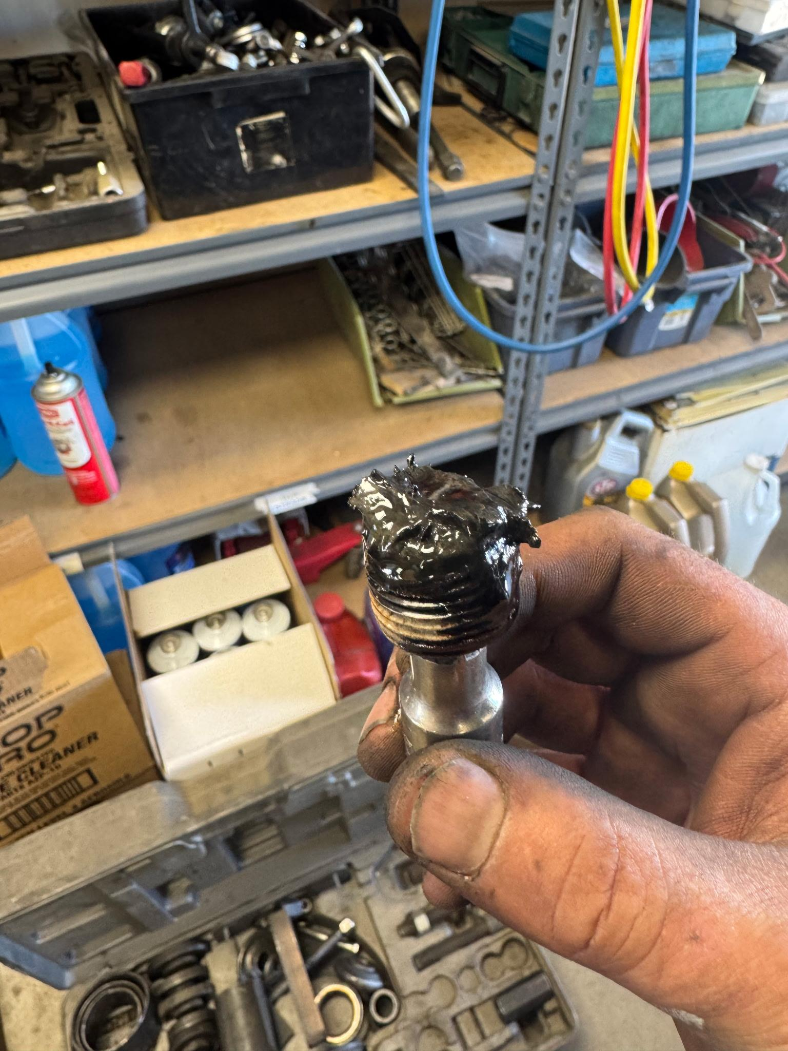

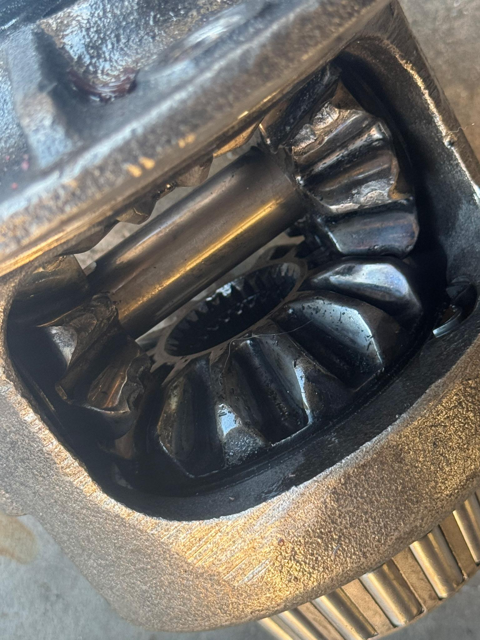

What my rear spider gears looked like, by the way. So far it's been a couple hundred miles and no chirping, the Yukon Grizzly has been quiet as a mouse except for a couple times when I was learning how I have to turn now in the Jeep.

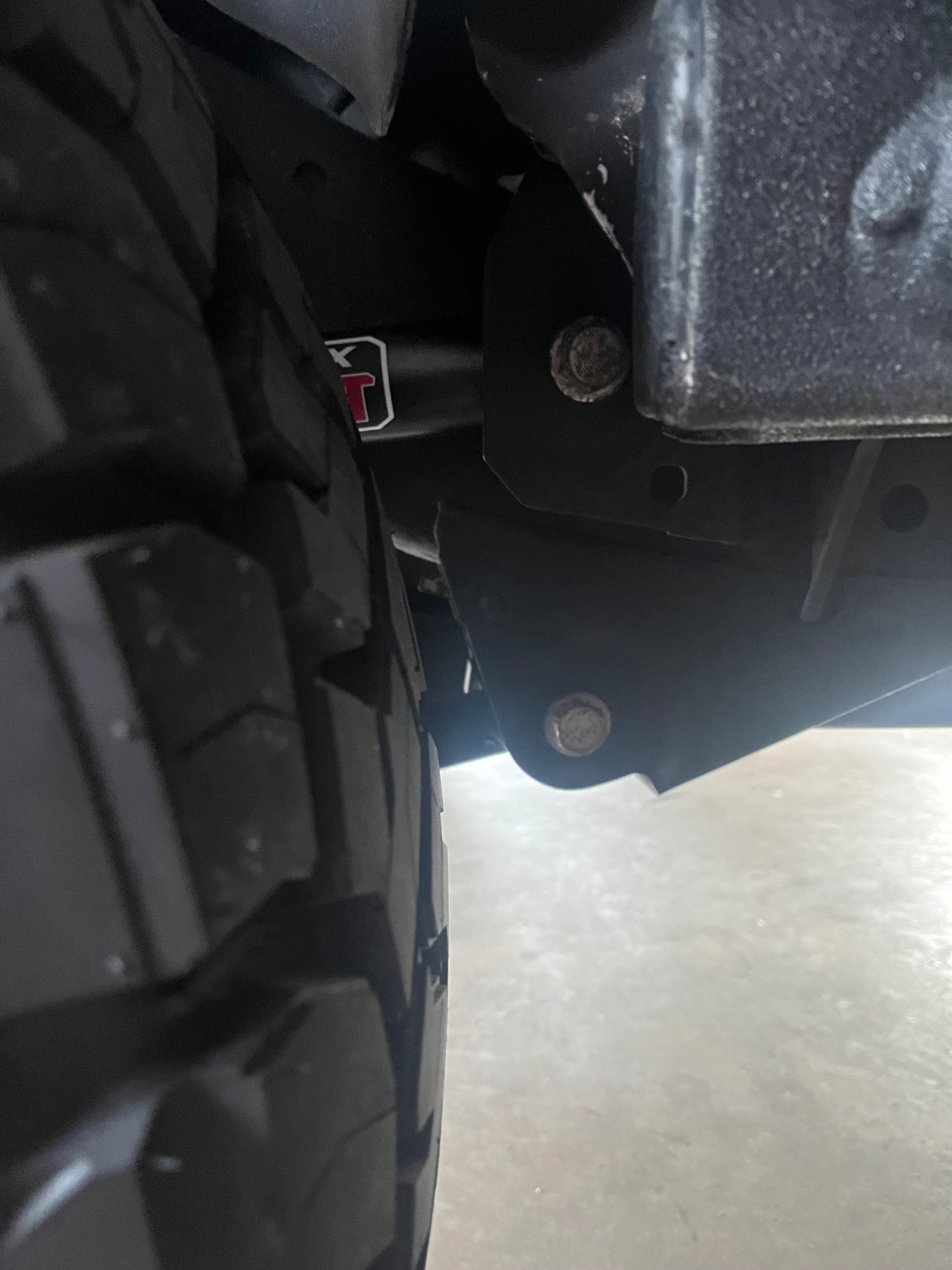

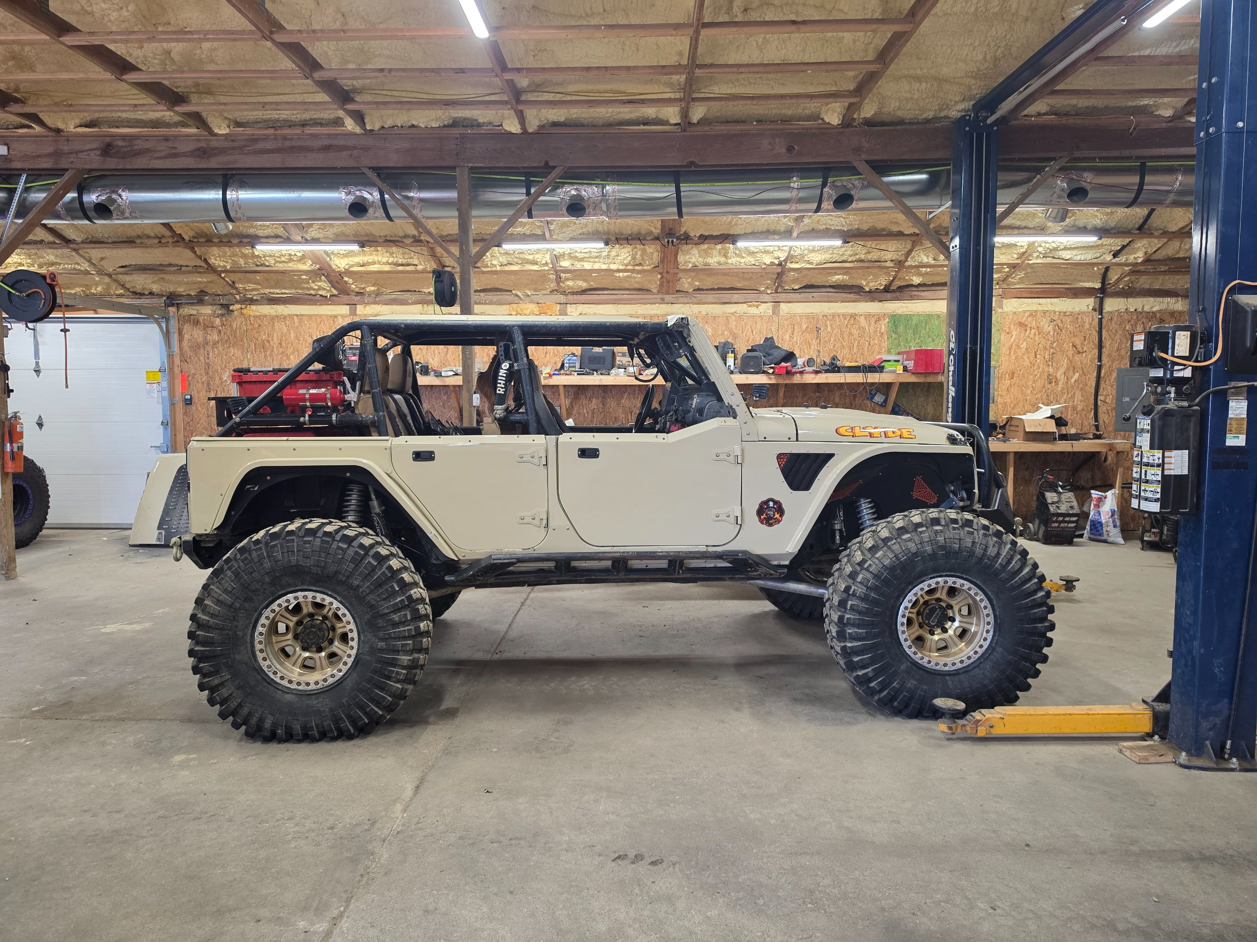

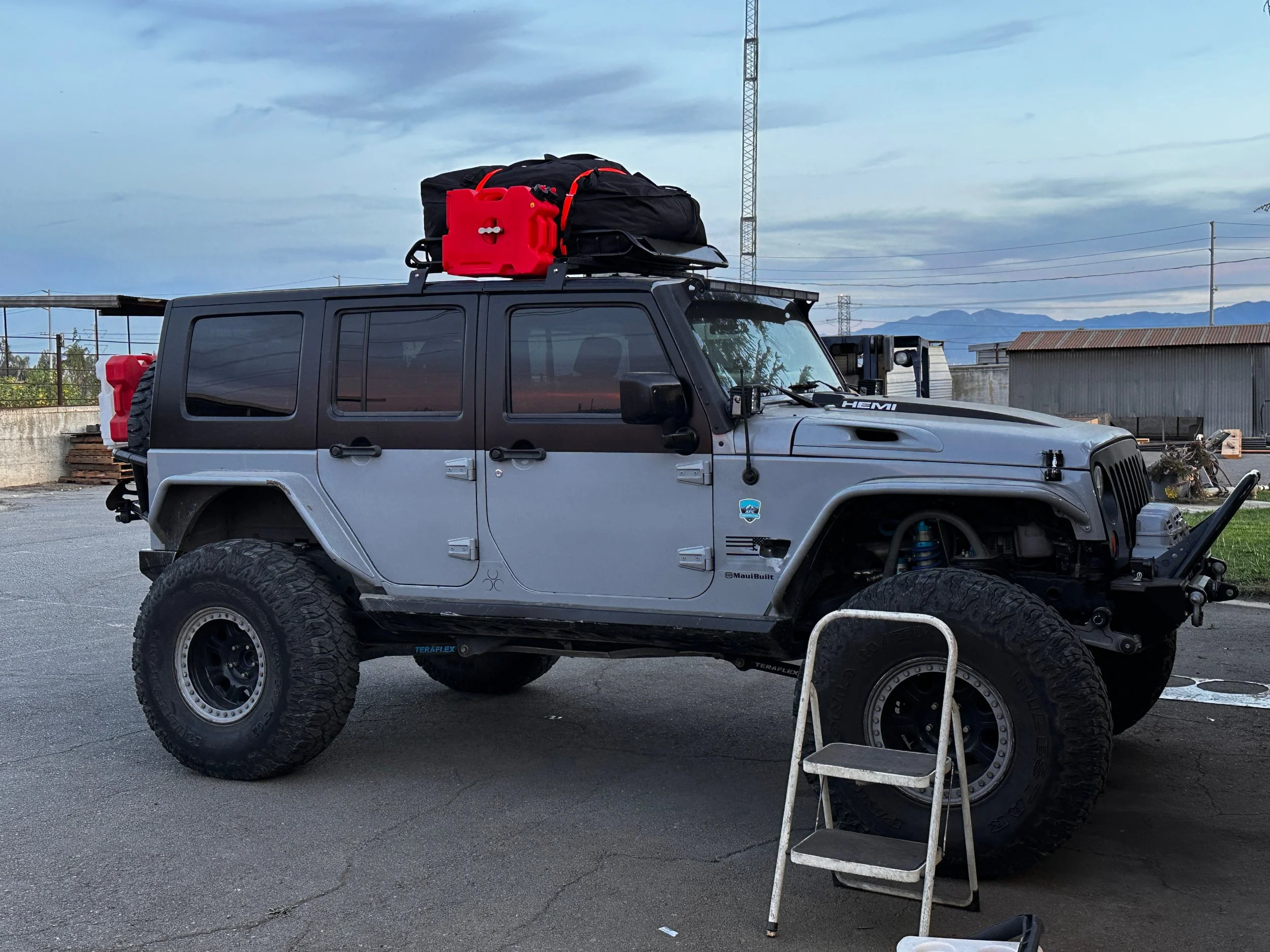

Today, I unloaded it. Had way too much gear for three day trip that we had to bail on 21 miles into. We (three rigs) were set to do the Mojave road from Friday to Sunday. We picked a "record temp" weekend to do it. Was supposed to be mid 80's typically but by the time we pulled the plug, it was 107º. We had plenty of water but other issues plagued us. One rig had new dirt logic coilovers installed and the shop forgat to tighten the unit/wheel bearing bolts. I could not get to all of them to tighten as the upper control arm needed to be pulled to get to the top two bolts. I did manage to get the lower bolts back in. We were able to grind the flange off and un jam it from the (new) axle. Lucky I had a grinder. I really wanted to conquer this trail.
