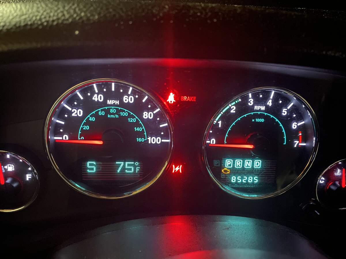

Has anyone resolved this issue? I have a 2014 Jeep Wrangler sport with the 3.6 engine. While driving, just like the first poster said, the transmission slips out of drive into neutral and back. Or I can pull over to the side of the road. Put it in neutral back in the drive and get home. I'm having the interlock issue too, almost all the time. The shifter is stuck in park unless I flip the key six or seven times. Every 6 or 7th time I'm able to get it from Park and down into the gears. I'm not seemed clear resolutions on the internet. I'm hoping everyone that has reported this issue here has found a way forward. Please share if you have. I replaced the brake switch and that did not help. There seems to be no repeatable way to make it work. I've checked with doors. Open doors closed, wiggling wires, keeping the key depressed while turning. So frustrating.

Update. I've replaced the shifter with a used one found on eBay. Will keep you posted. I'm crossing fingers because to do this. I disconnected the negative battery cable. When I did that last time the shifter solenoid worked several times in a row, but the next day the problem reappeared. Reappeared. So I think it will take at least a day maybe longer to confirm that replacement of the shifter is a resolution. I'm still getting the u0404 code and it is marked permanent. I've tried erasing the code but it will not go away. Will keep you all posted.

Any update i have the same issue with my 2017 wrangler. Happened to me randomly. I just changed the shifter, same issue coming back. I have the code U0103 lost comm with gear shifter module. On many forums the fix was too replace the whole TIPM… i have a buyer for my jeep and this shit happened to me. Gonna try to clean all the contact from my current tipm..

Thank you. I have already replaced my shifter and still coming back intermittently… i can literally see the gears light on the dashboard blinking on and off, then engine light comes on « No communication with gear shift module ». I must have a power issue somewhere but to locate is not so easy. I was thinking of changing the TIPM because when i switch off and on the ignition multiples times the issue disappear…so annoying ! I have a 2018 Jk with only 15k miles 😢
