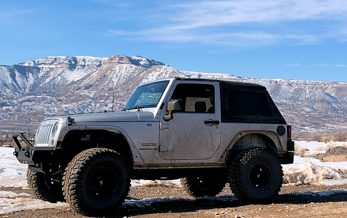

New to Jeeps let alone anything not a truck. But, in the 2 months of ownership have embraced and enjoyed wrenching on mine with the goal of going mild to wild with the build.
2010 2 Door Sport that is mostly stock.
Purchased SLIM with the following aftermarket parts and accessories; SmittyBilt Soft Top, Rough Country 2.5″ Puck Lift, Flat Metal Fender Flares, 17″ Level 8 Wheels, 35×12.5R17 Goodyear Wrangler MT, EAG Front and Rear Bumpers, K&N Intake.
Also accompanied with; a Christmas themed dash, a bunch of plastic stickered all over the dash, 119K on the ticker, bald tires, sagging springs, a ratchet strap secured tire carrier... and other miscellaneous things which have since been remedied.
The wheels / tires were replaced almost immediately followed a week later by the JKS JSPEC lift. The front driver side had a 2" +/- sag that was so bad the front sway bar bolt was digging into the coil spring tower. Using simple hand tools, a few borrowed, I had the new JKS lift installed by myself in a weekend. It was also crazy how easy it was to realign the axle with the adjustable track bar.
Not sure what a new JK drives like, but it is night and day compared to the puck lift which felt like a rickety POS and was a white knuckler to drive.
