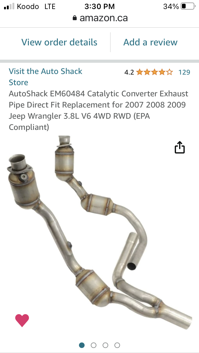

Anyway ordered a non factory CC system of Amazon .
Received that .

They are factory replacements but not made by Mopar . Sone reviews were great . One guy wrote only lasted 6 months . Couldn’t beat the price compared to OEM brand .

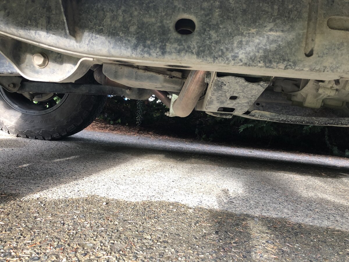

Yeah I’m kinda bummed . Got the CC installed professionally .
The crossover pipe hangs to low for front skid plate to mount .
It hangs about 2-3” lower than stock . It did clear codes I was getting so on the right track .
I need that front skid plate cause its pretty dinged up so doing it job protecting trans & crossover pipe . Without it would rip off cross over pipe and probably damage front end of trans pan .
So much for a good deal . UGH . There is an exhaust shop located in Ontario that sells the cat setup for JK’s.
Emailed them about clearance and if mounts properly like OEM. Just waiting for response .
About $650 CDN
OEM 1200-1400 CDN

That is a bummer. Curious, any option to have a shop cut the pipes up higher and provide a piece of new pipe between the two in order to raise the crossover pipe? Hope that makes sense.
Yeah, this should be an easy fix. Exhaust isn't rocket science. Any exhaust shop in business should be able to cut and weld to make this fit.

Apologies for delayed response . Just dealing with sone stuff .
I kinda thought about that .
Crawled underneath a couple of times to get a better idea .
Where the crossover meets drivers side . Wouldn’t really be able to bend in that area .
To cut & weld with shop rates what they are nowadays
It’s just about the same price and Just order new cats that actually fit .
Confirmed with exhaust shop
that cat system they sell 100 percent fits exactly like OEM.
No issues installing skid plate etc . Price is reasonable @ $650.
Going to install myself while the engine is apart . Have to do head gaskets now . Kinda knew on the way out but symptoms getting worse .
Since half of engine peeled apart may as well take of cats.

Yeah you would think . But where crossover meets passenger side can’t really bend that area . To cut it all up and reweld may as well get new ones that actually fit .
Perhaps the farmer focused shops around me are more willing to do that kinda thing. Though at the same time I know most don't like people bringing in random internet junk.
