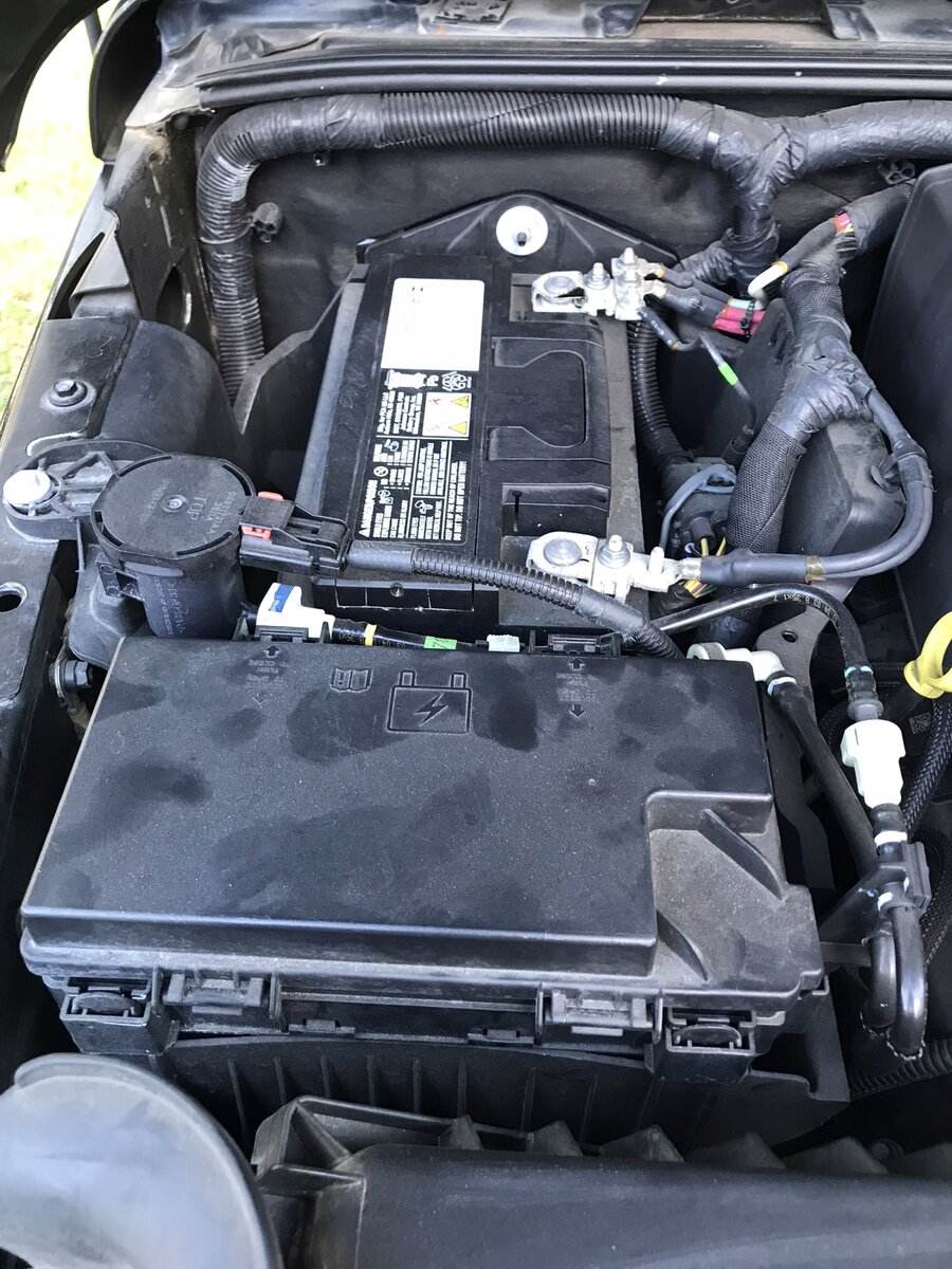

This is what I’m getting on my JScan:
What does this mean?
B210A
System Voltage Low
Basic Description:
System Voltage Low
Module Type:Tpms
I did go and check with some tire companies and they had no clue.
I went, then, to a mechanic and he thought the low voltage issue could be the main battery or the auxiliary battery?
Thoughts?
Getting to the Auxiliary battery is a chore/pain!

You have an auxiliary battery?
I have not tried to get it out yet, but I think so, Supposedly under the fuse box. I’ve watch several videos on removing it by taking the fuse box apart.
That’s a little scar for me.
I’m just not sure which battery is making the scanner show low voltage.

I’ve attached a photo of my engine bay.
Notice my fuse box is in front of the battery.
on videos I’ve seen of jls the fuse box is near the fire wall
Reactions: Speartip and mrjp
That is indeed the engine bay of a JK. But I do not think the JK has an auxiliary battery. The JL and Gladiator do, but I can find no source that has any info on one for the JK. If you were told it is under the TIPM, then I would start by removing the battery to see if that would give me any access.
I feel like a real dummy with my questions about an Auxiliary battery in my JK. Yes it is a 2018 JKU. But everywhere I look and all that I read, JKs, do not have an auxiliary battery!! Right???
That's kind of what I've been saying since you mentioned it... I initially thought you meant an aftermarket dual-battery kit.
