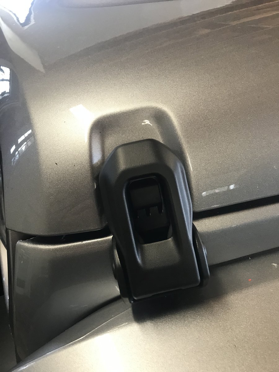

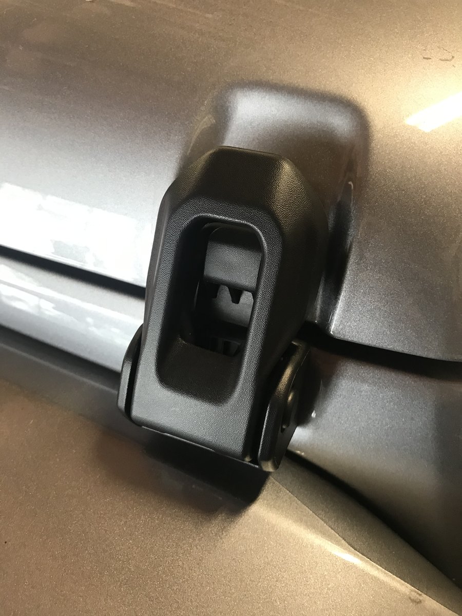

Hood flutter fixed! Installed new JL latches and very happy with them. Would have been happier if Jeep would have given them to me though.
