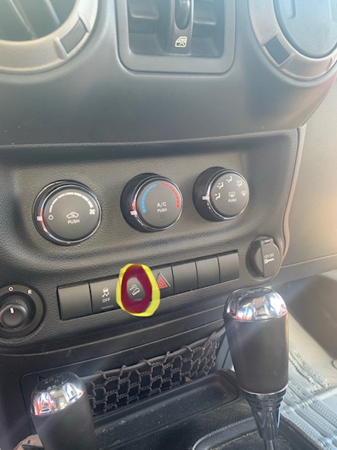

This is what I found. ??? I didn't see a Towing Button. I don't know what this is. ThanksThere is a towing button below the radio try to push that button if it improves.
YesThis is what I found. ??? I didn't see a Towing Button. I don't know what this is. Thanks
