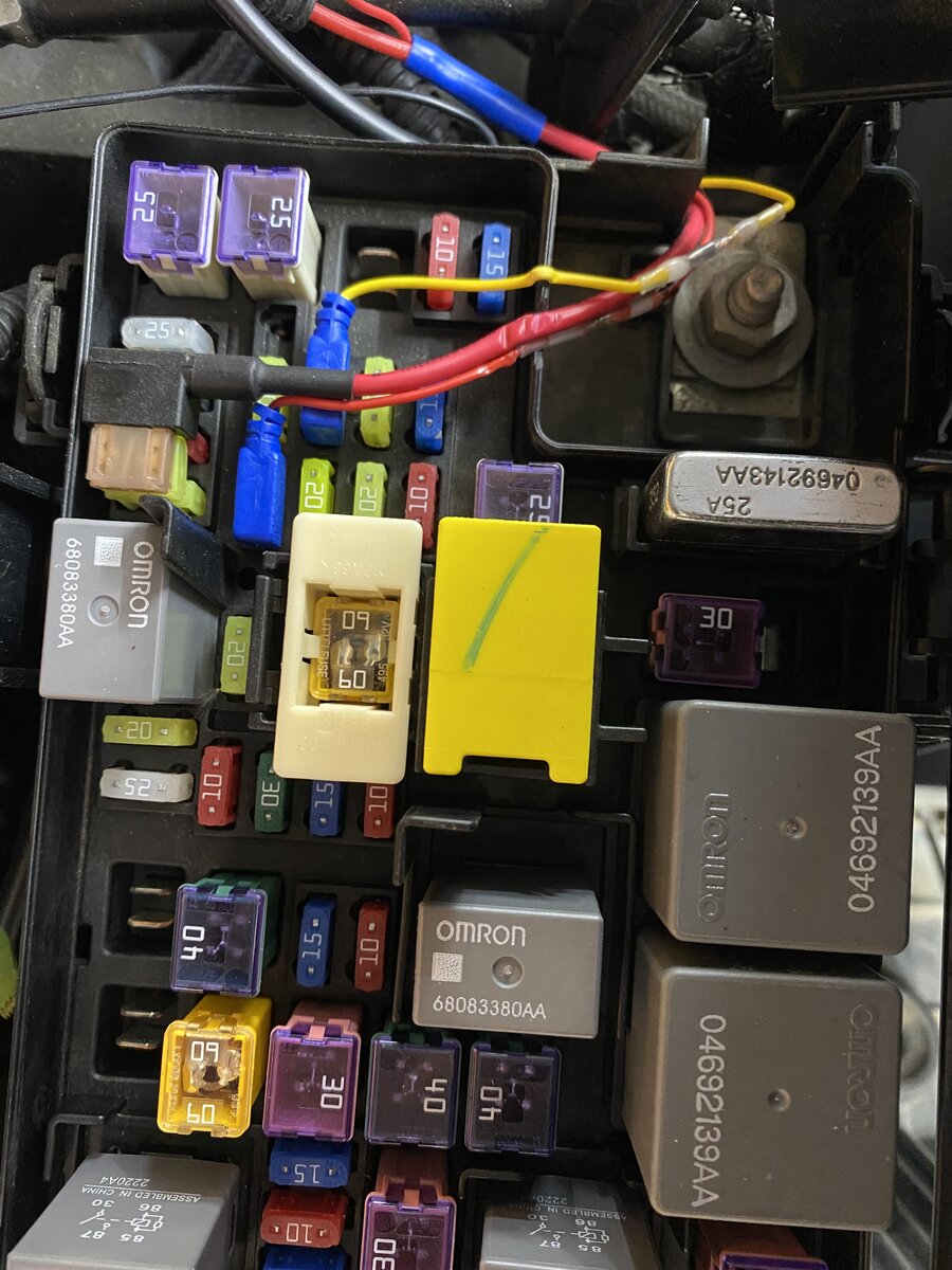

Cool! I’ve got to go back a read your write up for how you connected to the fuse box. Not really a fan of making any holes in that thing.
Just ran the wire through the existing hole. I did go back and make a small notch where you can see the wires being pinched. I put the wires in the notch and then slathered some silicone over them to seal it. Should be as water tight as OEM.

I went back and took a look this morning. Since I’ll only have the one device going into the box, might be able to have them fit. Thanks again.
