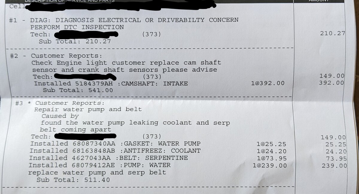

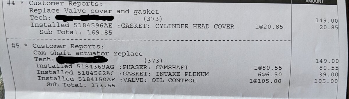

Right. He said that someone has been in there messing with this. Someone was probably trying to fix it on their own and was trying different things and just never figured it out and decided to instead just sell it
Reactions: mrjp and Dirty Dog
But that included that the water pump and the serpentine belt need to replaced with it. There was two hours on the machine It was hooked up for 3 hours but he took one hour off and only charged me for two for the diagnosis and the parts and labor I believe was around $1,400
Dang man, thanks for the info. Sorry for the issues!
