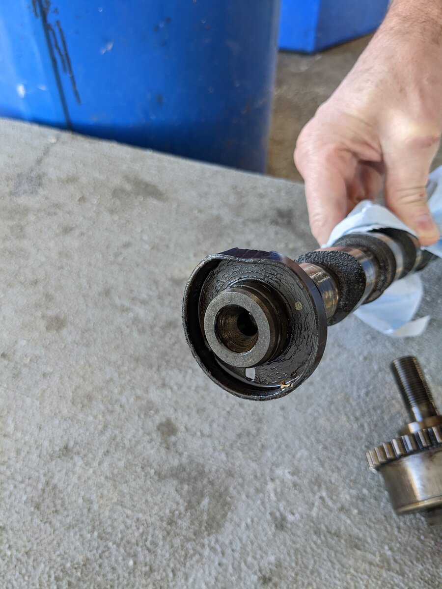

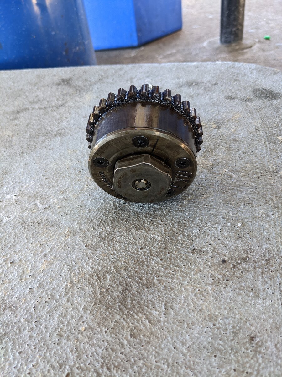

We changed both camshaft position sensors and the crankshaft sensor and still kept getting the code with various other codes. Finally took it to the Jeep dealer and the grounding wire needed changed and it helped get rid of all the codes except one. Still had the camshaft position sensor code on one of the banks and they found the actuator on the tip of the position sensor had broke off, or something like that and they repaired that and now it's good to go

I had the same issue. The traction control light and the engine light were on and it would knock off my cruise control and it would bog down. We changed both sides of the camshaft position sensors and the crank shaft sensor. Still got codes. Even though we cleared the codes and tried to relearn the codes, It did not matter. We finally just took it to the Jeep dealer and the ground wire on the harness kit needed changed and that got rid of all the codes except one. They still were getting one side of the camshaft position sensor code. They investigated further and saw the end of the camshaft position sensor (has something to do with the actuator) and it was broke off, so they repaired it and now it's good to go
