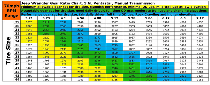

What is your RPM's with the 4.10's at Interstate speeds?

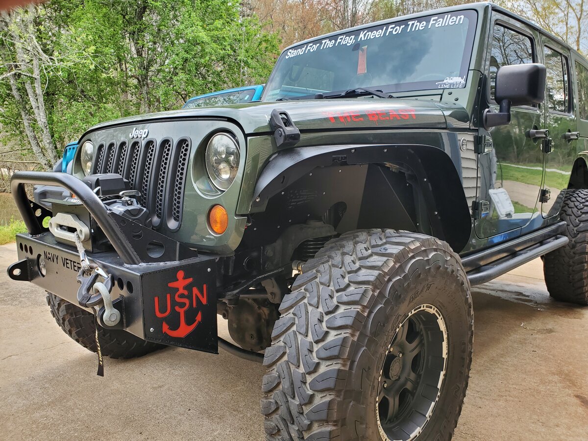

I'll have to double check on my way home today to verify for sure. But I also do have alot of weight added to the jeep. The 4.5" lift, 37s, ace rear bumper with full size 37 spare and hi lift jack, ace step rails, front bumper with 12k winch, hard top
I just found a regear chart and for the 3.8 with manual trans and 37's it recommends 5.13 or 5.38. And that was driving at 70 MPH.
