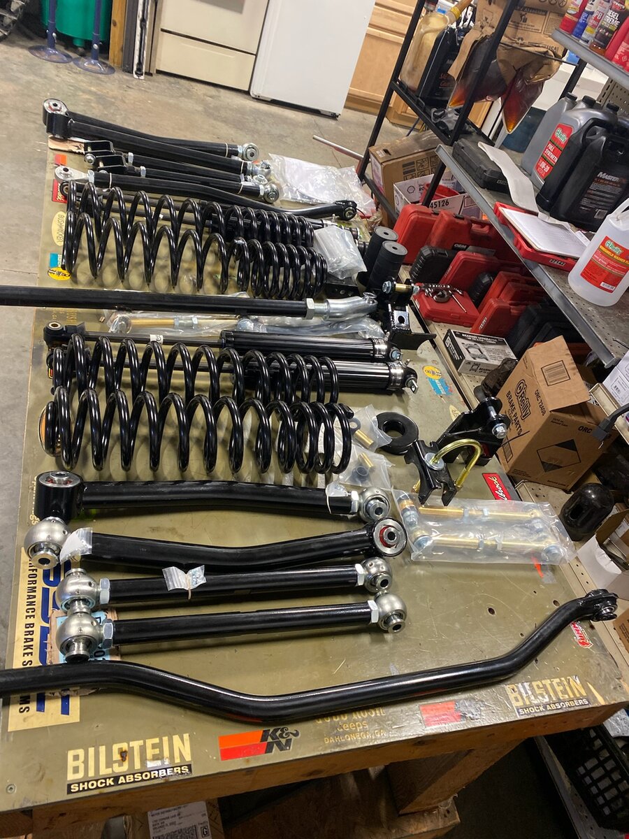

I really gotta get the RK lift on..... 5 years sitting in the original packaging is long enough to be "aged" don't you all think?

I think my RK kit is the same model or at least very similar to the one you have. I will run the 35" ProComp MT2's until they are worn out, then possibly 37's with a gear change.
RK kit came with everything including the shocks, brake lines and the recommended AEV tuner to change tire size in the ECM. Nothing else required except if I wanted heavy duty steering linkage, that was separate.

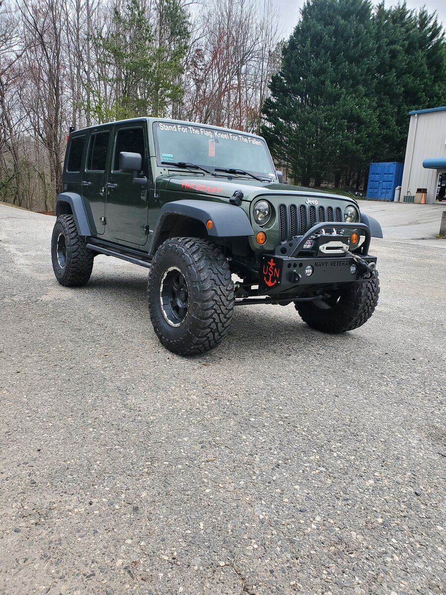

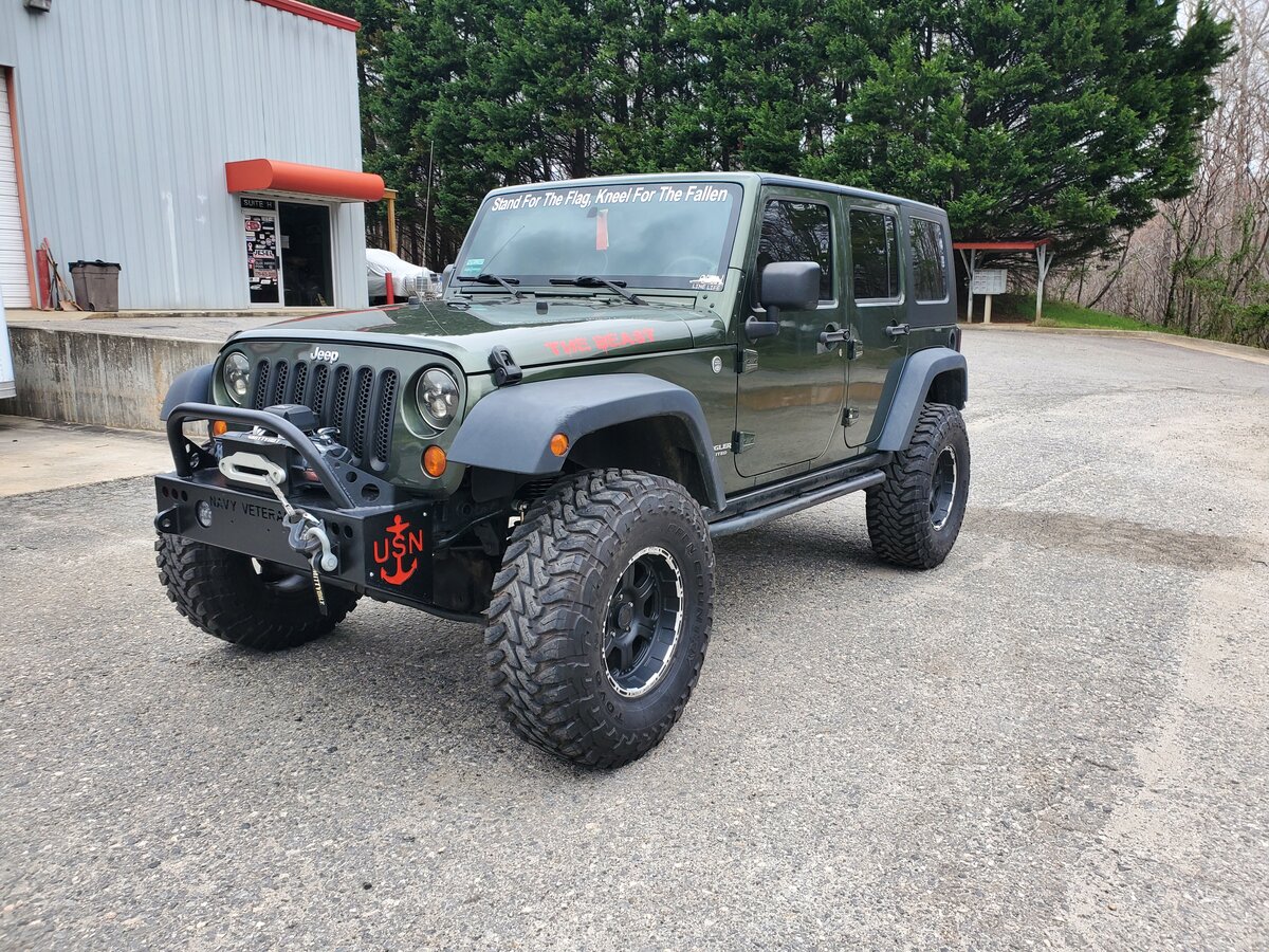

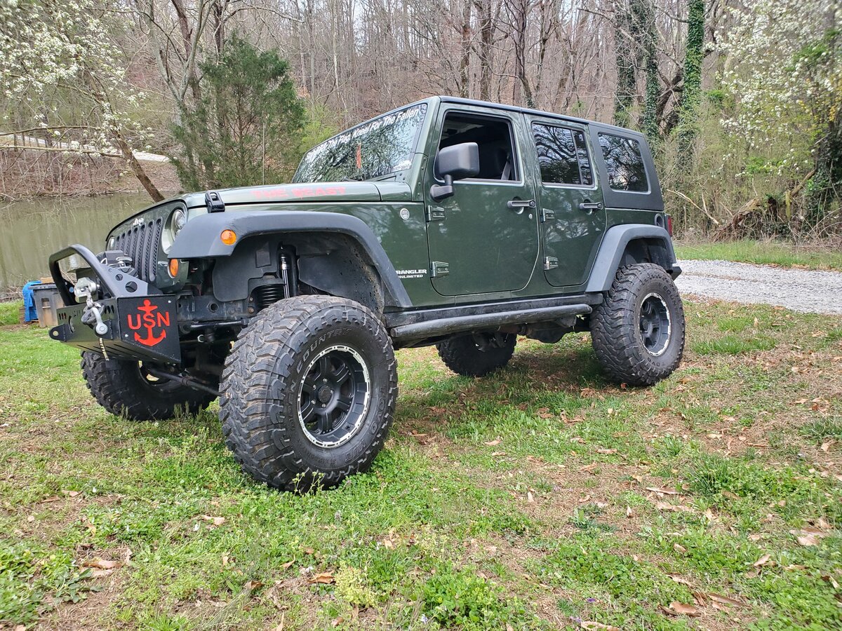

I had a shop do mine and it took them 2 days. Main reason for having them was due to work and jeep being my only means for transportation I couldn't be without a vehicle for a week. I had a coworker give me a ride to and from work for the 2 days.
The RK kit came with everything including extended brake line and also hi steer steering. It was the complete suspension overhaul kit.
I'm still not 100% sure my jeep will even fit in the garage anymore with the 37s on lol.
I'm running factory 4.10 gears at moment and jeep don't seem to do too bad with them and the 37s. Still pulls and gets down the road just fine. Only problem is I live up in the mountains so the elevation and up and down hills makes me have to down shift more to get up. It will be going back into the shop here within next month or so to be regeared to 5.13
