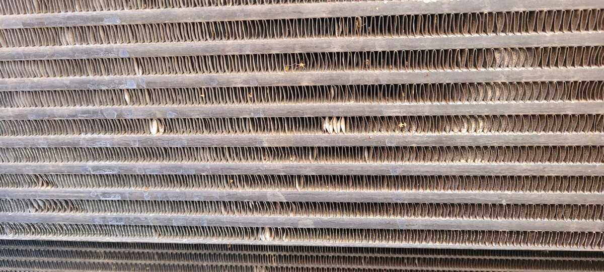

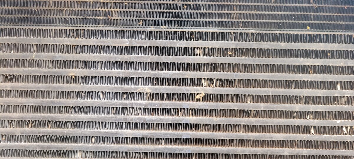

Swapped my headlights out the other day and here are pics of my rad. Are these fins concerning to anyone?

About to head out to get another jug and do this burping again. I posted pics of my rad fins, if your have any opinion on that.
Fins generally don't tell you anything unless you see rusting/corrosion/coolant residue around the bottom where there may be a leak.
Bent fins on radiators are like freckles. Everybody has some. The fins are just thin bits of metal. Kamikaze bugs are enough to bend them, even without the occasional rock being tossed up. They absorb heat from the water in the channels and transfer it to the air. If the channels are damaged, that can affect water flow. But it takes a LOT of fin damage to have any real impact on cooling.
